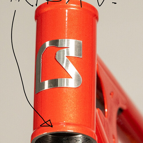

Does the surface inside that HT look bad? Yes. It sure could ‘look’ better.
Did the unclean reamer/facer from the previous shit-bagging video make me squirm a bit? Sure did.
Will the headtube work for its intended purpose even with that rough finish? Also yes.
Some commenters like to bring up fatigue failures due to the rough surface.
Does surface finish impact ultimate fatigue life? Yes. But not in a bloody headtube where the metal is at its thickest out of anywhere in the frame, apart from maybe the dropouts. You could probably reuse that same headtube in 10 frames, and the other tubes would still fatigue before the headtube would self-disintegrate due to some reaming marks.

If you want to contribute to “raising the bar” in this trade, then learn from it, every day, every bike, every customer, every opportunity to do better. Encourage others to do the same. Excusing examples of work like this only set us all back. The bike industry-as-a-whole already does more than enough promoting of nonsense.
Agreed, wholeheartedly that, in practice, the referenced poor surface finish is unlikely to adversely affect the bike’s performance or its lifespan. Doesn’t matter… A better surface finish is not difficult with sharp, clean tools and even rudimentary skills to use them. If your cutting tools produce a finish like this, now you know there’s room for improvement, something to strive for, practice, not to excuse.
I remember a time when, if a shop mechanic had reamed a head-tube to look like that, the frame’s builder would have thrown a tantrum over the heinous defacing of his efforts. Now we’re making excuses for when the builder cuts corners and charges a premium? Because it doesn’t really matter?
It does matter. Others have higher standards, and produce them. Raise the price, and turn out work that Hambini truly is unqualified to criticize. Or be a garage hack, that’s ok too, but it’s one or the other.

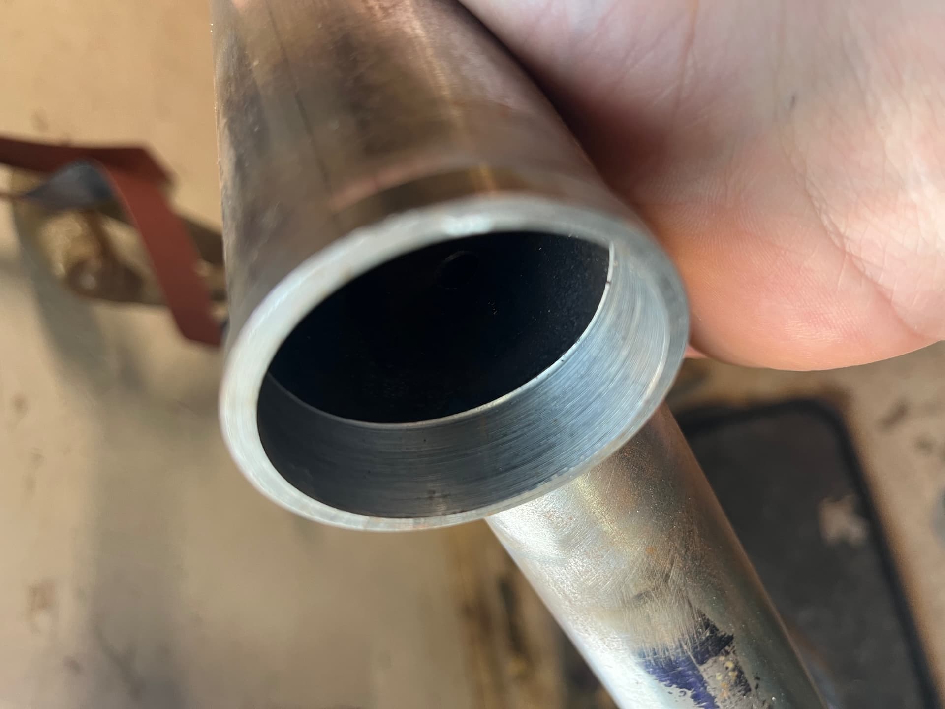

Please post a picture of a perfect surface finish on a large (greater than inch) bore that has been hand machined. I have never seen one. I agree that those in question don’t look great, but neither does this one on camera, and it was cut with a sharp, debris-free cutter, plenty of cutting fluid, and even forward pressure. Sincerely, Garage Hack

Look at any bicycle reaming operation how-to video on Youtube. ALL produce a surface finish like this. Lighting and camera angles make a big difference in how bad/good anything looks.
