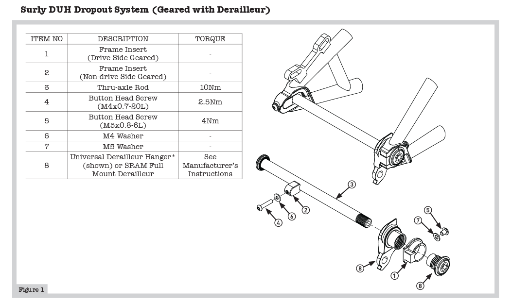

The DUH dropout system looks awesome! Who can pull strings and get Surly to sell these to frame builders? Am I correct in thinking that they used to sell some small components to builders?
The new avinox launch with the cylindrical battery got me kinda excited since Iāve been thinking of doing an ebike version of the lugged frame, but have been waiting on a good cylindrical battery option.
I guess MOQ on those units could be quite high though and getting the 3D models might be impossible for small builders. If anyone has any info on that it would be appreciated.
