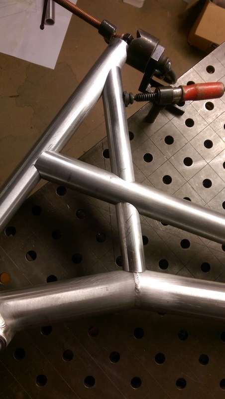

Always wanted an EWR and a Klein so I kind of built one. Far from perfect. Need a lot not practice but I do like it.
Will post more pics of the process

I like this a lot. I dig the brake rotor brace for the brake. Is it a spray can paint job? If so, you’re better with a rattle can than I am. Very cool. Very, very cool.
Yes rattle can. I can’t spend money on paint until I start doing a better job.
I does ride nice and did not break.
Is the ST/TT/DT brace a single tube or two pieces?

The brace tube goes through the top tube in one piece. It seemed to be a better approach structurally, but a PITA to actually make.

Mine is 2 pieces. I could never do the hole and not screw that up
