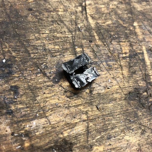

I am trying to silver braze (Harris safety-silv 55) some Paragon stainless cable guides to a stainless tube. Using type G flux. They will not “bond” with the filler metal. It sticks to the tube fine, but the cable guide just pops right off. Both parts were abrasively cleaned. Any ideas?
Maybe the cable guide is in fact titanium and not stainless?
I just tried a different flux (Harris Stay-Silv) and the exact same thing happened.
Had also tried welding one and there was some weird oxidation then a very loud “ping!” As soon as it started cooling.
I’m suspecting you are right.
Yep, slot size is only 1/8”
And they weigh 1.6g v 2.5g for the same part in steel.
