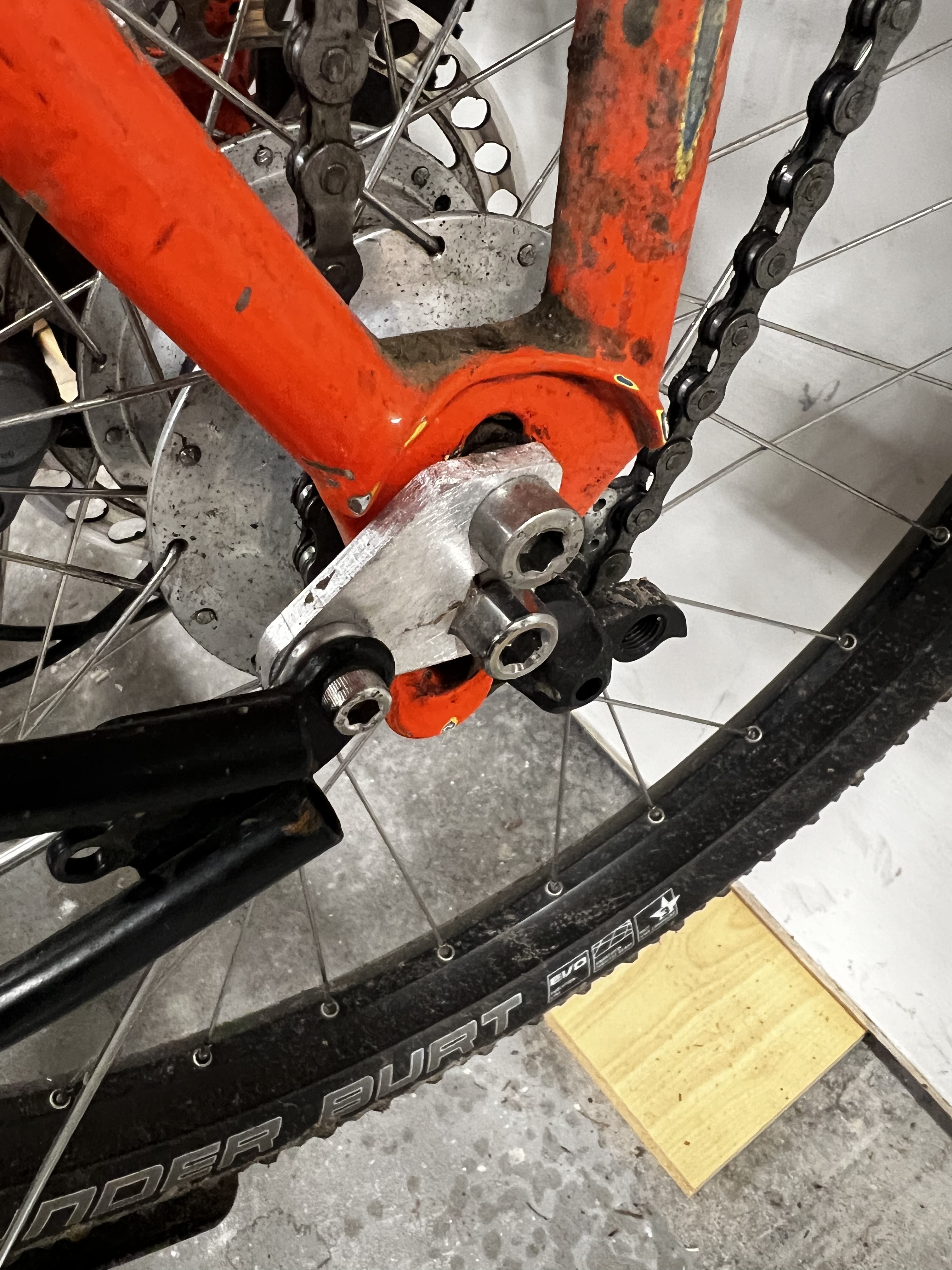

I’ve done two methods of adding an eyelet. On one bike I drilled and tapped some space in the sliding part. On the second bike I made some aluminum plates that slide with the sliders and add (ugly) eyelets. I don’t have a milling machine at the moment so it was crudely hand cut.
Both of these bikes have Rohloff Speedhubs. There isn’t much advantage in a slider if the bike will only be used with a derailleur.

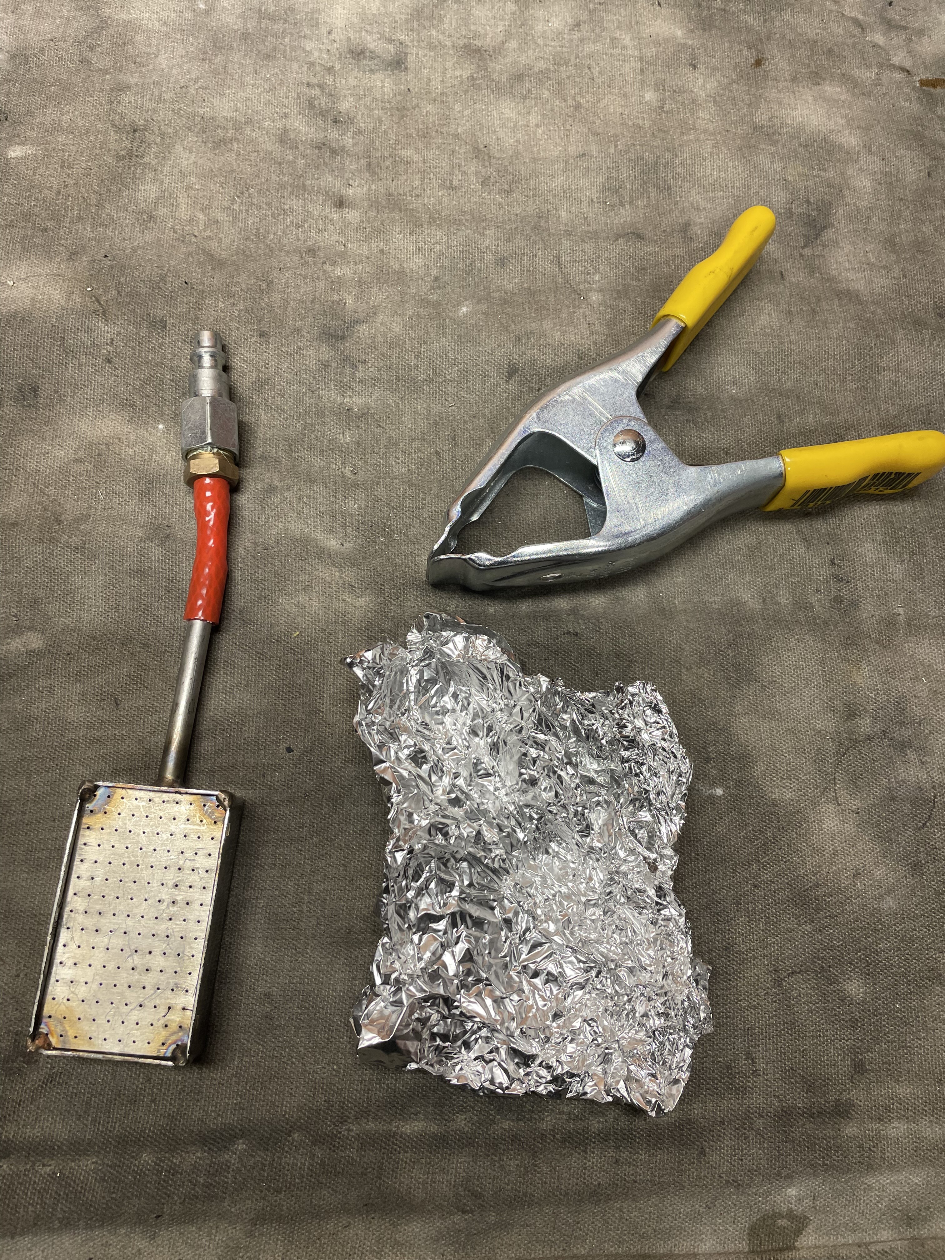

Sometimes you have to get creative. The thing to remember is your just trying to get the gas to stay put. Since argon is heavier than air you can imagine it behaves similarly to water.
I am going to build a diffuser. I think it could be really helpful in tight SS or CS joints.
Do you have any thoughts on sizes and shape after using one for a while? Anything you wish you knew before designing this one?
Keep the volume low so you don’t waste a bunch of gas to get it to flow.
