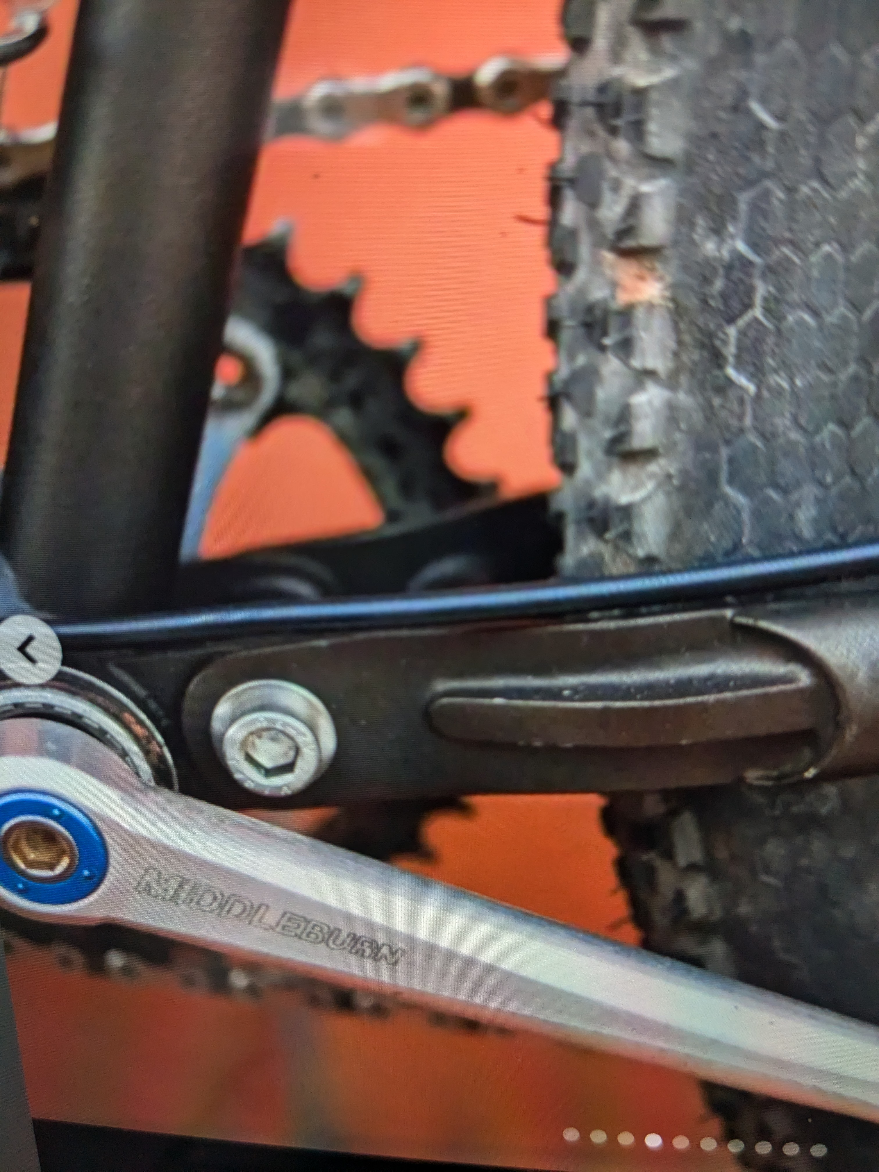

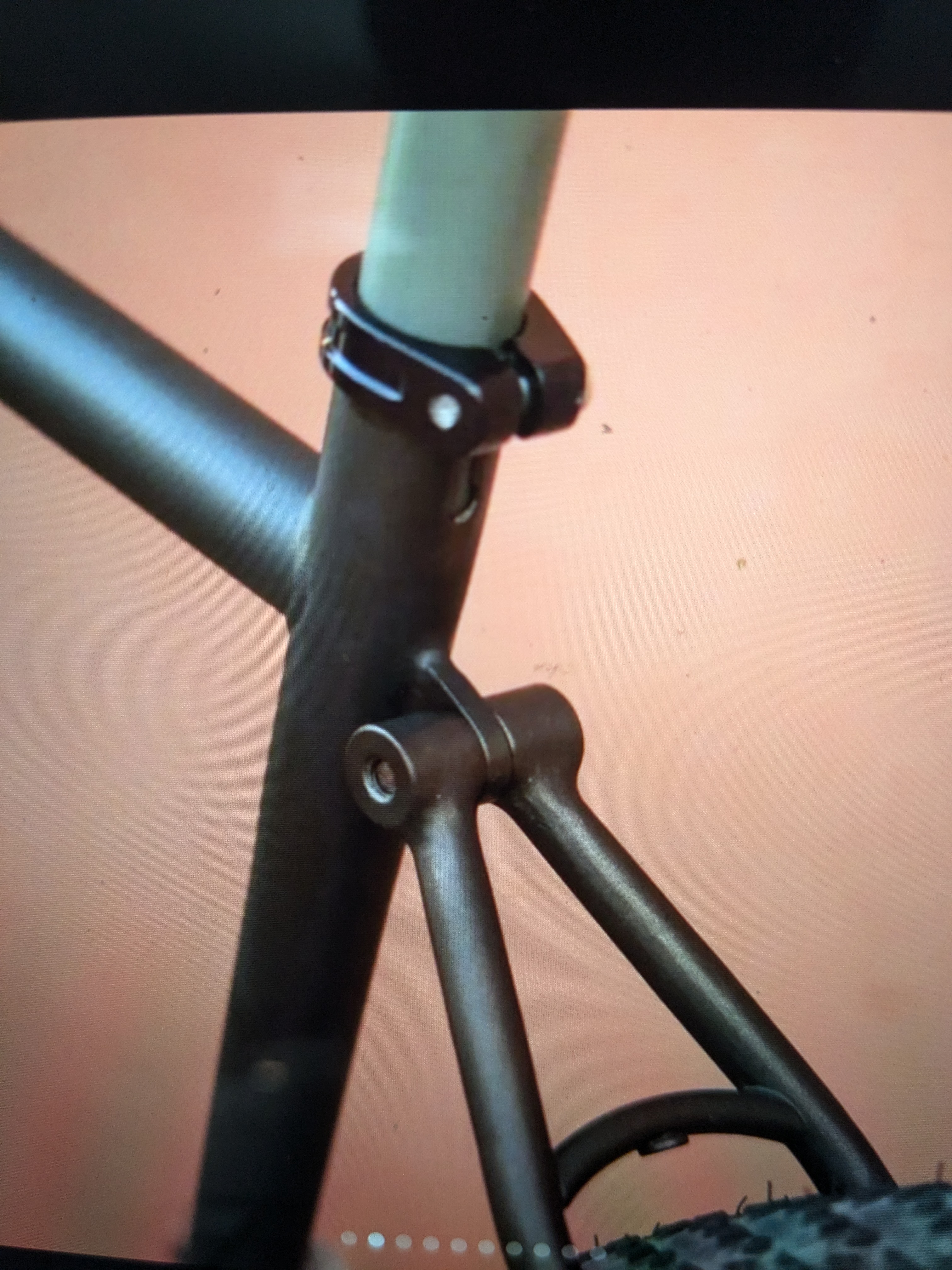

Ive seen other DIY options like these, which i could do but the tube in sleeve connection doesnt fill me with confidence and the bolted together rear end isnt as tidy as id like

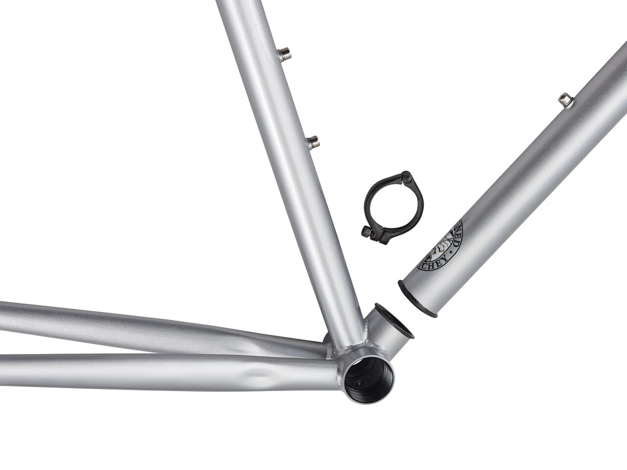

Is this going to be a one-off project, or do you plan on doing this more than once? A Ritchey-style collet system would be pretty simple to have a machine shop do for you. The clamp is a bit more complicated, but if you forgo the pivoting clamp in favor of bolts, it would be much more manageable:
If you contact some Asian CNC prototype shops, I would estimate they would charge ~$300-400USD for three coupler systems.

Id happily build a few so yeah it would be cool to get some machined. I was wary because i havent seen a ritchey clamp up close and wasnt sure exactly what the clamp looks like/what the interface between the clamp and lip looked like. Two bolt clamp would be fine by me i think.

I havent actually found any Ritchey systems for sale, but apparently you can get them directly from Ritchey in Europe without too much trouble. I guess you just pay shipping and import fees to get them here.

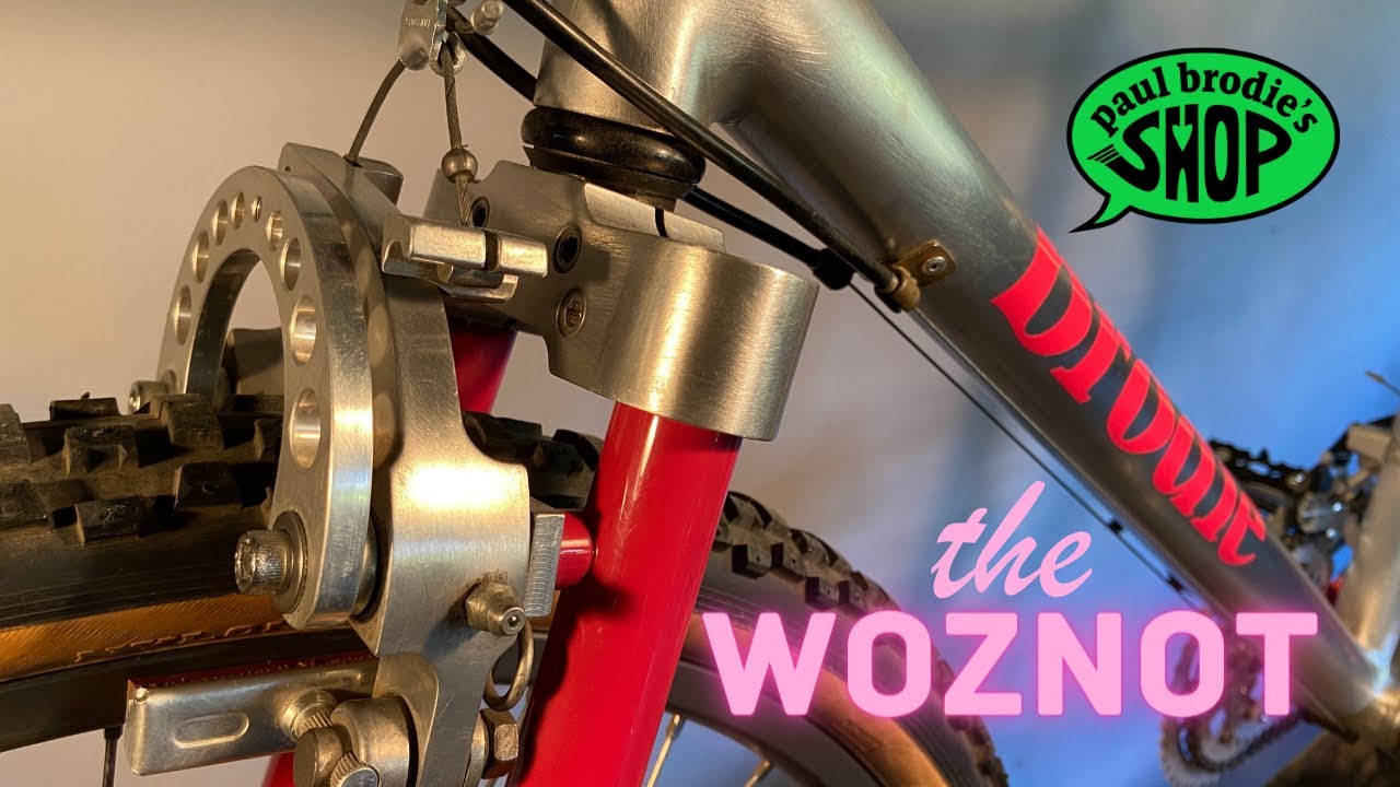

If you are looking for ideas on a break-away solution, check this one:
Ahh that’s a big one yeah.
