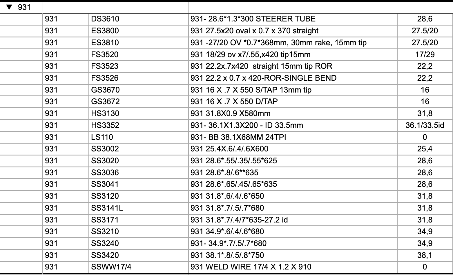

sure, contact I have is Joe, was super helpful and the email address I used was jmccrink@kvastainless.com was a good few days sometimes between replies so not sure he’s on it full time maybe? I was in touch over a year ago with them too on the same email address, didn’t buy tubes that time but i remember it was always a good few days between contact then as well. Not sure if you have the latest tube guide but I did find that the tubes he had in stock didn’t really match the guide
MS3_Product List_110221.pdf (281.4 KB)
