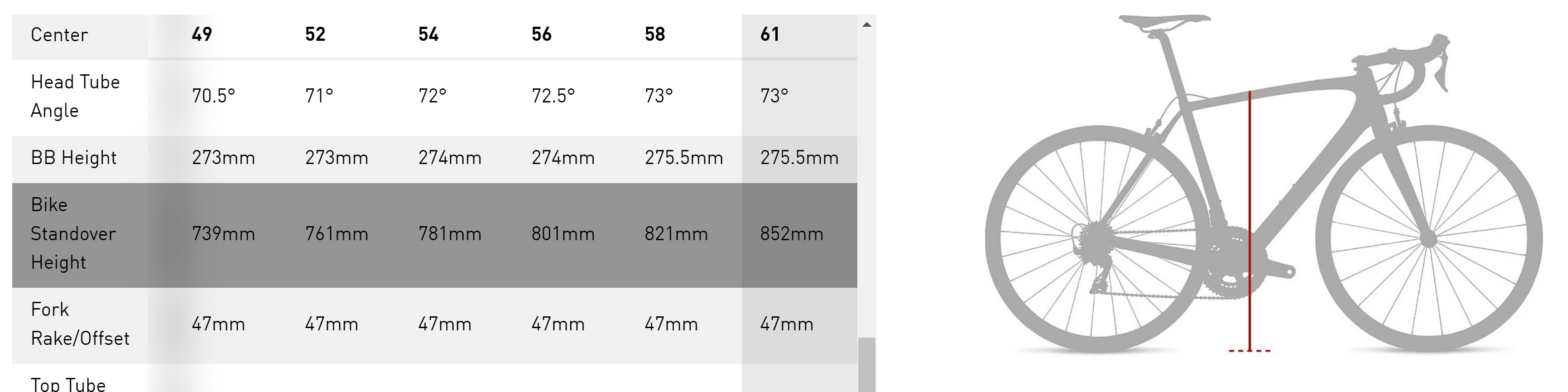

Compare that to the current Specialized standover dims.
Seems like standover was (more) correlated to TT length at one point.
