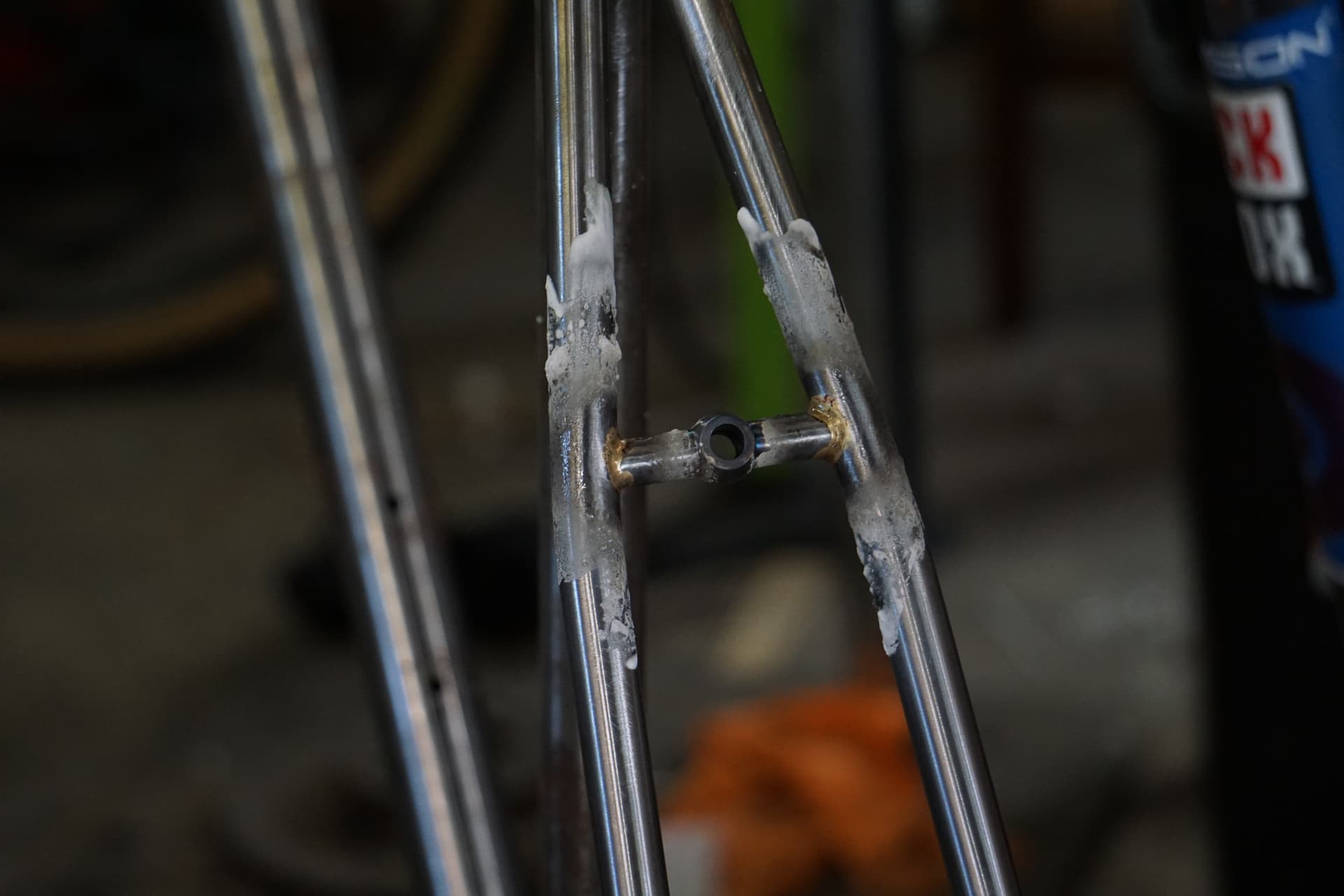

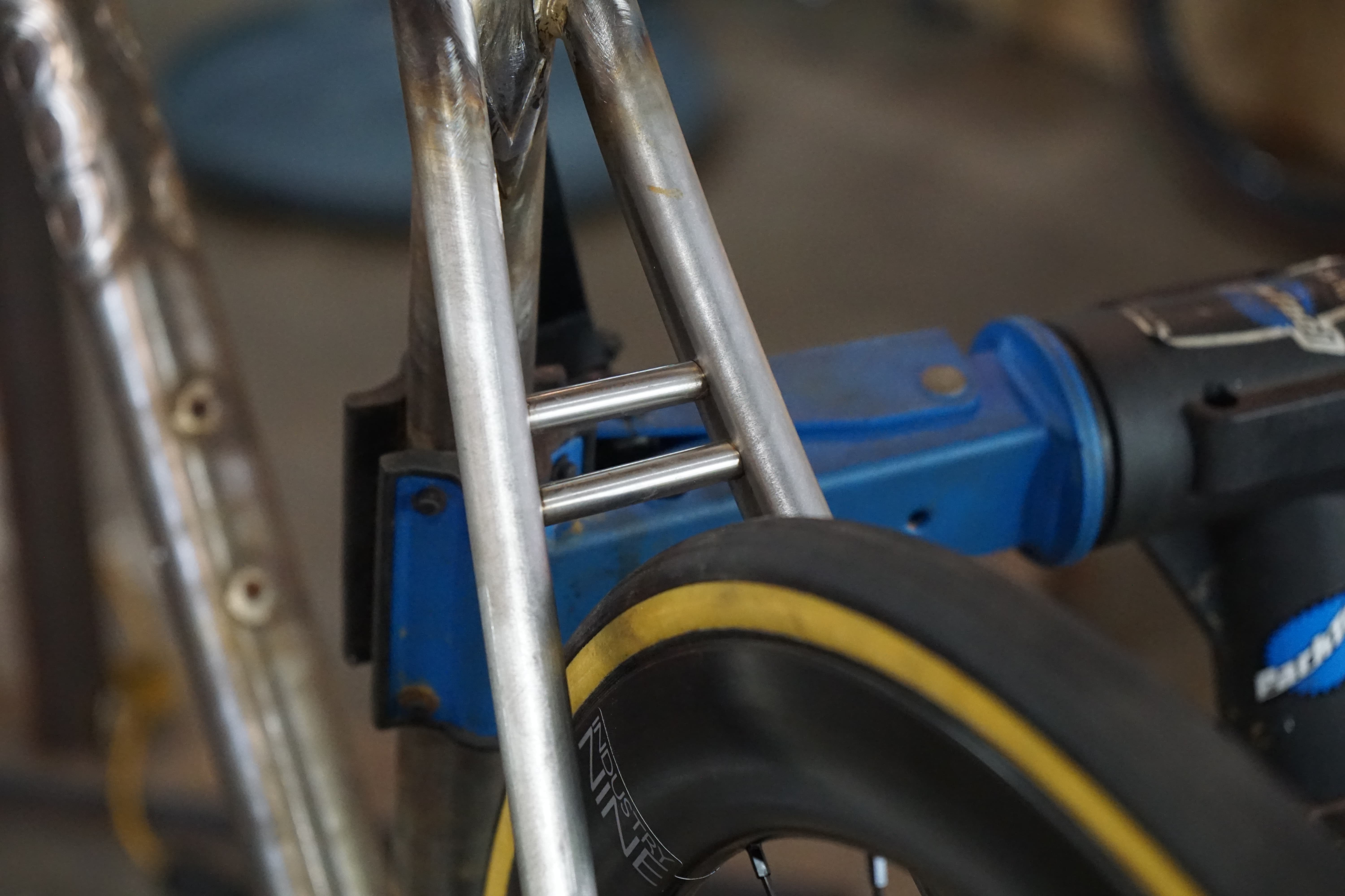

Chainstay toobz

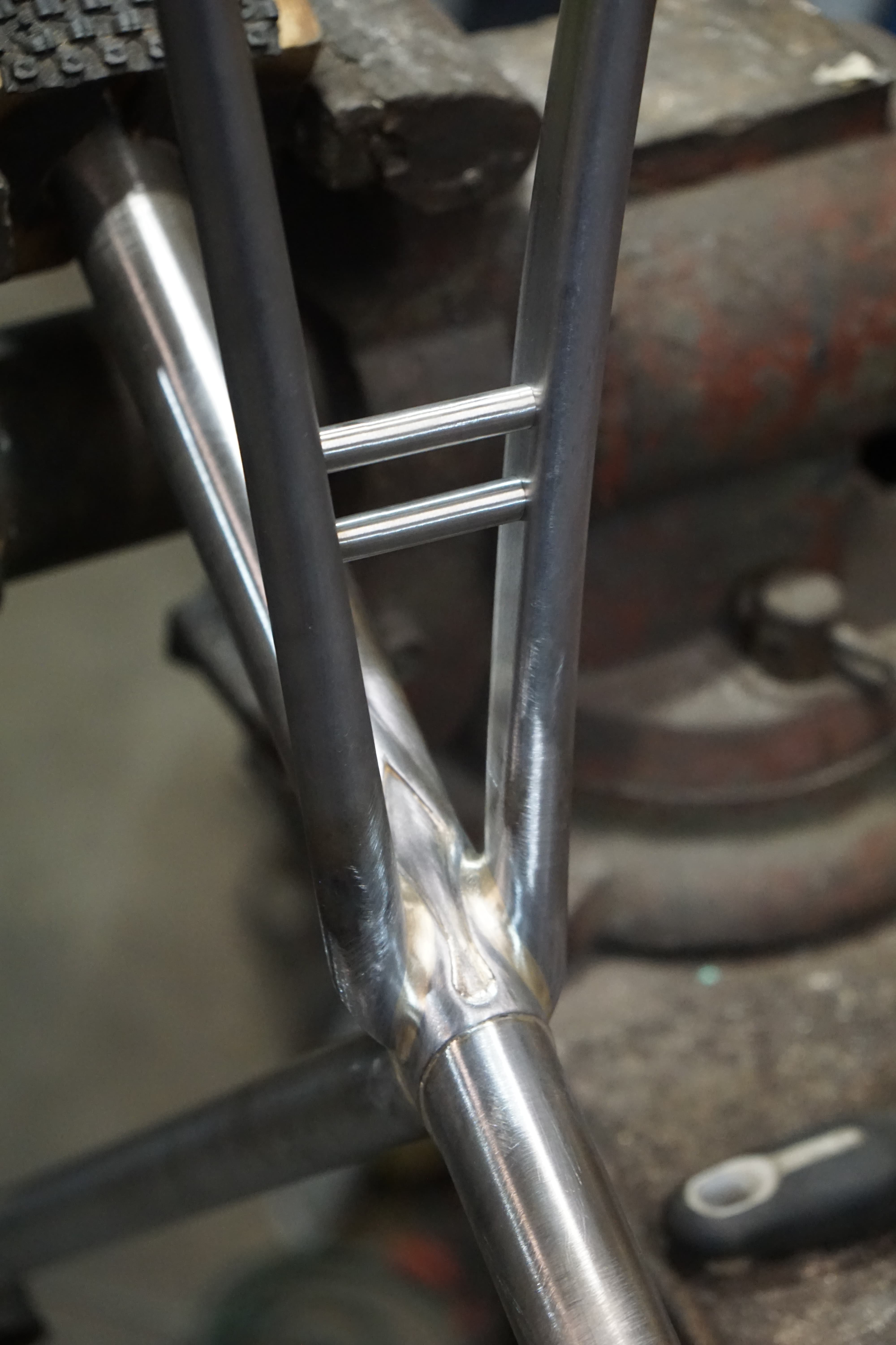

Some raw fillets

Sketchy sanding
Final form

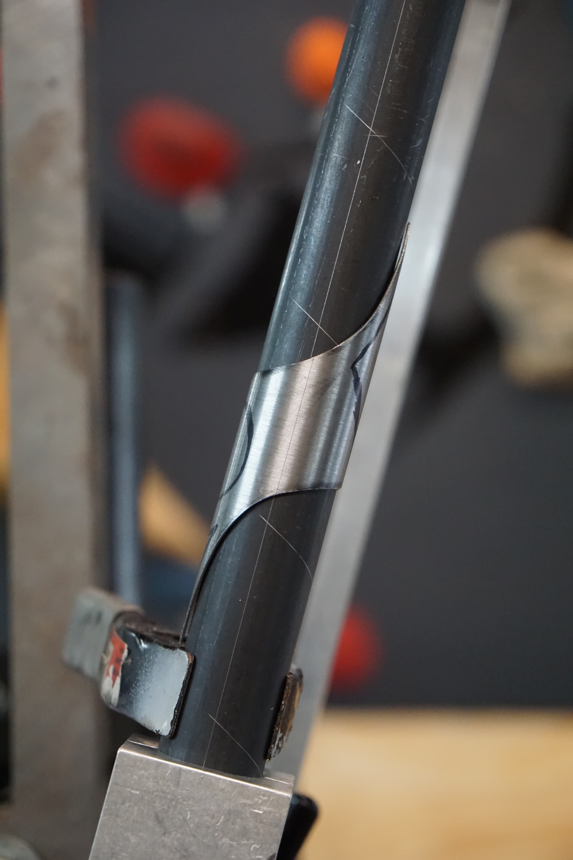

How do you hold the ovalized top tube for mitering?
As long as the oval is pretty uniform throughout the tube, a v-block will hold both miters in phase.
Fortunately, my tube notcher’s vise is essentially a v-block

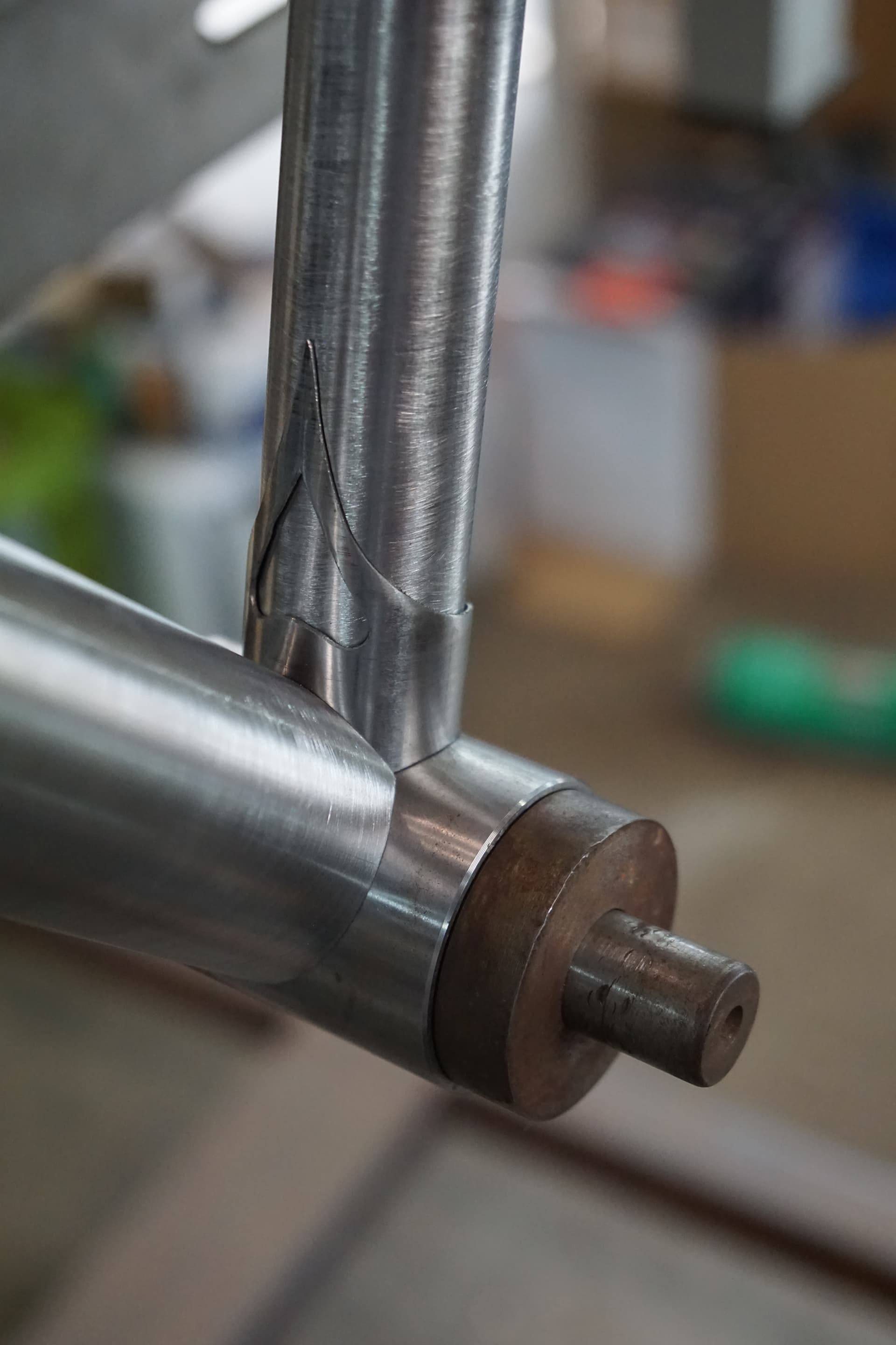

First time doing any sort of sleeve/bilam stuff
First seatmast and topper
Maggie performing the olfactory inspection

What ID/OD were you using for the topper and the seat tube? I have been eyeing glued-in seat tubes. Do you have any thoughts on the ISP designs?
I believe the seatmast was 1.25"(31.8mm). x.035"
The sleeves were 1.375" (35mm) x .058 - ID 1.259 (if i recall, i turned down the OD to shave some beef)
The topper was 1.375" x .049 - ID 1.277 to leave some extra room for paint.
I normally powder coat all my frames, but this one was wet painted and clamping the topper left blemishes. If I seatmast again, it will be carbon or at least have some sort of stainless upper for the topper to clamp on without harming the paint.
Perhaps powder could hold up to the clamping but it is often thicker, risking the topper wont even fit.
I’ve been wanting to do a carbon mast for some time, I think there’s a road bike in my queue that might get the treatment this year!

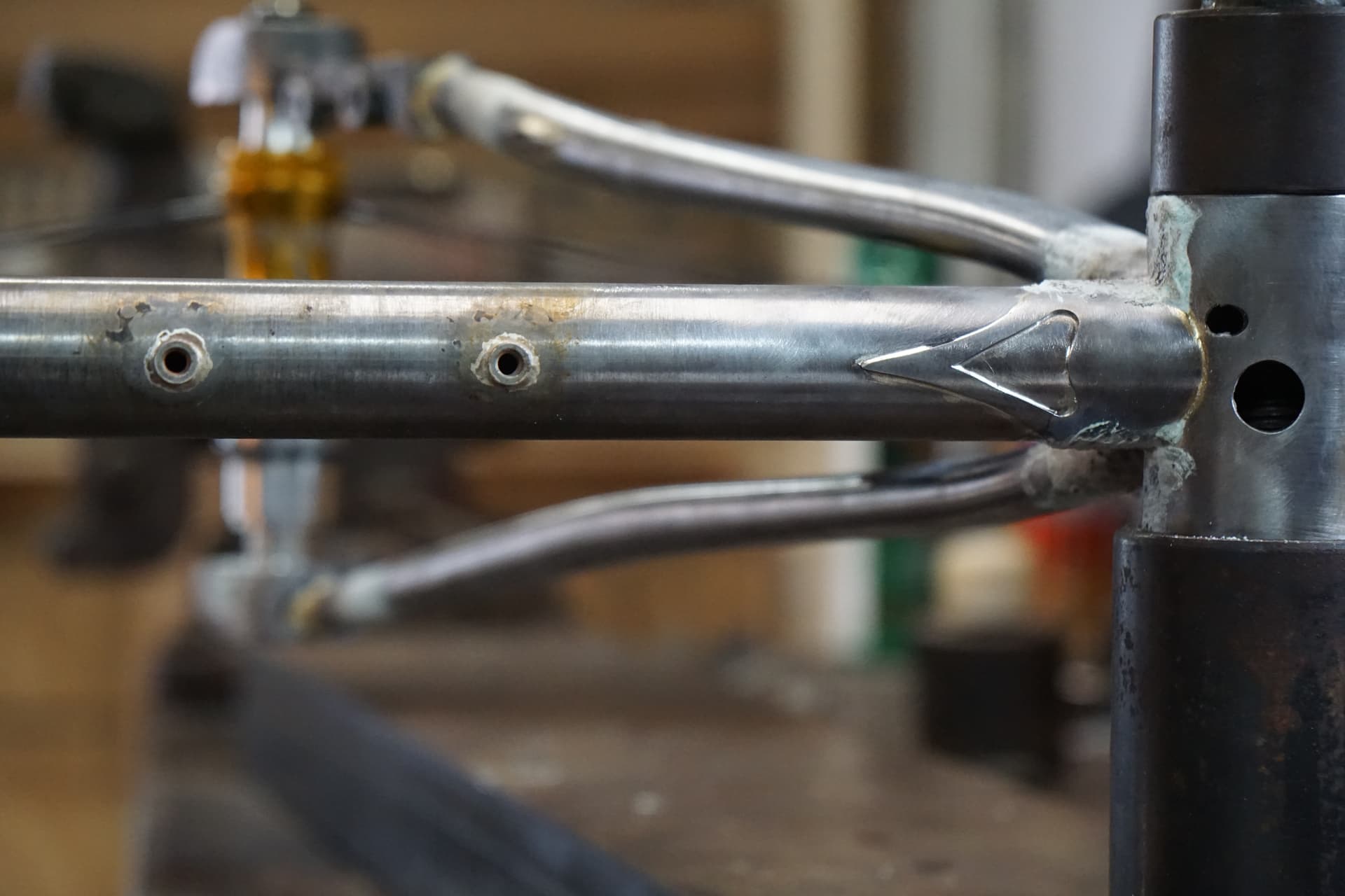

Damn that thing is sexy. The polished branding really pops! What tubing are you using for your internal cable routing?
Thank you!
These are 304 Stainless. .25"OD, .21"ID. 12$ for a 6’ stick from Grainger.
This will tightly fit shimano and sram hydro lines BUT NOT TRP, they use some chonky 5.5mm lines.
Nice, that’s a pretty solid deal. Good call on watching out for the chonky lines. I’m in the middle of a build with some hayes brakes that also use the chonky lines.

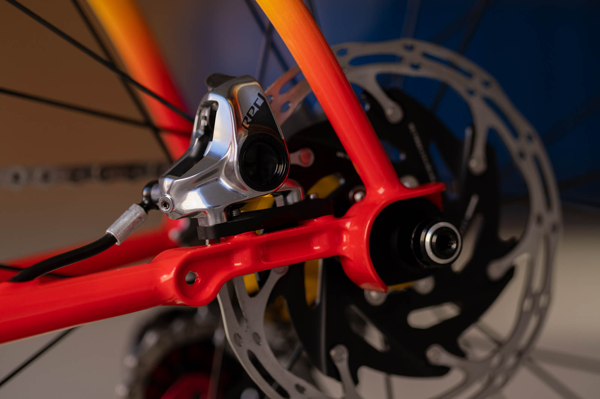

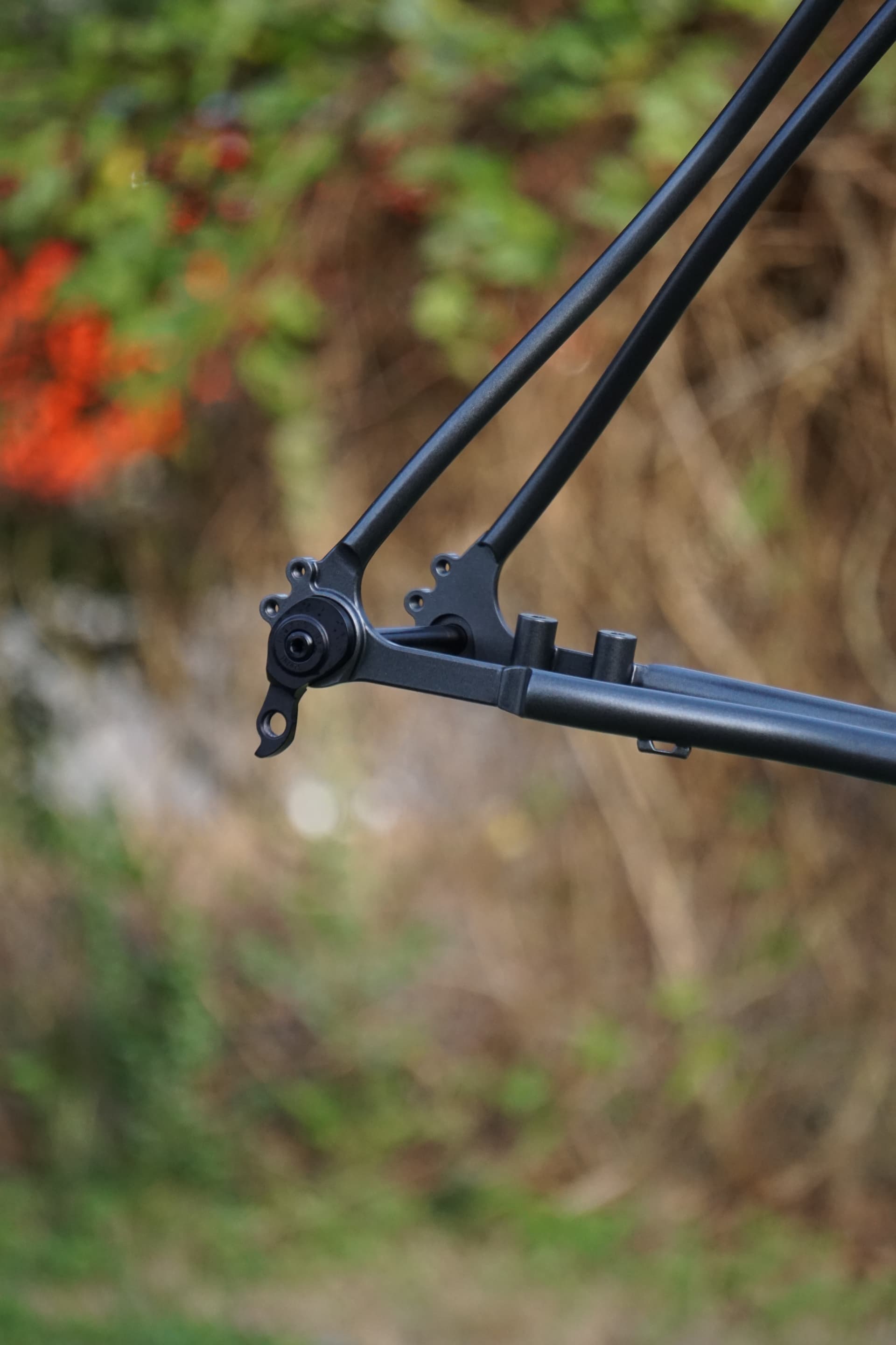

What dropouts are those, BFS?
Yup! These…
However, after working with them on this bike and some others, I’m not a huge fan. The way the inserts mate to the body made for trouble when trying to align the dropouts. There aren’t any screws on the back half of the insert and it felt like I was bending the inserts rather than moving the dropout body.
