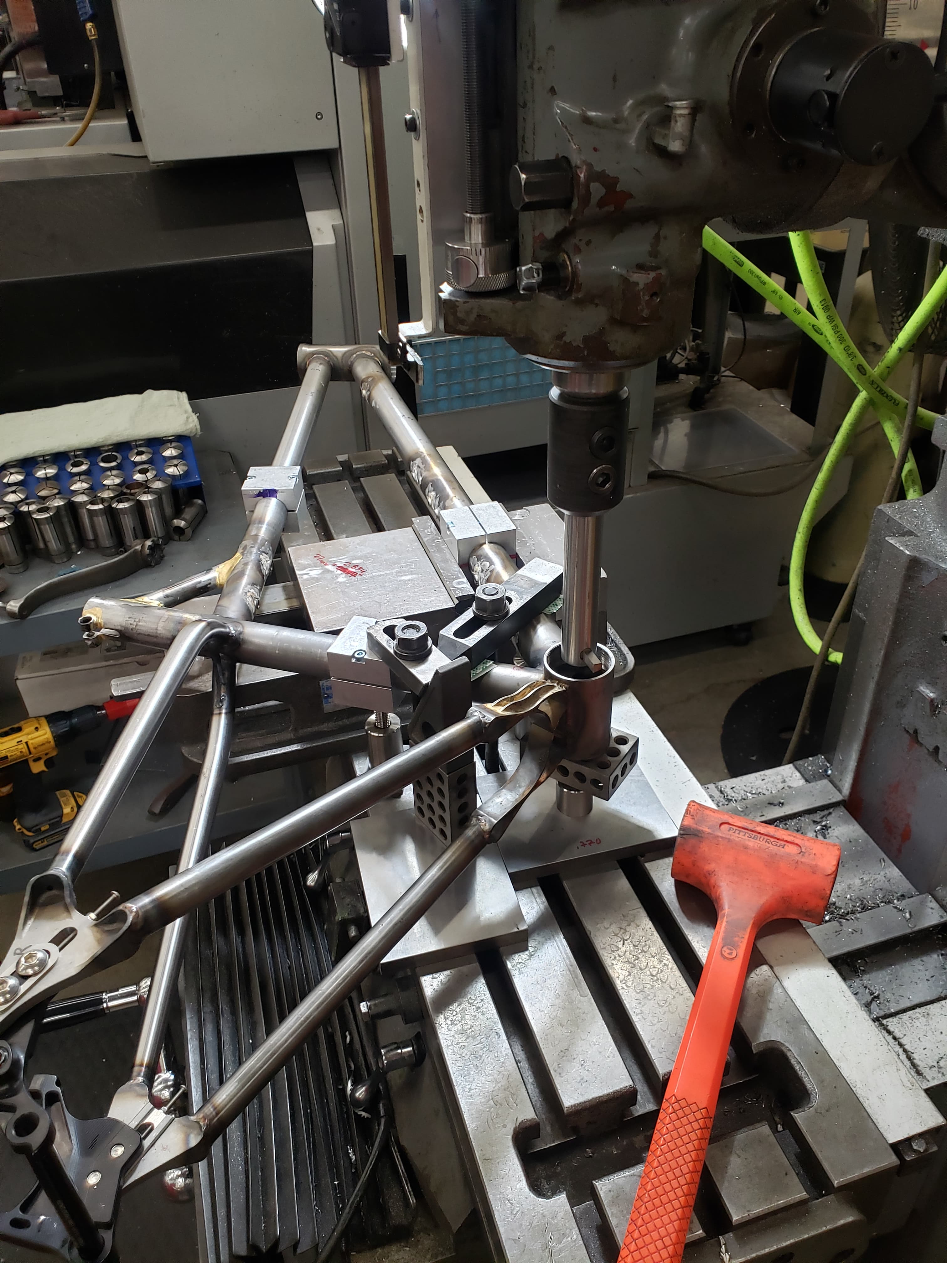

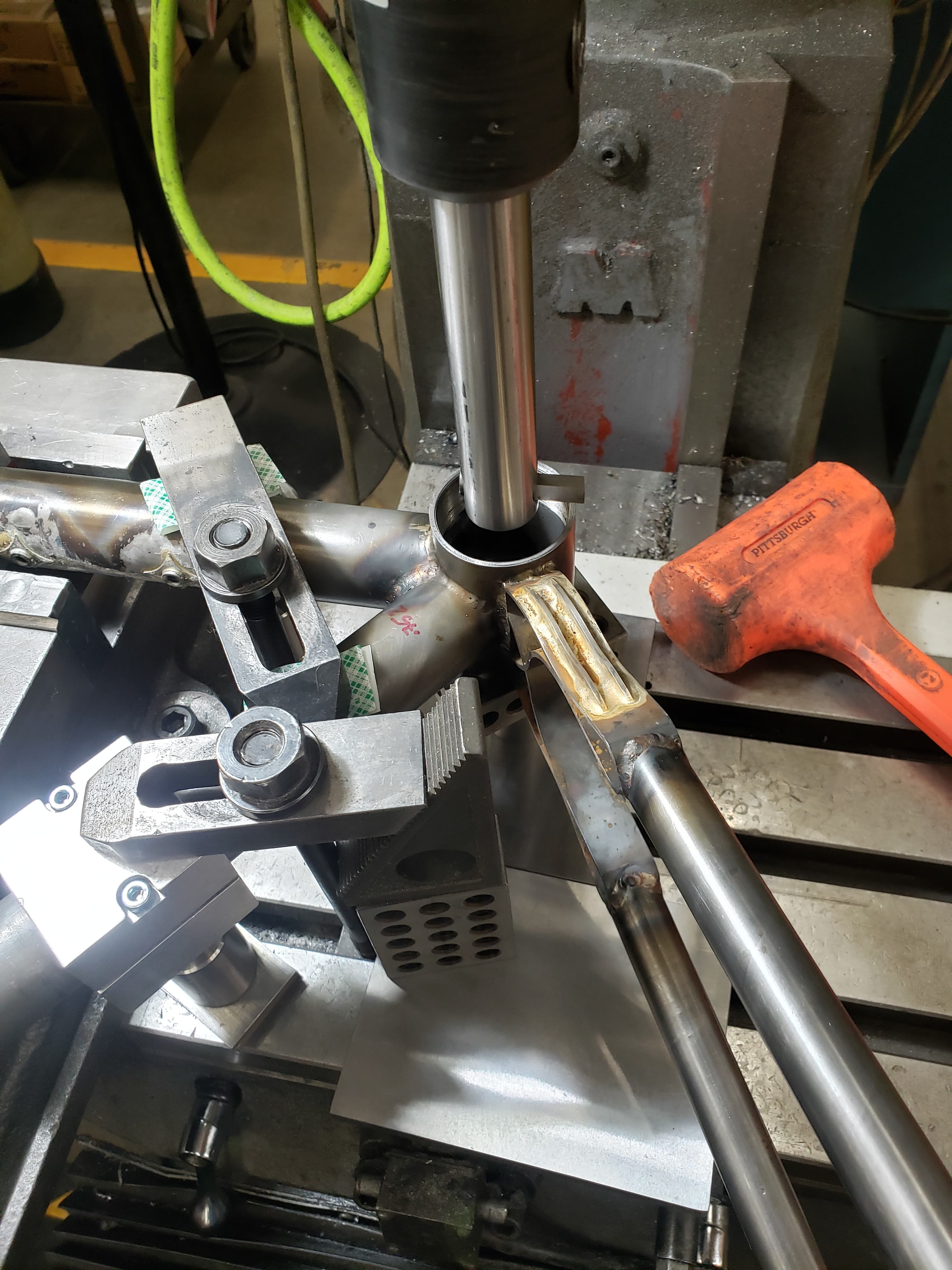

I ended up getting it done on the bridgeport. Went through the tool drawers and couldn’t find anything that quite worked. I ended up making up a single flute boring tool with a flat face and parallel cutting edges top and bottom.
Facing the top side was easy but the bottom side squealed and chattered a bit but cleaned up fine with a flat stone. Took some setup and made me wish I had a horizontal mill but I got my dimensions within .001"

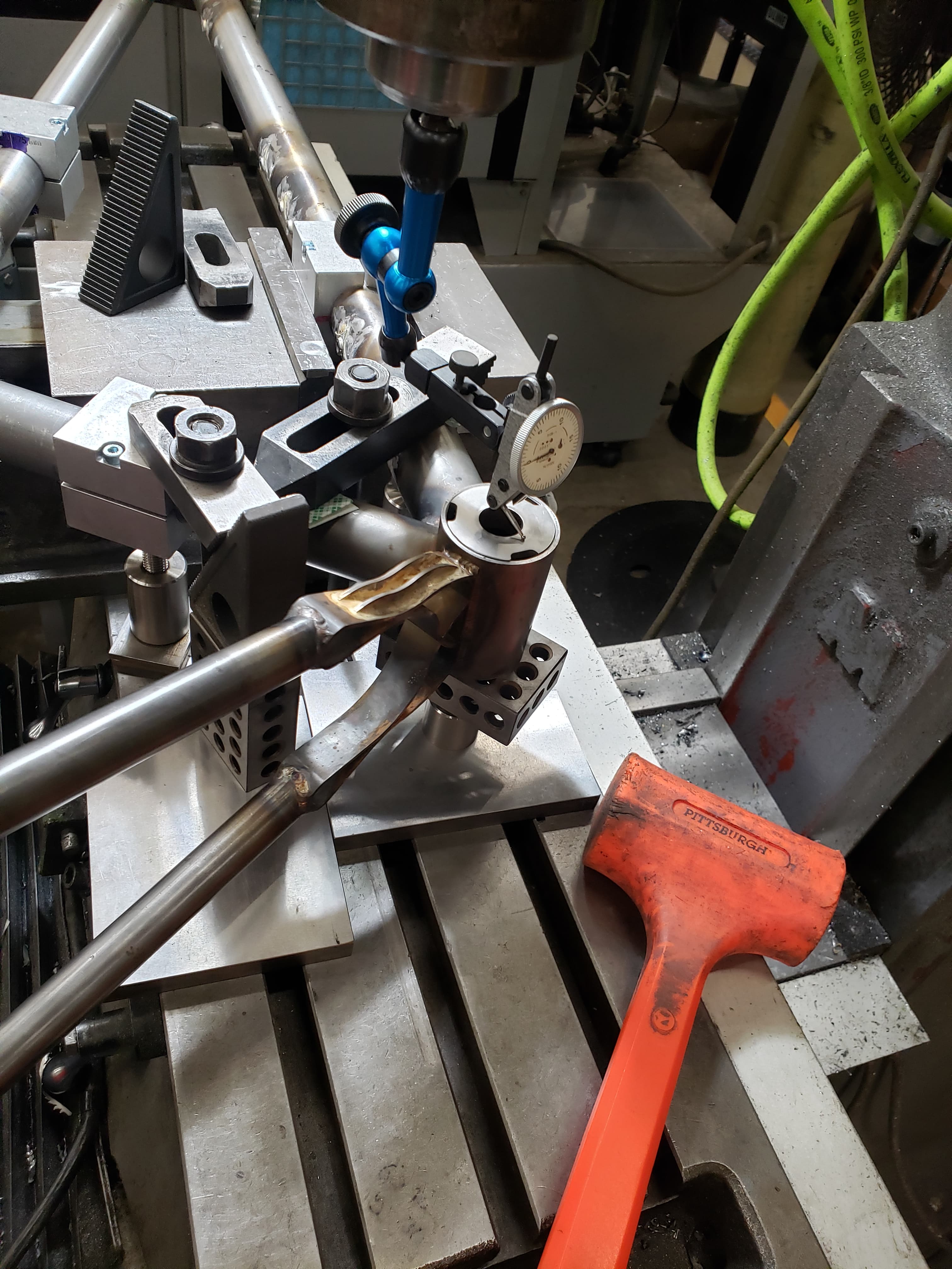

I know this was from a while ago but it’s peaked my interest. How are you reference the horizontalness (is that word?) of the frame on the table? Are you referencing off the top face of a tap in the BB or is that a tool you’ve made to go inside the BB?
That piece you see inside the BB is my shop made T47 tap. The faces are ground so I dialed off of that and then also swept vertically on the outside of the BB shell to double check my initial sweep. I think I got it all really parallel.
