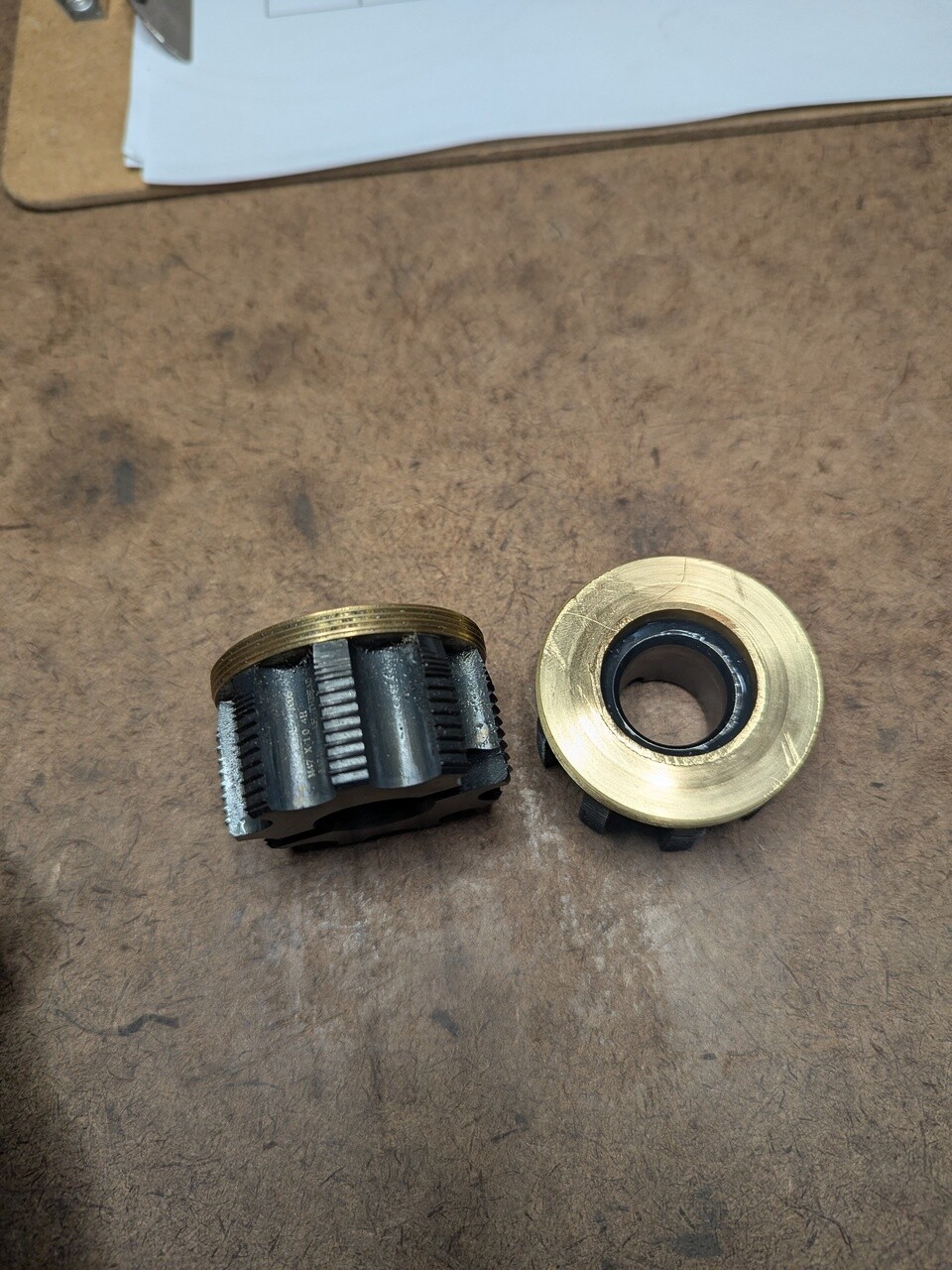

Thanks Andrew. I was thinking something similar, how it’d be nice to somehow use a thread gauge to project the threads upward toward the tap and that idea quickly evolved into adding a full thread pilot plug on the taps.
I made some undersized 47x1 right and left threaded guides from brass. Bonded each to the face of a tap while aligned together in the threads of a fresh shell. Zero stress or worry of any misalignment now.
If anybody finds this useful then I’d be happy to make a couple more. Learned a few lessons making these!
Really smart!!! I had thought about using a lock ring but that is so old school and I knew of no T47 lockrings, of either thread direction:) I recently watched a vid about using LockTite to bond a work piece to a mandrel for machining. Never thought I’d see it used in the bike world. Andy
