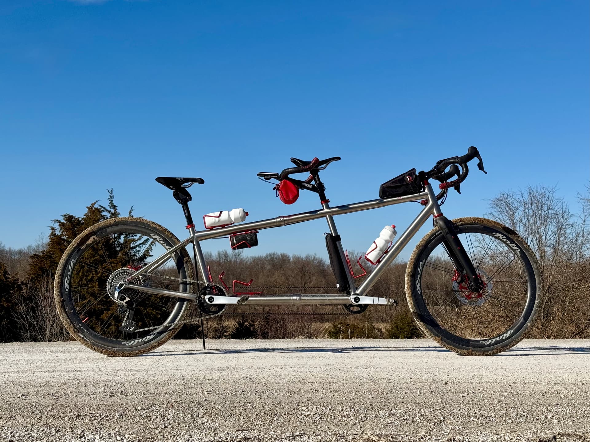

So, thought I’d follow up with my own thread.
Bike was built up in January/February and has been ridden a few times now.
Bike is near perfect. Comfortable on gravel & road on 45c gravel tires (still need to ride on 30c road tires). I can tell the frame has some compliance in it. Isn’t nearly as stiff as my old Cannondale tandem. Once I get more free time I’ll try to do a back to back ride to do a better comparison on ride feel.
