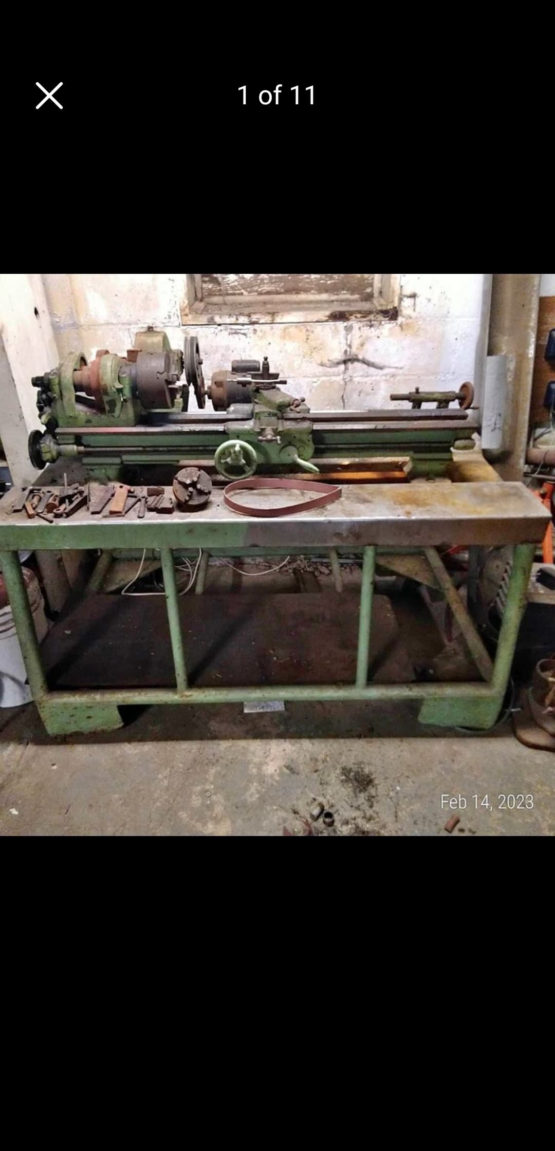

Also here is a picture of an old lathe for sale near me for $500 without a tailstock.

I’d get a lathe without hesitation first. The extra ability and capacity it gives you far surpasses the initial cost of it and you guys get them cheap in the US. I paid Aus$7500 for my last one and I use it everyday I’m in the work shop from frame parts to making jigs and tools for building.
If you have the money and space for a lathe, go that way.
Otherwise, KMS is currently running a sale on their JD2 style tube notchers.
$300 cad
$200 cad
In the us a decent lathe starts at around $2k. But if you can find one for $500 and have the space, do it!
Machine pricing in the US is highly regional. Friends like Drew at Engin (Philadelphia) and now Eva at Liberation (Pittsburgh) find stuff for half the price of what it would be in Seattle, and with a lot more selection.
Sometimes you get lucky. I got my Emco 10” lathe for $1200 in Seattle because the seller was moving in 5 days and just needed it gone.
$2k is probably the normal floor for a lathe in Seattle that can fit a steerer tube into the headstock (a very useful feature if you build forks).
If the OP lives in the land of cheap lathes I would get one for sure. Find one with the most tooling that you can, finding a tailstock for a 50 year old lathe is no fun. If space is tight also be picky about footprint, I moved from a South Bend 9A to my Emco Compact 10 because it takes less than half the floor space with similar capabilities (and fits steerers in the headstock). I’m putting stuff back together for making frames and intend to miter on my lathe.
I’ll jump on the buy a lathe train. They have so many uses around the house or shop outside of Framebuilding.
