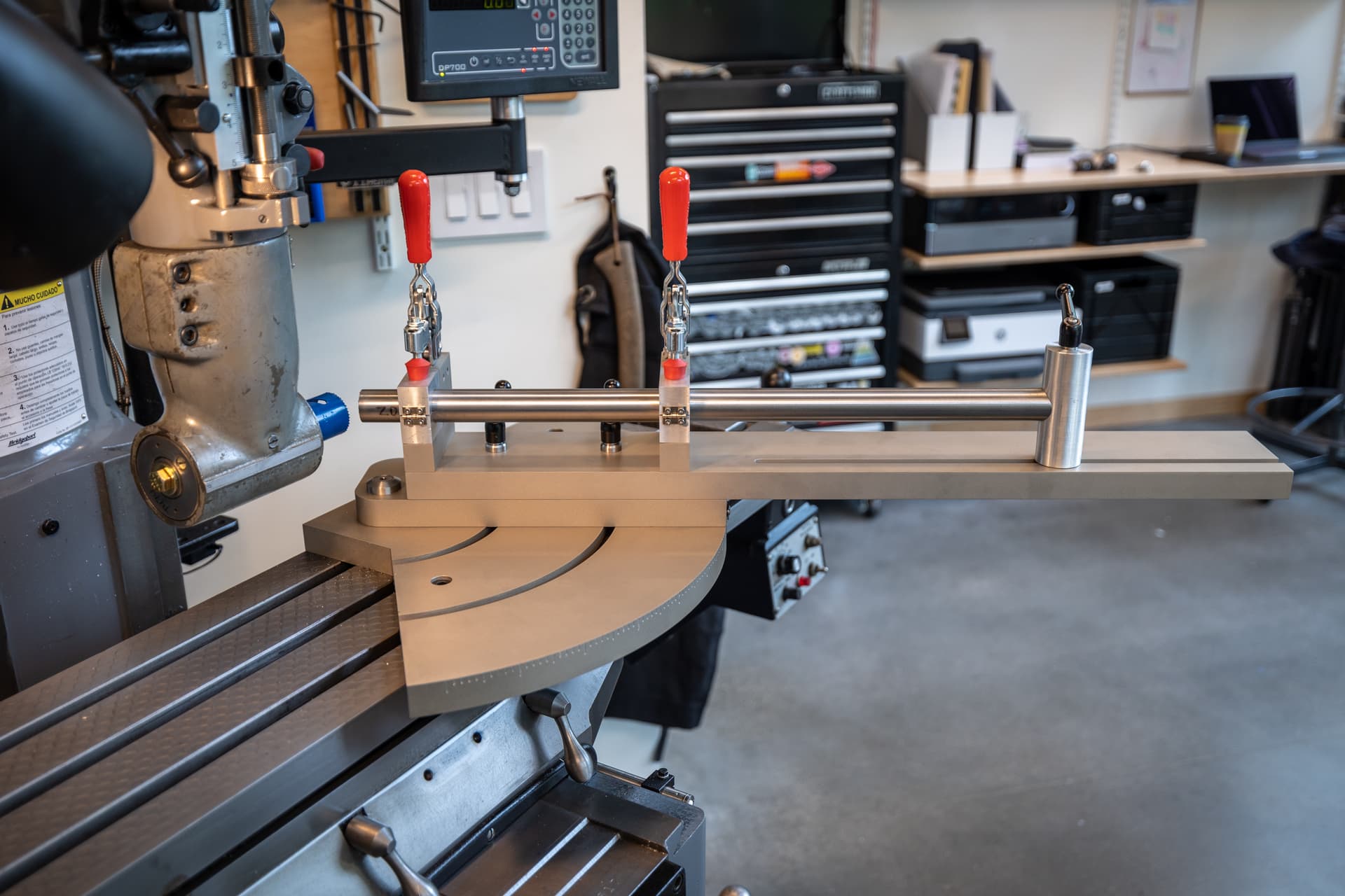

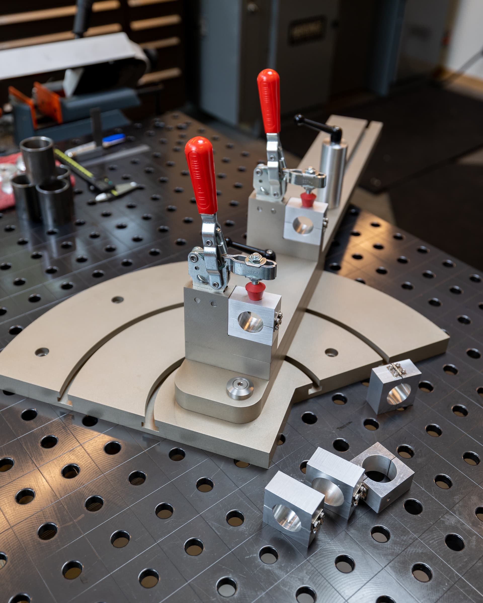

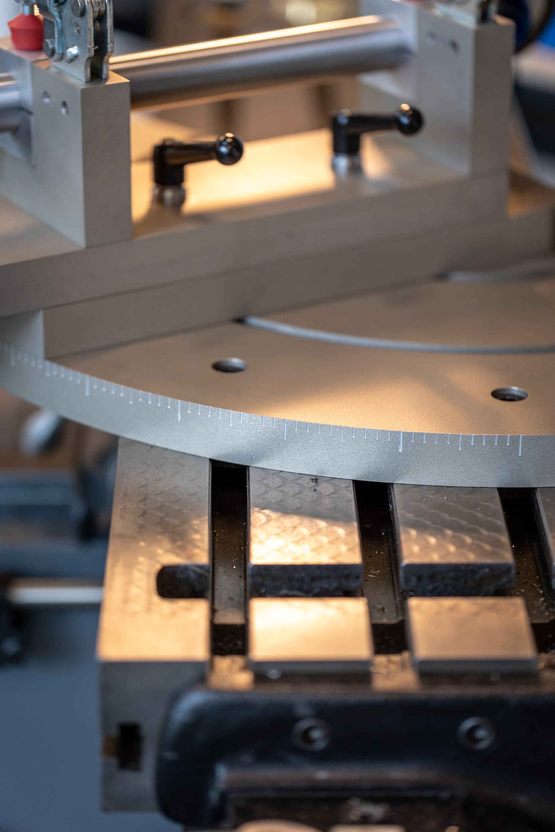

Thought I’d share this here… Just finished this fixture this week. (It’s my first manual machining project, so don’t judge too harshly!)
This is based on an Oscar/Simple/Cielo/Chris King design that I used a BUNCH in the last few years (and grew to really love). Haven’t seen another setup quite like this. Those versions were mounted on dedicated Hardinge TM-UM mills. If I ever end up making more than a couple bikes a year at home, I would love to have one of those little mills. For now, this is going to sit on the end of my variable speed Bridgeport. A little more setup than the typical tube-block-in-a-vise Bridgeport mitering, but super worth it I think.
Anyway, pretty easy to make (if I can do it anybody can!) and makes really nice cuts with the usual Rockhard hole saws. With the variable head and auto feed on the table, you can play with feeds and speeds to your heart’s content.
-Chris
Thanks for sharing. I have never seen a mitering setup like this. Very cool. It seems extremely accurate due to the large radius.
Autofeed is a nice touch, what a luxury!
