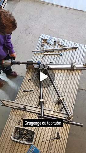

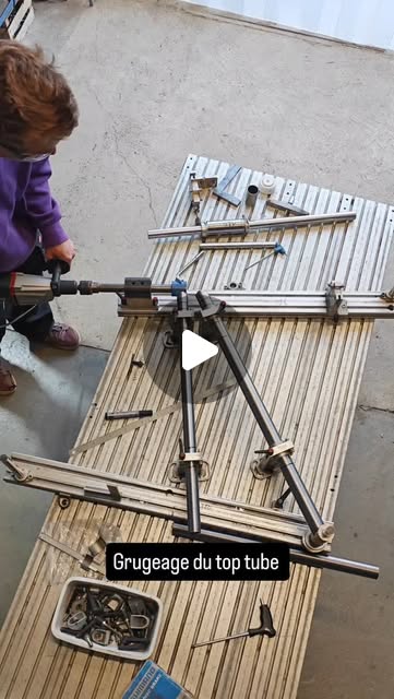

The mighty miter
This setup is pretty cool, I can’t say I’ve seen anything like it
Have you used it?
I have a cheaper one but same concept. When I try to miter a tube it just catches and shreds the tube apart. Can’t figure out what I’m doing wrong
I have used something similar without issues, that said, the chain holder may not work well with our thin tubing.
If your saw catches the tubing it may be because you are using too much force or maybe it’s not that sharp anymore. I use fine tooth hole saw and I have better results vs the classic coarse ones.
