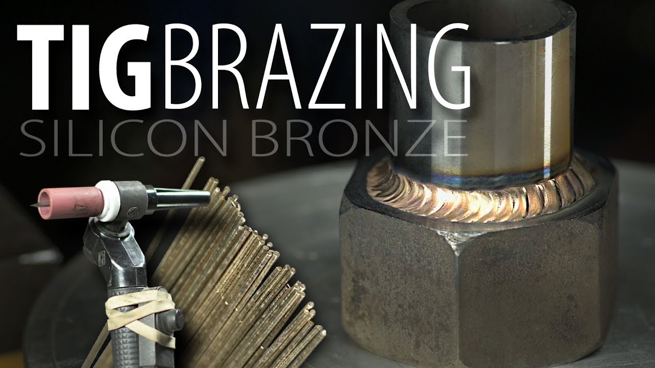

Thanks for the video link. I’m glad I watched it because at the end he says “don’t use bronze made for gas brazing”, which is exactly what I would have done!
I TIG braze those things. Yes you could tack them with weld but I usually don’t like to put weld anywhere the tube isn’t specifically thickened like at the butted ends etc. The exception is I do weld v-brake posts rather than braze them just because you know brakes, safety. I’m sure brazing would be fine though.
That will make a lot of smoke and a nasty mess! I use SIFSILCOPPER 968 rods (but that may be a UK thing). You want silicon bronze that is meant for TIG.
