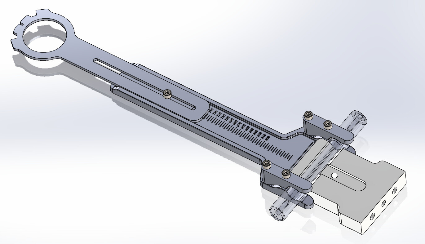

I’ve shared pictures of my 3D printed tire clearance checker tool in the DIY thread and have since been asked a few times to share it so here we go!
It is designed to clip around any dummy axle holder that works with anvil/paragon dummy axles and the tire in there is something like a magic mary.

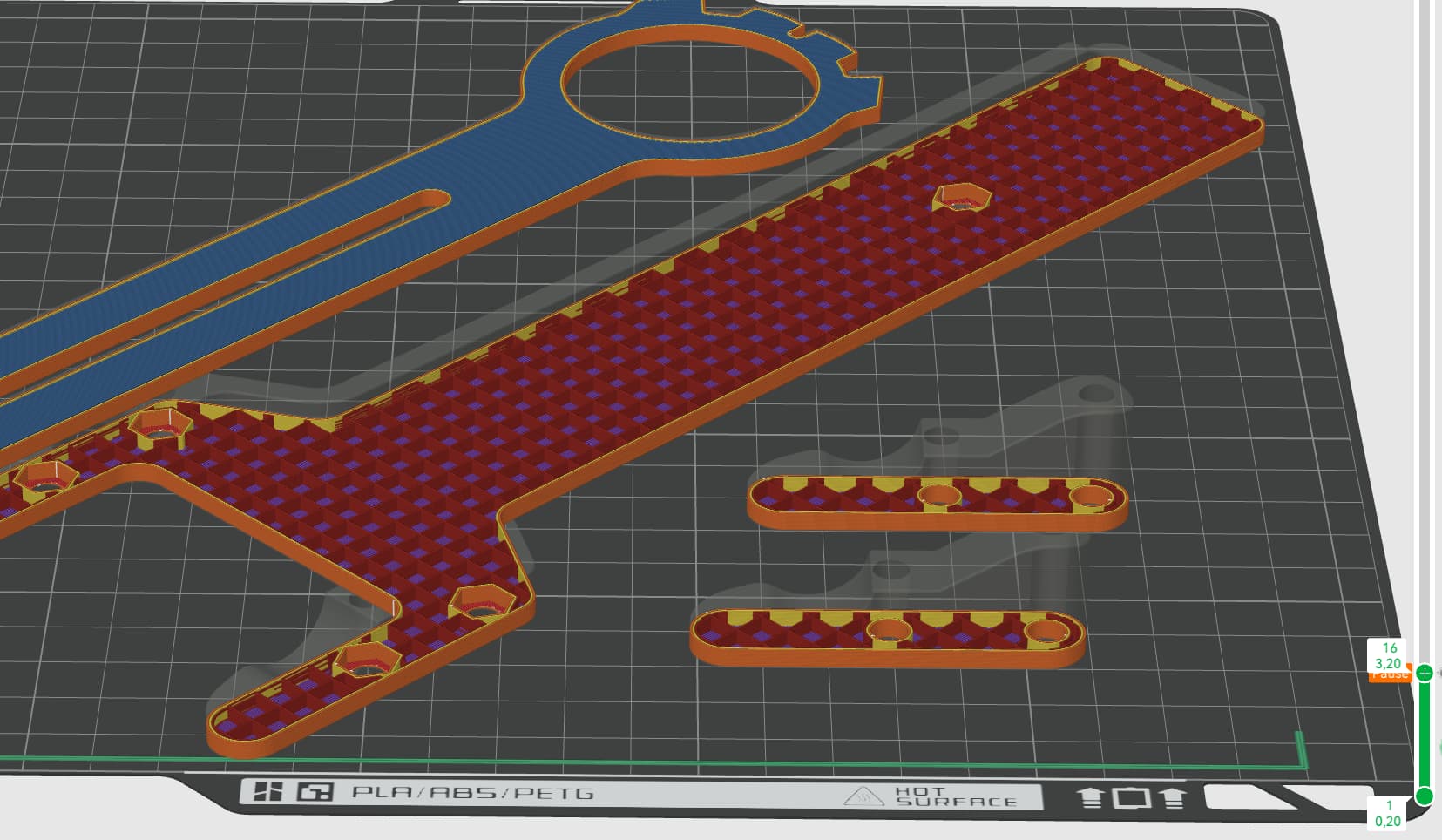

I left cavities for flat (not standard height!) metal nuts in the base plate. You’ll have to pause the print before it reaches the top layer of these, insert the nuts and continue the print. As you can see, it JUST about fits a regular bambulab printer!
The nuts this is designed for are obviously not freedom sized but metric (ISO4036 M4)

tire_clearance_tool.STEP (6.8 MB)
