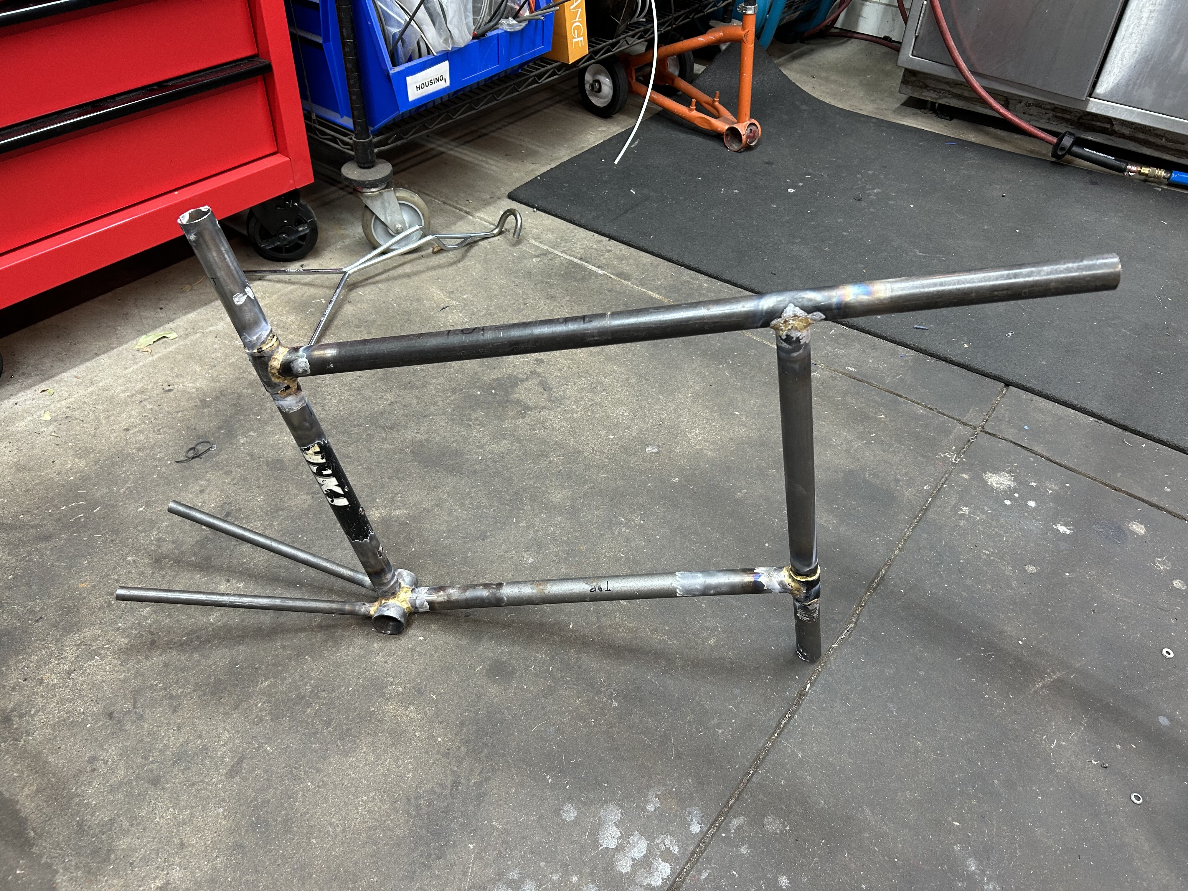

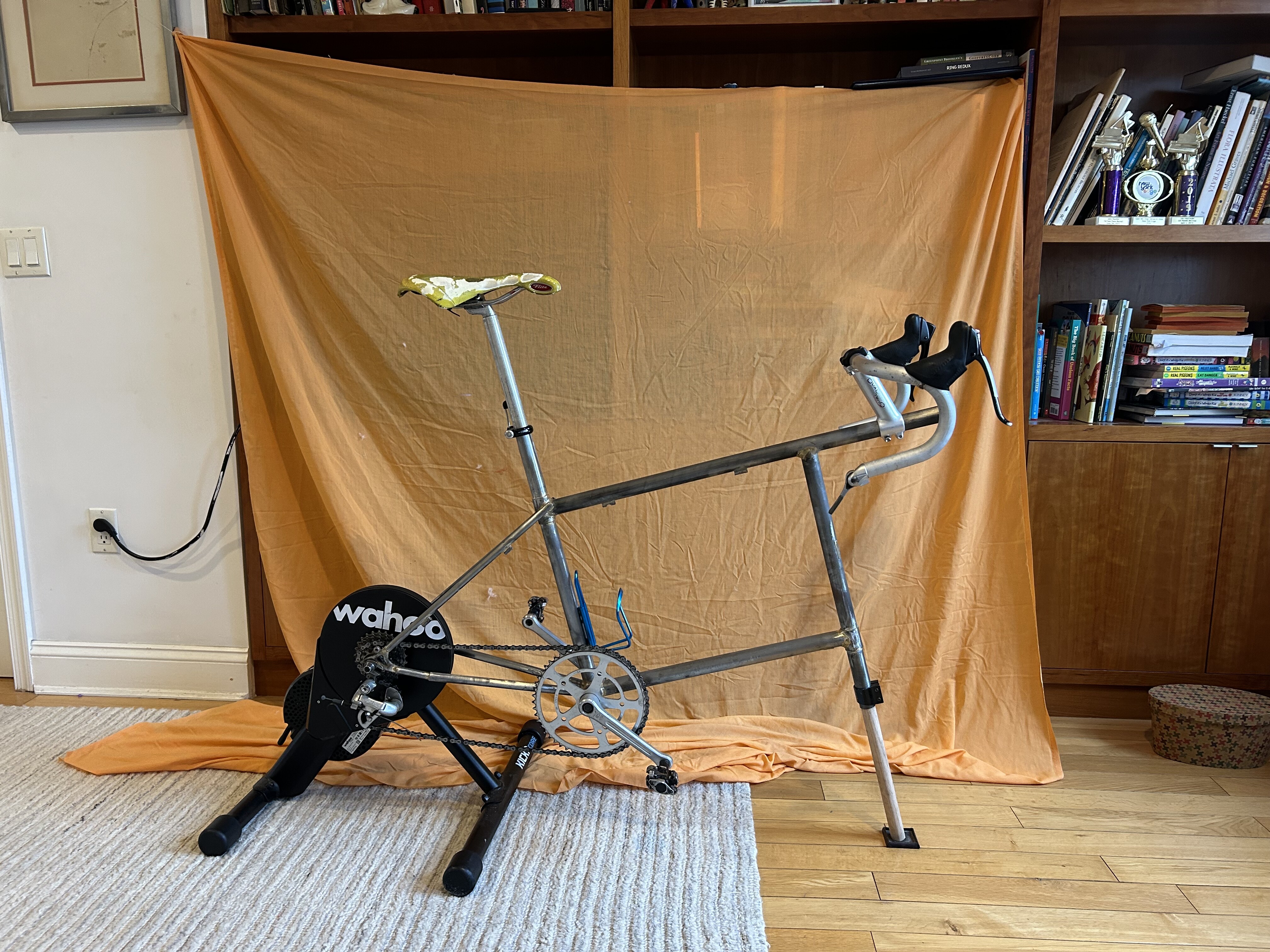

Duane, I’ve made sure not to paint it, for maximum rust accumulating.
In all seriousness though, it will get some paint. This is just the “parts bin” initial build that I inevitably end up riding for a year or so. Also, since weight wasn’t a factor these are all straight gauge .049 or .058 tubes. It will take a while to eat away those.
I made something similar. I bought a cheap bike for £10, to get all the parts like a BB shell etc., and was going to cut it up and make it into something like you have. But the bike I got was kind of a nice vintage Peug (a “Mixte” one from the 80s with “HLE” tubing or something), which I felt like it would be a shame to damage, so I just made a kind of frame that the back wheel dropouts went into and which completely replaced the fork, with a 1 1/8” tube that went straight up through the steerer into a kind of custom handlebar (the person it was for wanted a high stack and a flat bar anyway).
Well, if it were just a regular bike on there it would also be balanced on just one point, right? I’ll grant you this: it does have a lot of flex for a frame made of such stout tubing. I like the flex, personally. A more high-wattage rider might not be so into it.
