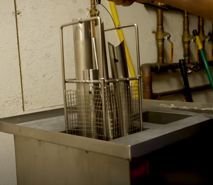

Anyone out these using an ultrasonic cleaner for tube prep? I love the idea of reducing the amount of sanding in my process and I imagine it’d benefit any type of joinery
Some online shopping led me to rifle sized cleaners, which seem to be the closest to bike tube sized.
I’ve seen Engin cycles setup, but that looks like an expensive machine…
Looks like moots does as well…
There’s a handful of tutorials out there on DIY ultrasonic cleaners and it seems that transducers and drivers are cheap and readily available from a number of places. Anyone tried this?
What are your thoughts?
Would you adopt ultrasonic tube cleaning if it didn’t cost an arm and/or leg?
Is it overkill?
Recommendations for affordable cleaners that would fit a tube?
