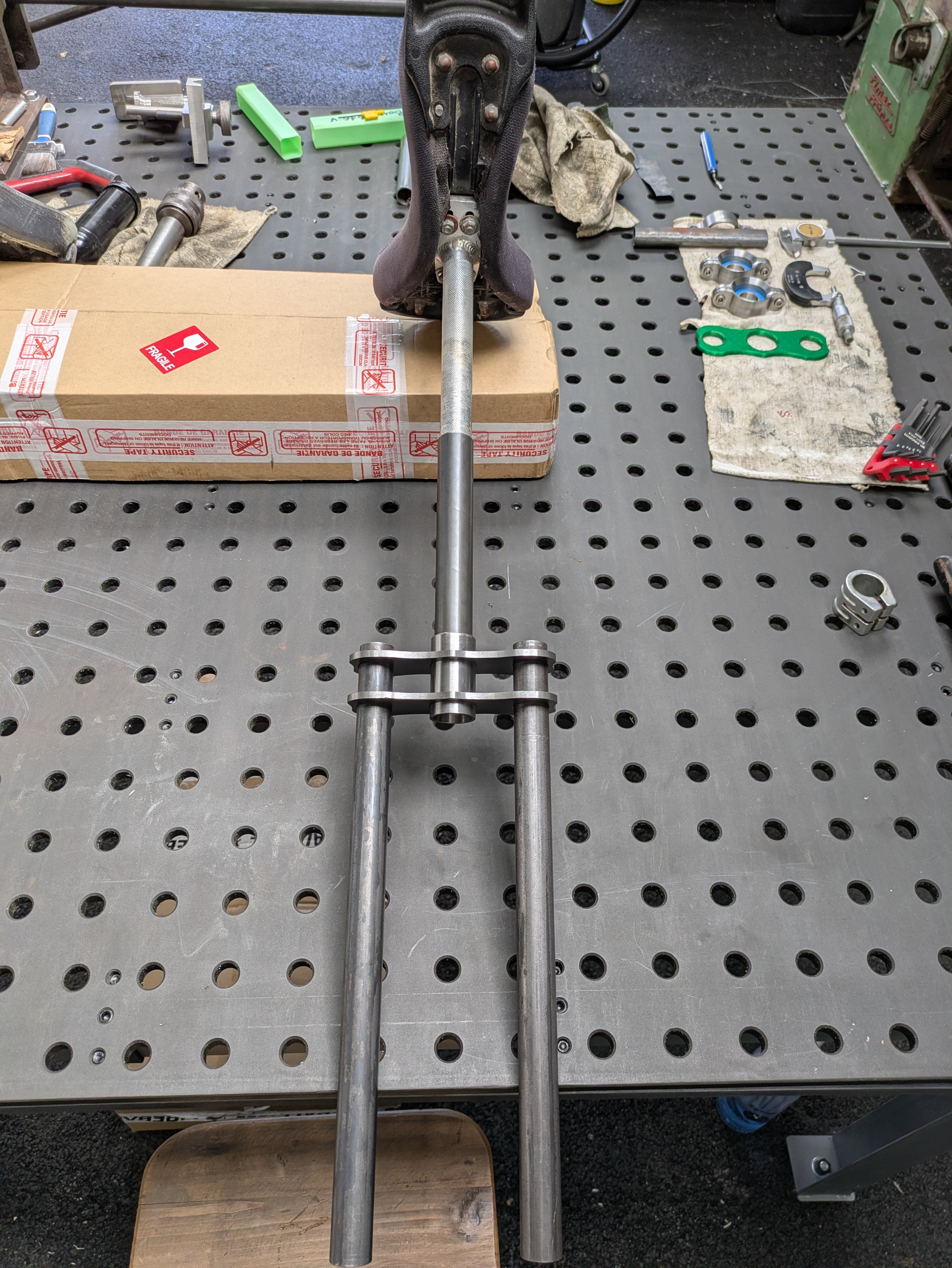

I choose to build a unicycle frame as a first project, I figured it would be easier and more forgiving (also I love unicycles).
I’m gonna build it around a 24” wheel that comes from another uni. I took inspiration from the said uni and frames I saw on the internet (special mention to Flansberrium and his fantastic work).
I already started working on it, fork blades are 25x1,4mm straight gage tubes. I’ll ovalise them to weld the dropouts.

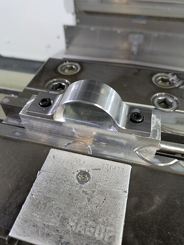

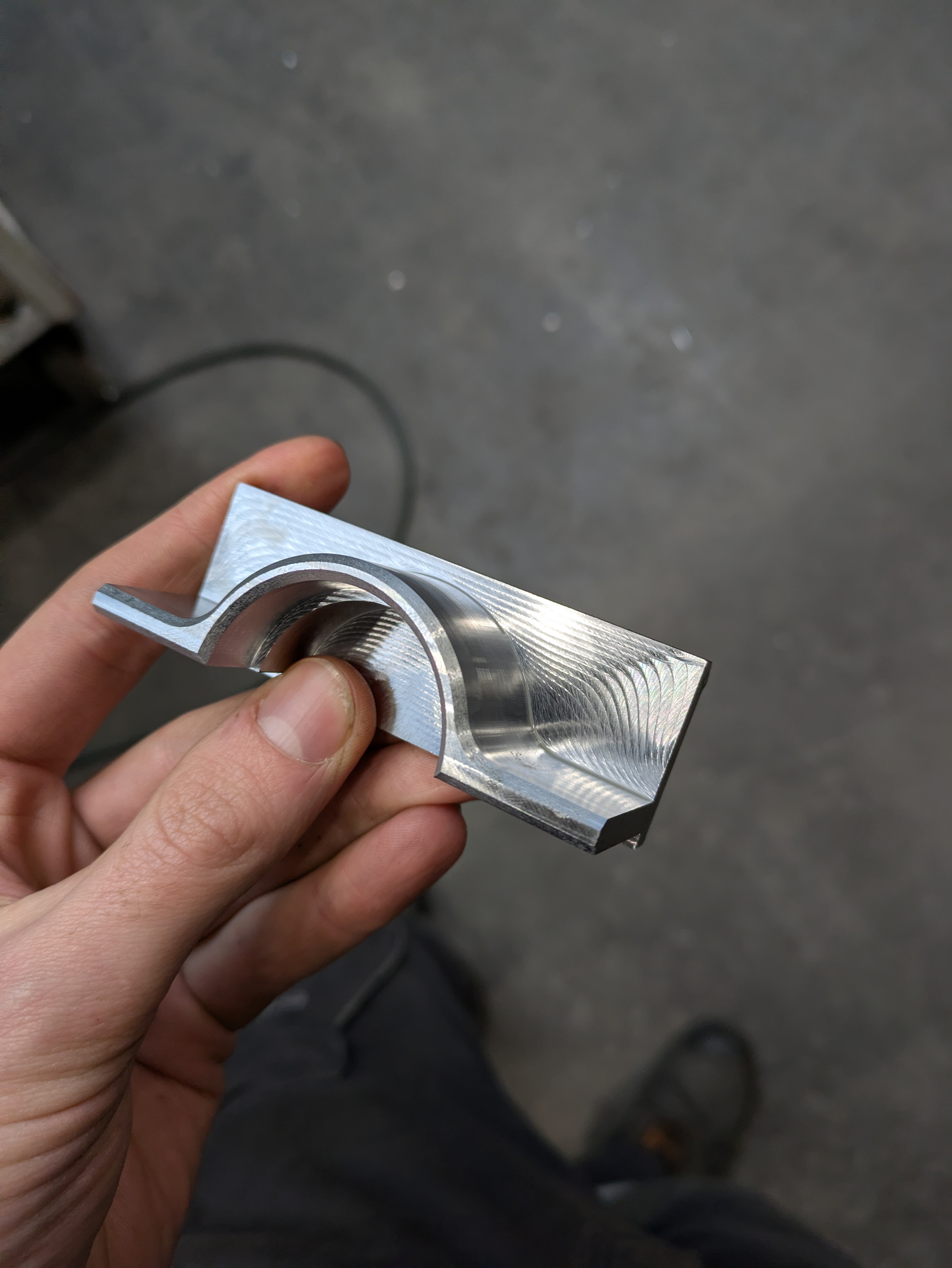

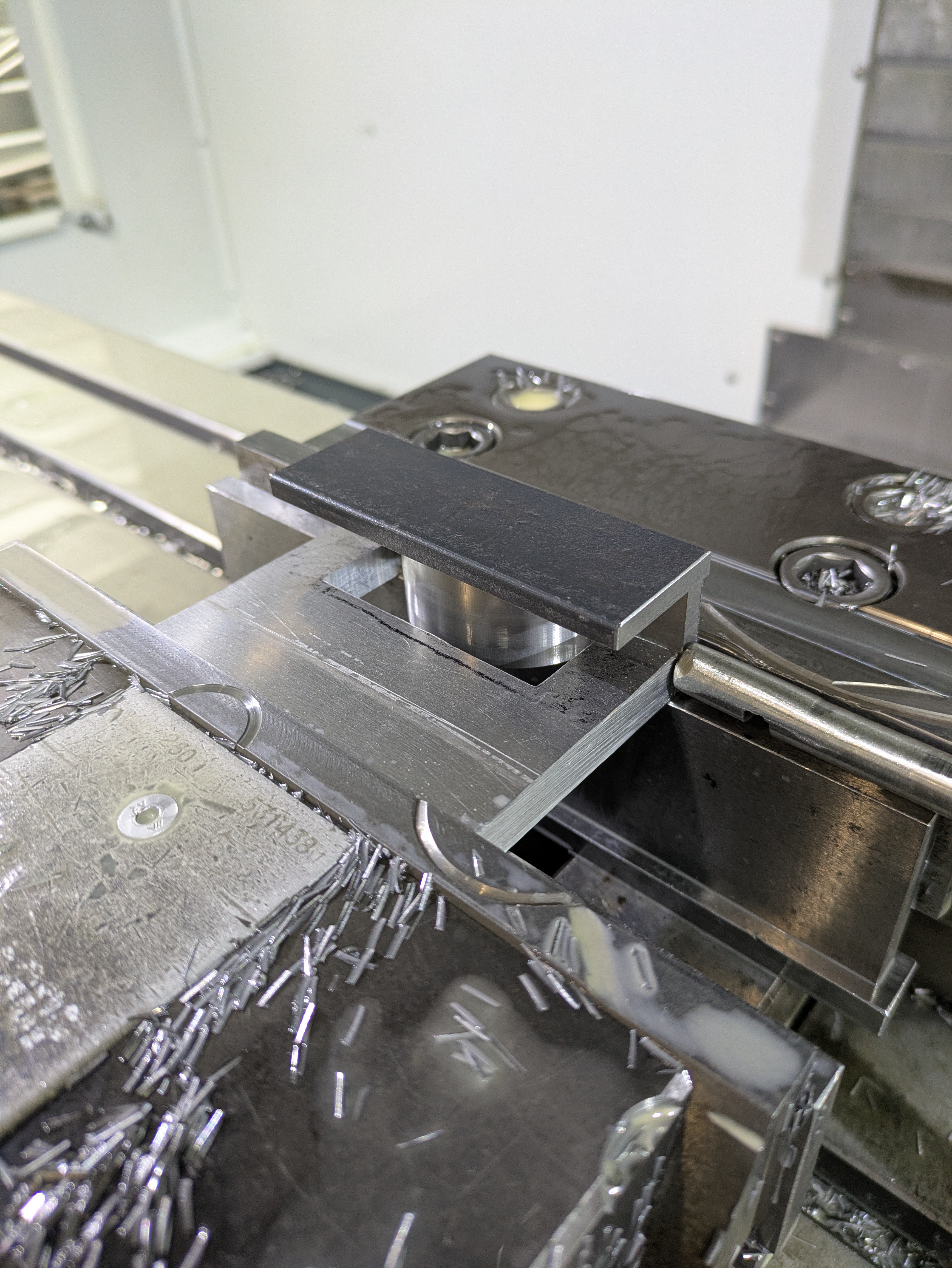

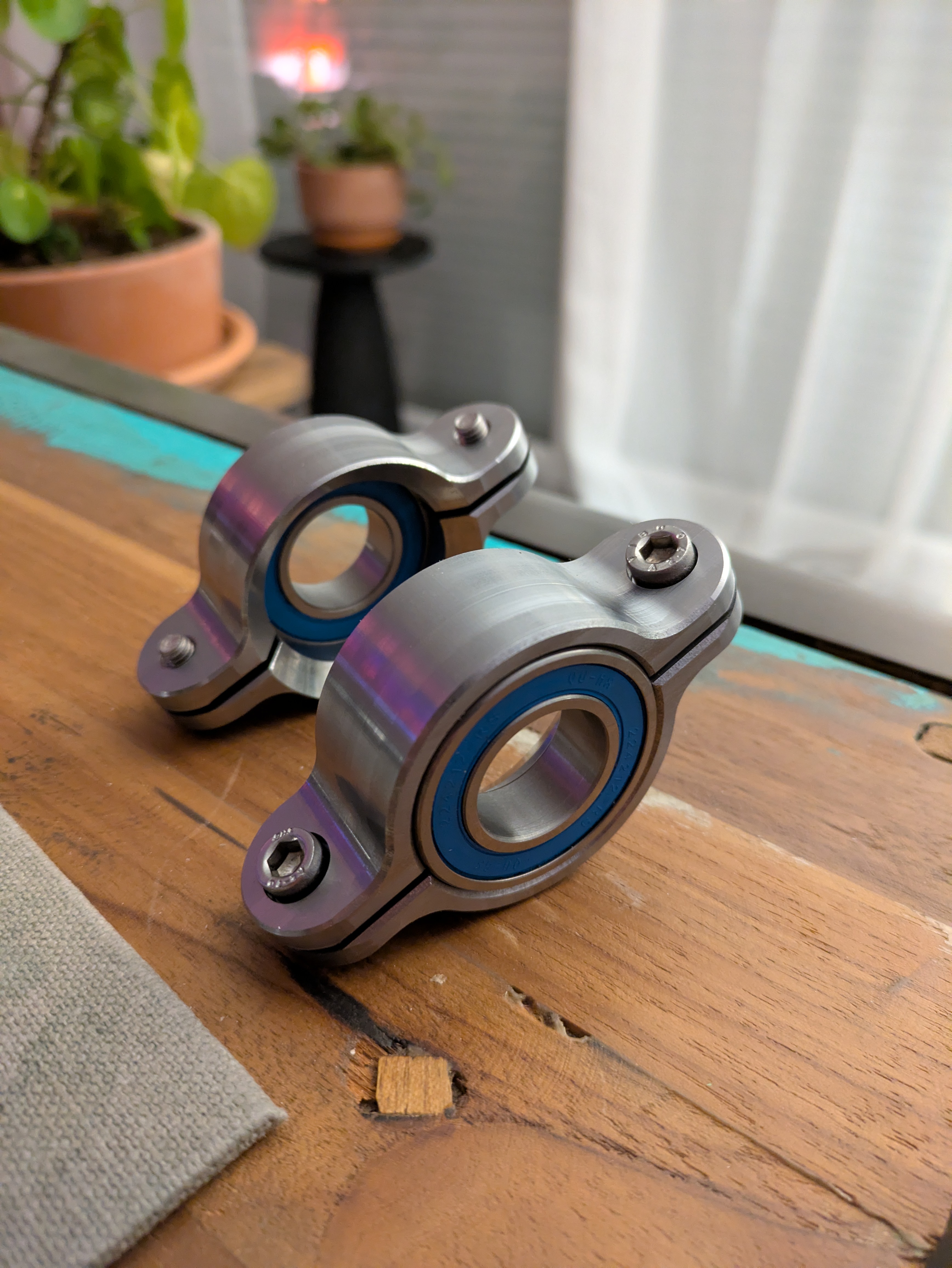

This week I machined the dropouts at work
Added a big chamfer to clear the crank arms
I thought it was mild steel but after machining it I can say it’s not so mild
Next step will be machining the top plates, ovalize the end of the blades and get to welding.

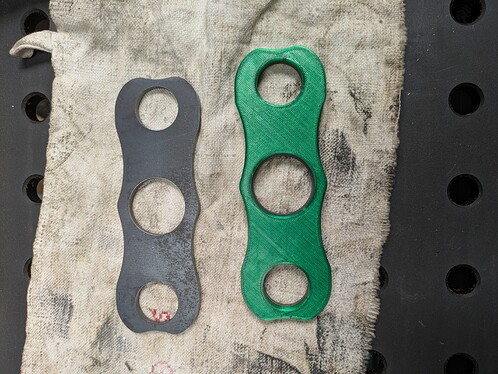

I already tried to ovalize some scrap tubing with a vise but the result isn’t so pretty. I’ll try again with a 3d printed die

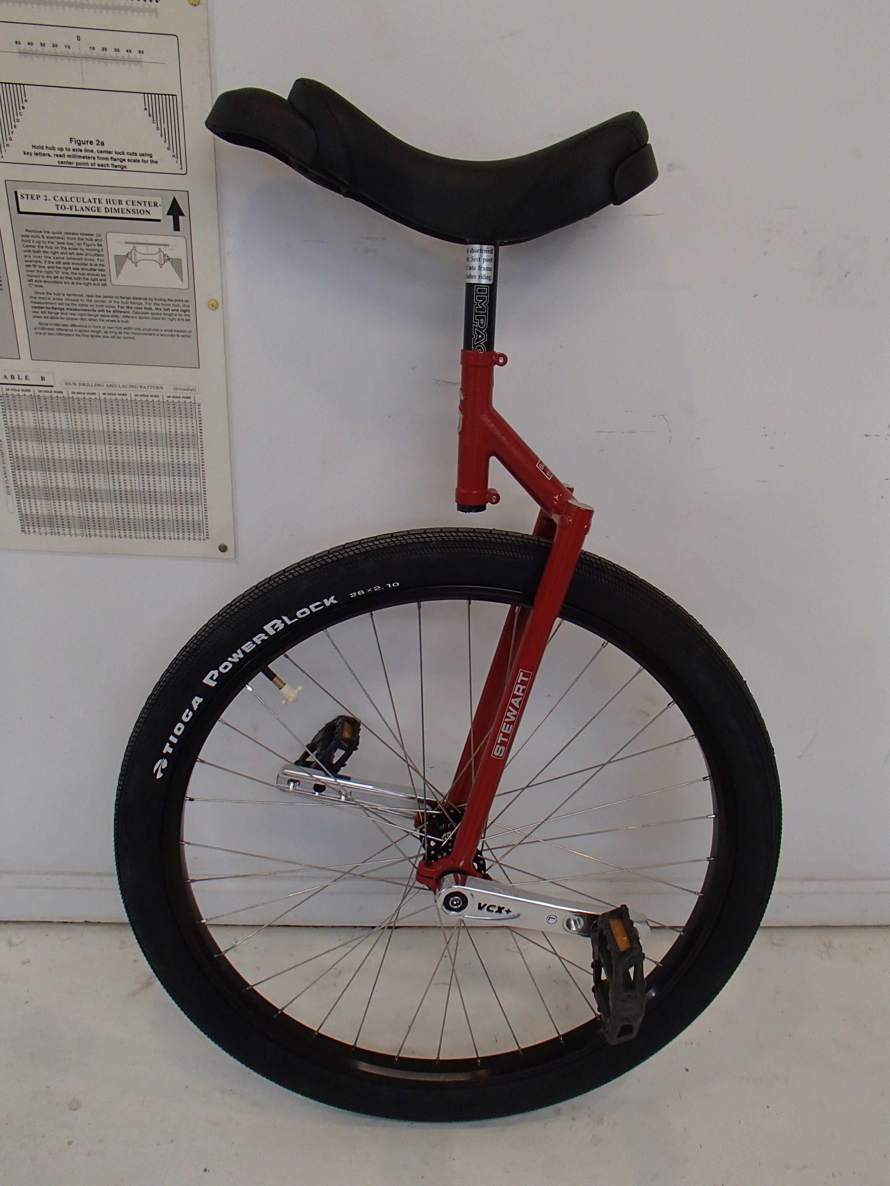

Here’s my Unicycle. Made it a few years ago although rarely try to ride it. Andy
That’s a really nice uni ! Does this geometry add something to the ride or is it only cosmetic ?
And where did you get your dropouts ?
Drop outs were bought along with hub from Affordable Unicycle for Commuting, Best Long Distance Unicycle . Design was a copy of hatchet styles and my own experience as a 50 year LBS veteran, like the two post binders. This is now a silver and black as a practice paint project as i move to auto grade paints and from Rustoleum cans. This is but another example of the odd stuff I have made over the years. The guy who first taught me frame making also made unicycles for the neighborhood kids (till one broke his arm on a giraffe), his personal uni used a 700C sew up that JUST barely cleared the crown’s underside. Andy.
Sick! I like the dual crown design for a unicycle. Gives it some good DH bike vibes.

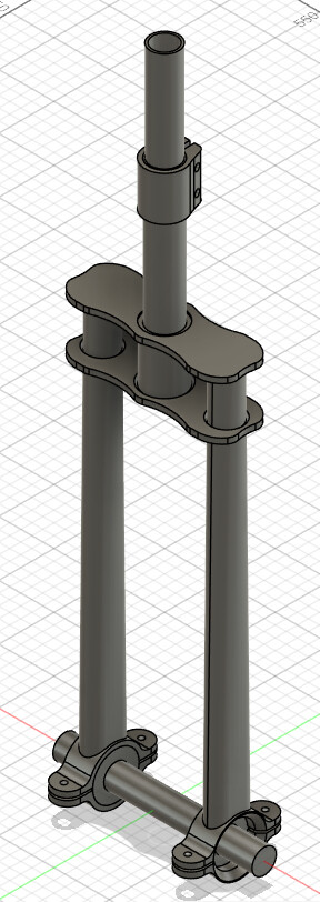

Have you done any FEA on tubing diameter etc? Curious for my own build how thin it’s possible to go.

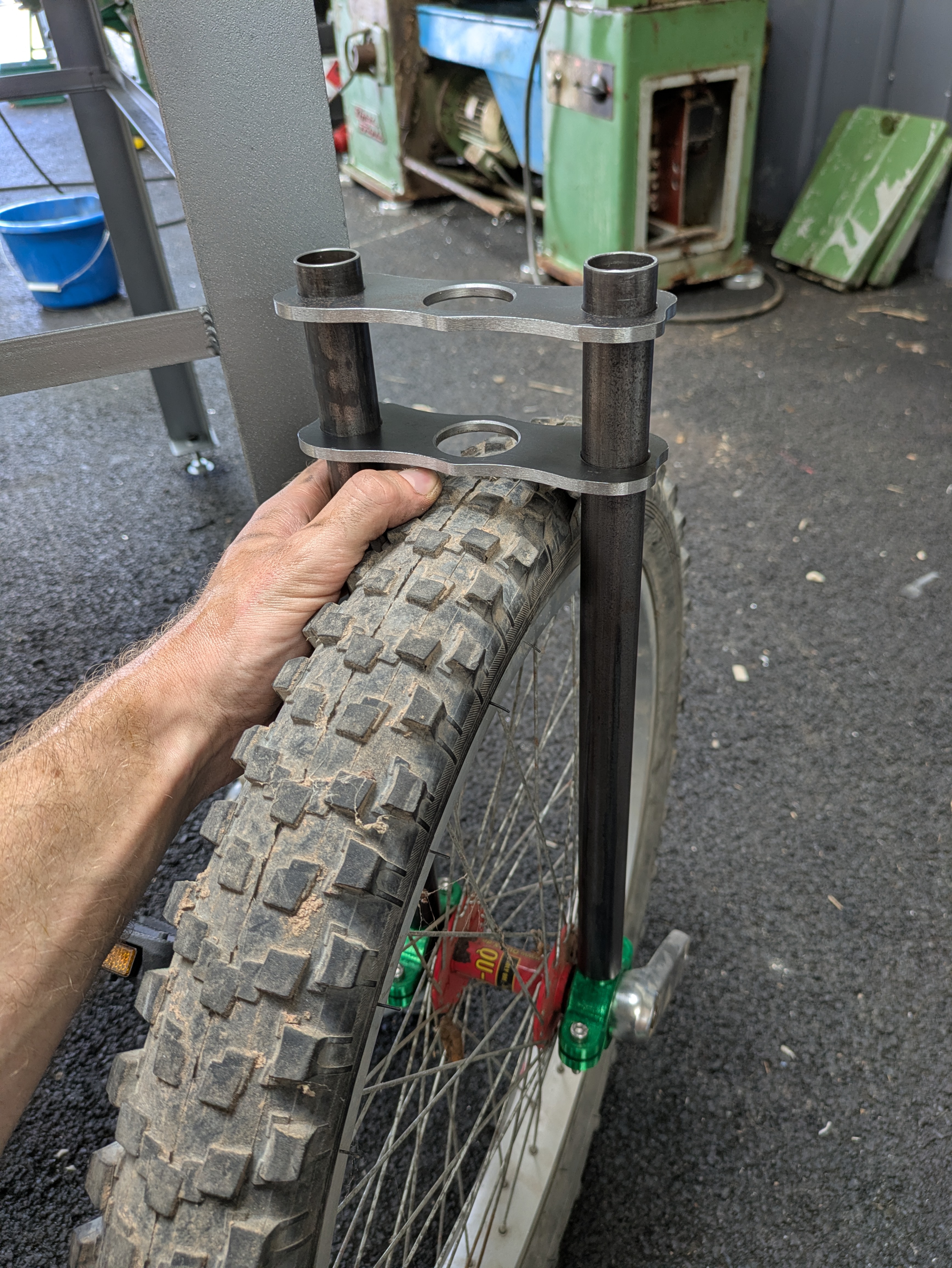

I haven’t done any, it is surelly overbuilt but for a first frame I wanted to be safe. I asked Jakob and he told me he’s using tubes from .8 to 1,2mm thick depending on the use case. I’ll go with 5mm top plates, it should be sturdy enough for some light trial/small trips around town :slightly_smiling_face:

Back at it after moving my shop and buying/cleaning/repairing a lathe !

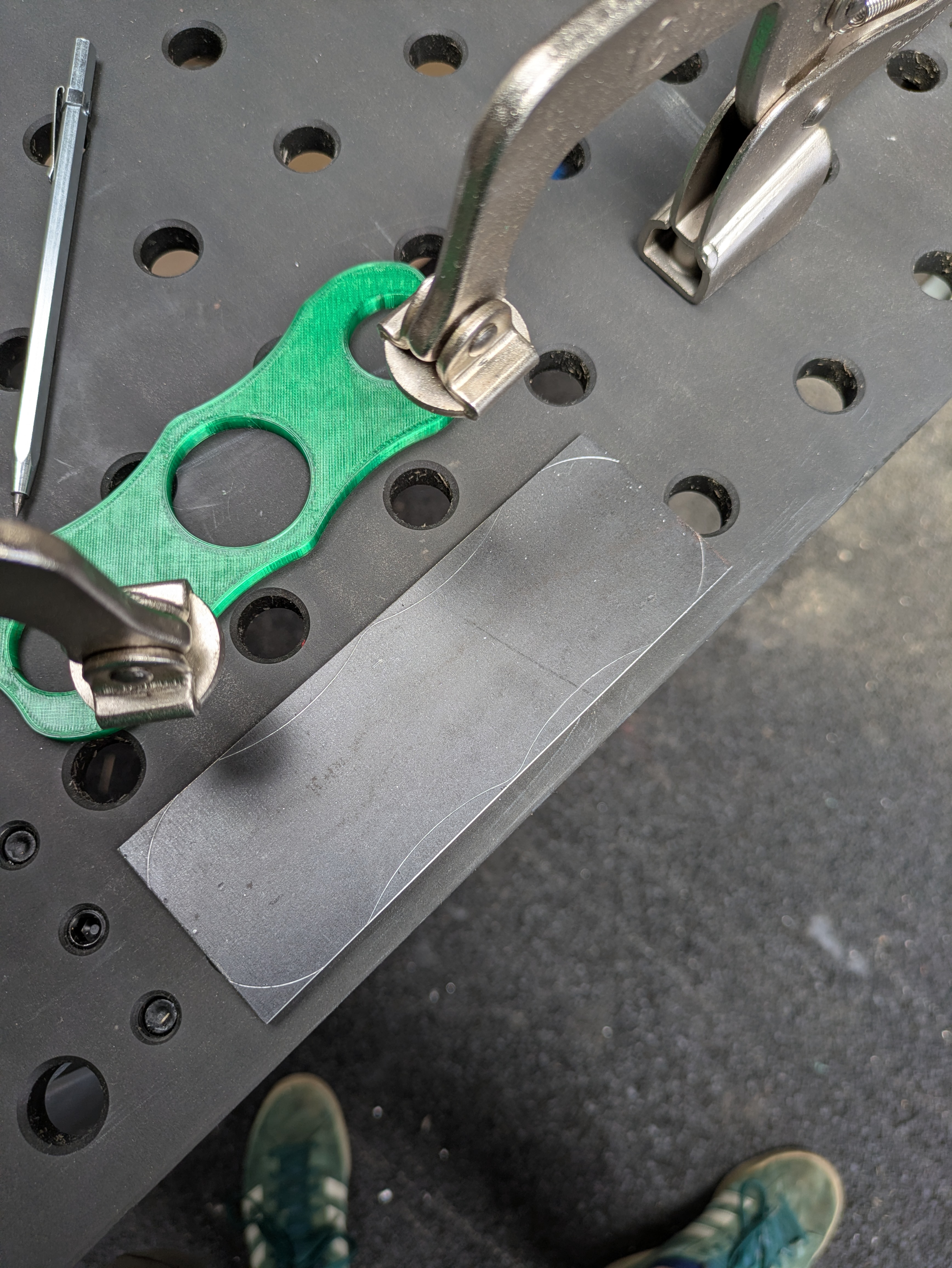

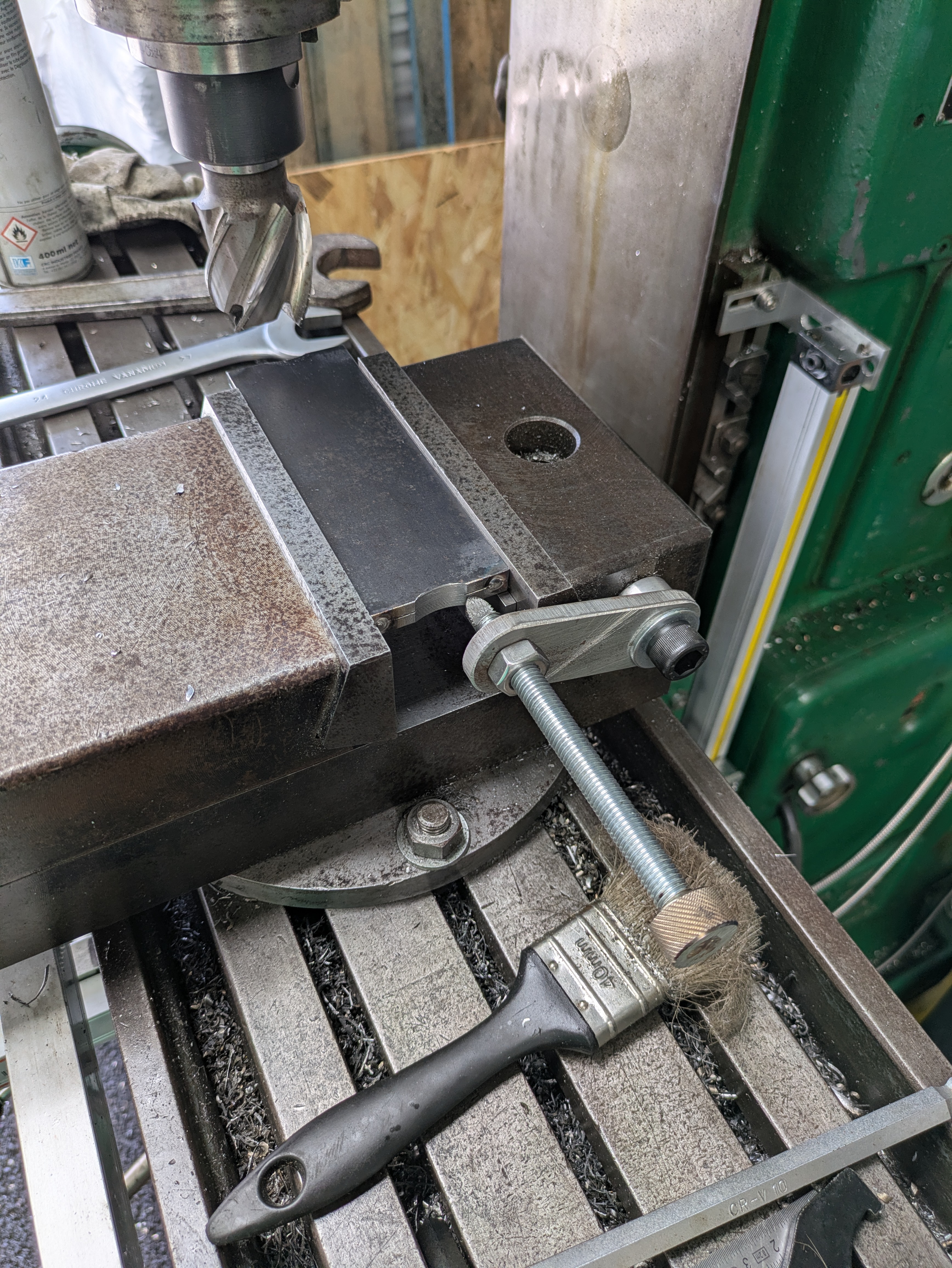

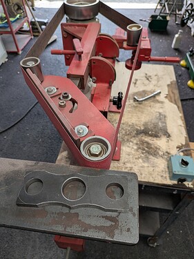

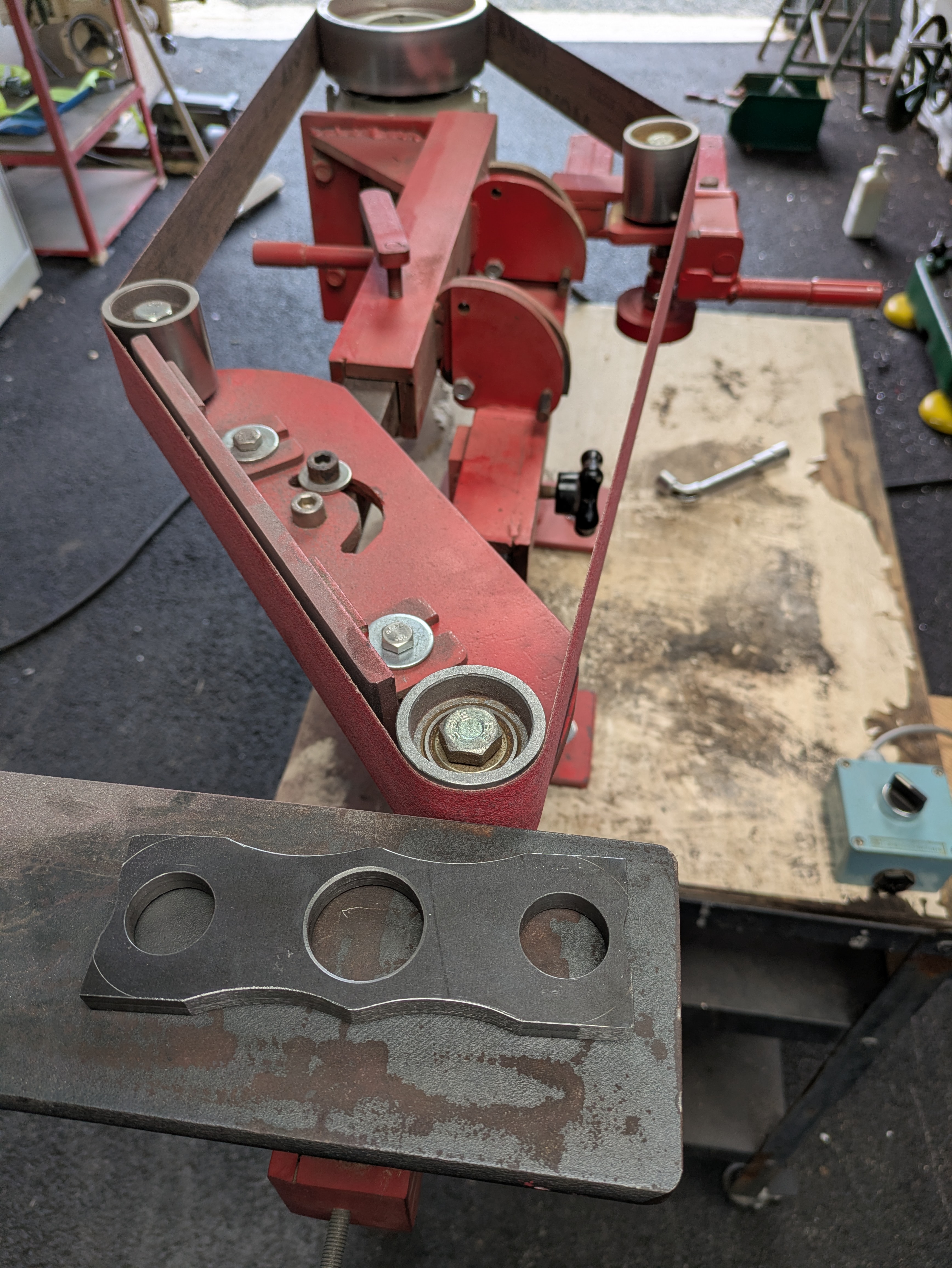

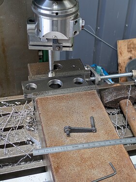

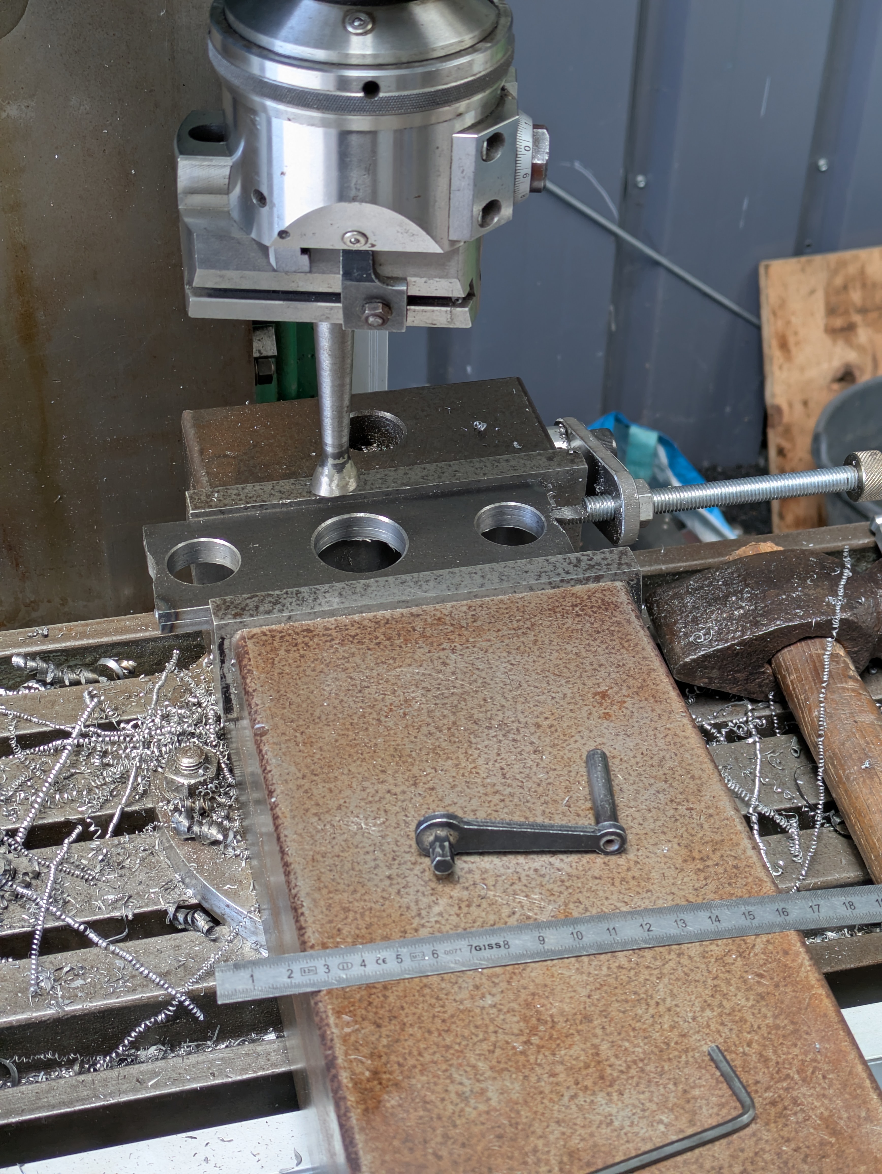

Machines at work were busy so I machined the top plates in my homeshop
Good ol’ cnc backstand

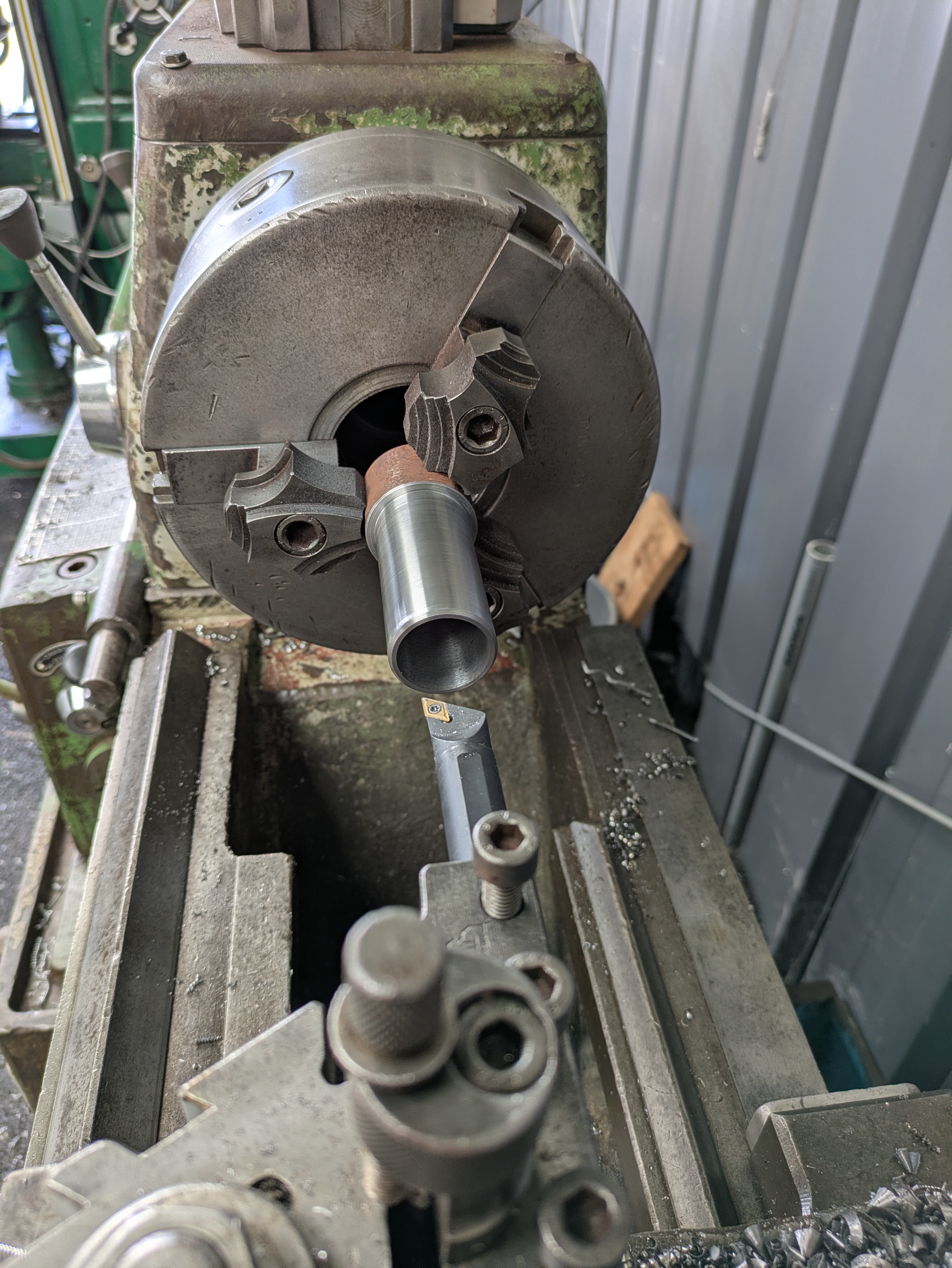

Next step is going to be machining a sleeve for the seat tube and some caps to close the blades
The sleeve is finished
Seat tube is already to size, i won’t have to ream it

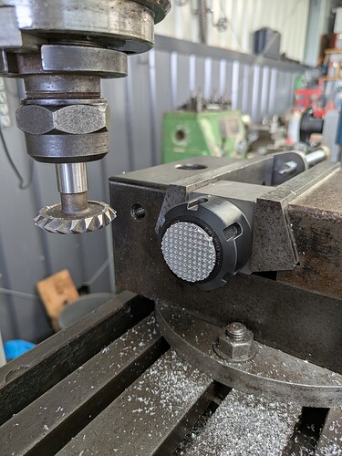

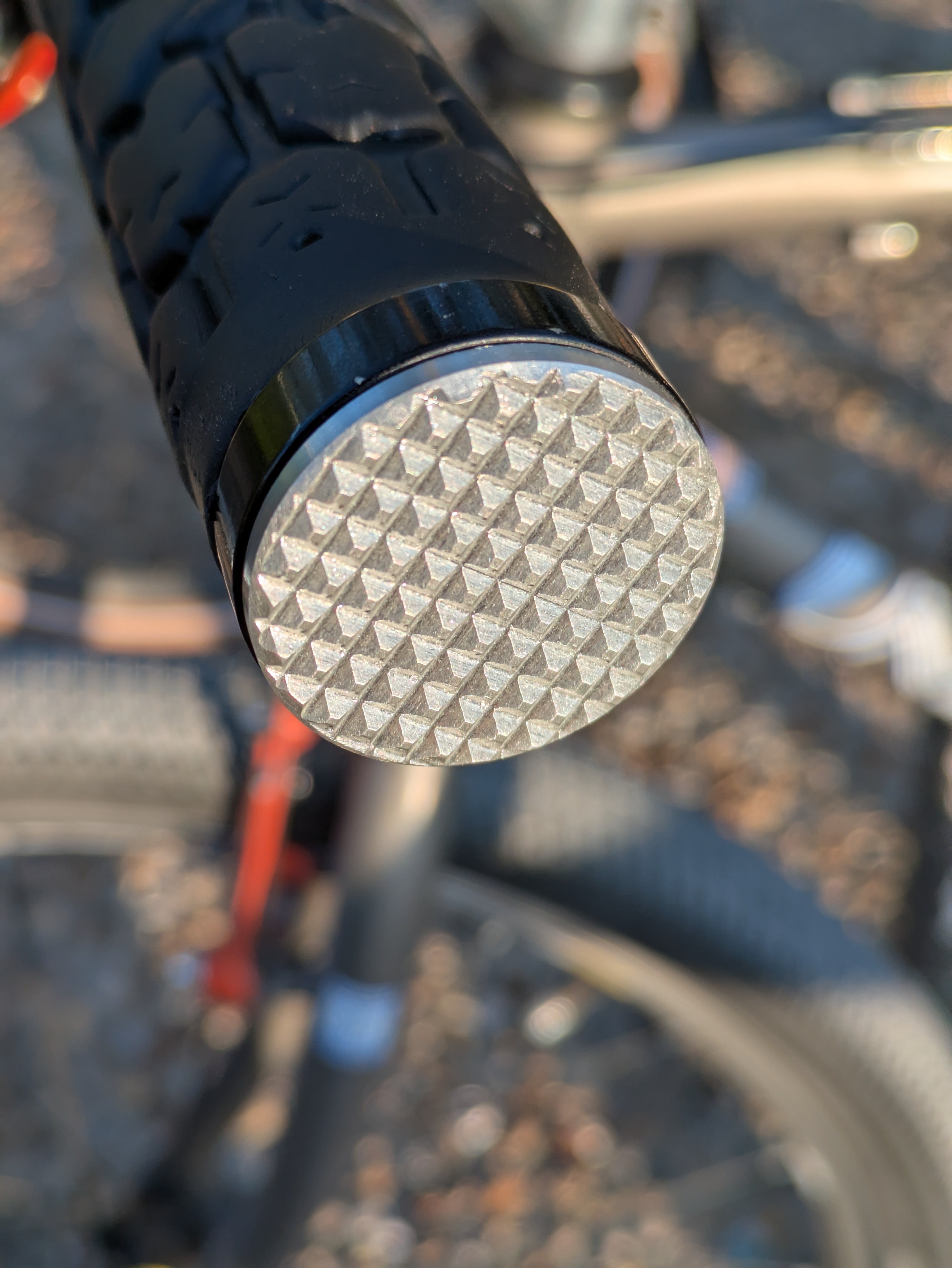

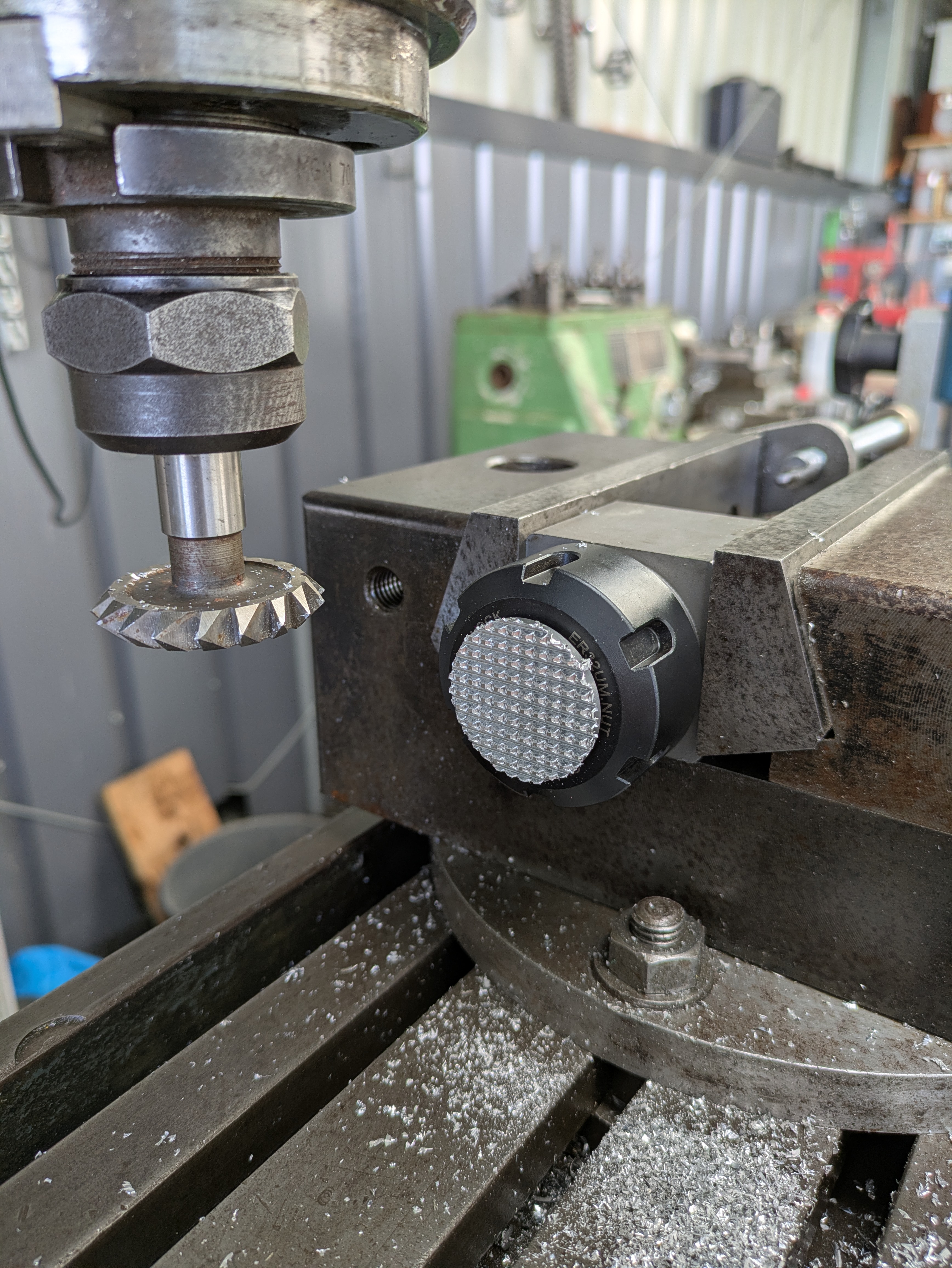

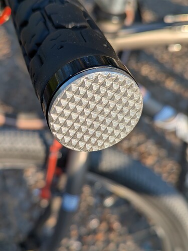

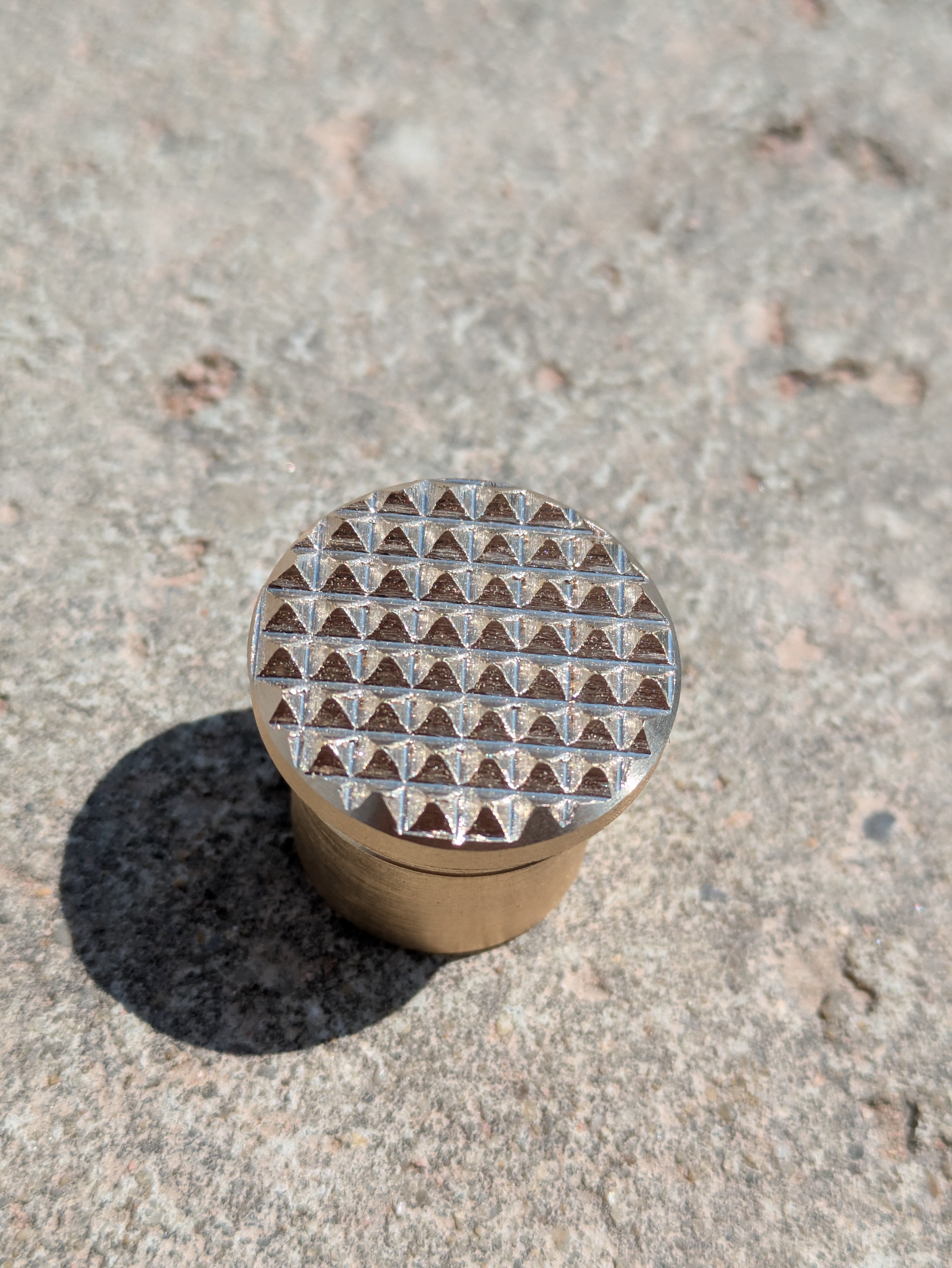

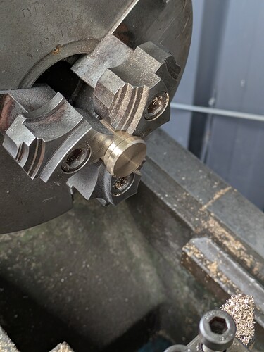

I made some tests on a bar cap and this knurled surface aspect looks really nice. I’ll try again with bronze

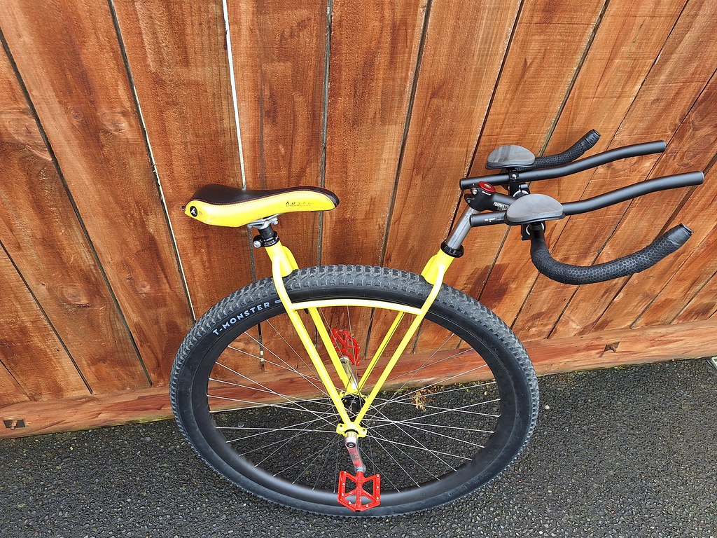

Do you have bars on your unicycle? :wink:
Ahah not on this one but I’ll use this design for the blades caps though !
Handlebars on unicycles is a thing though :wink:
Imgur
I really like this one ! But I won’t need handlebars for my occasional commute/bakery trip :wink:

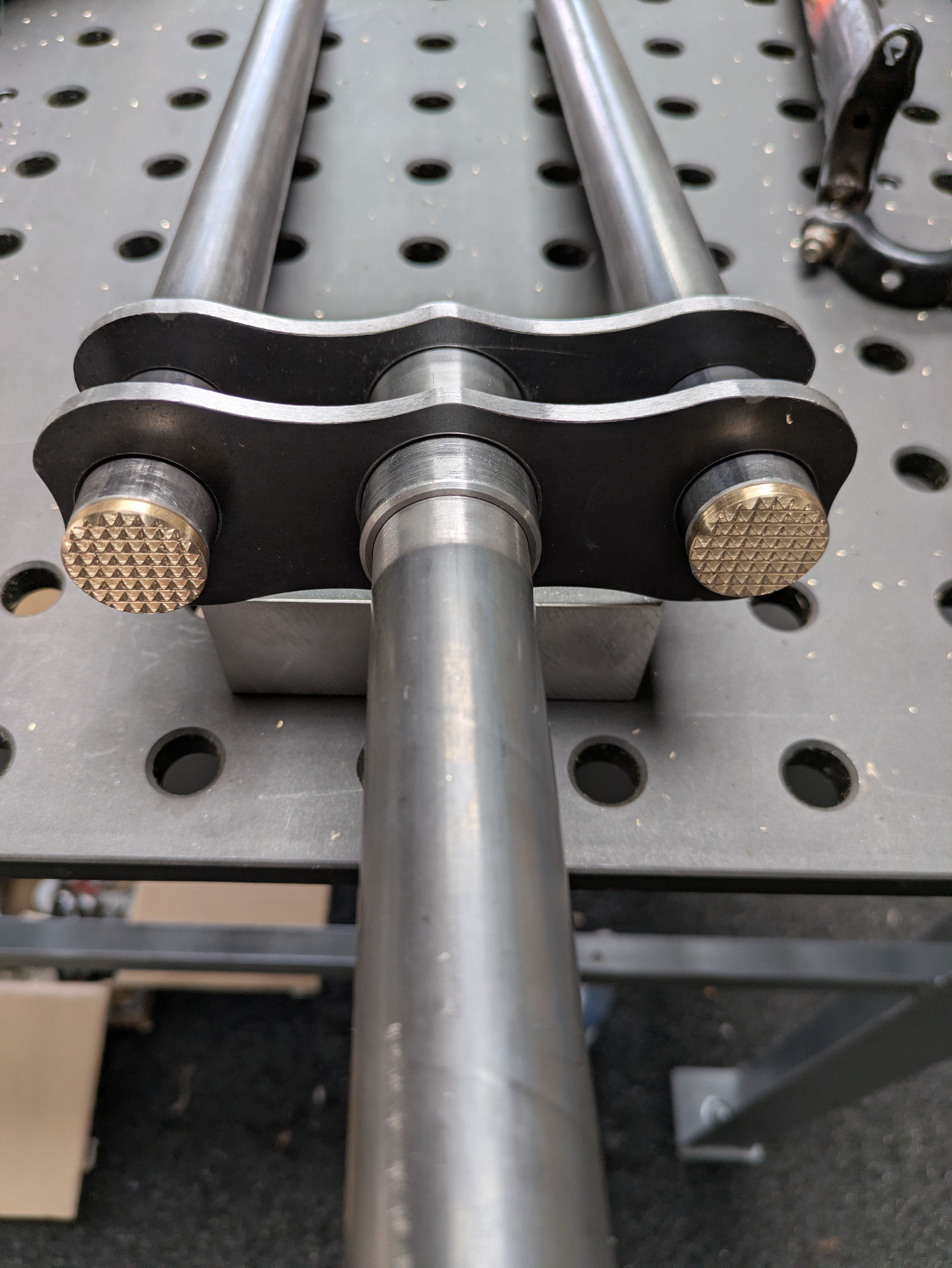

Had some time to finish the caps
I’m planning to tig braze them, I made a test piece but it didn’t go as smooth as planned
I’m struggling to get it flowing nicely, i’ll have to make another test cap or two !

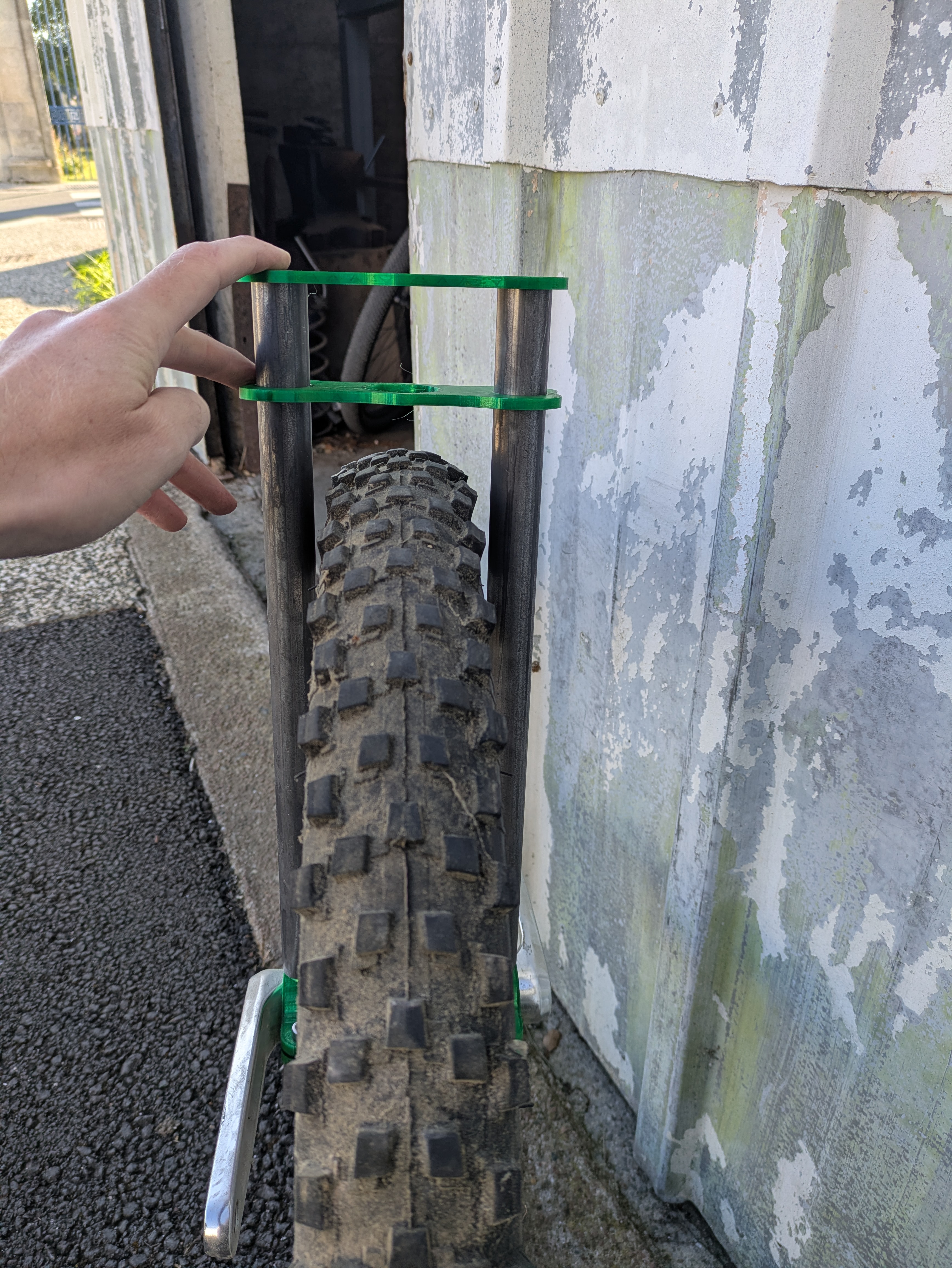

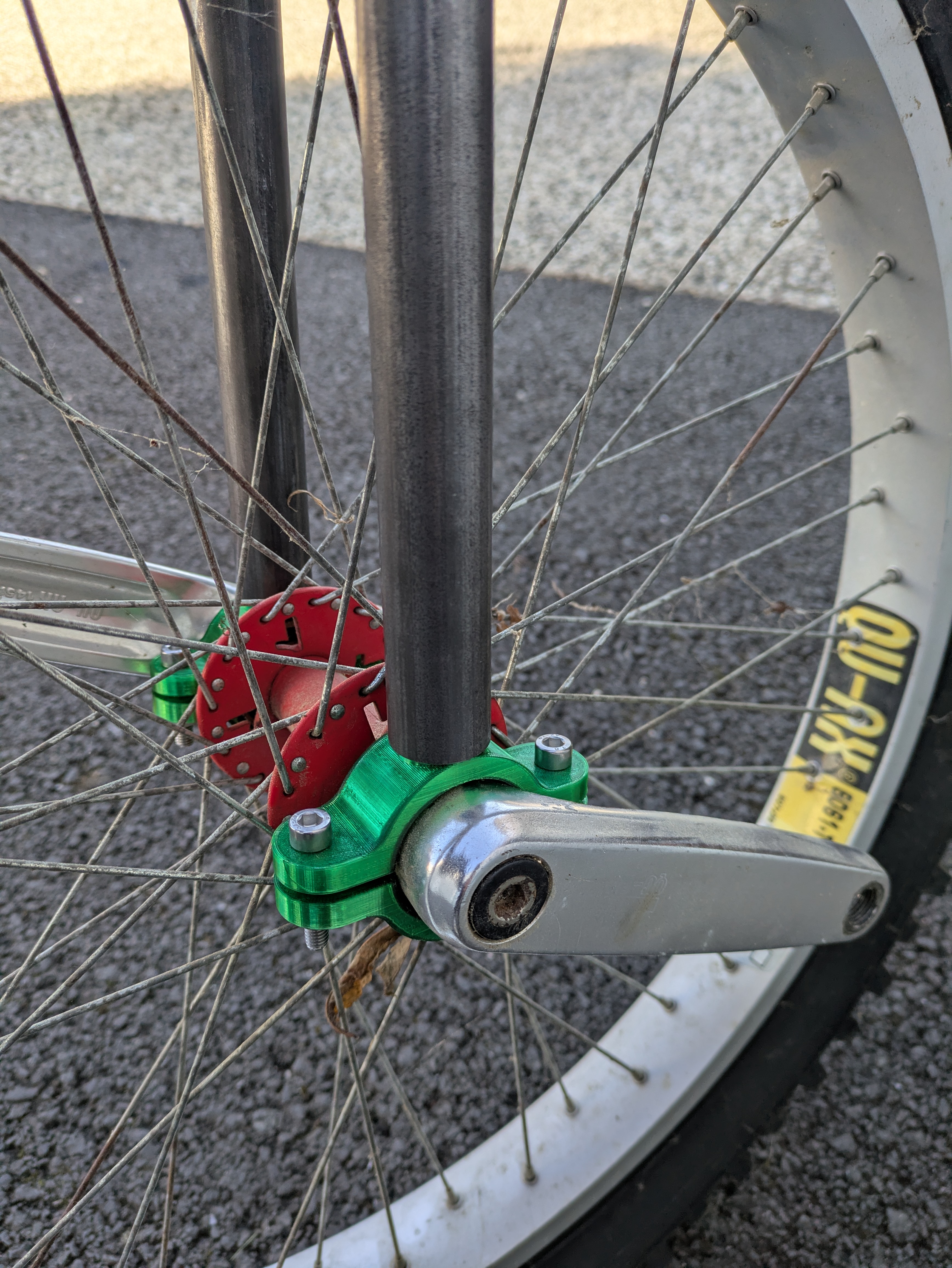

Some progress has been made !

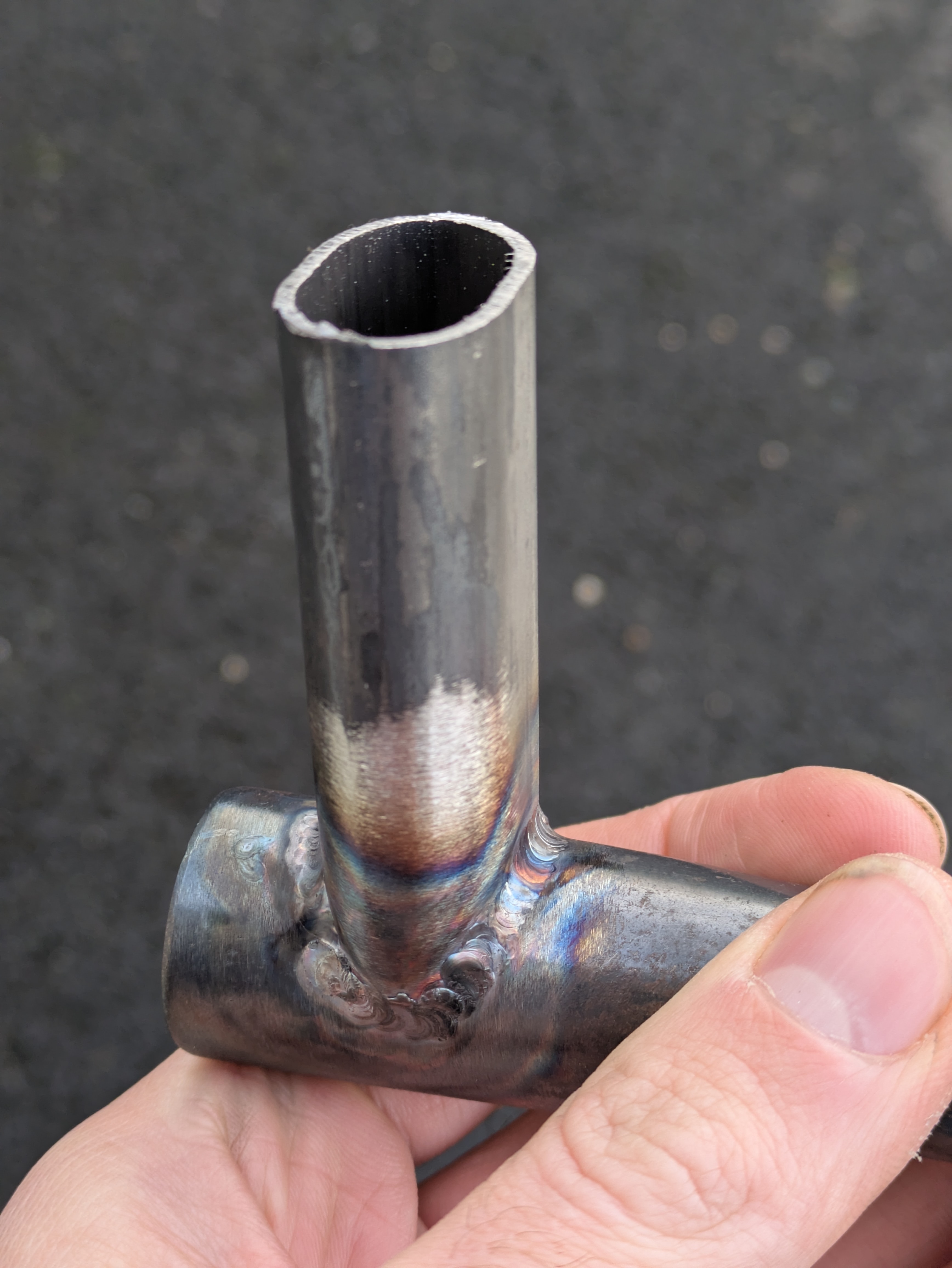

I ovalized the blades and mitered them
Also made a dummy axle, It’s been really useful
I also tig brazed the caps
I don’t think I’ll weld the interior joints, top and bottom should be enough

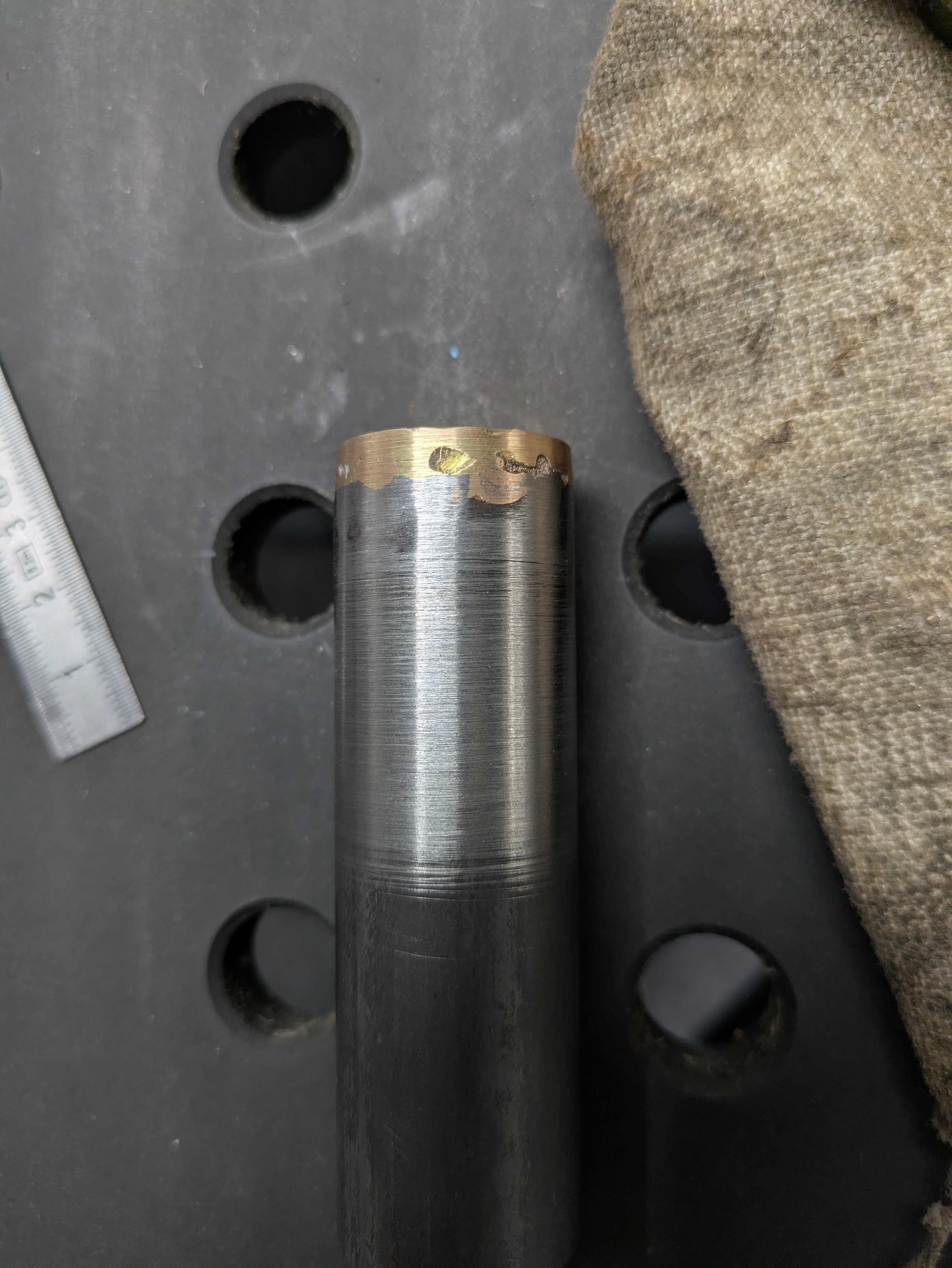

Unfortunately I can’t fit the original seat tube collar, I’ll have to make one at work !
Thats a really fun project, this thing is built to last! Can i ask how the boring head mitering went? Might be a better alternative to squishing the hole saws when we need a specific diameter
Thanks ! Yeah it should be strong enough :wink:
And for the boring head mitering, it’s clearly not ideal but it works. I had to miter for a 50mm diameter but only had a 45mm holesaw. I stepped the rest with the boring head. Having an adjustable stop on said boring head is a nice feature for repeatability
