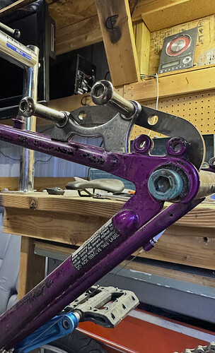

Here is my homemade IS brake mount jig. (or at least the only photo I have of it.)
I did the design in CAD, but just got it laser cut at Send Cut Send.
It has holes for both front and rear. To do the front, you just need to have some spacers between the mount and the jig. Just ignore the fact that I’m mounting a front mount distance in the rear of this bike. We didn’t want to have to buy another spacer or rotor, or modify the rack and fender mounts.
