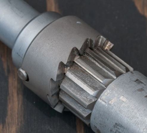

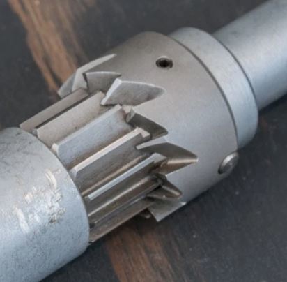

Just noticed that ebay seller has two of the complete cutter set, at the same price, but the cutters are different.
One has the older style cutter that doesn’t make the 45° chamfer, which I think dates it to early '70s before the Super Record headset with alloy lower cup came out.
Here (below) is the other one they’re selling, check out those chamfer blades. What a cool cutter, more expensive to get it resharpened though I bet:
I think I see some wear on that cutter, so don’t assume it’s sharp.
