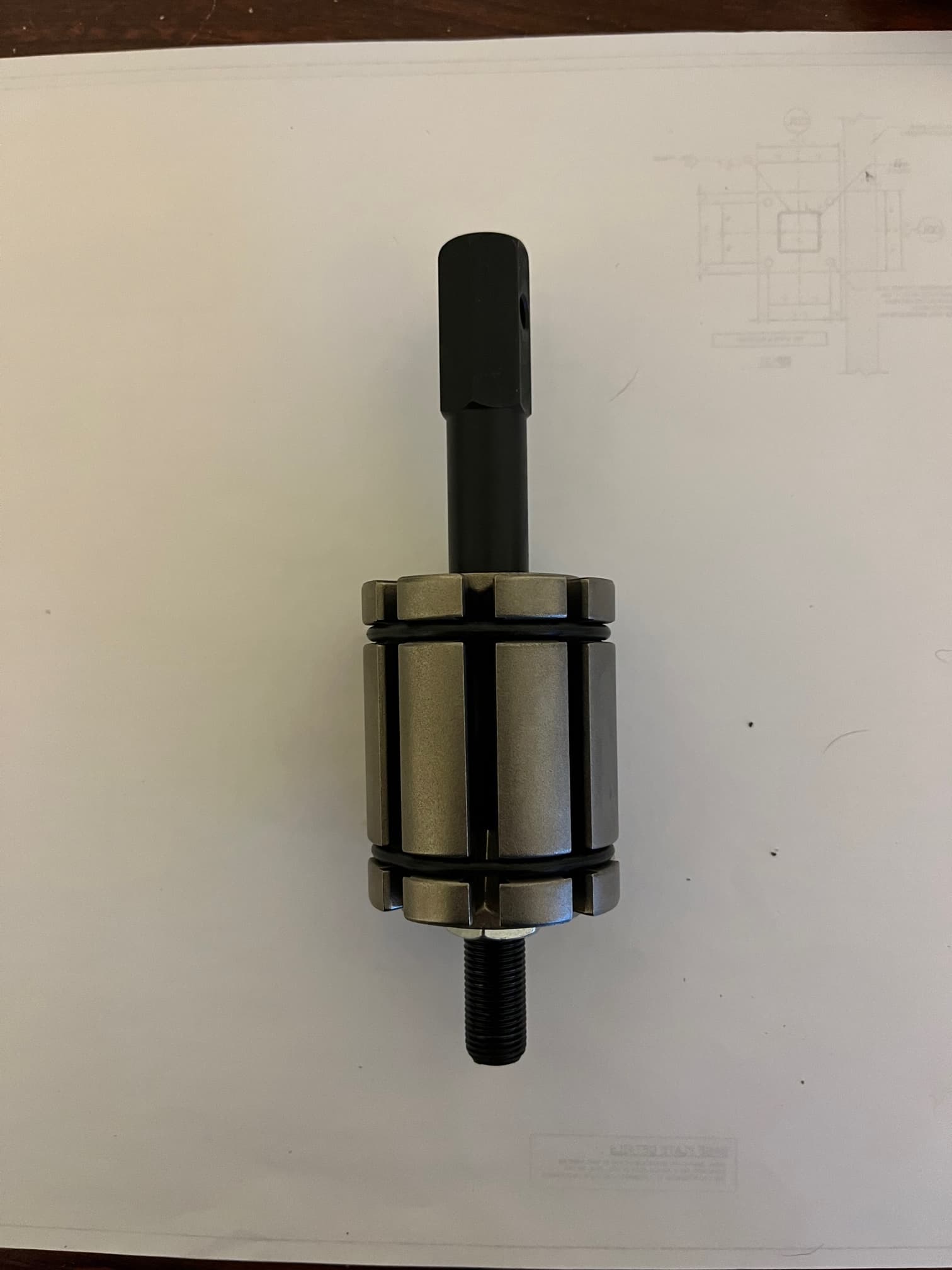

I got some tailpipe expanders from Amazon. You can get a set for about $30-$40. I haven’t used them yet so can’t verify how well they work, but I figured give them a try for that low of a price. Some people have said they used them in the past with some success. You may need to get some garter springs from McMaster to go with them. That being said, I did get a Paragon BB heatsink because the BB is critical for roundness, etc. I’m hoping the expanders will work at the HT and top of ST.

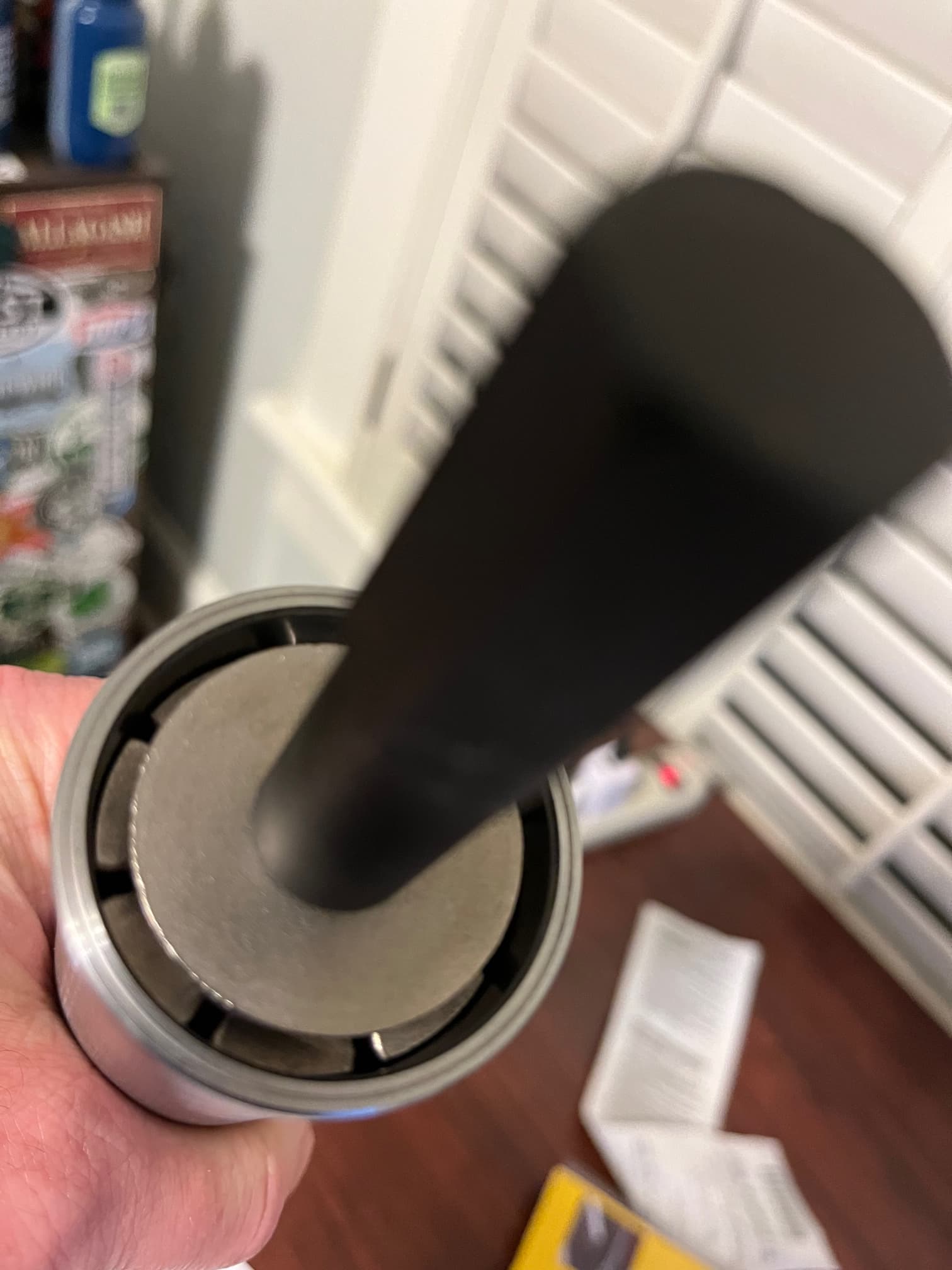

I’ve been using these too. I haven’t figured out the best replacement for the rubber rings that can hold up to the heat. Right now I’m just using steel spring wire, that works okay.
Not sure if these actually help heat or distortion, but they seem like they would.
