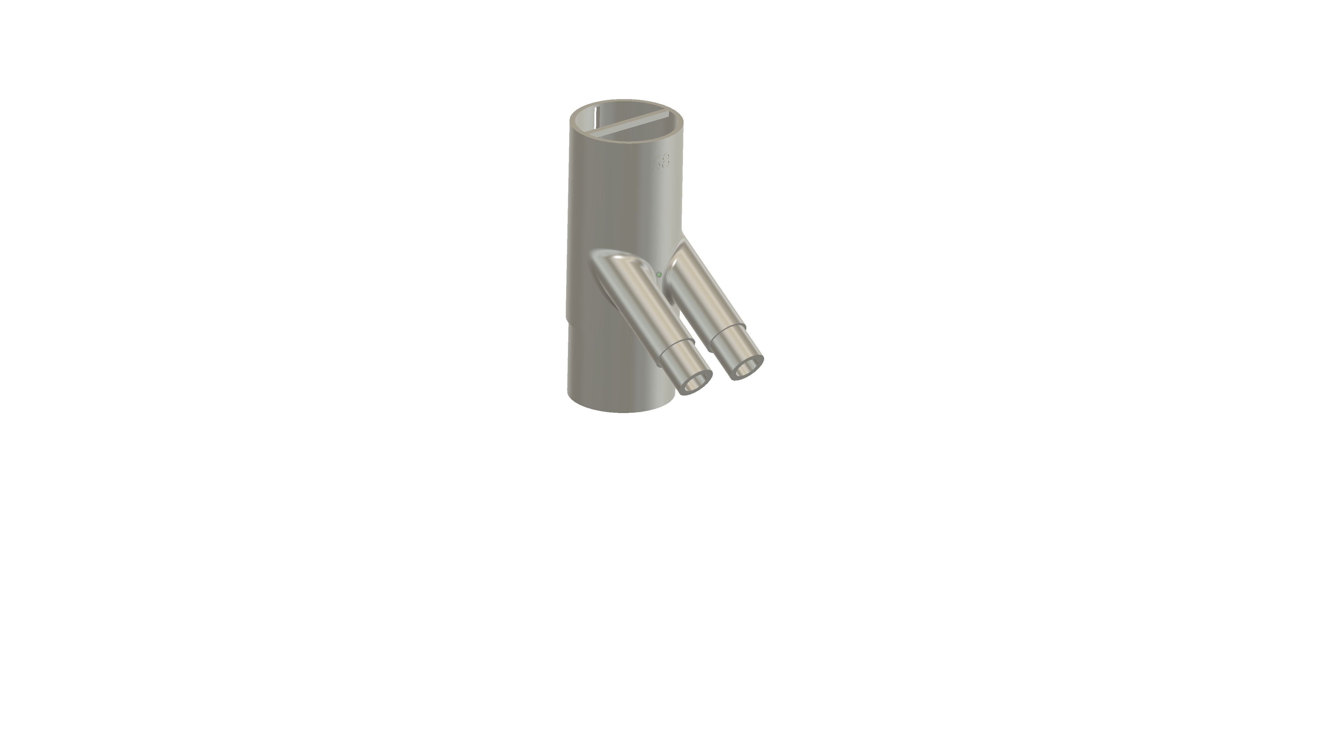

I have a design for one that we arent using that I could share. However I think the problem youre going to run into is that they are all designed for a specific frame, and the odds of your designed seat tube/top tube/seat stays all lining up with it id say are pretty slim.
It maybe worth a try. Send me the info
I know it’s not the same, but I use these for my TwinBone frames. But same as @Swood says, they get printed on a frame-by-frame basis as the angle is always different.
I haven’t designed that part before, but I’m willing to give it a go. Shoot me a message with the ST-TT angle, Seatstay-ST angle and the angle between the seat stays that you need to be able to clear the rear tire. Maybe I make it configurable in the end and we can share the file with whoever wants to make their own?
