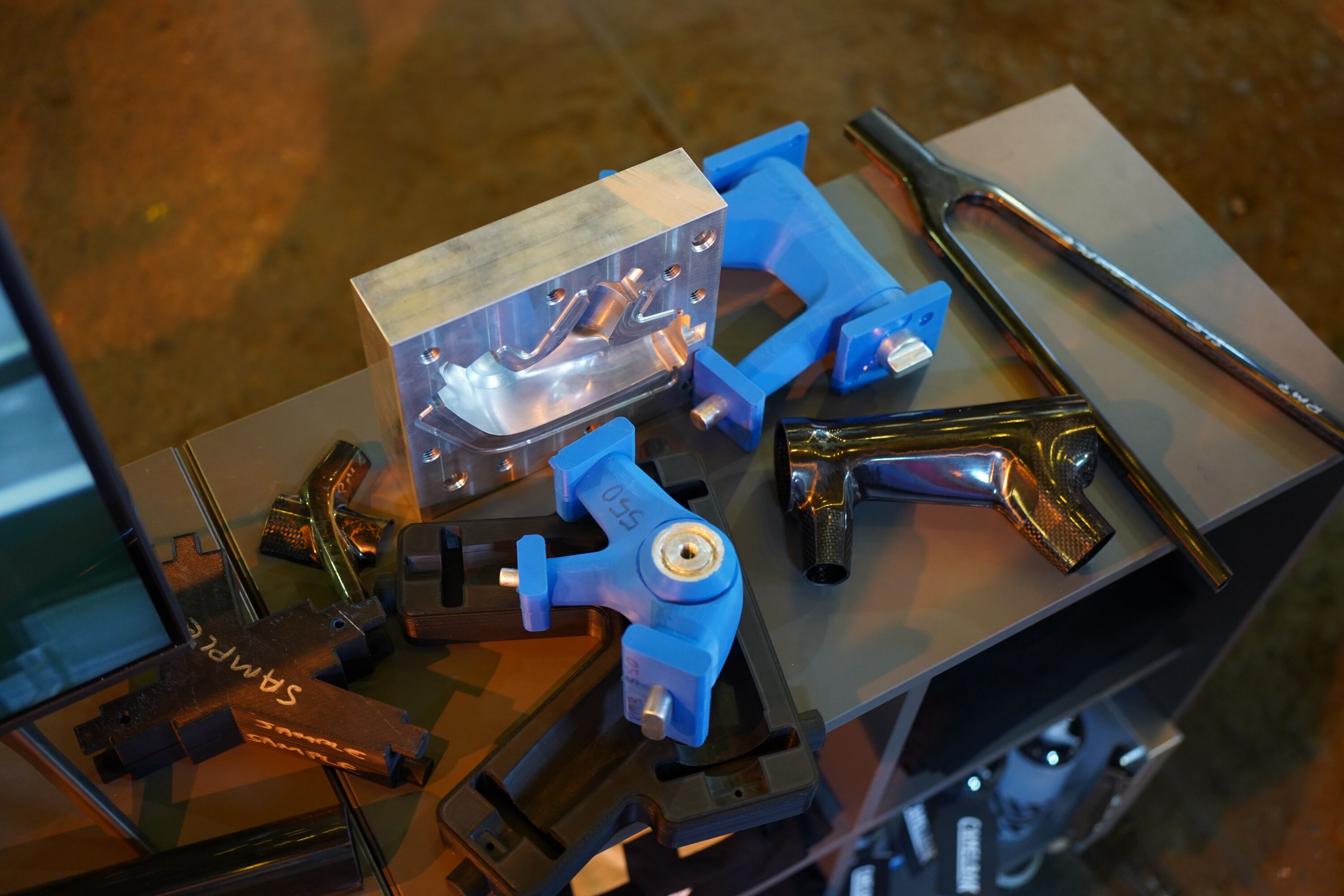

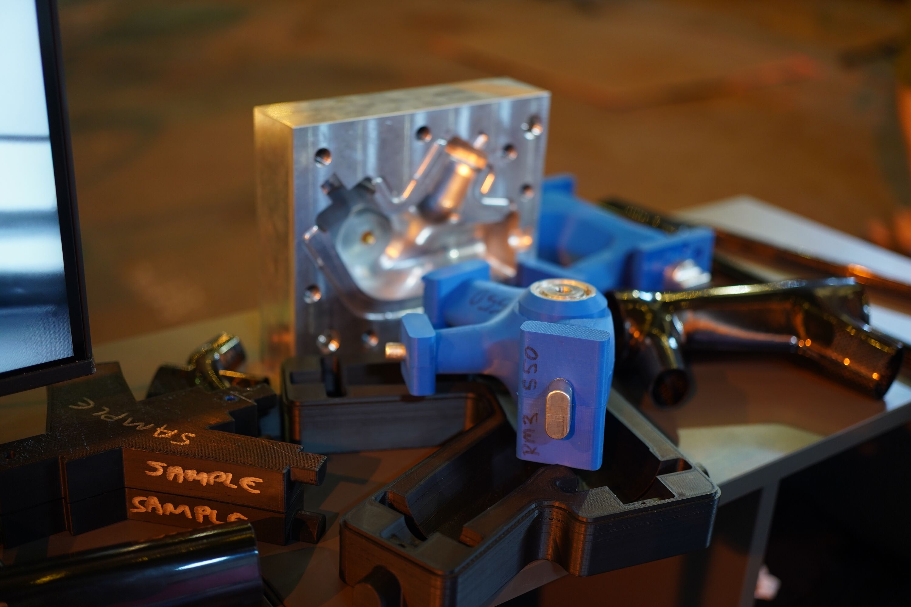

Even a professional company like Argonaut uses 3D printing in their carbon bike process.
In their case, they 3D print a mold to pour a silicone mandrel:
The clamshells are still machined aluminum, but the silicone mandrels help them get the compaction they need. No idea how they get them out though :rofl:

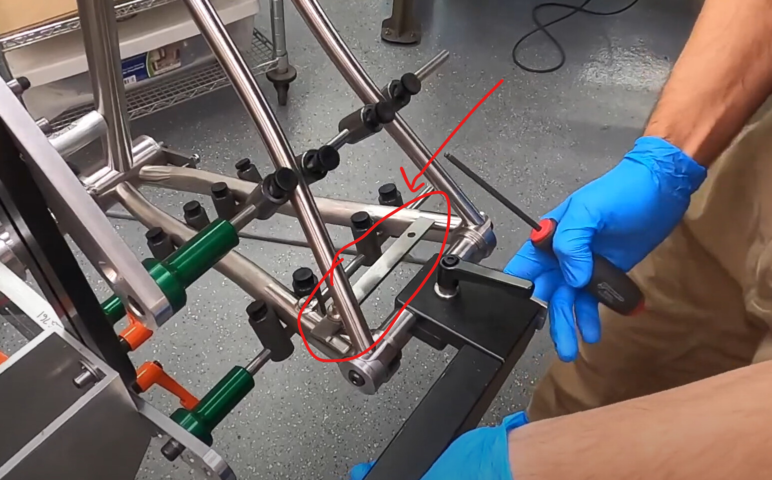

Thanks for sharing. Using a parallel block on the FM to visually make sure it is aligned is a great idea:
