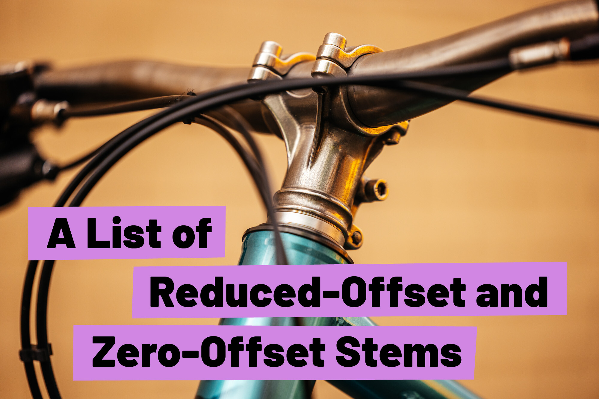

Mark,
There are a bunch to choose from today -
Excellent! Thanks Kirk, you rule.
The Discord Creemee (or Chromo Creemee) looks perfect, let’s see whether I can buy one or build one quicker. Laurie is eager to ride her new bike.
Though I am not involved anymore, I think Pacenti Cycle Design is (or will be launching) a 10mm extension version of the PDent system this year.
