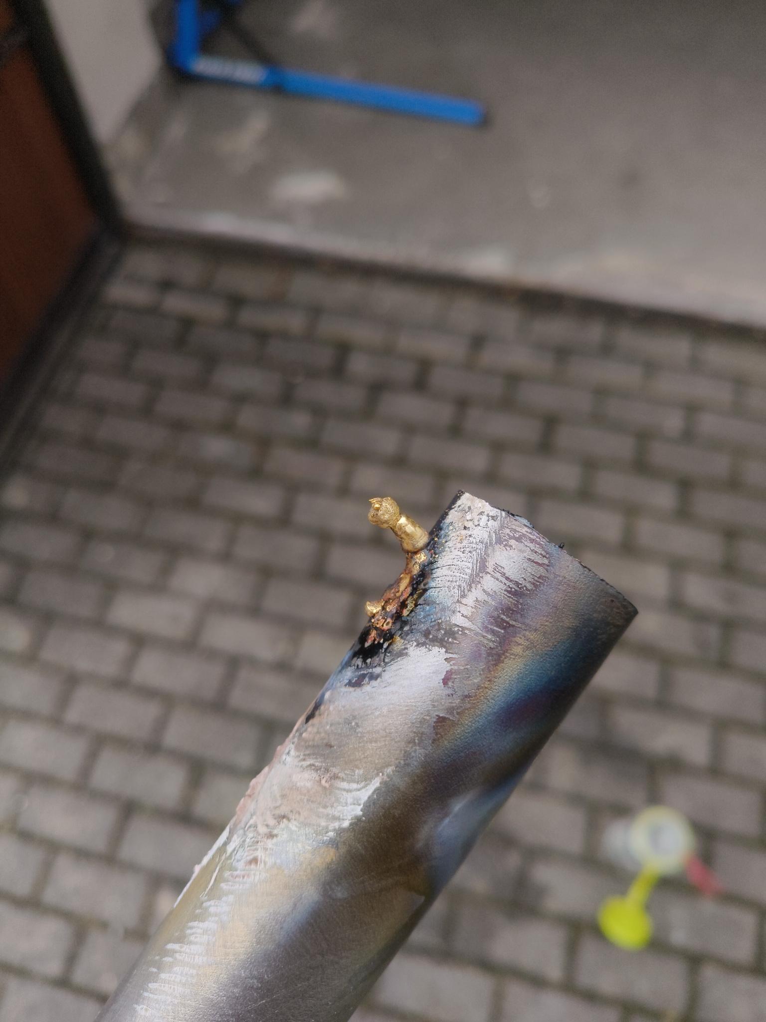

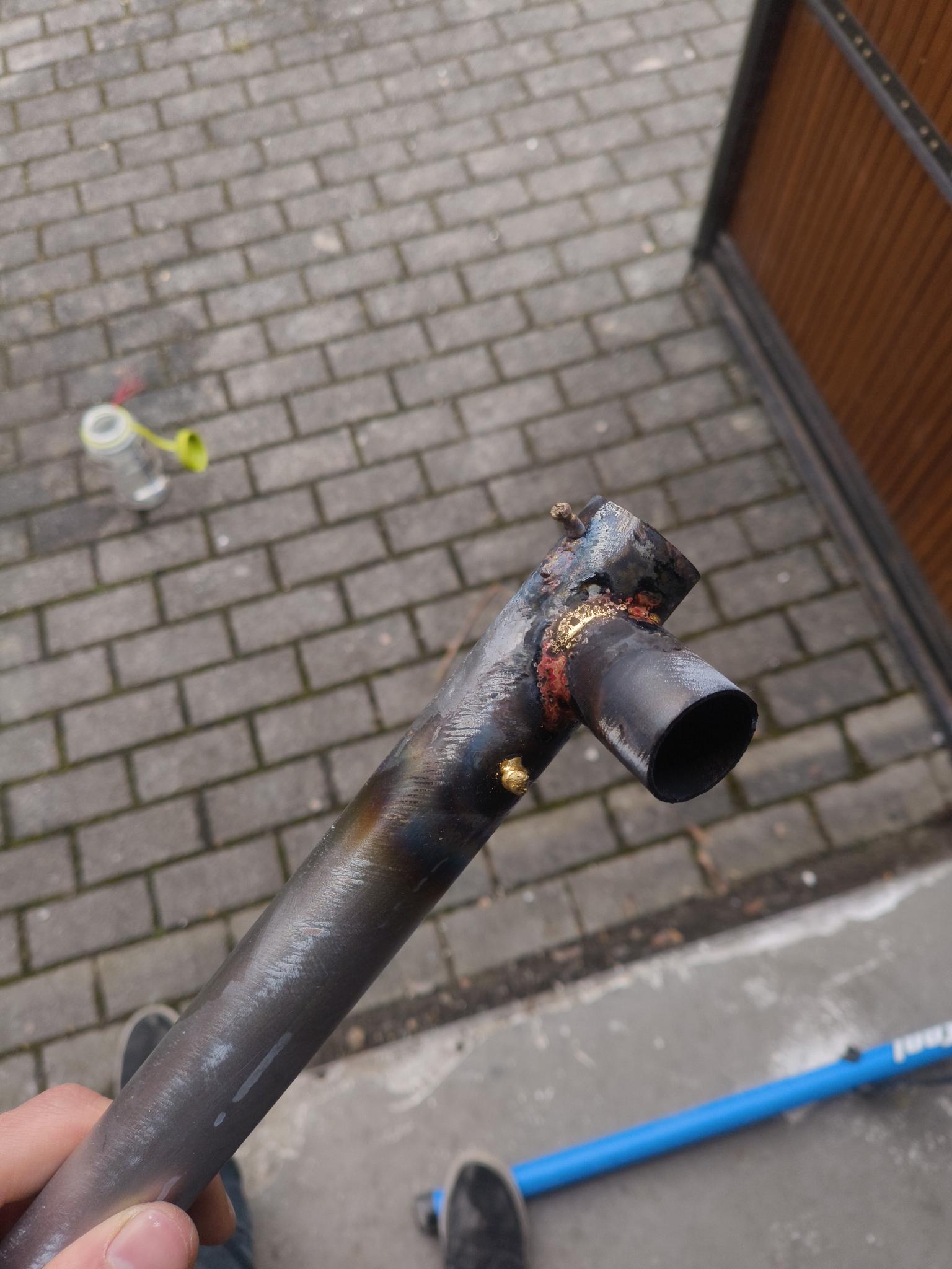

This weekend I was finally able to set up my torch, and to do my first bits of bronze-brazing. I tried building an icicle (inspired by Paul Brodie), as well as doing one tube-to-tube join (without trying to get a perfect fillet, it was just to get some feel for the process.)
This leaves me with two questions:
The tip of the icicle formed some sort of lump, that would not accept any further bronze. Does this mean it got too hot? And on the other picture, you can see some copper-colored sections in the “fillet”. Is this something to worry about?
I cut it open, penetration looked good. I also tried to break it, but the section I brazed onto the bigger one was too small and just bent. I will do more joins tomorrow, to see how strong these small fillets really are.
The problems you are seeing are exhausted flux and too much heat. Just do more joints like that and then clean it up and lay a fillet on top.
Edit: It is a good long-term goal to make some fillets in one pass, but I made my first three fillet brazed frames by making a first pass to focus on penetration, then a second to lay the fillet. It is easier to control the heat once the two pieces are joined, cleaned up, and re-fluxed.
