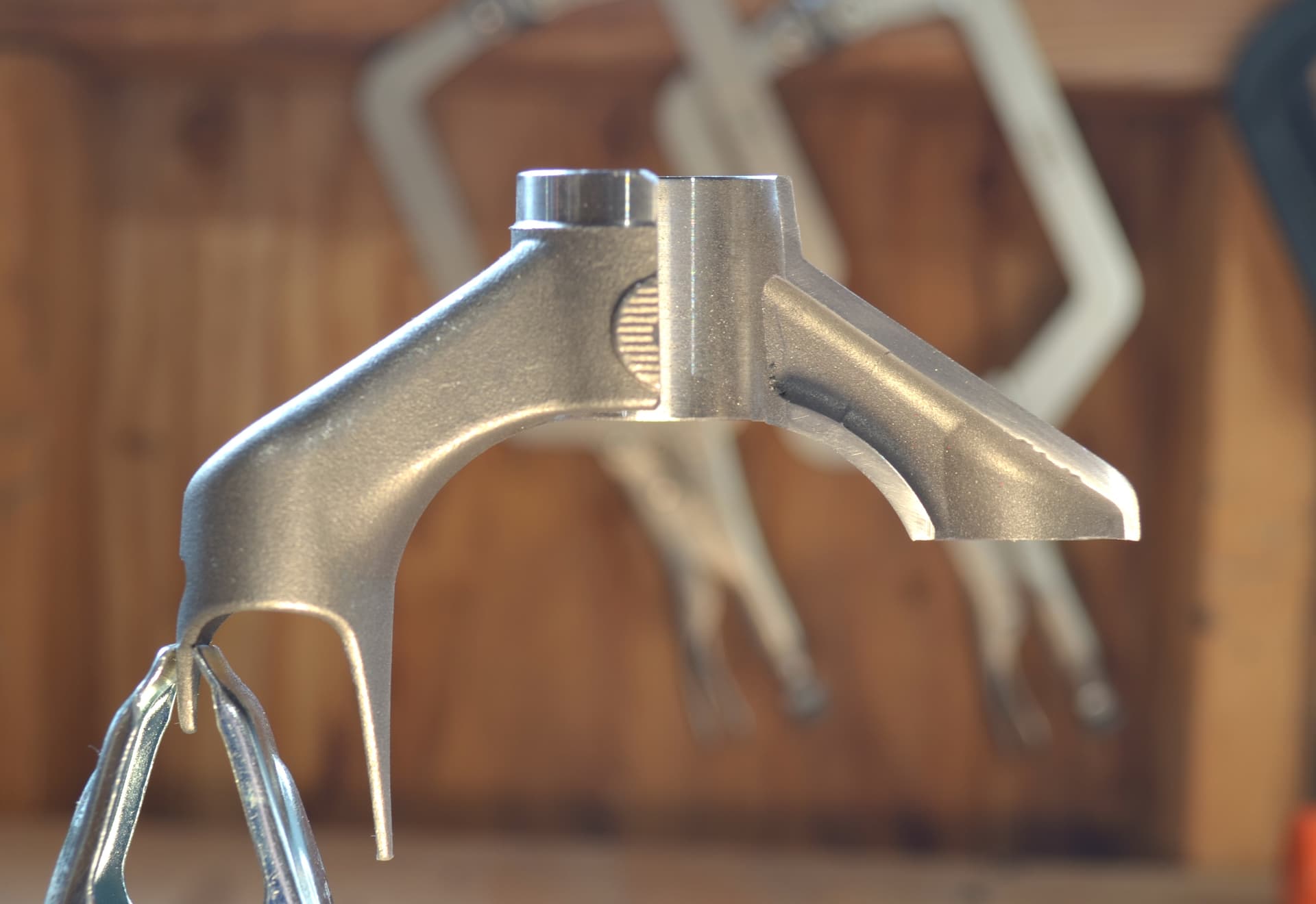

Re: make stress concentrations as small as possible: Last night I decided I wasn’t happy with the transition of the fork blades into the crown I designed so I decided to give the plug-style stuff a shot.
I’m much happier with this one. Perfectly smooth curves all around and I can turn up the wall thickness without the crown turning ungodly heavy.
Alright, finally took some photos of the sectioned fork crown. The wall thickness is about 3 mm, and the leg cross section is roughly 15.5 mm by 22 mm. There are a wide variety of cast fork crowns out there, each with different geometry, so I’m not sure how representative these numbers are of other styles. This crown in particular is the Allotec A24 with 60 mm of clearance between the legs.

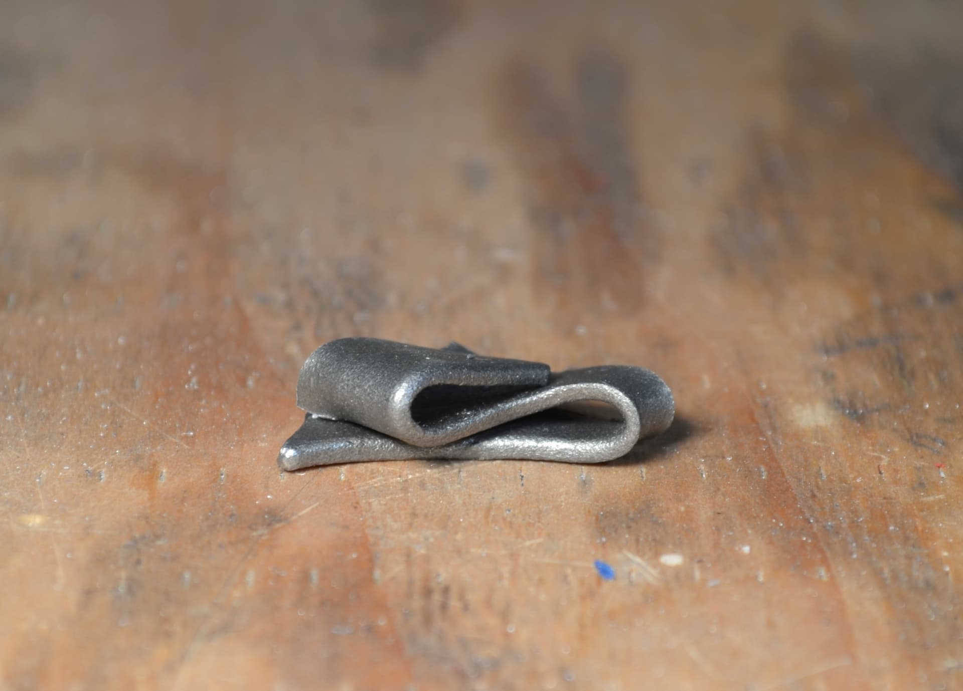

When I bent an off-cut after sectioning the crown it was ductile enough to be folded over on itself, for whatever that is worth.
Cool! Damn that’s a lot more ductile than I expected. How much effort was needed to bend that?
It took a bit of effort, but I folded it using just hand tools so it wasn’t too extreme. I did the final compression using a Knipex 180 pliers wrench, and I think the extra mechanical advantage those provide helped a lot compared to regular pliers.
This crown looks so good!
Have you made one?
Thanks! Unfortunately not, life has been getting in the way and I still need to get around to making the finishing touches on my frame jig and actually make my first frame.
