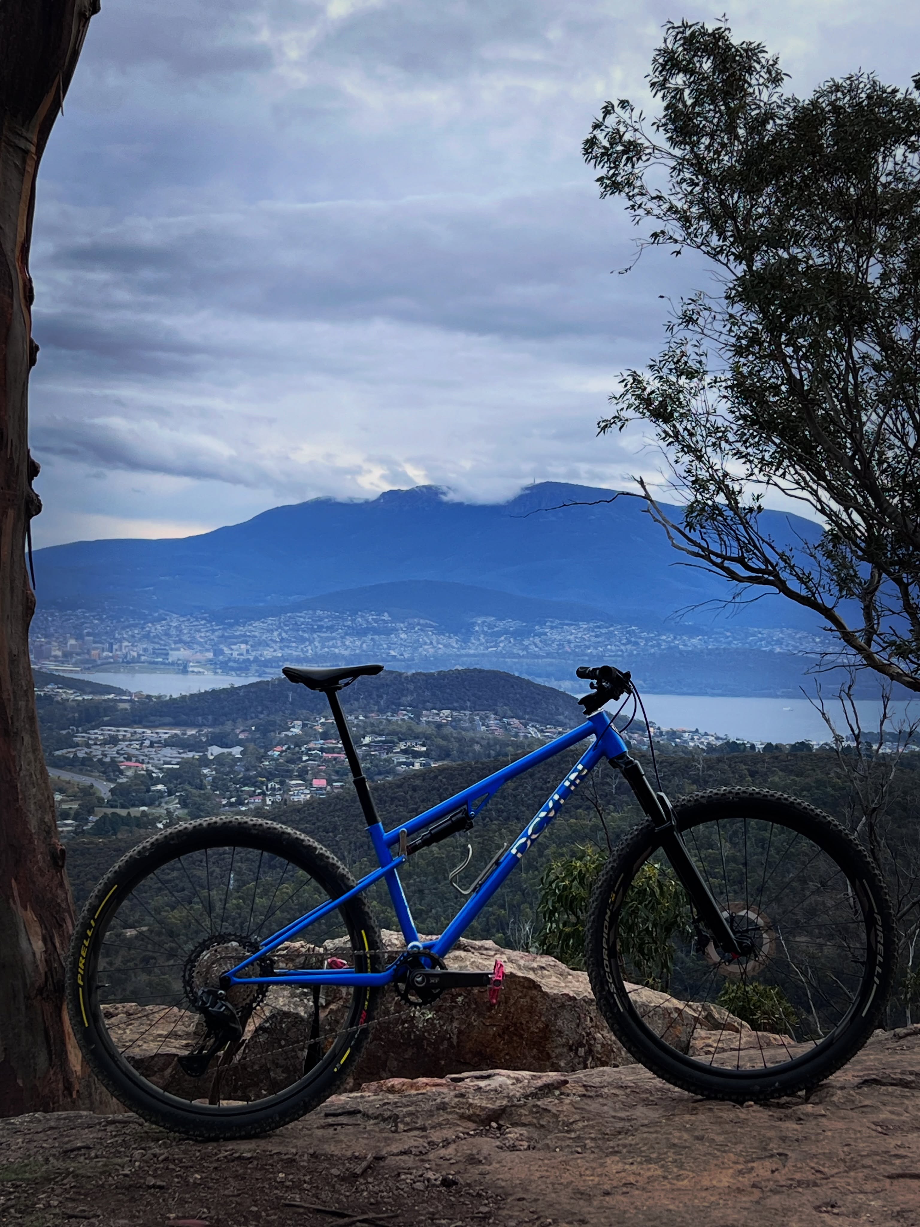

Slightly different post but a couple stages from last weekends State Enduro Champs at Derby. I struggled with the early pedal heavy stages but the Jester shined bright is the fast technical stages. So much fun.
Below is link to last stage…….

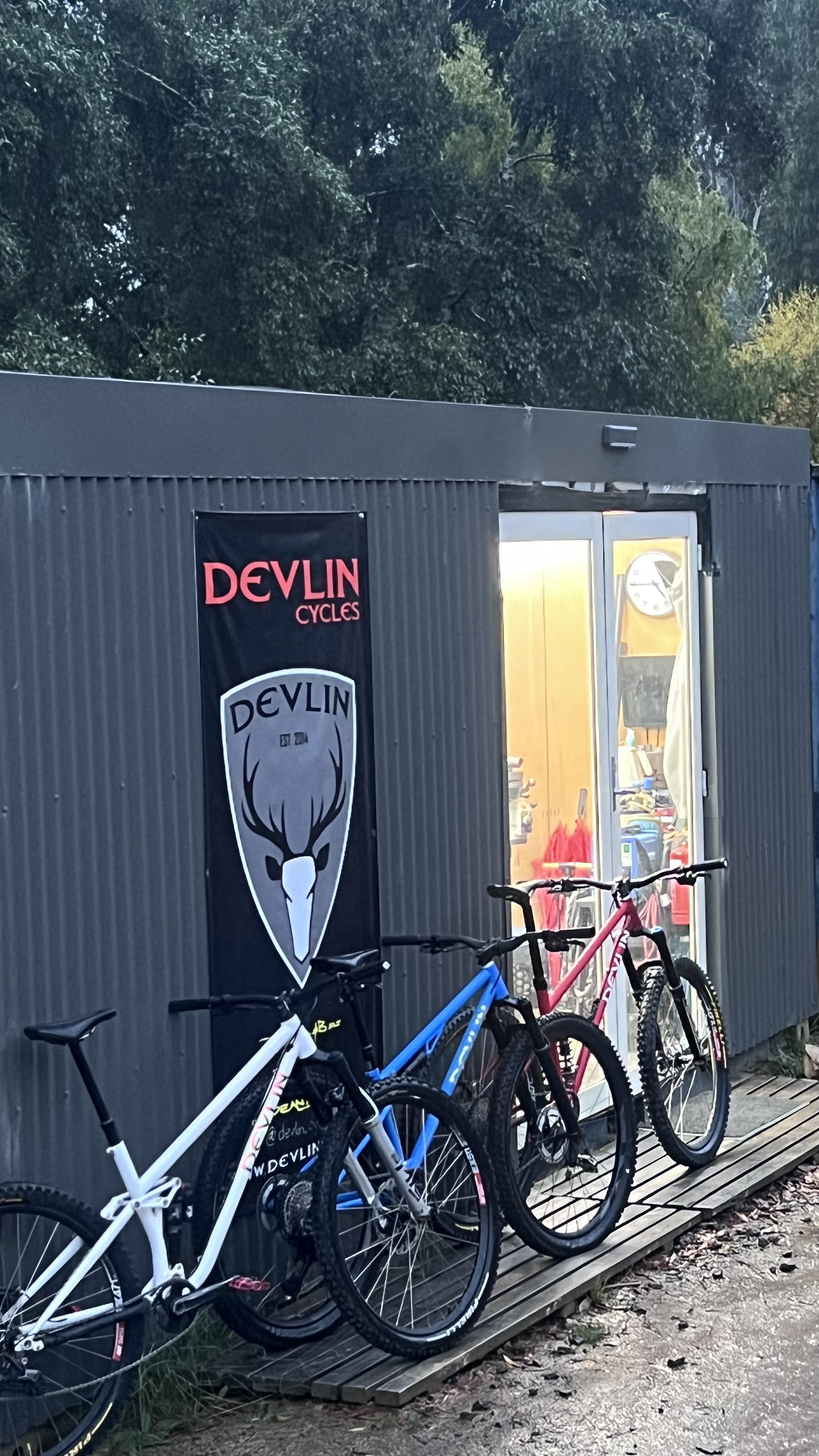

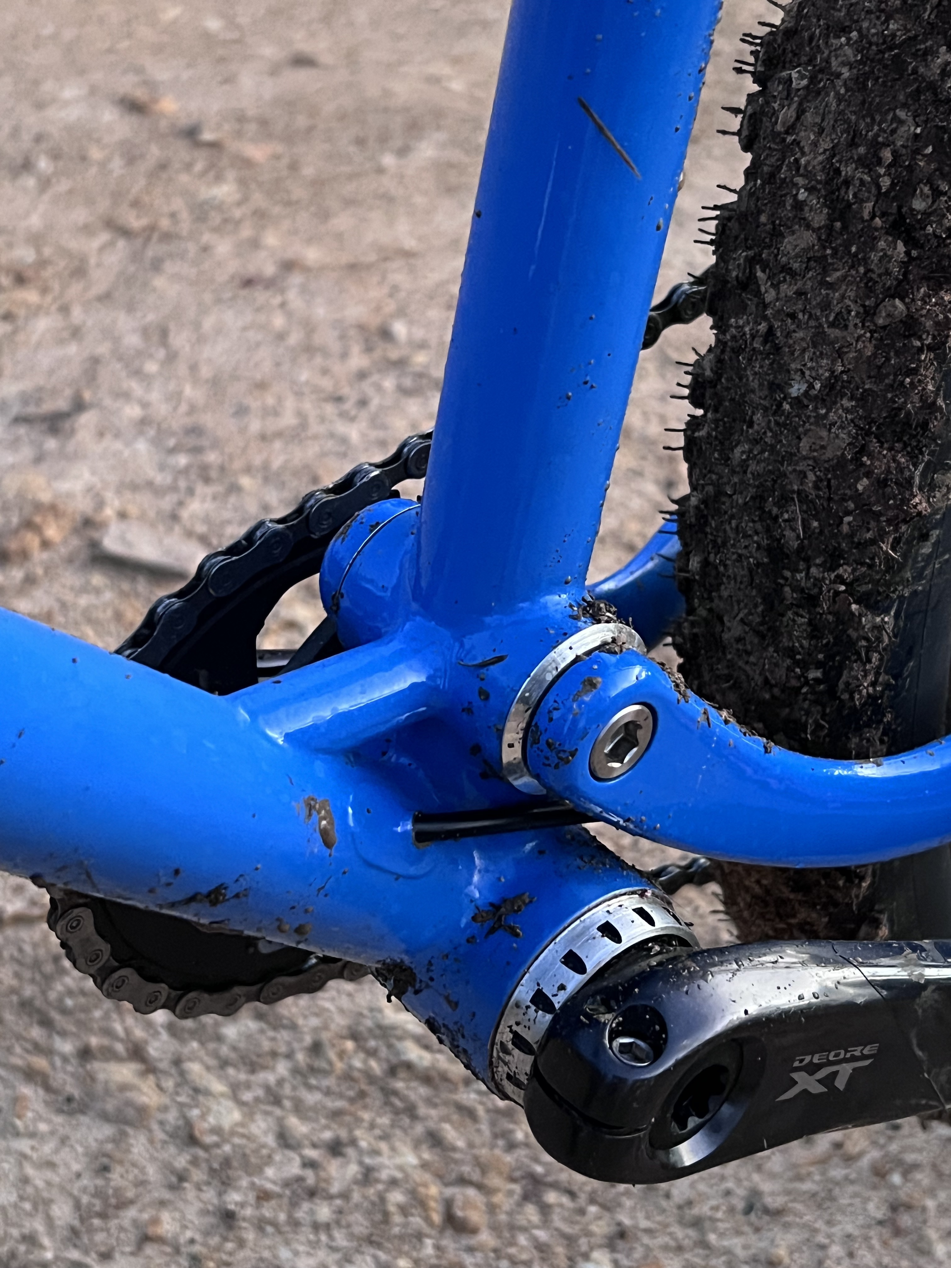

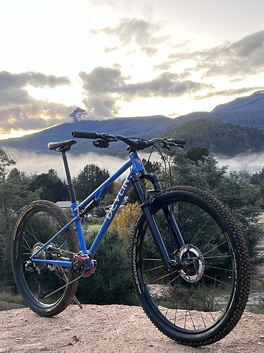

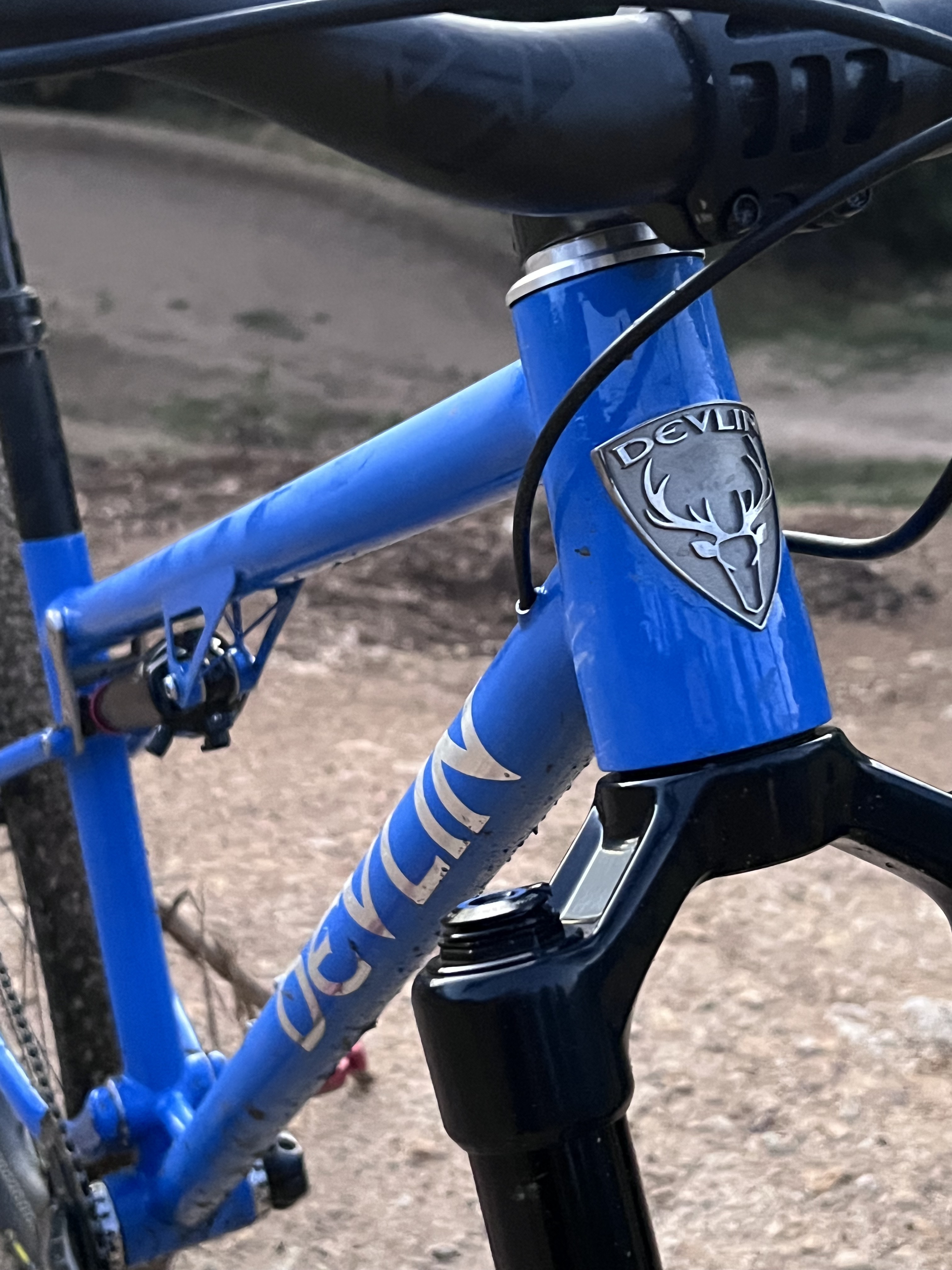

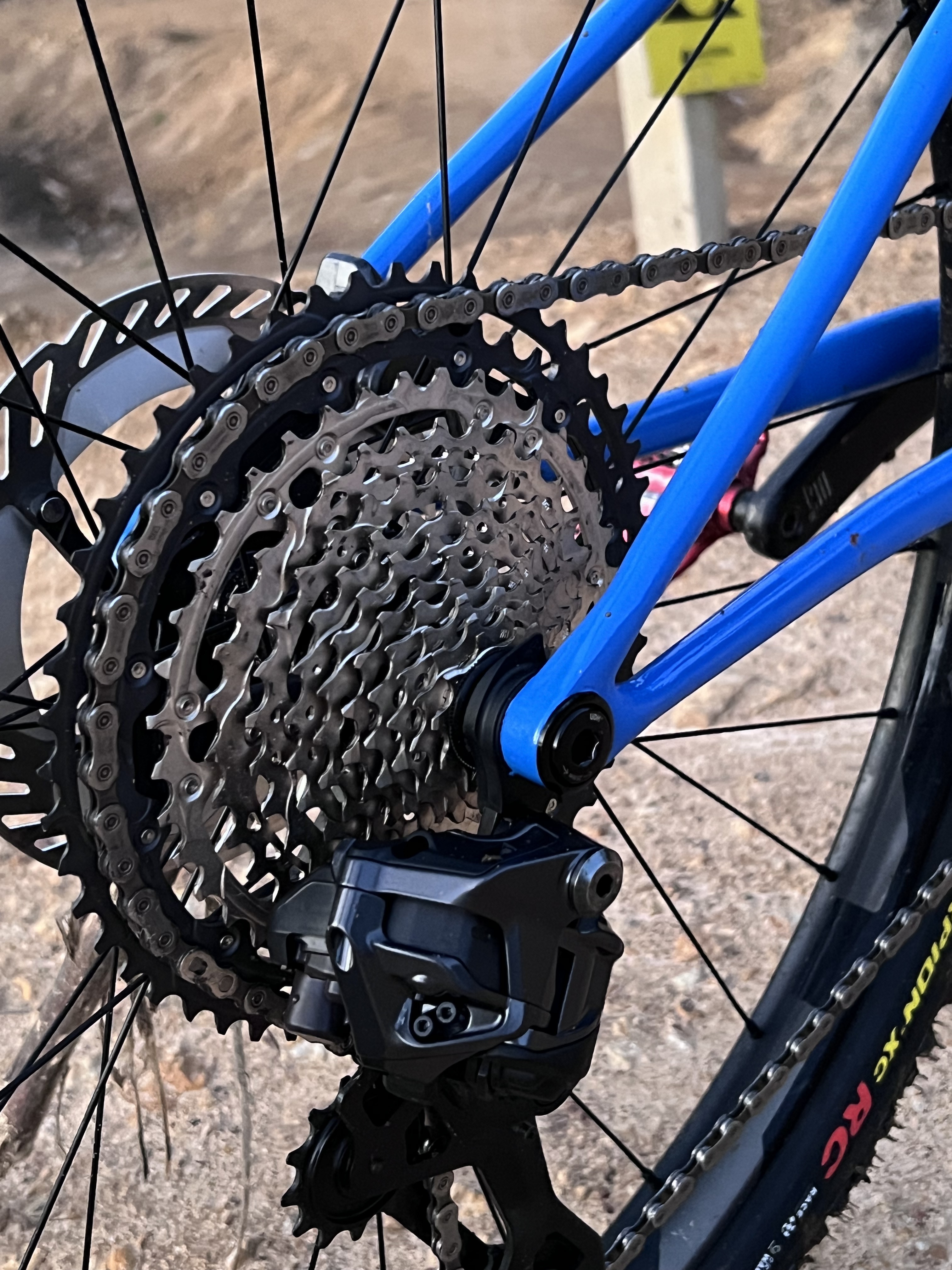

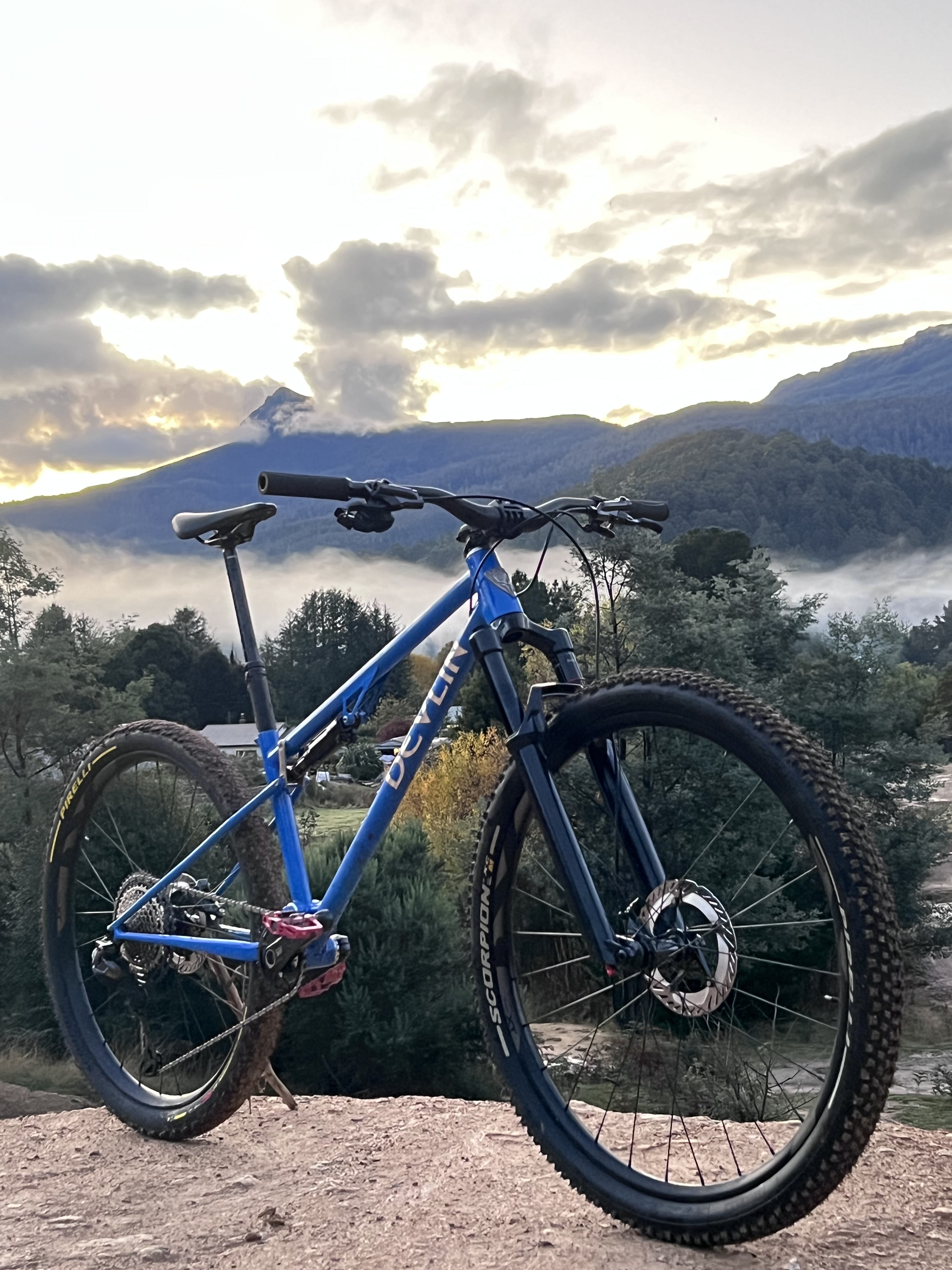

You my friend make some beautiful bikes.
Thank you. That is very heart felt. I try so hard to make them look good so I’m glad that people do appreciate them.

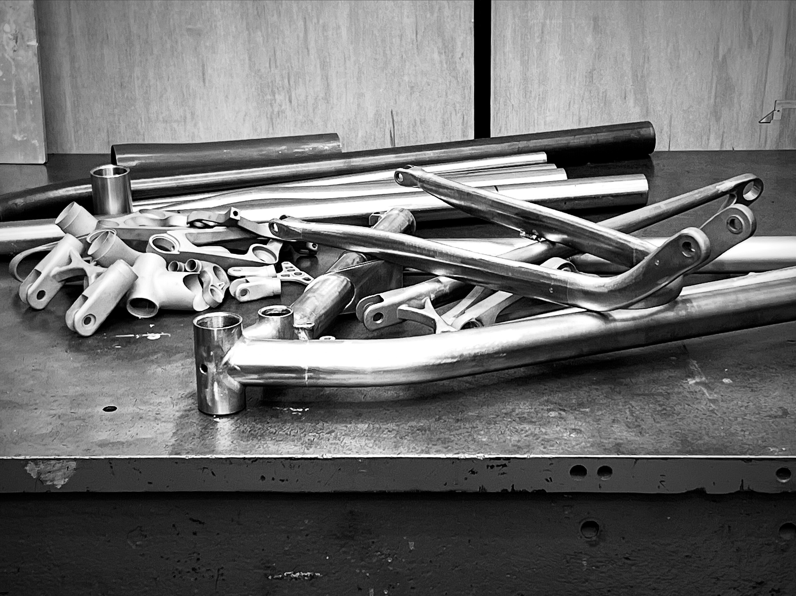

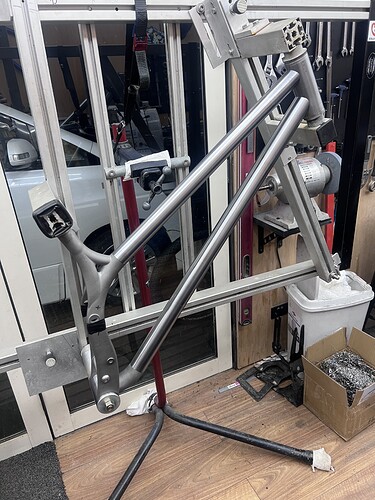

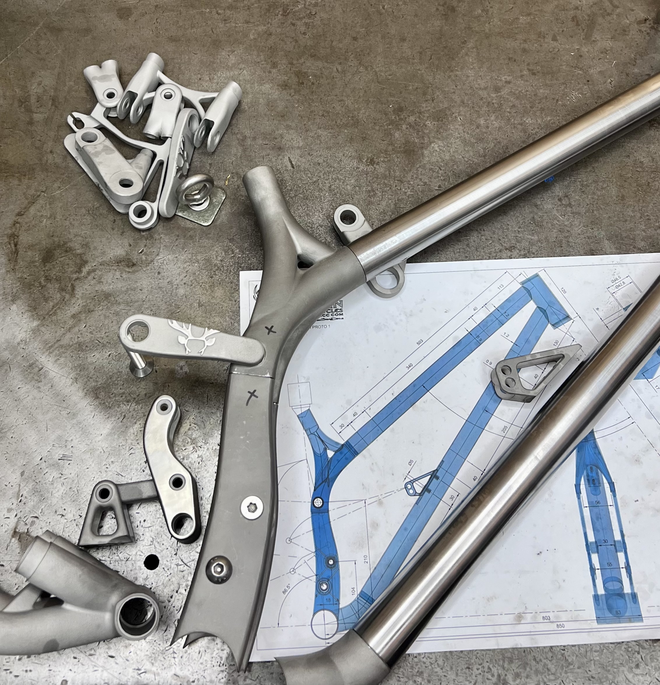

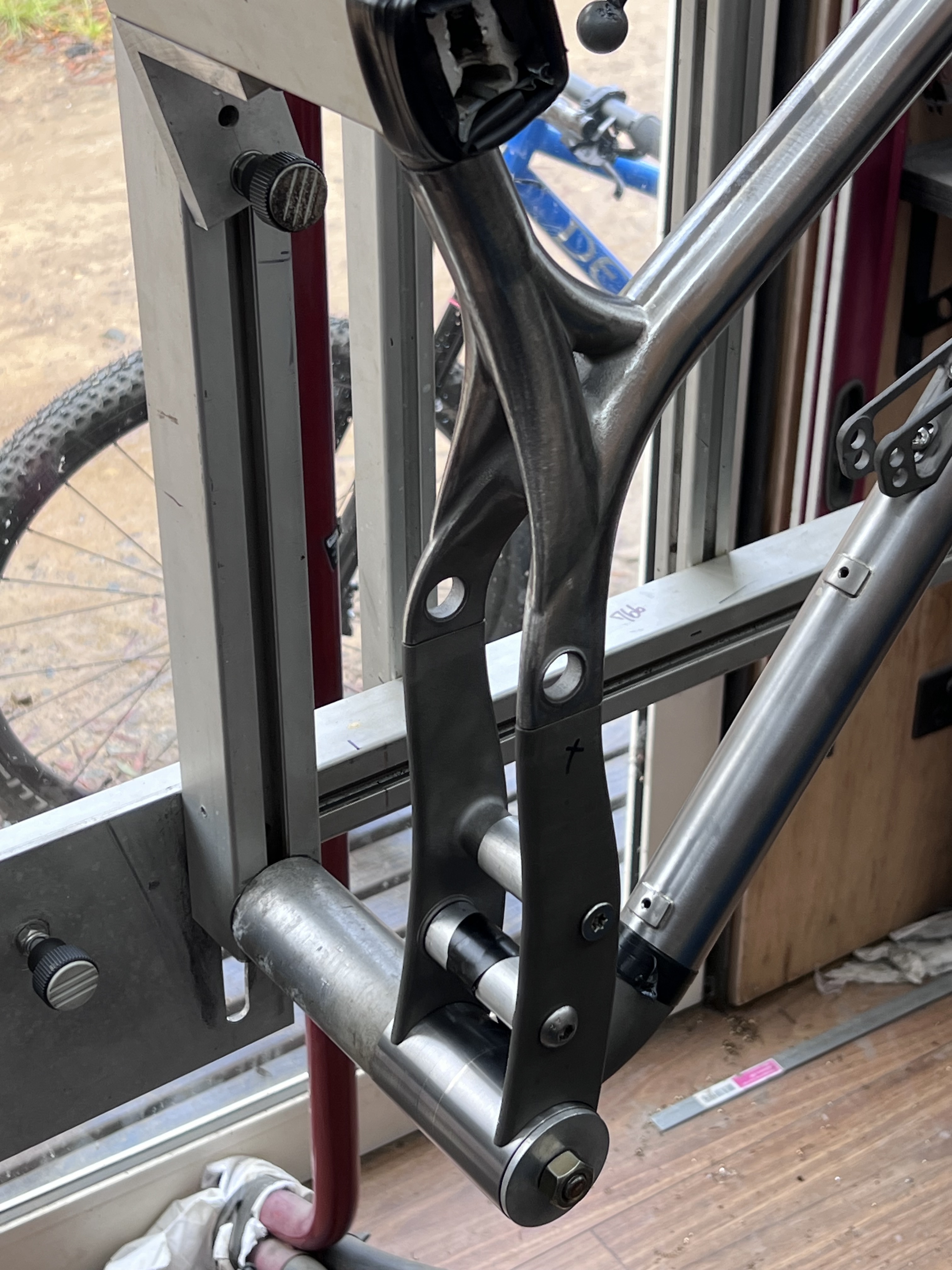

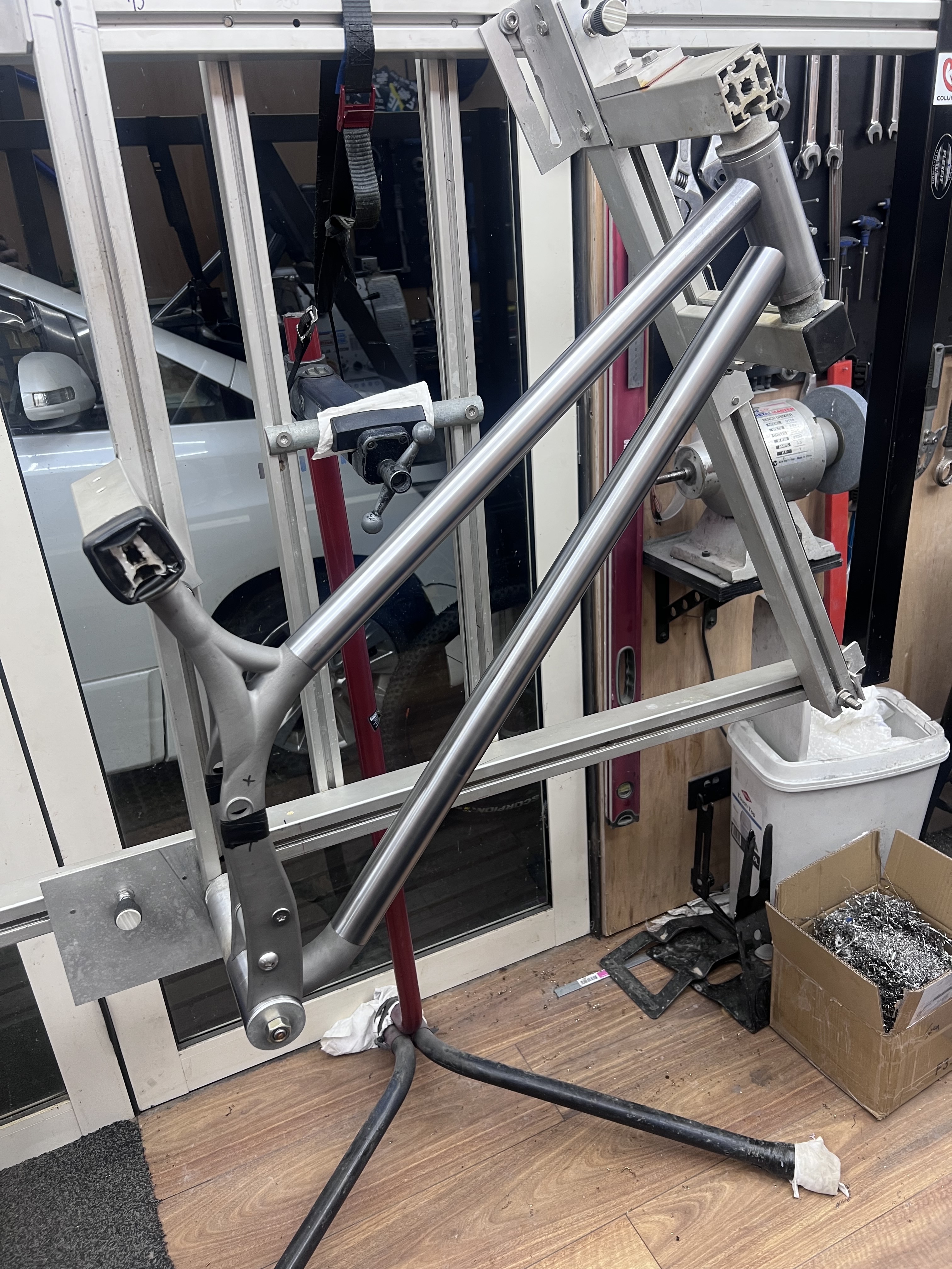

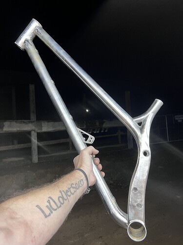

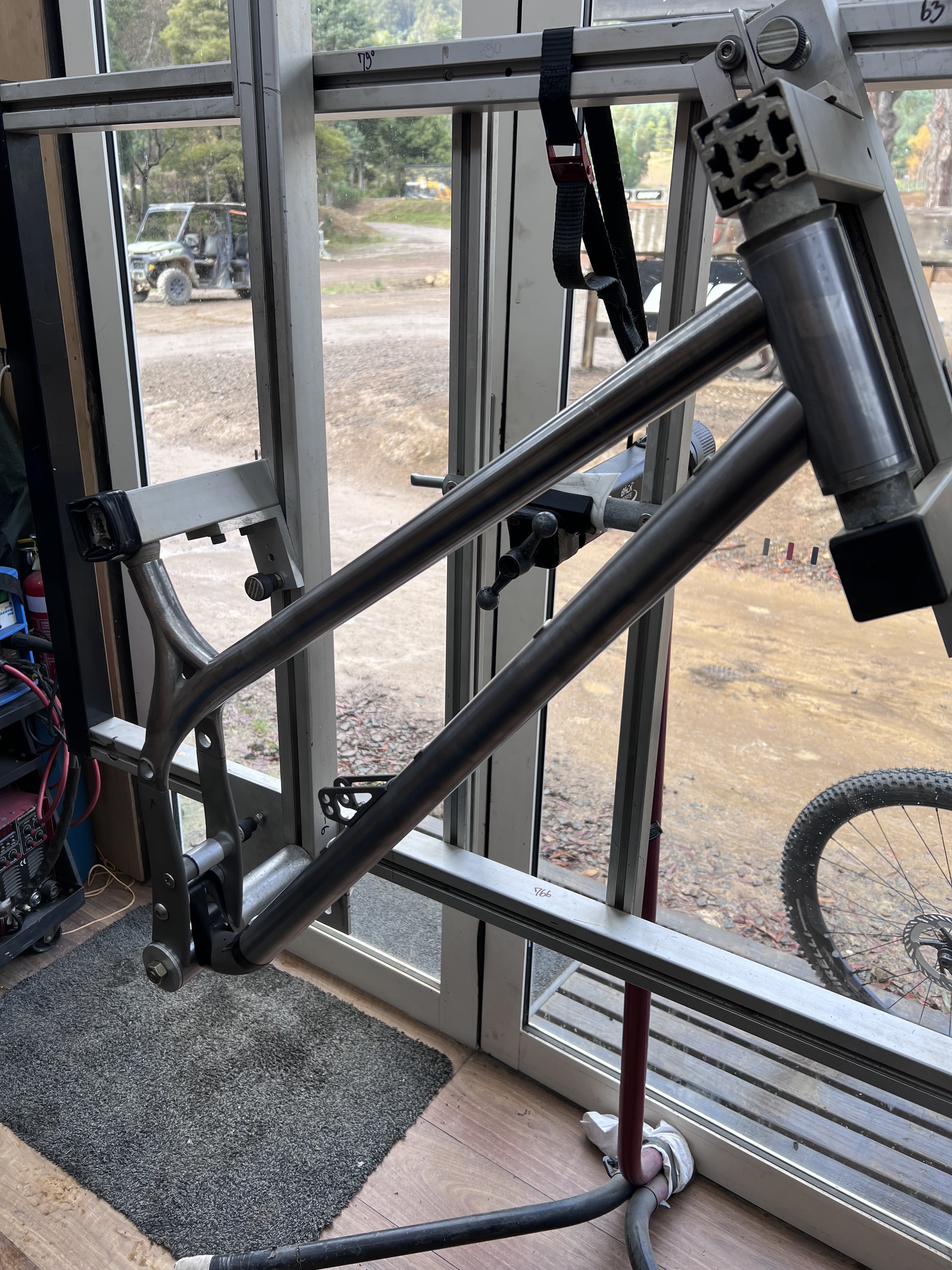

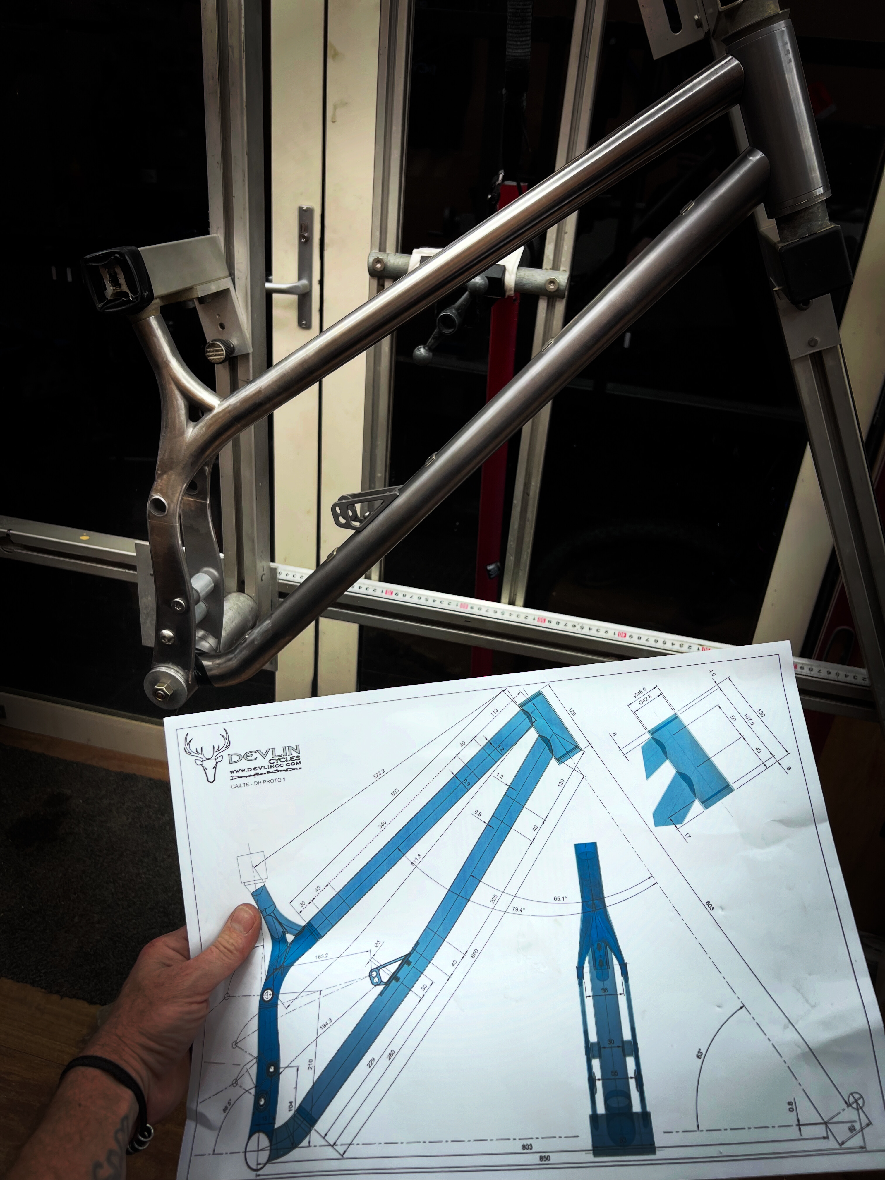

Still some clean up and a seat binder to do. Will check alignment tomorrow.
Downhill bike?
Yes. Will do the rear end today then get stuck into the final details.
That’s great. I am slowly working on the F360 skills since I want to build a FS short travel 32”.
Keep grinding away it. It’s a deep soul satisfying thing to do.

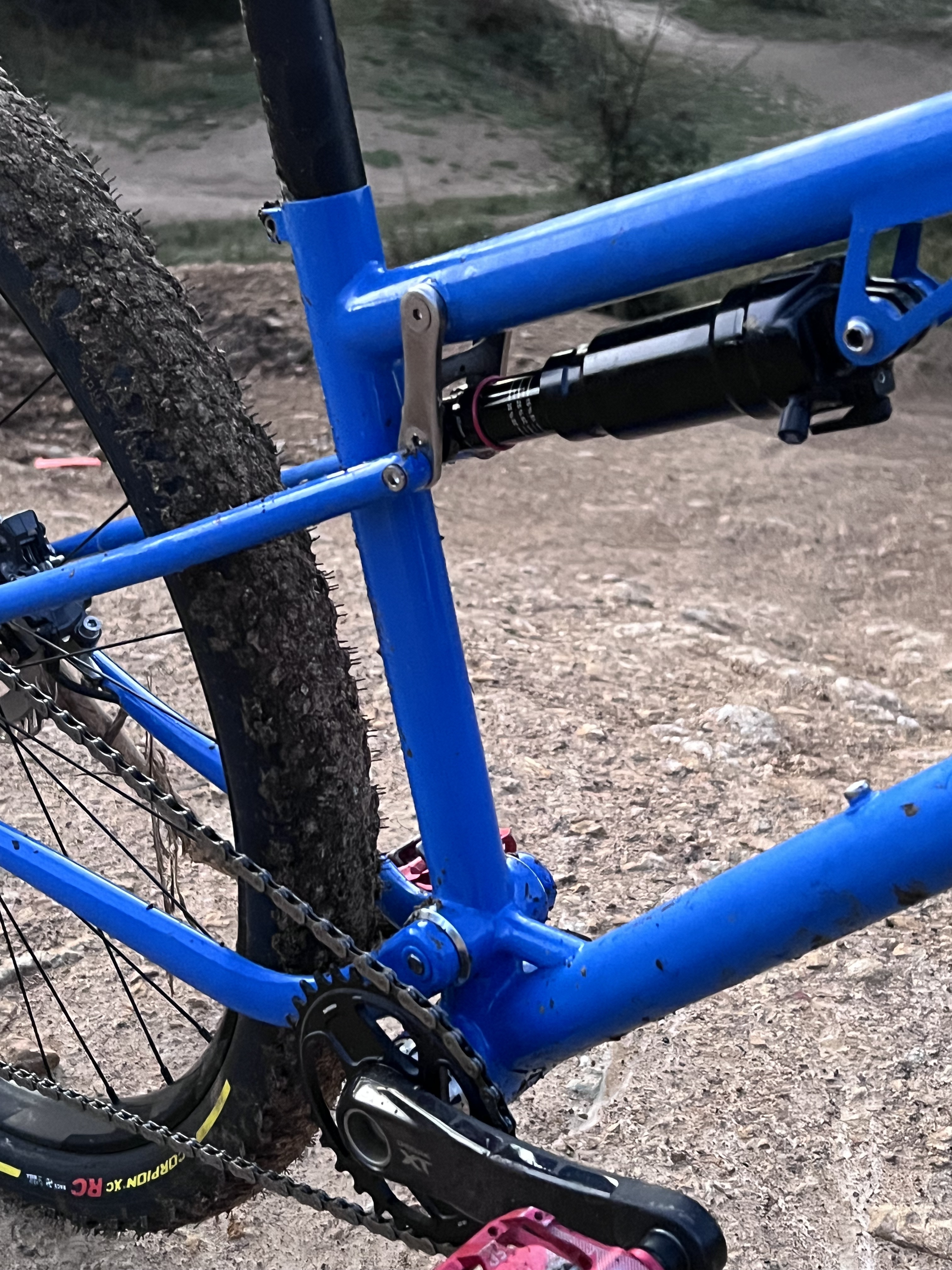

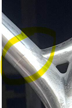

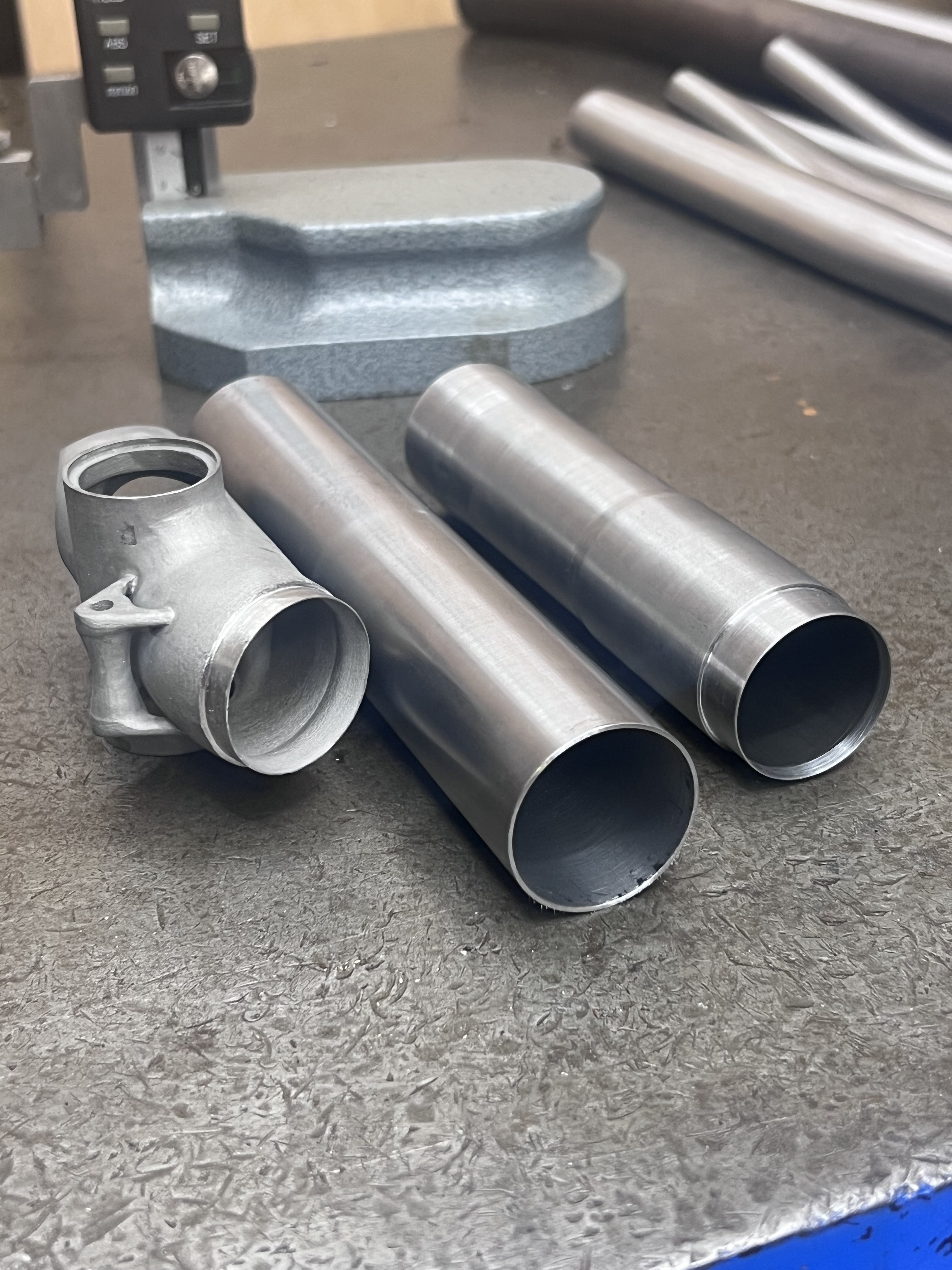

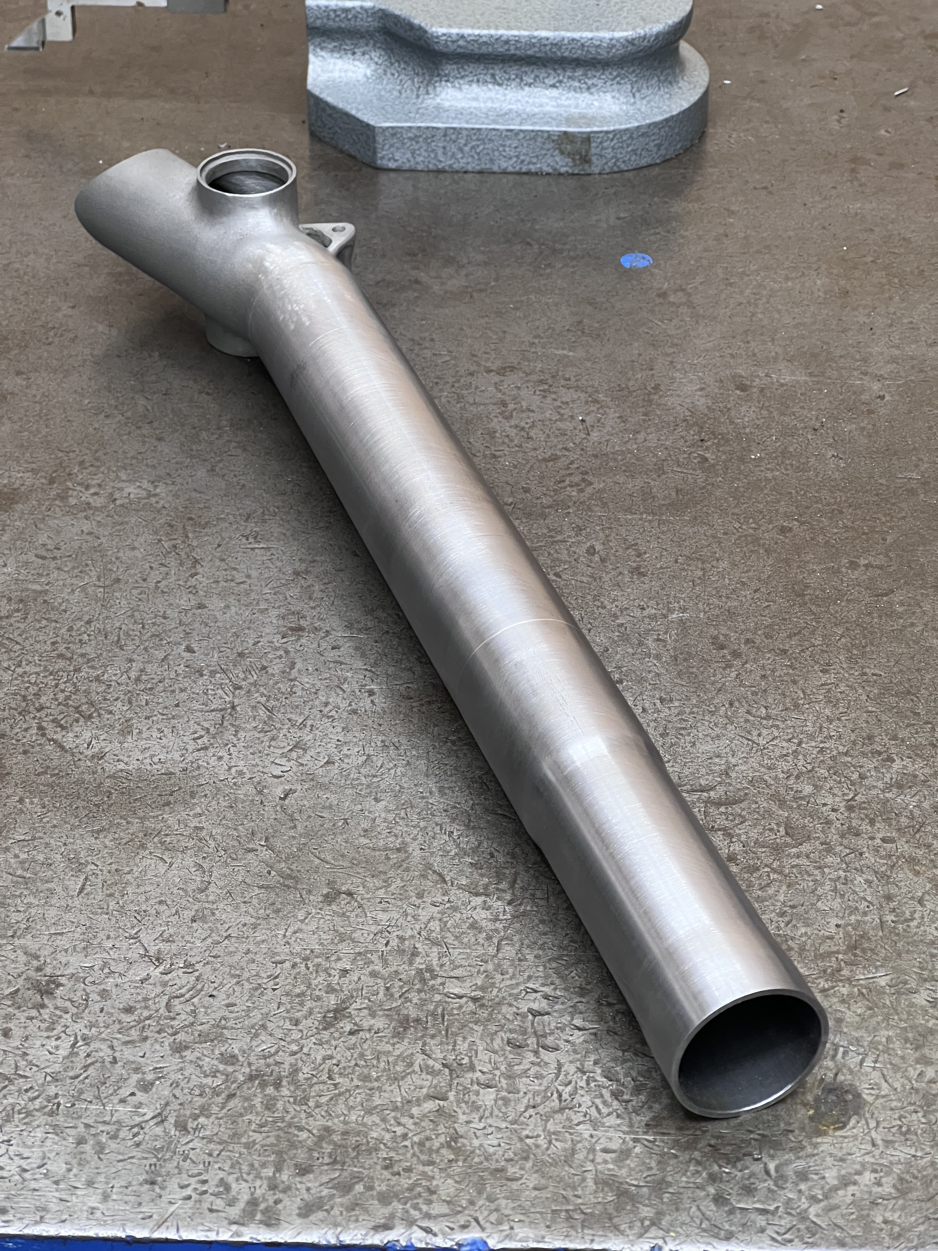

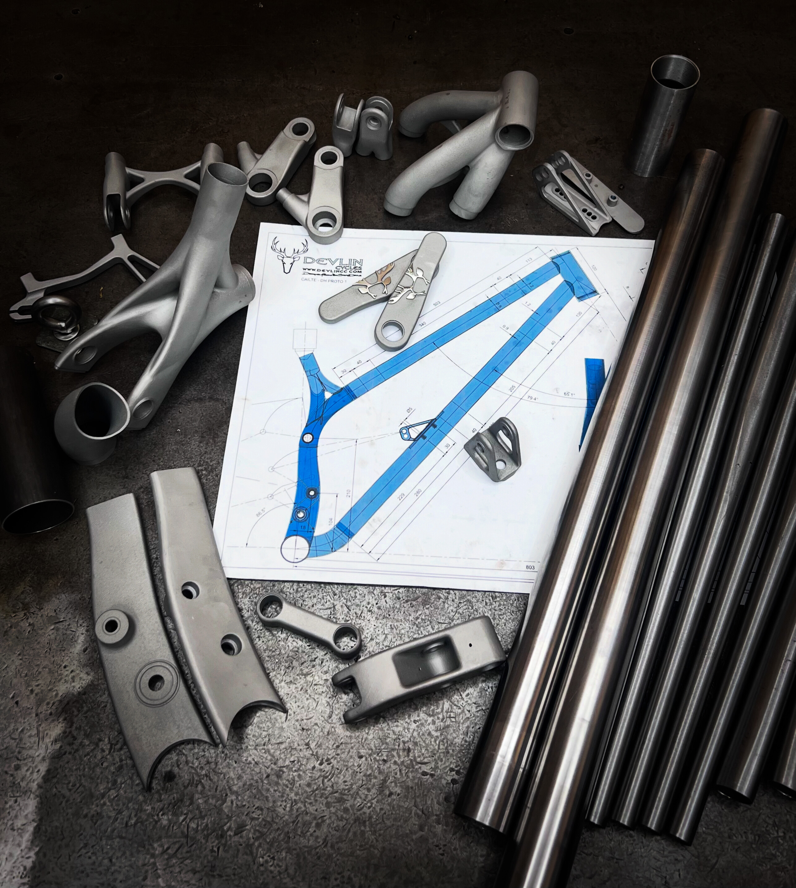

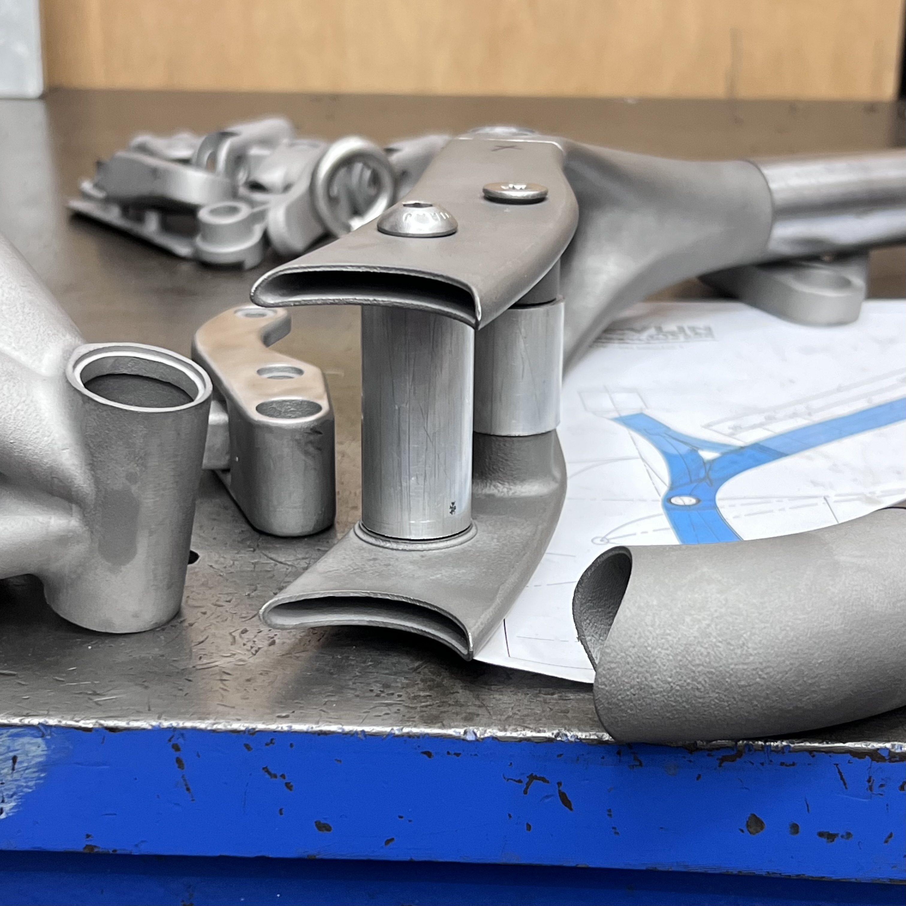

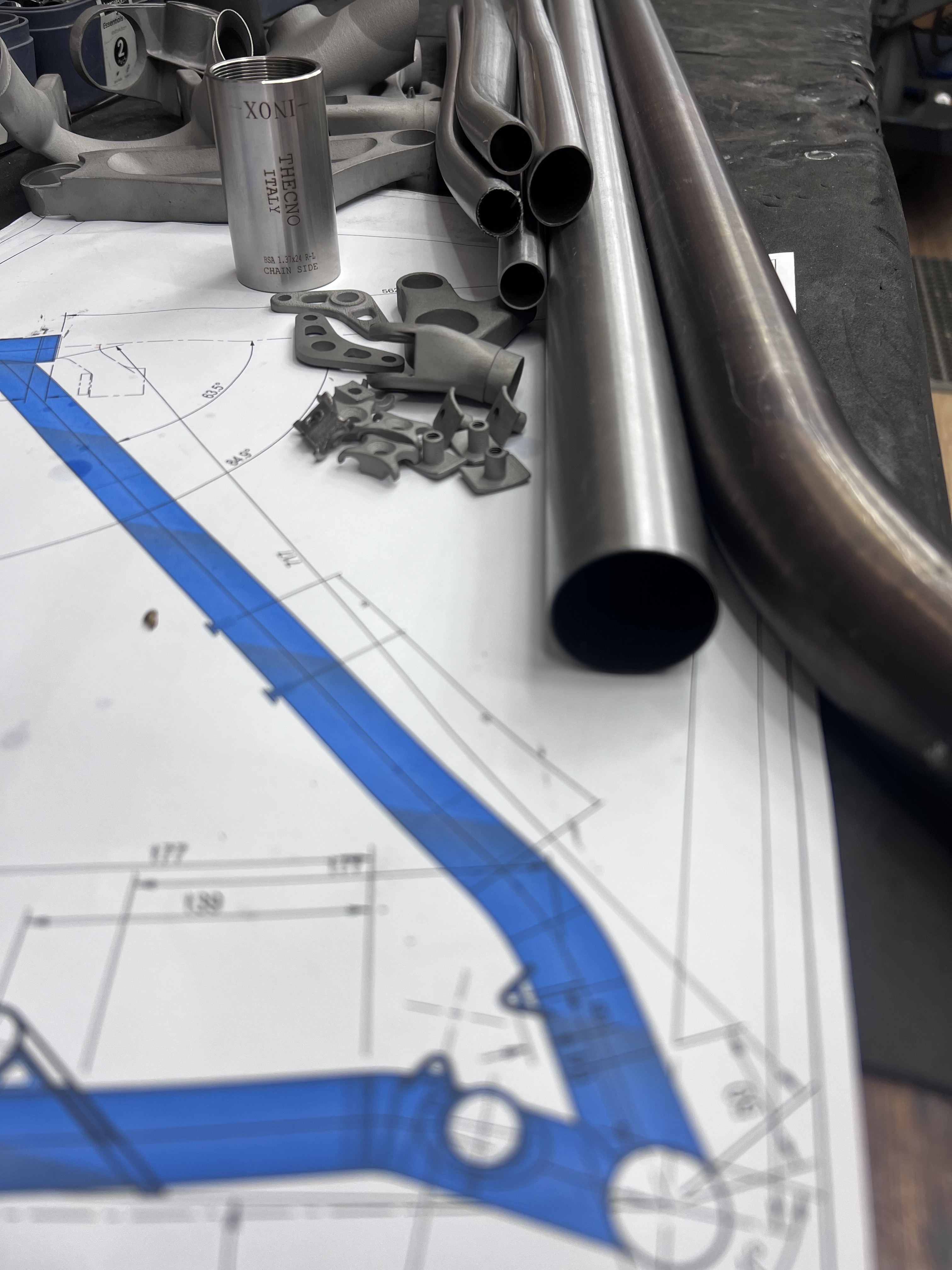

This is amazing! What type of brazing do you do for these joints?
These are basically a reveresed lug joint and are silver brazed as the 3D section is stainless.
