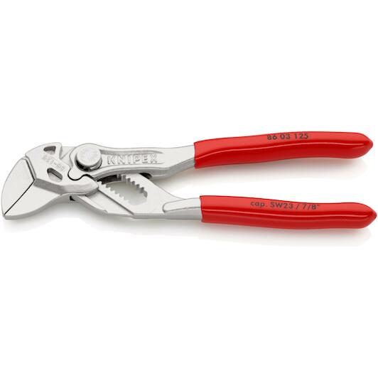

This reminds me of the little Knipex plier wrench I recently bought! That has an insane amount of leverage, I’ll try using that on the frame I’m planning to build.
It’s this tool:
Impressive leverage and you can set the width of the opening, sounds like a perfect recepy for dimpling chainstays.

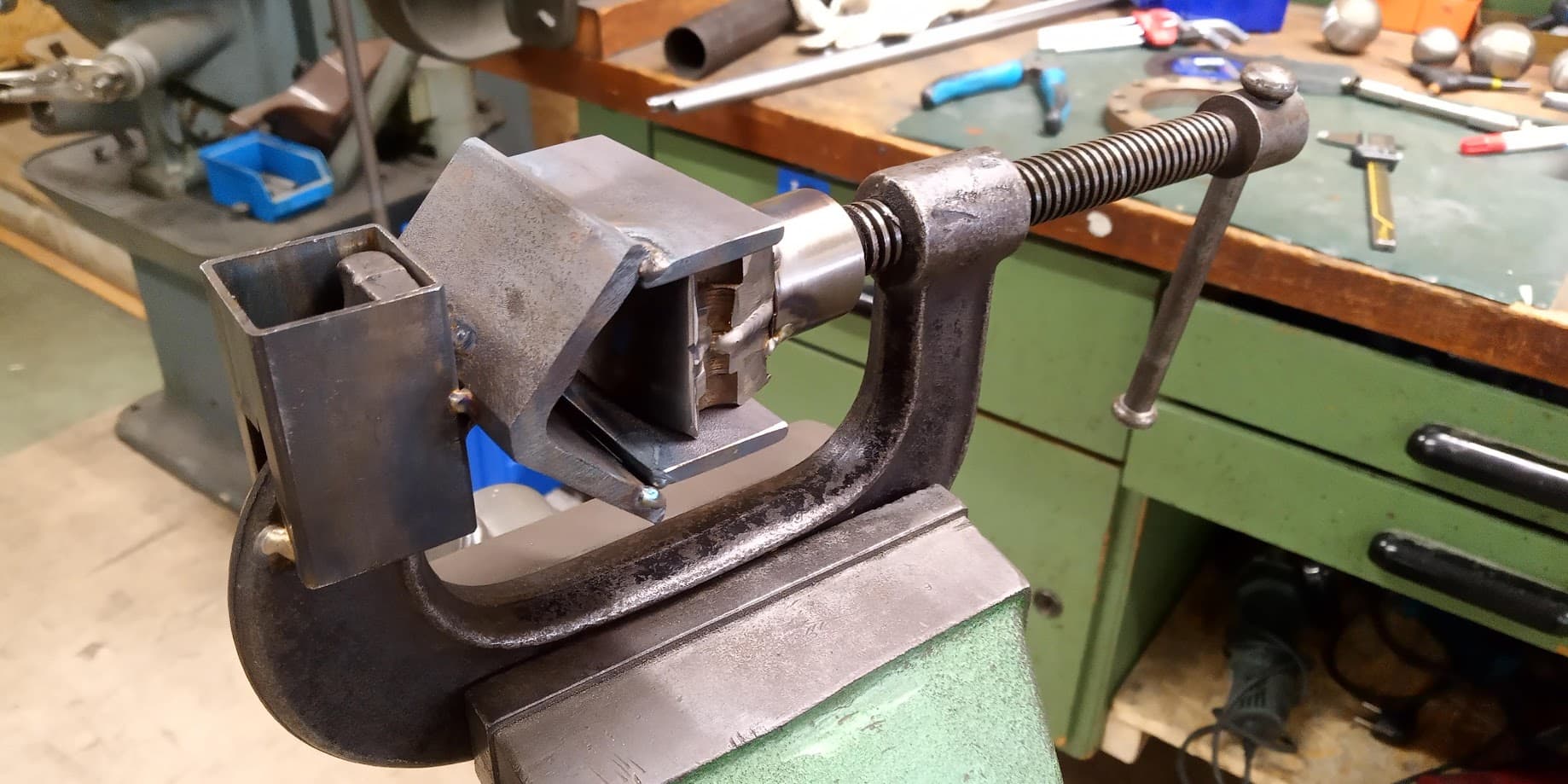

I dimpled with a C-Clamp and some makeshift pieces of steel tubing, planning to make my own but then I bought this one:

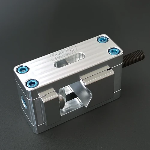

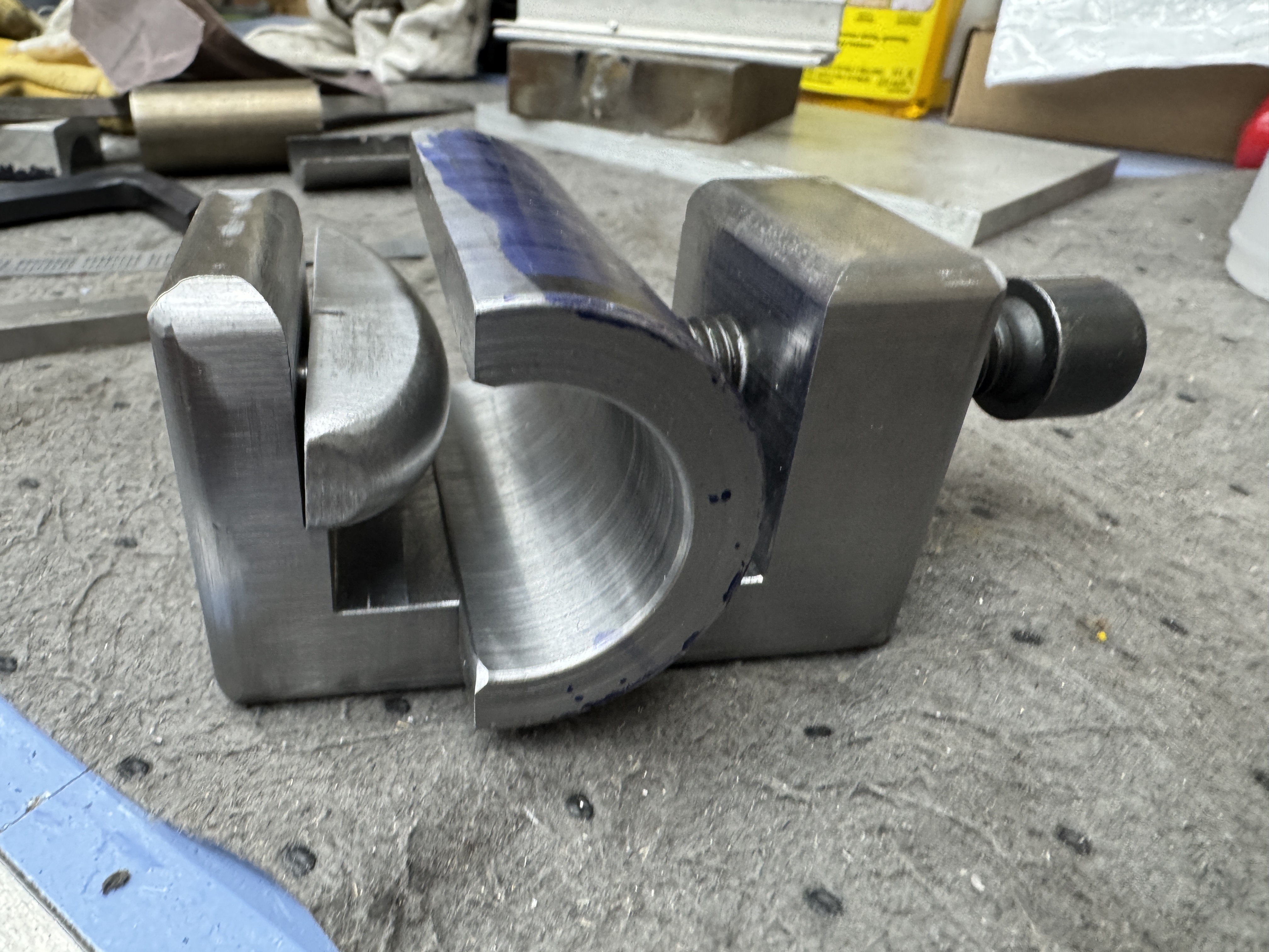

I recently made this one. The die and tube cradle are replaceable for different tube shapes and sizes and it fully supports the outside face of the chainstay.
@matt Happy with it ?
Saw posted already
Yes, works well!!
Do you have to take the lid off to get it around the chainstay and then replace when using?
yes, if you are working on a closed rear triangle you need to remove one of the faceplates to fit it. For my needs it’s an acceptable compromise

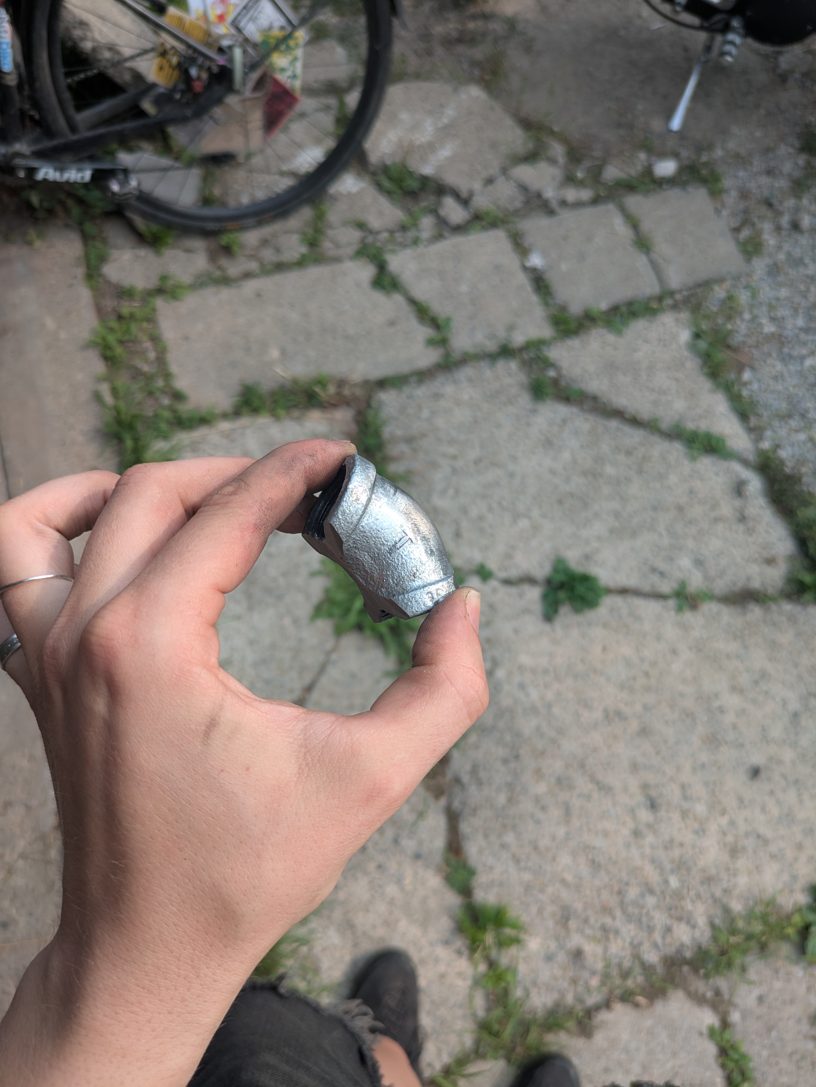

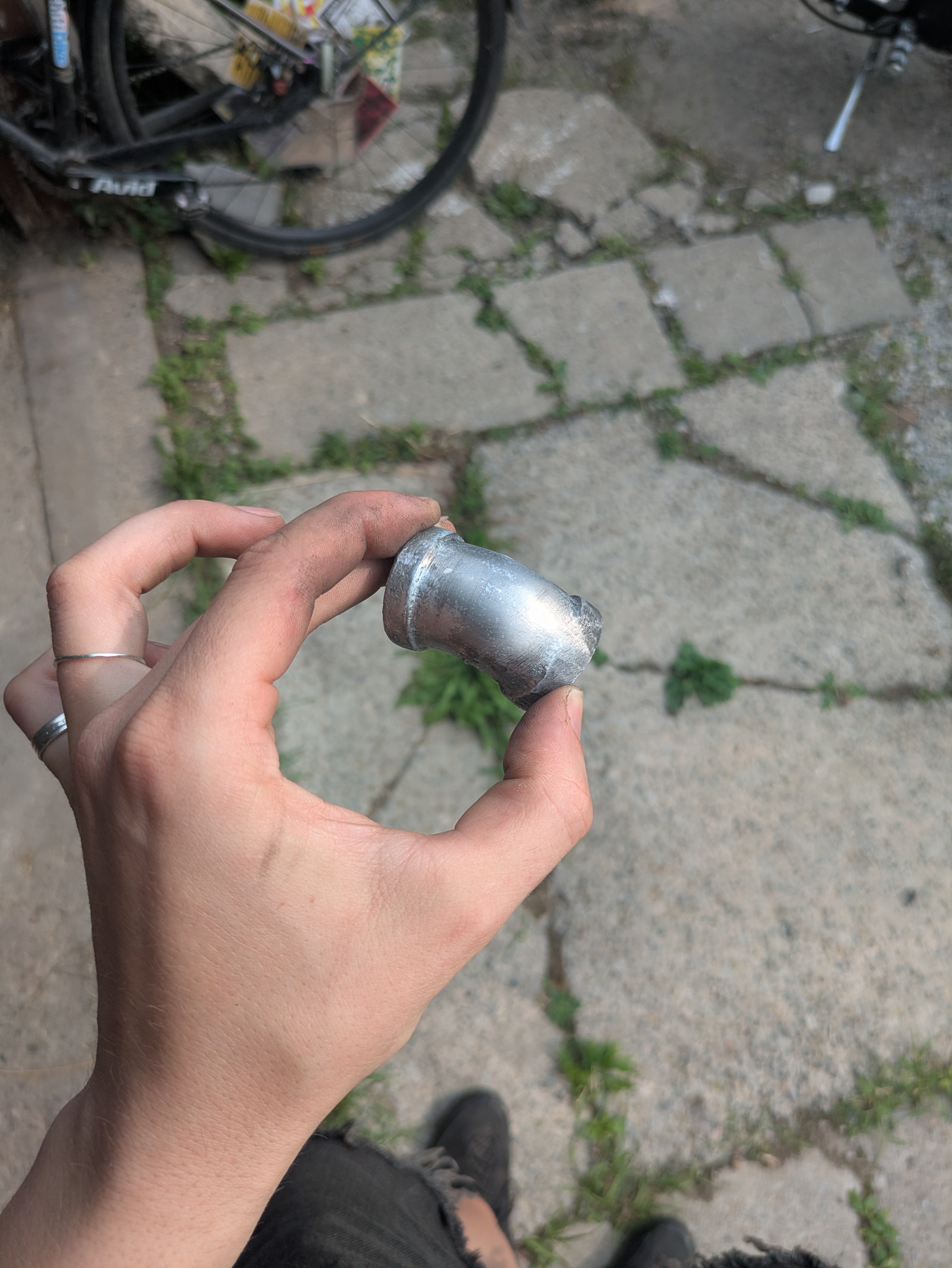

Adding a cheap option to this list for begginers, i made a die for a friend using a 45° 1/2" steel plumbing elbow and some filing to cleanup the casting texture, with a wooden tube block on the other side it works pretty well
