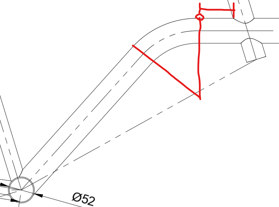

I think my question belongs in this thread. How do you measure a tube that you you’ve bent to make accurate cuts? I have a tube that I’d like to bend and than need to cut it to BB and HT. Somethng like in the picture attached. I guess I need to bend it first, than index in blocks so it’s in the right plane, but than - how to cut it?
What I would do in this case: Bend the tube first, then, by laying one of the straight bits on a table and looking where the light starts shining through, find the “starts” of the bend. Measure the distance from this point to both cuts and mark them on the tube.
In you particular case (your DT is larger than your headtube) do the headtube cut/punch first because you can’t “sneak up” on it. Then do the BB mitre, starting a few mm longer than where you marked it and adjust until it fits…
I don’t understand the question, or more to the point, why it is a question. Why not measure it exactly the same way you measure any tube for mitering? The placement of the curve relative to the ends doesn’t need high precision, does it? I assume eyeball is close enough for any bent tube scenario I can think of. Just ignore the bend and measure miter to miter in a straight line. Clue me in if there’s some reason that wouldn’t work for you.

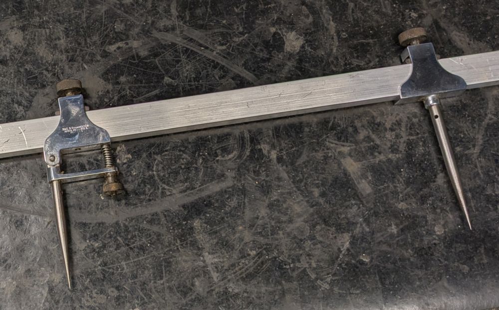

I like to use a beam with trammel points, that I set to length on a steel rule. Then use the trammel point to scribe a line, maybe through a Sharpie mark for visibility.

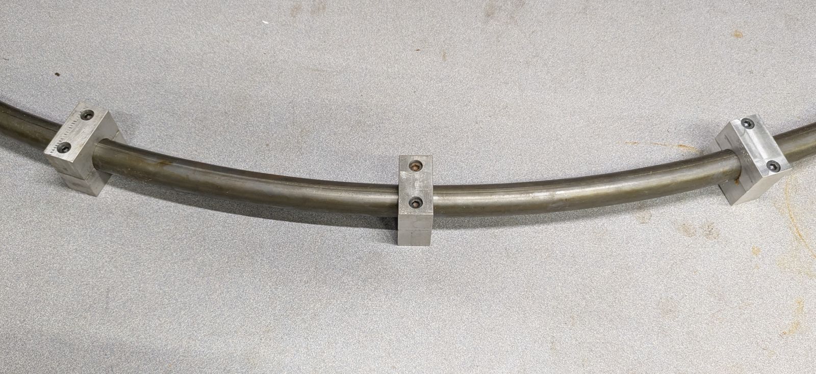

You’ll probably want 3 tube clamps, tightened on a flat surface, to ensure the bend is clocked in the plane of the bike. Or at least a spacer in the middle, of the right height to do the same job as the middle clamp in this pic:
Regular clamps are meant for straight tube, so clamp them beyond the extent of the curve if possible. The ones in the pic are from Alex Meade, good for this because they aren’t as long as say a Paragon block. For gradual curves, a narrow enough clamp doesn’t mind the curve. For a tighter curve, use a spacer in the middle, that puts it at the same height off the table as the clamps at the ends.

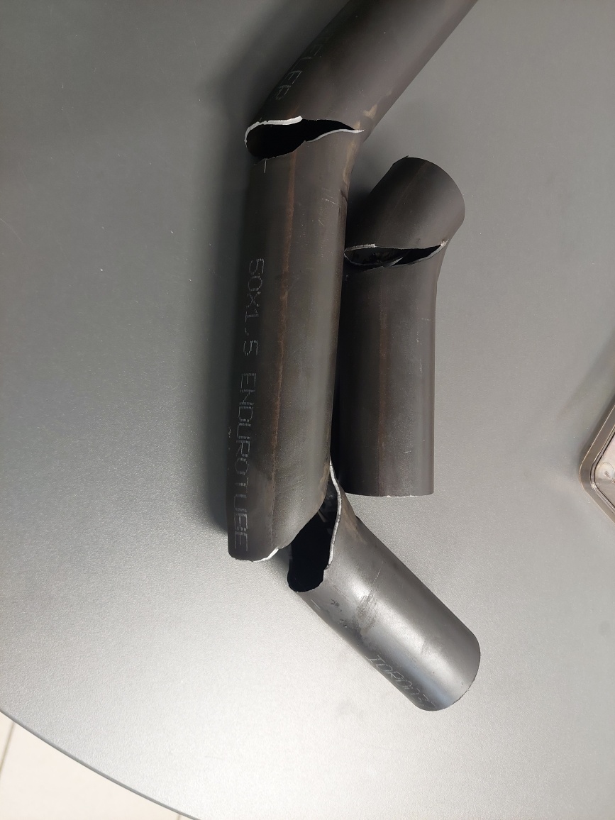

Hi, back to bending. Does anyone have experience in bending 50mm x 1,5mm wall tube?
I need a radius of 150 or 105 and about 50 deg.
Result:
I’ve seen bikes with a similar bent tube, so it must be possible somehow. This was my suppliers attempt with a large bending machine with a pilot(? Don’t know the name) filing the tube inside.
