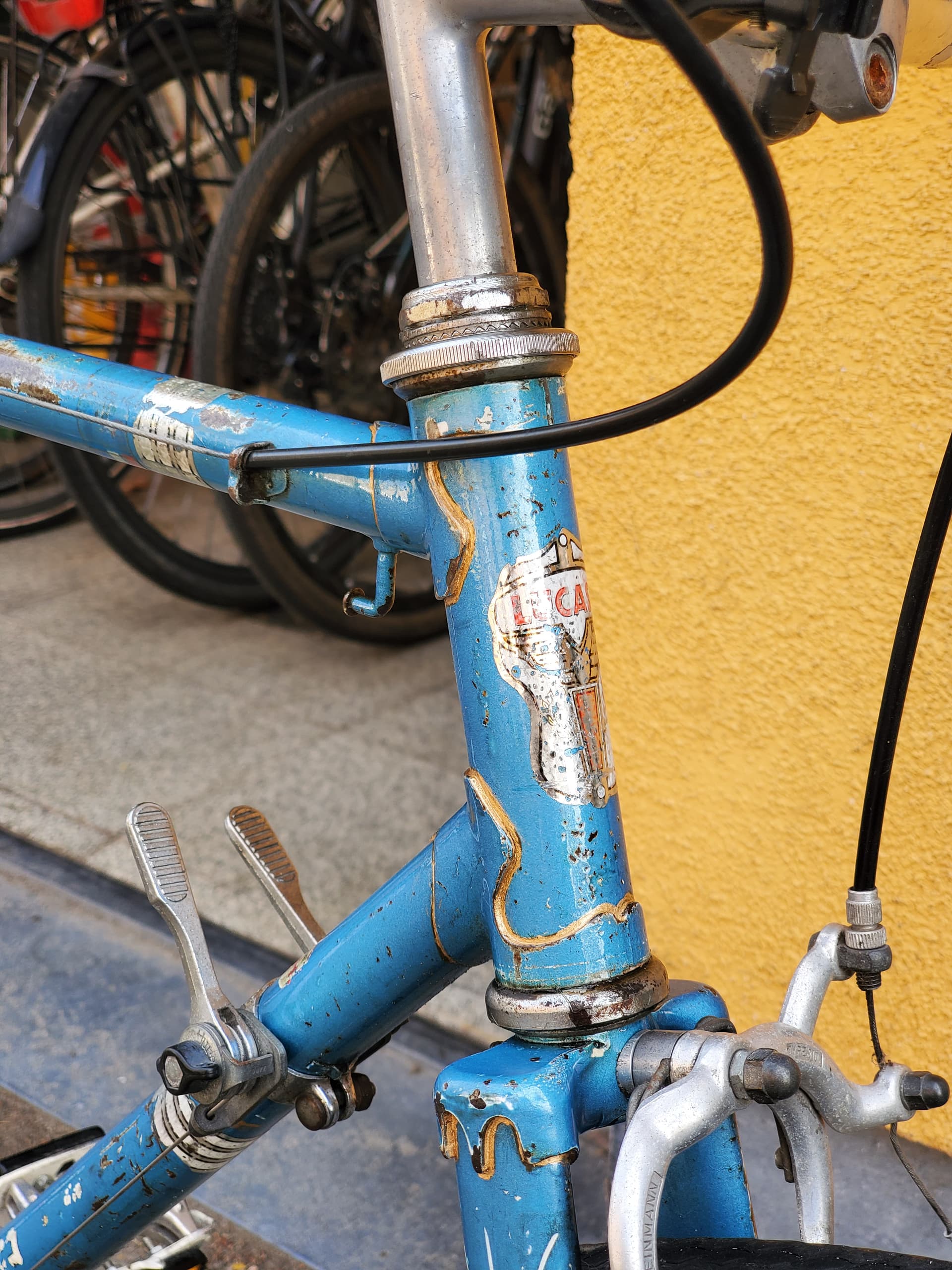

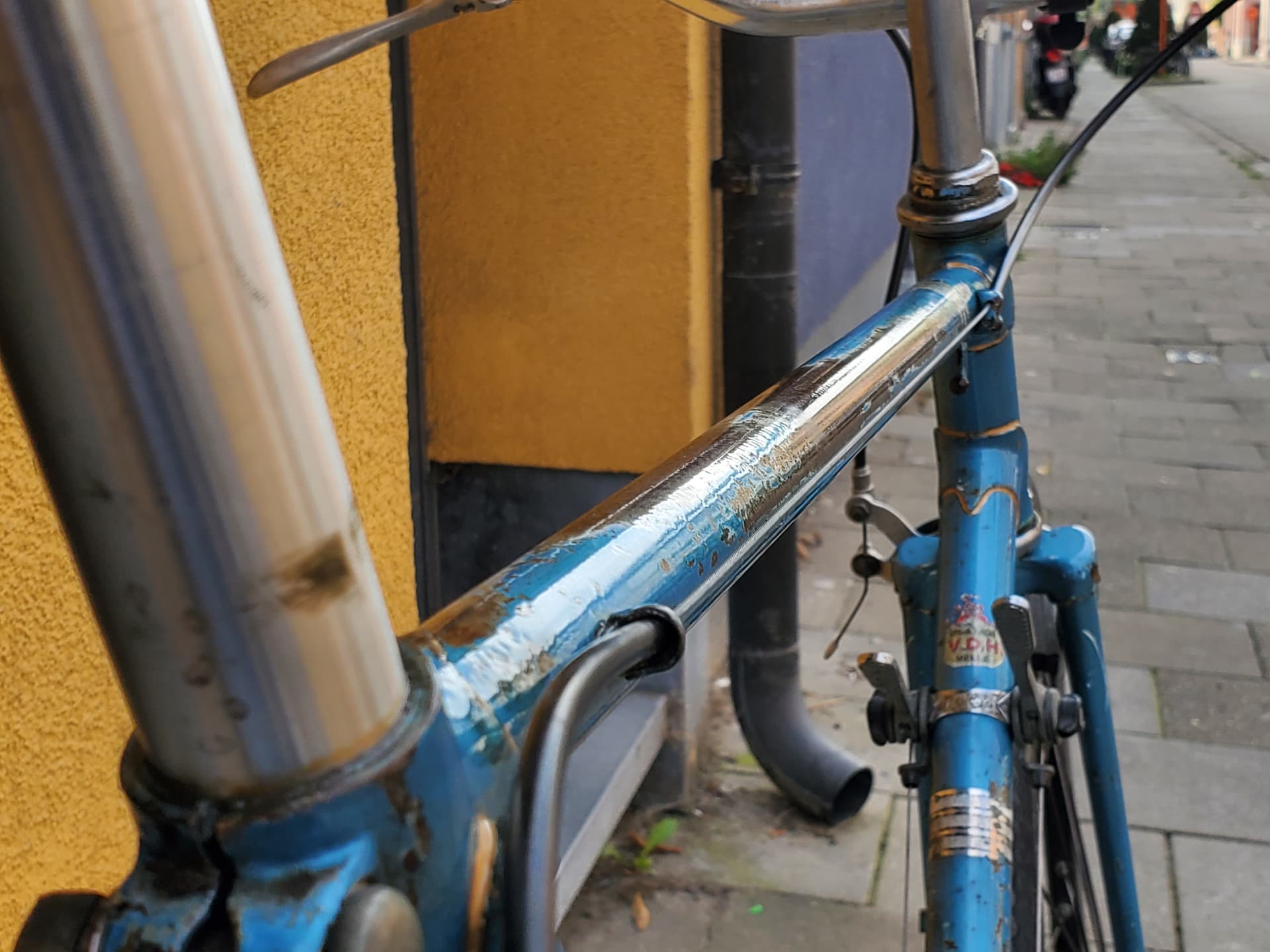

I just sealed in the patina and character of this bike with 2K clear for a friend’s dad, and between the prep and clearcoat I also freshened up the edges of the lugs with some metallic gold paint.
I’m happy with the results of the clearcoat, but the detailing on the lugs is messier than I’d like.
Luckily it fits the look of the bike but when I build my own new frames I’d like to be able to do a nice clean like of metallic paint on the edges of my lugs.
For anyone who is interested, this is the process I used to clearcoat the bike:
-remove all parts (duh)
-make sure there’s no grease or oil on it anywhere
-use a ball of aluminium foil with water to rub off the worst of the surface rust
-after drying, gently key the surface with a scotchbrite pad
-gently clean surface with acetone, but carefully because too much acetone takes the paint right with it

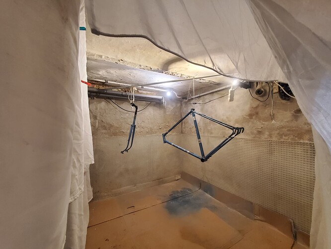

-spray 2K clear in ghetto basement paint booth
-let dry a few days
-sand any spots that didn’t take clearcoat nice and smooth
-gently sand whole surface
-second coat of clear

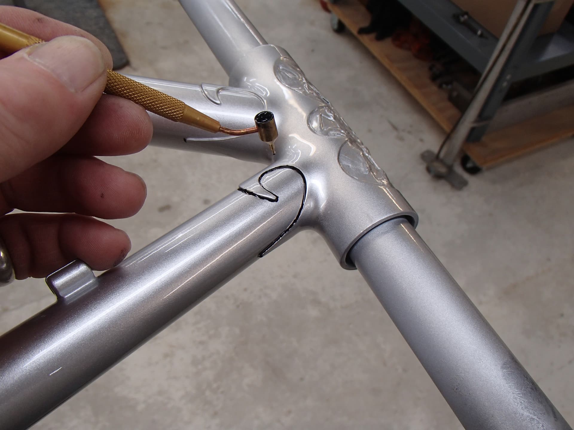

I just lug lined a recent frame using a Kemper Tools Fluid Writer
Very fine paint line produced easily. The paint’s viscosity is important to get right as too thick and the paint won’t flow through the tip and too thin and the paint can run from where you’ve placed it. I use 1 shot brand paint for this, a very high solids type of paint. Andy

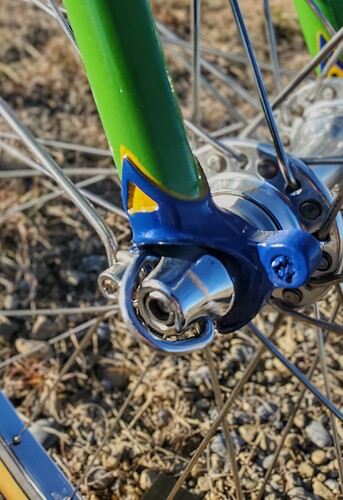

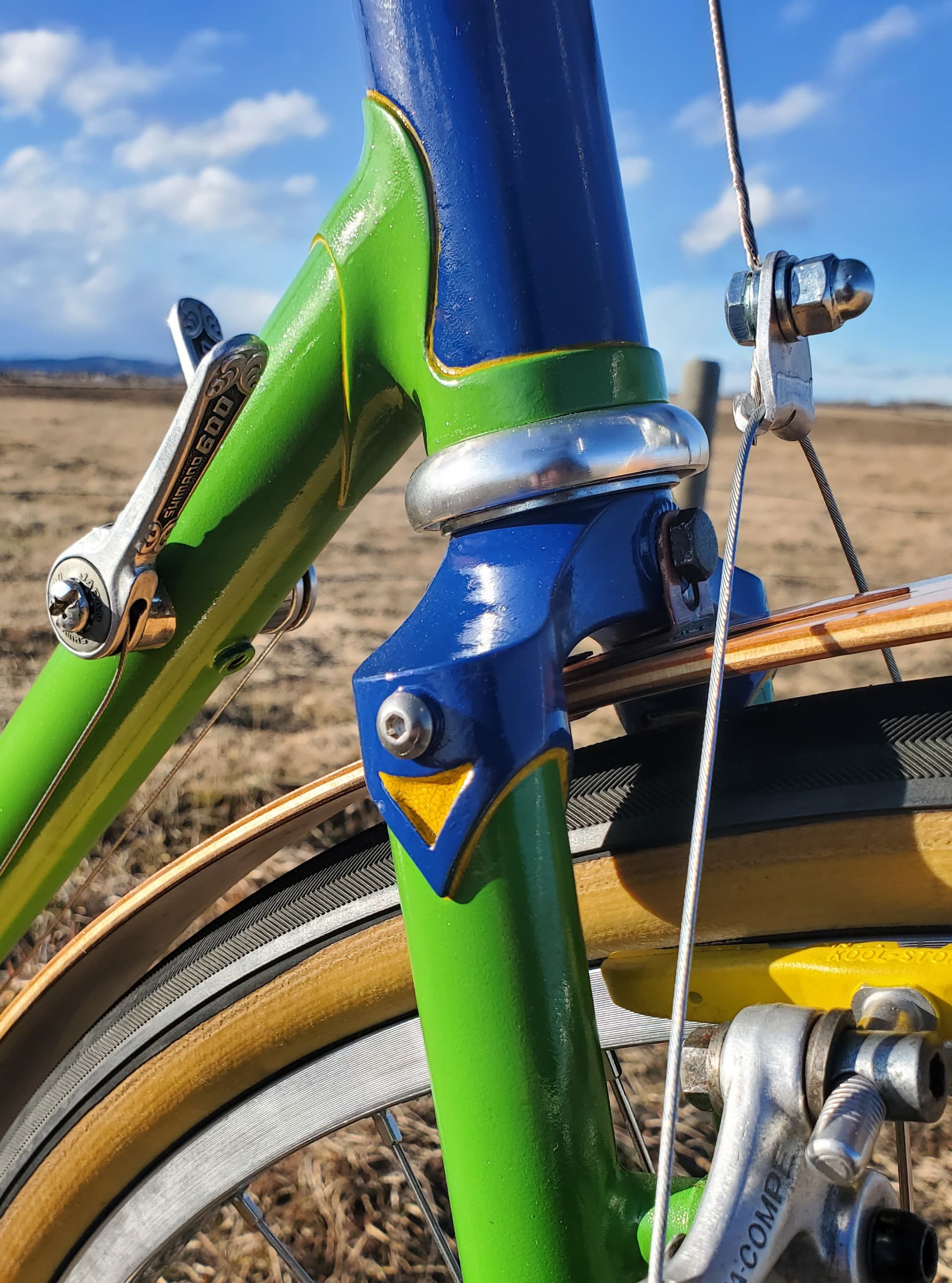

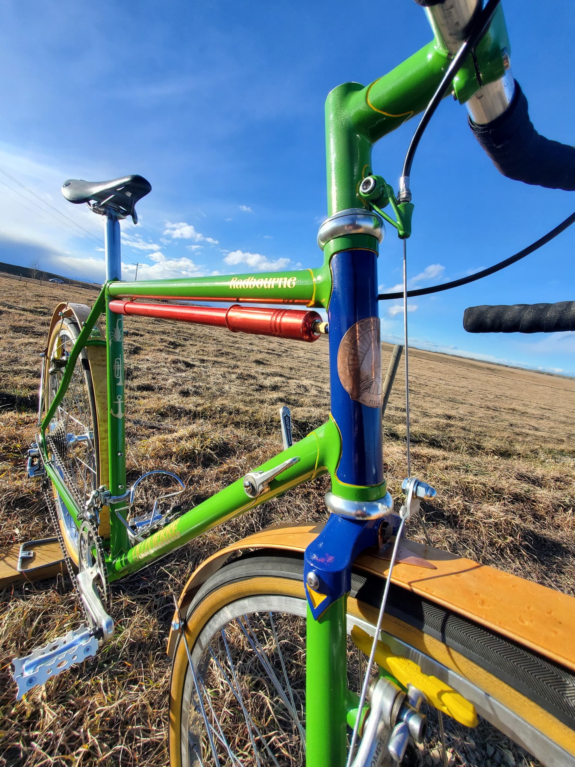

I used a fine tip Montana Paint pen to line the lugs on this bike. I like montana pens because they"re refillable with whatever colour you want to use, tips are replaceable, and montana paints are compatible with 2k clear. And the lines laid down quite nicely for the most part
That’s a wild colour scheme :smiley: love to see it
I see they have those markers at the place where I buy my rattle cans and they’re cheap, can they be filled with whatever paint or only acrylic?
Not sure. I’ve only refilled with acrylic. The tip is like an osmosis action type deal to pull paint through the material the tip is made of as paint lays down on the surface. So not like a fluid writer or ball point paint pen, which paint flows through an orifice. I could see 2 part or automotive paint potentially clogging up the tip of the montana pen
Paint scheme is a shout out to my Vincentian heritage :st_vincent_grenadines:
