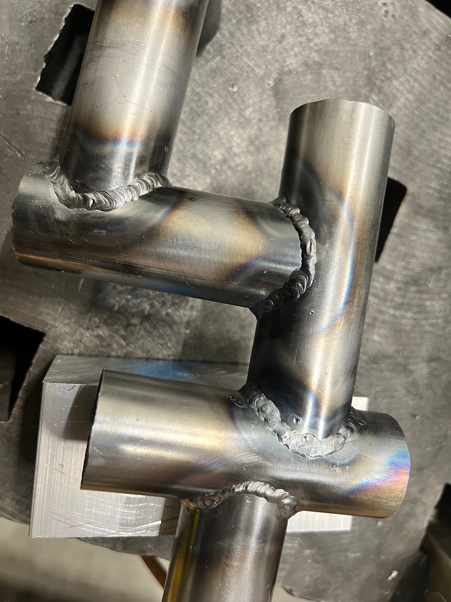

Just a confirmation, I know that once the metal gets hot it needs less amperage to weld but I am finding that it really needs a LOT less.
When you weld two tubes together, do you wait after each “weld” until it gets cold again? Like you do 1/4 of the way around, then wait until it’s cold then another 1/4 etc? Or you go at it while it’s hot?
Lots of factors at play here. I definitely lighten up on the pedal a bit especially without a pulser. Your speed and filler rate/volume are also a big factor. You are cooling your puddle with each dip of wire and the quicker you move there is less heat input. I think there are a few schools of thought about moving around the frame and welding sequence. I have always found more consistency in frame alignment when welding junctions in whole increments. I do this with both titanium and steel. My rational here being that I get better consistency in starts and stops as well as overall weld quality. I can go into more detail about this process if you would like, I would just need to collect my thoughts into a more clear and concise explanation so I don’t over complicate things.

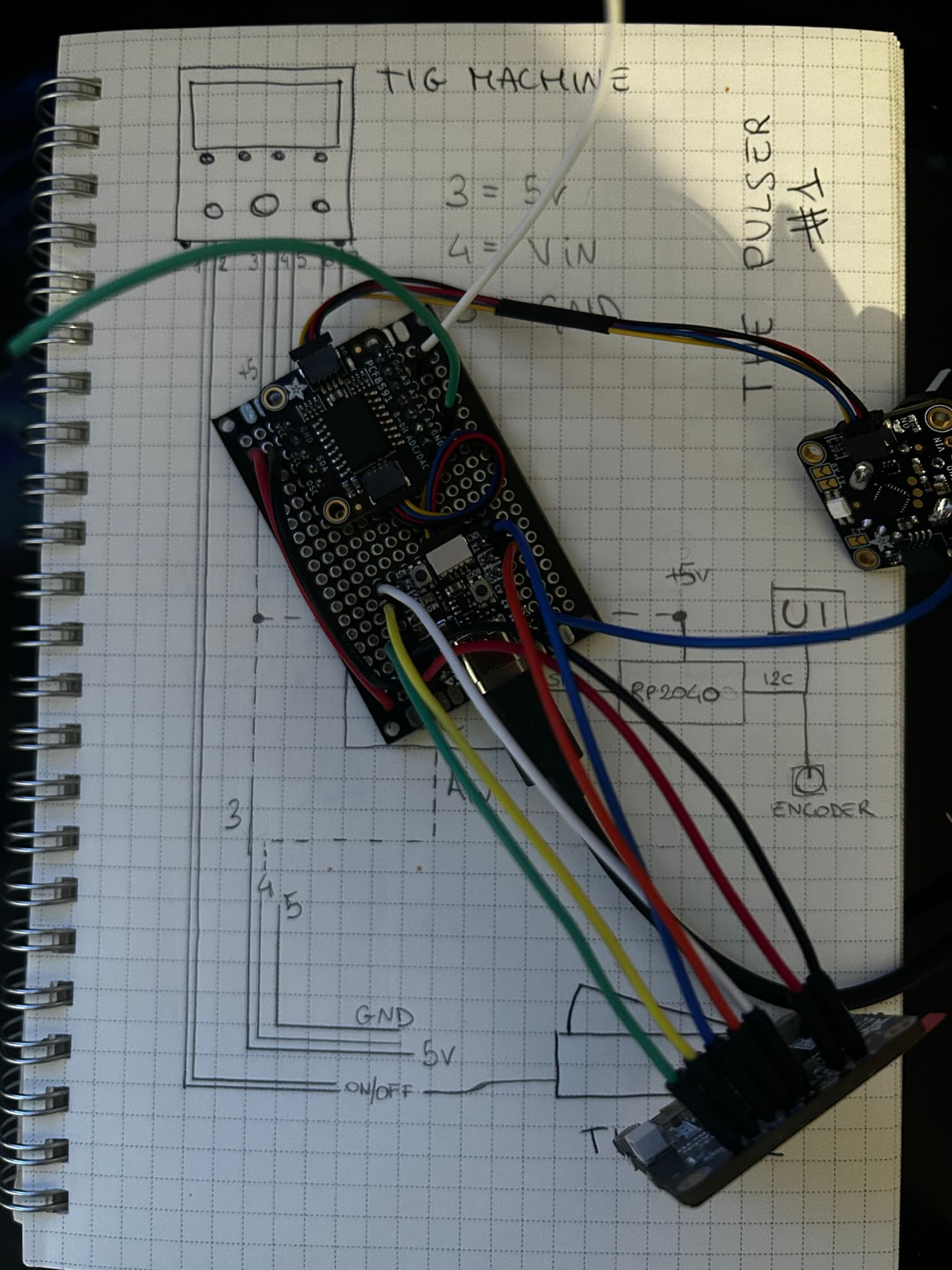

I did a thing…

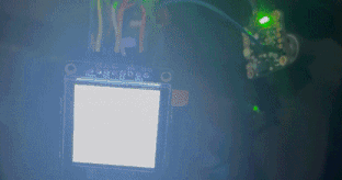

This little guy goes inline between my machine and the pedal, it’s configurable and although it’s my first draft, it seems to work (on paper) - I need to work on an enclosure and then I can test it
tig-pulser
Oh heck yeah!!! I almost made one of those when I had a Maxstar, but then found a Dynasty on Craigslist :grin:
Looks pretty cool and I bet you can get better granularity than the on-machine pulser. Sometimes I wish I could add about 0.05 PPS.

Nice work! I was considering trying to make one of these myself. Care to share the design details?
I have yet to finish it - waiting for parts - but yes, I will upload everything here, I will make a dedicated post and share hardware designs and software

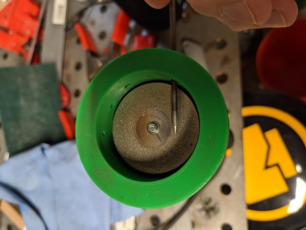

I 3D print this grinder for my Dremel and use a diamond wheel. It’s not perfect and but given the price of a real tungsten grinder it is a huge improvement over a bench grinder!

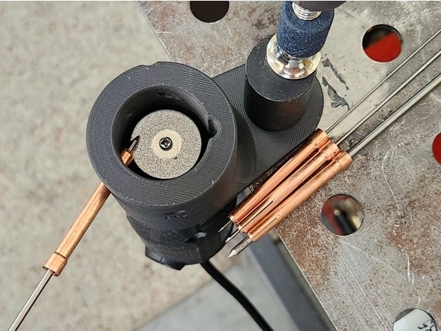

Another plug for a 3D printed tungsten grinder for a Dremel with a diamond wheel. I really like this one because it uses collets for the guides that also serve as heat breaks.
I like it! IlThe one I use melts if you are not careful.
I also came across this one that is similar in using collets.
These printed grinders are great, thanks for posting!

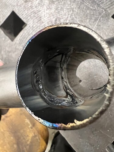

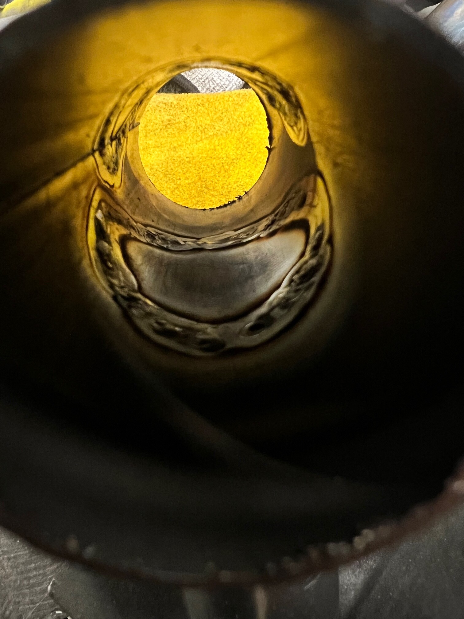

Hello guys. I did my first longer welding session. Would love some feedback. My welds sure did look a bit better in real life.
35mm x 1.5 s235 tubes
Lift arc, no pedal
8 cup with gas lens
1.16 tungsten
10 LPM
1.16 ER70 filler
58 amps
Started out 54 amps, bit too cold, problems with pinholes. Arc too long. What else do you see wrong?
