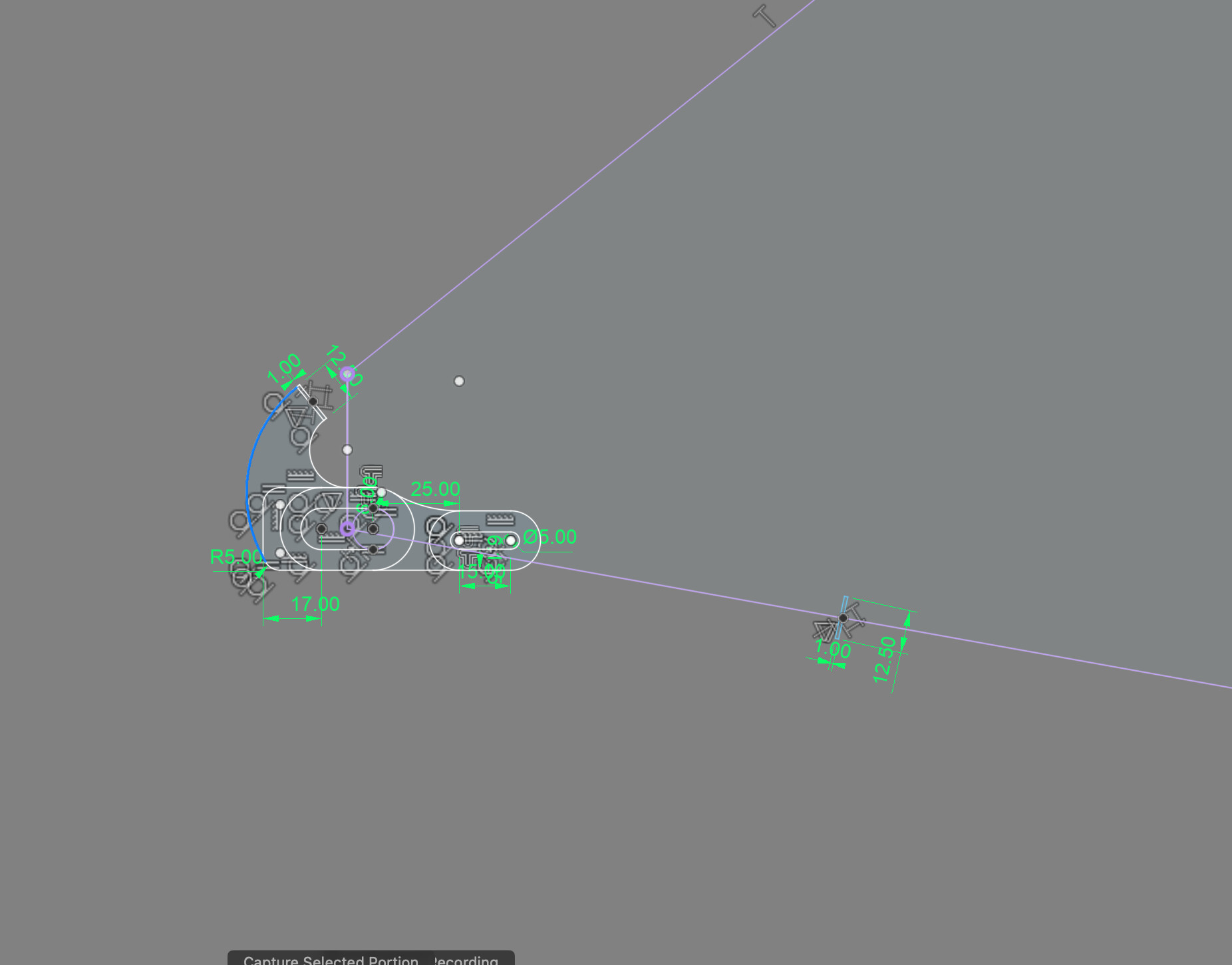

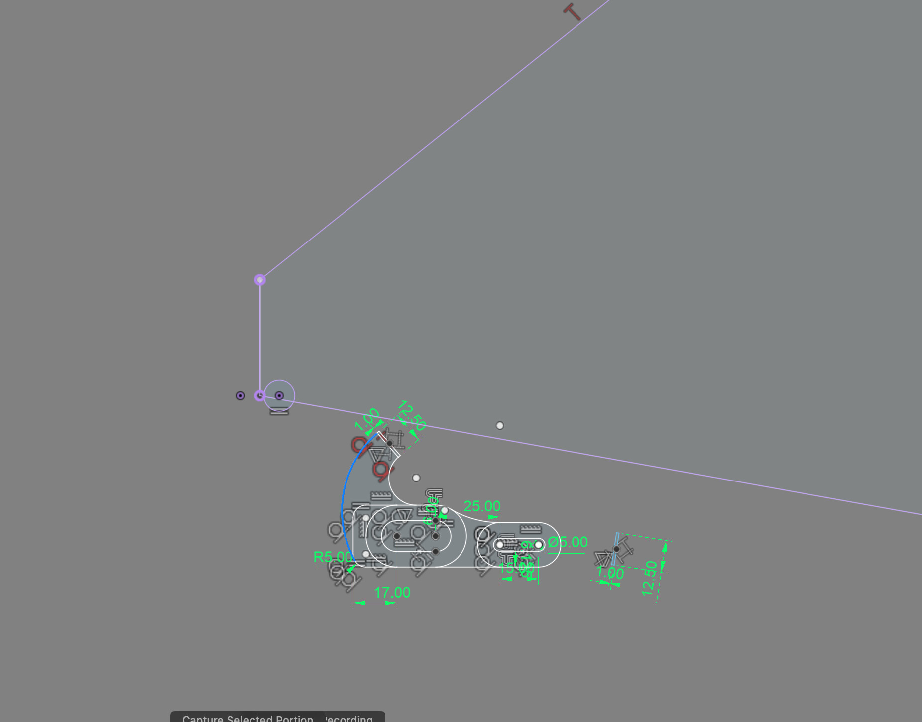

When I drag the marked line, it somehow snaps back into place. Any idea why this is happening?
