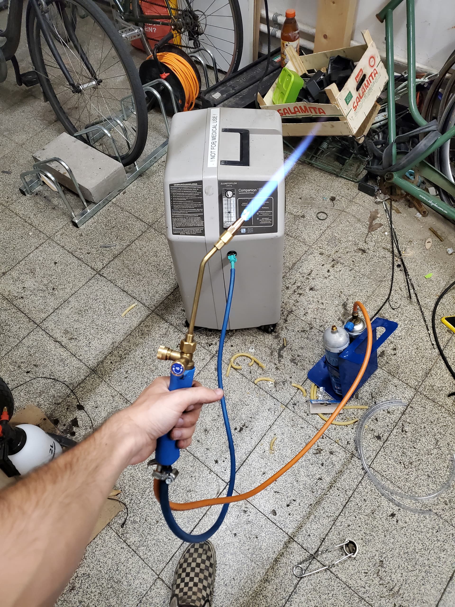

I finally replaced the old brittle hoses in my oxygen concentrator and got propane nozzles. It’s so much better!
Now I just need a real propane bottle to hook it up to, I notice the flame gets leaner as that little bottle cools down.

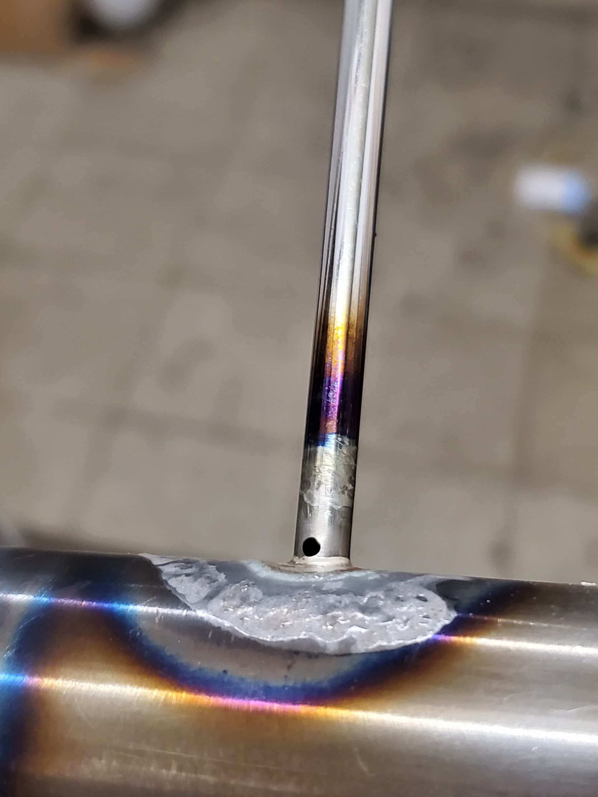

For the first test I brazed a 0.2mm thick tube from an old retractable FM antenna onto a 0.5mm thick section of bike tube. Went well! Lovely little fillet, didn’t overheat either tube.

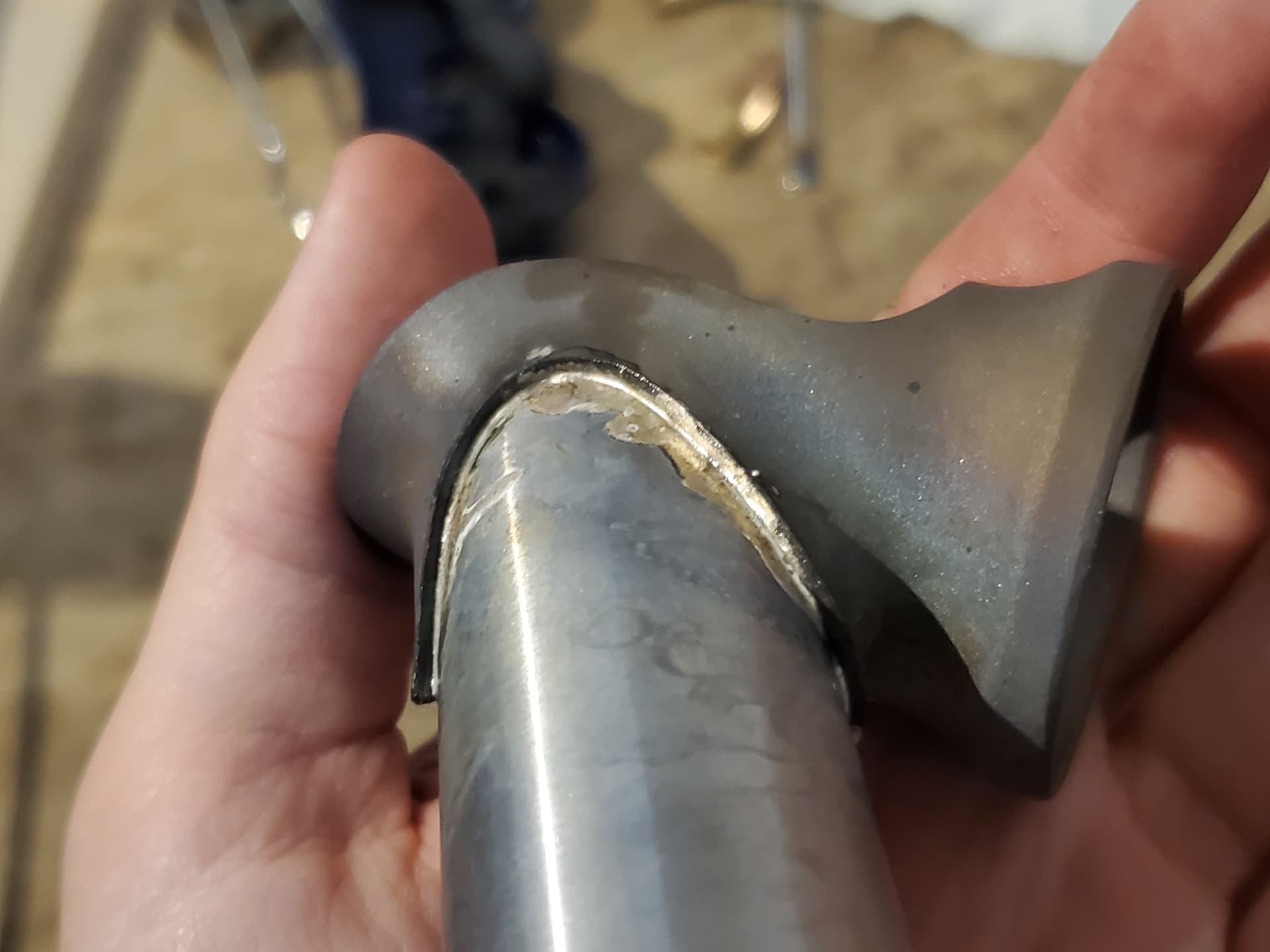

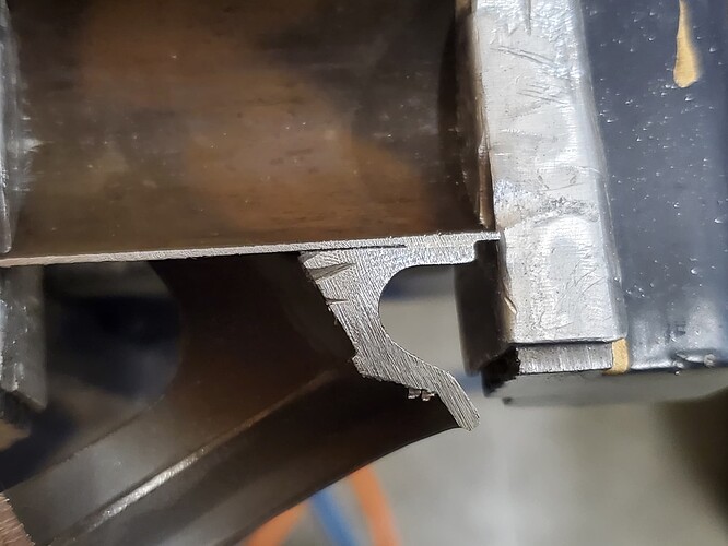

Alright so I have a couple of these 316L printed lugs that I got printed back in april when I had the idea for the road bike with printed lugs carbon fork etc etc.
I thought if I have them anyway and I’ll never actually use them, might as well see if I can use the for practice. Tolerances around the tube were far too sloppy with pretty big gaps around some parts but I gave it a go anyway.
There are definitely some spots that didn’t fill properly, not sure if I should’ve added more filler but those were also the spots with big gaps.
I was also struggling a bit to get some parts of the lug up to temp because this one is very thick and has the big bulky material on the bottom for the idea I had for integrated bearings.
All in all not great but a good piece of practice. I don’t really feel like the fact that it’s stainless held me back but rather the overly bulky design and poor tolerances.
I also couldn’t fit a head tube through due to the little lip I stupidly put inside. Maybe with a head tube inserted it would’ve also flowed better because now I could only add filler from the side and bottom.

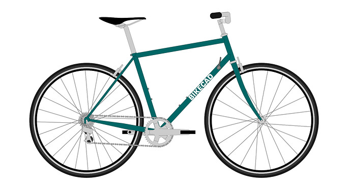

I kinda came to the conclusion that I’m really not interested in having another bike with a horizontal top tube. I really want a beautiful lightweight bike with a sloping top tube so I can have a comfy high stack height and plenty of seatpost extension also for comfort. Plus the more direct load path from the front to the BB and rear end should in theory make the frame more laterally stiff aka responsive and I want to feel what it’s like.
I also have the philosophy that it’s best to have the center of mass of a bike as low as possible to make the bike more responsive when you chuck it into a corner.
Might as well put in some extra time and money learning to build a bike I’m genuinely excited about rather than just a stepping stone to something I actually want.

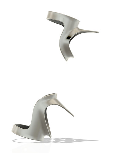

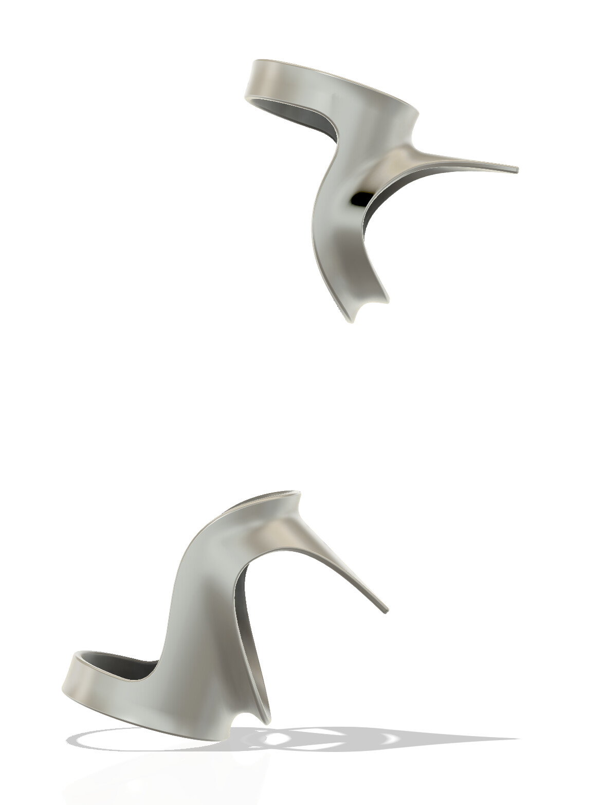

Lugs

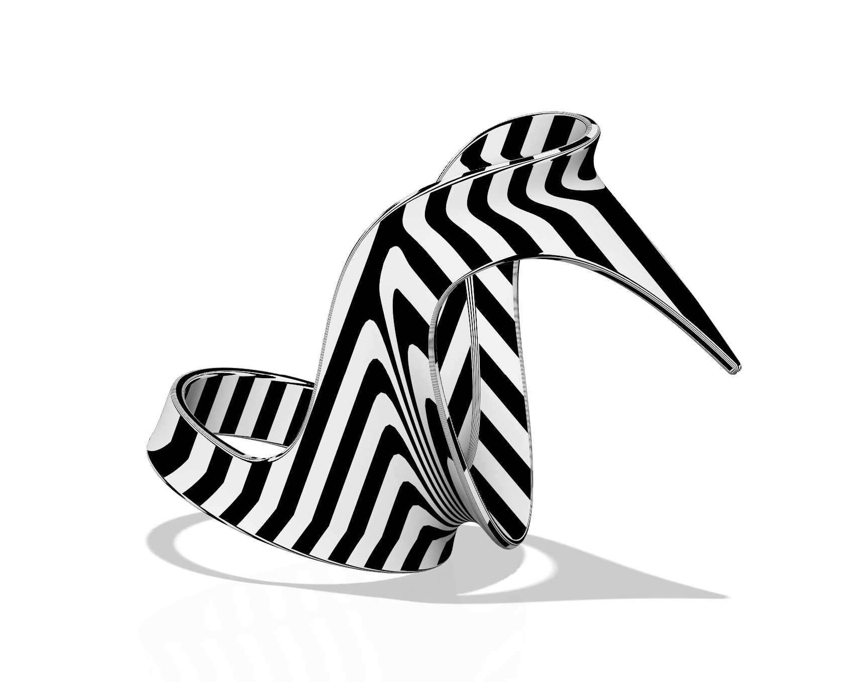

Very pleased with the zebra analysis. (Shows how cleanly the surfaces are modelled)

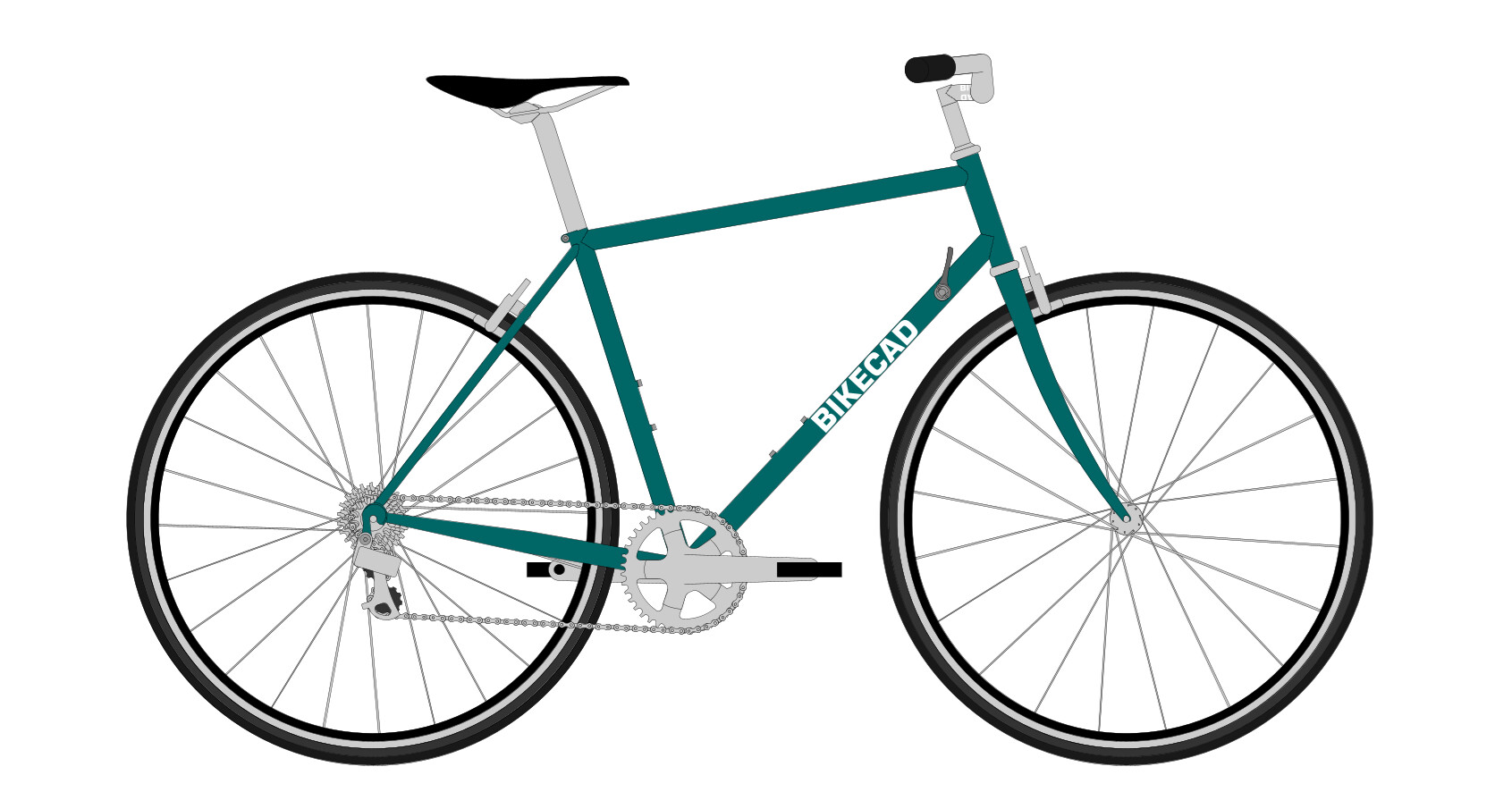

Whole bike visualisation in bikecad (final one has a touch more stack height but you get the idea)

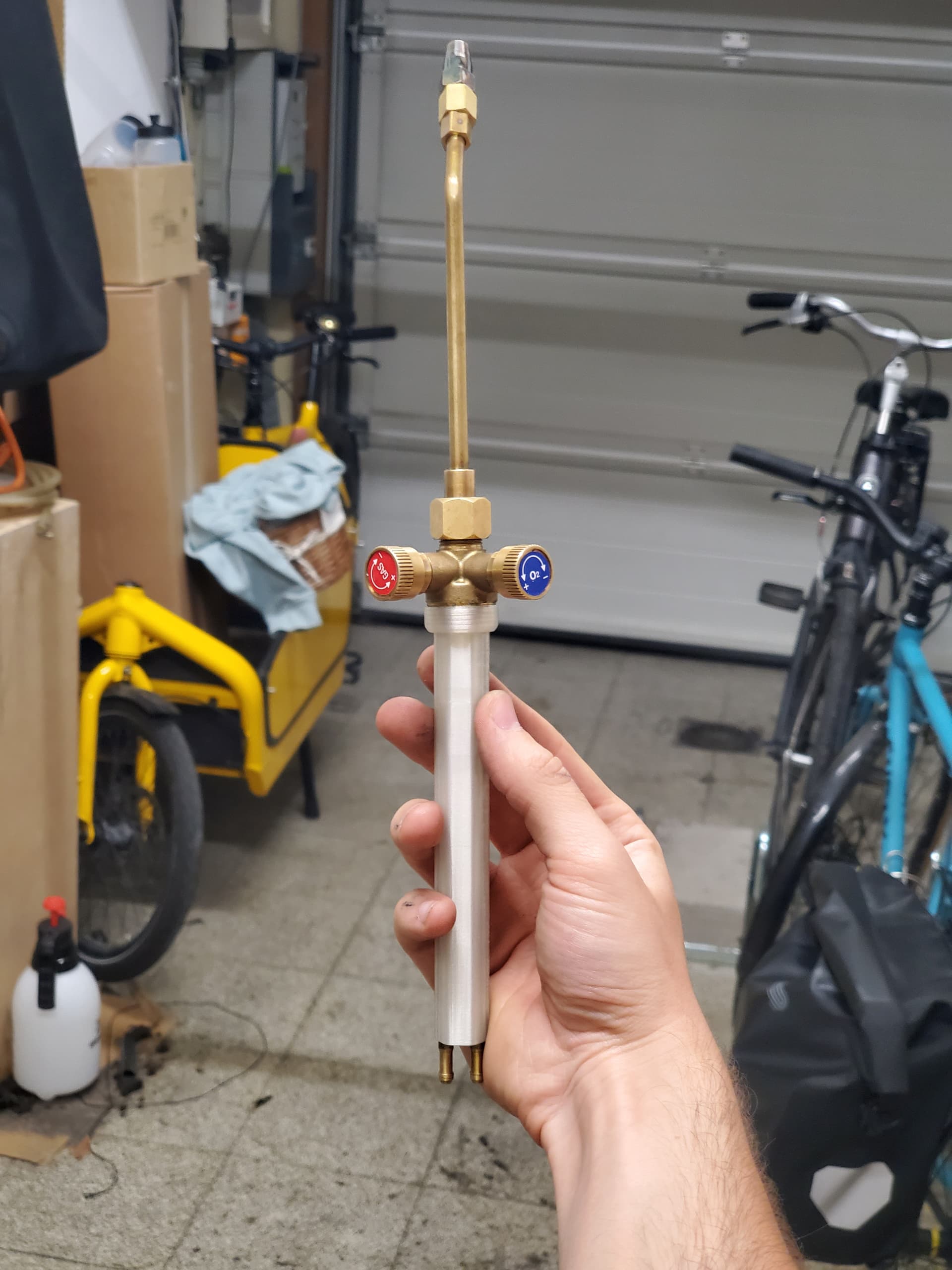

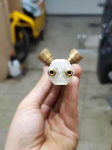

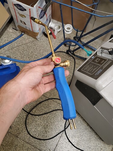

My cheap torch works pretty well with the proper nozzles but man the big fat plastic handle really sucks. It came loose and now it spins around separately from the rest of the torch.
So I went and 3D printed a nice new skinny hexagonal handle. My torch is a big flaming pencil now and it feels so much nicer to hold!

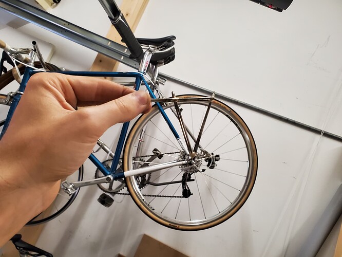

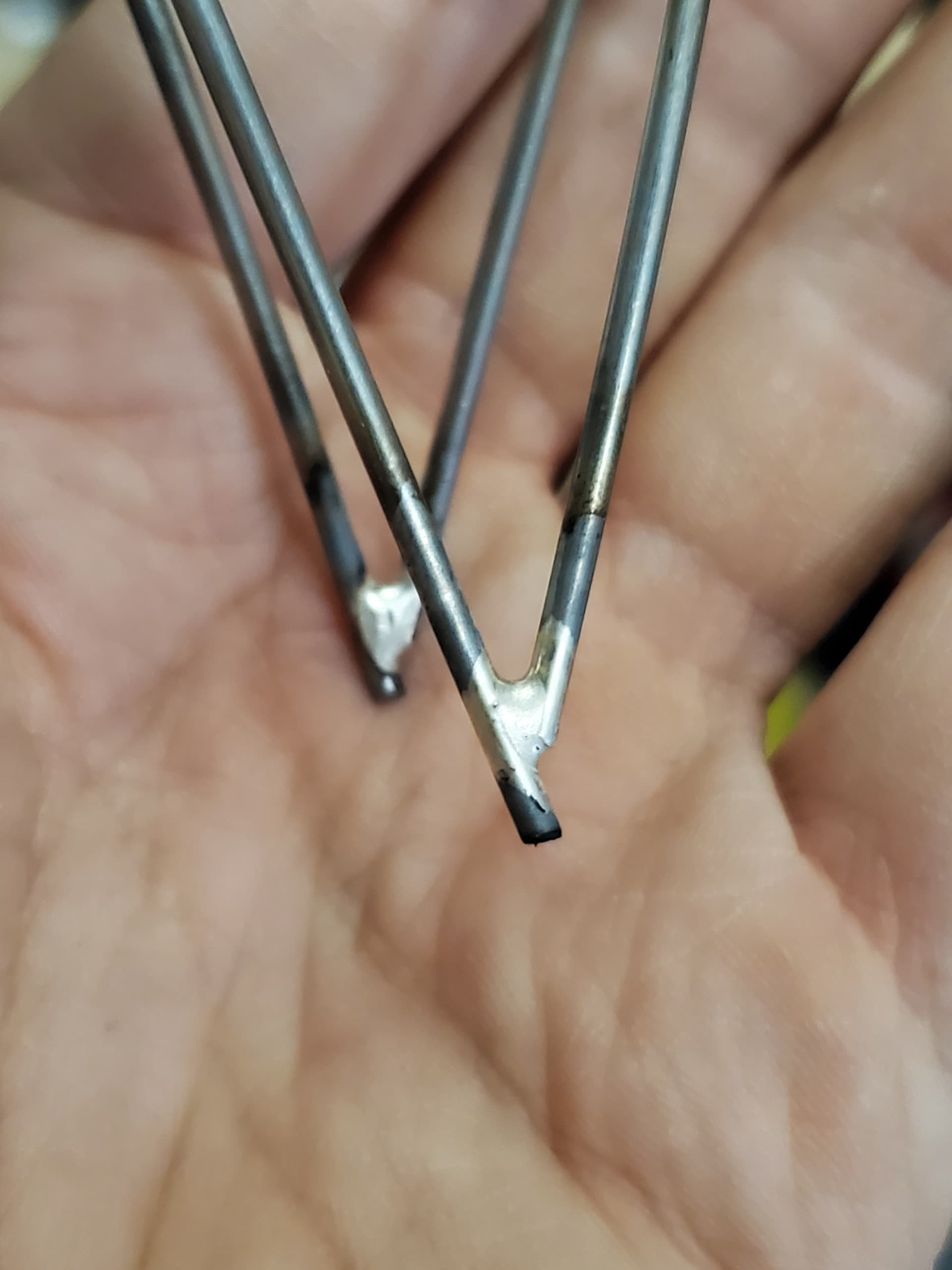

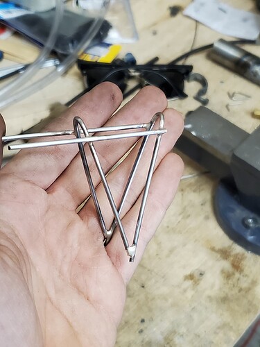

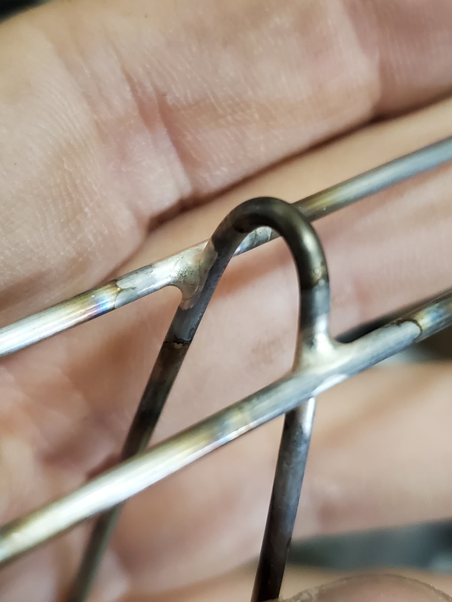

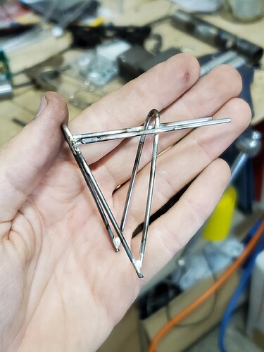

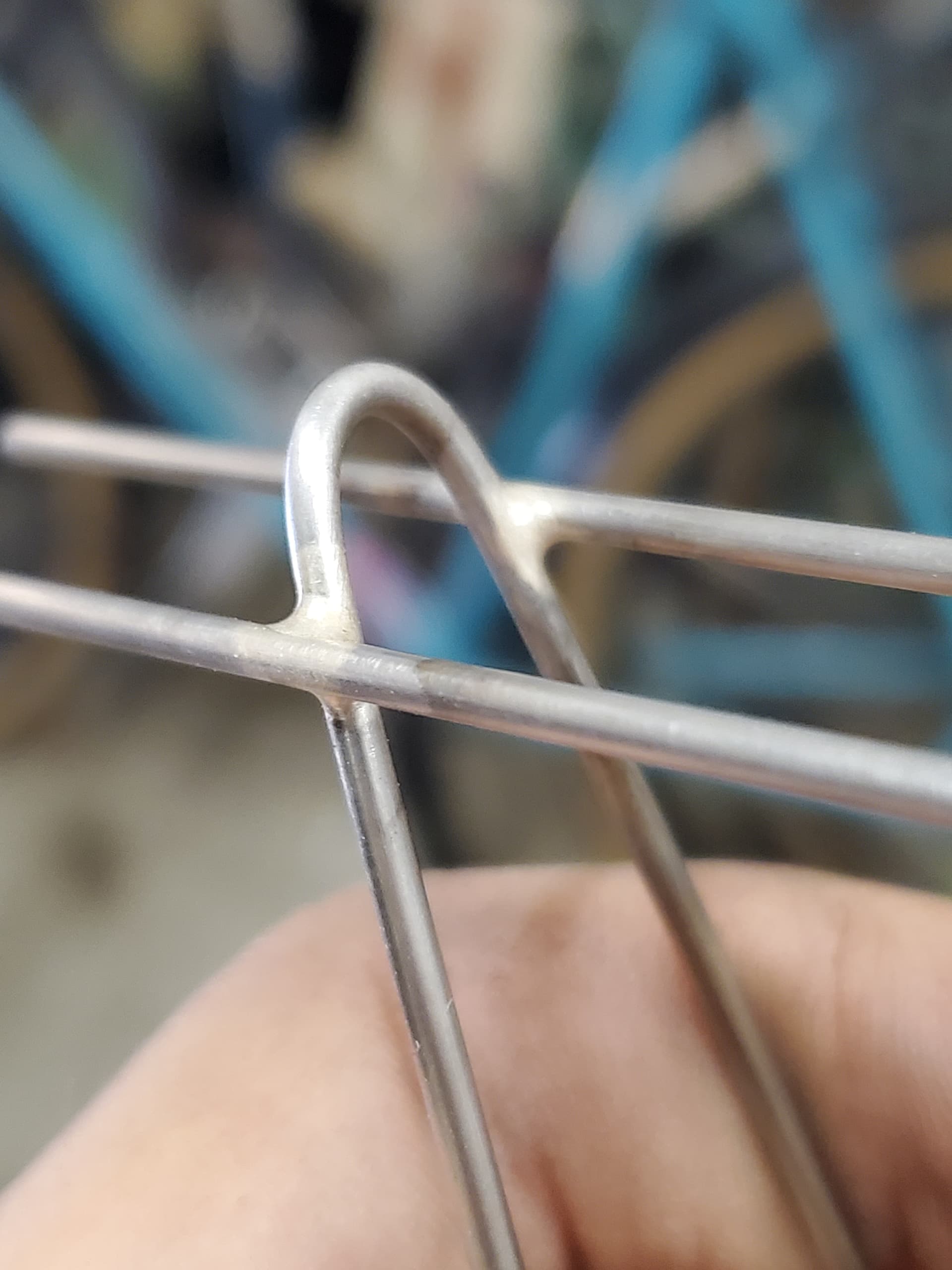

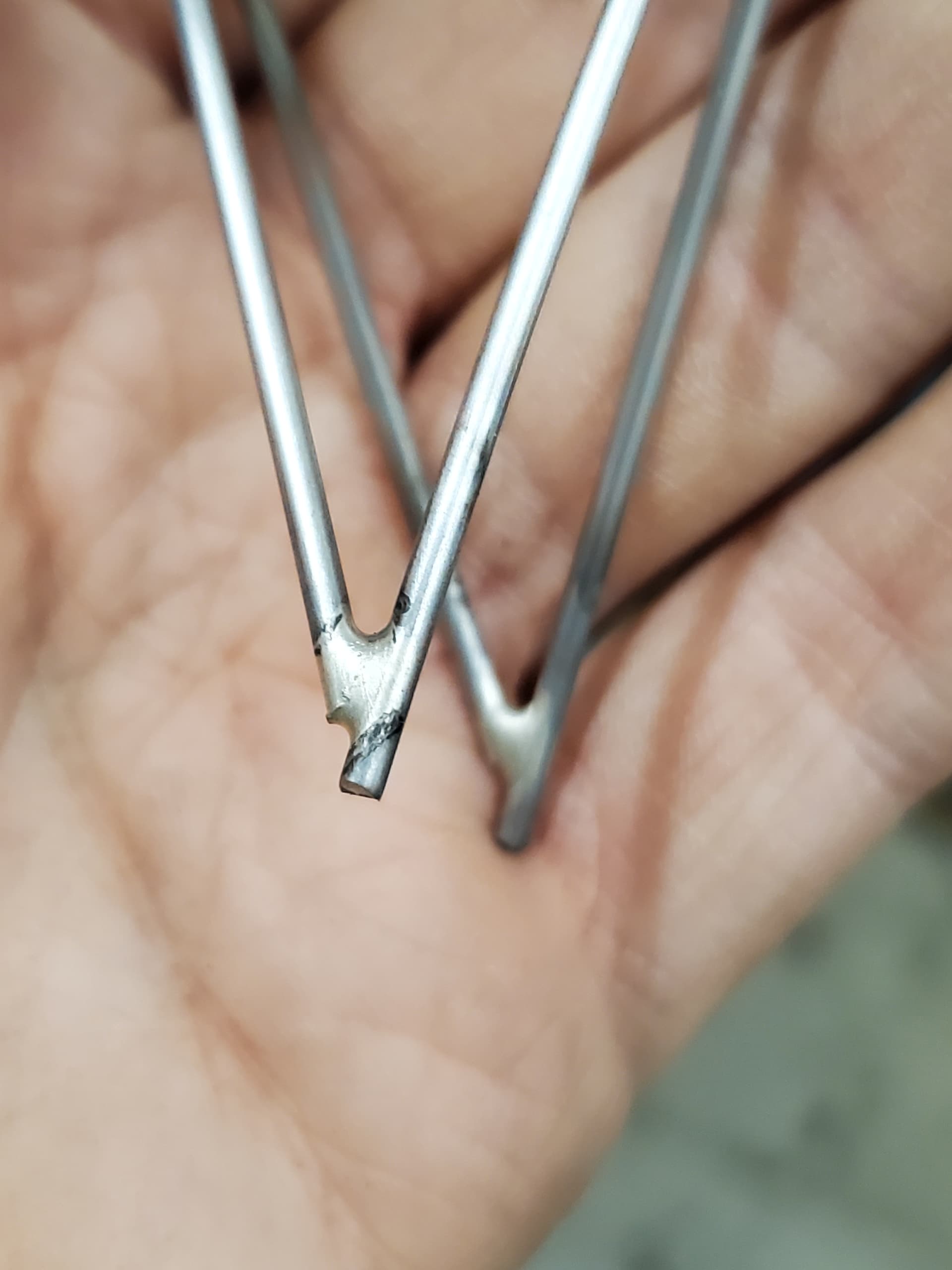

Made a little baby 1:5 scale rack from old spokes as cheap silver brazing practice while I wait for stuff to arrive.
After a little scotchbrite cleanup

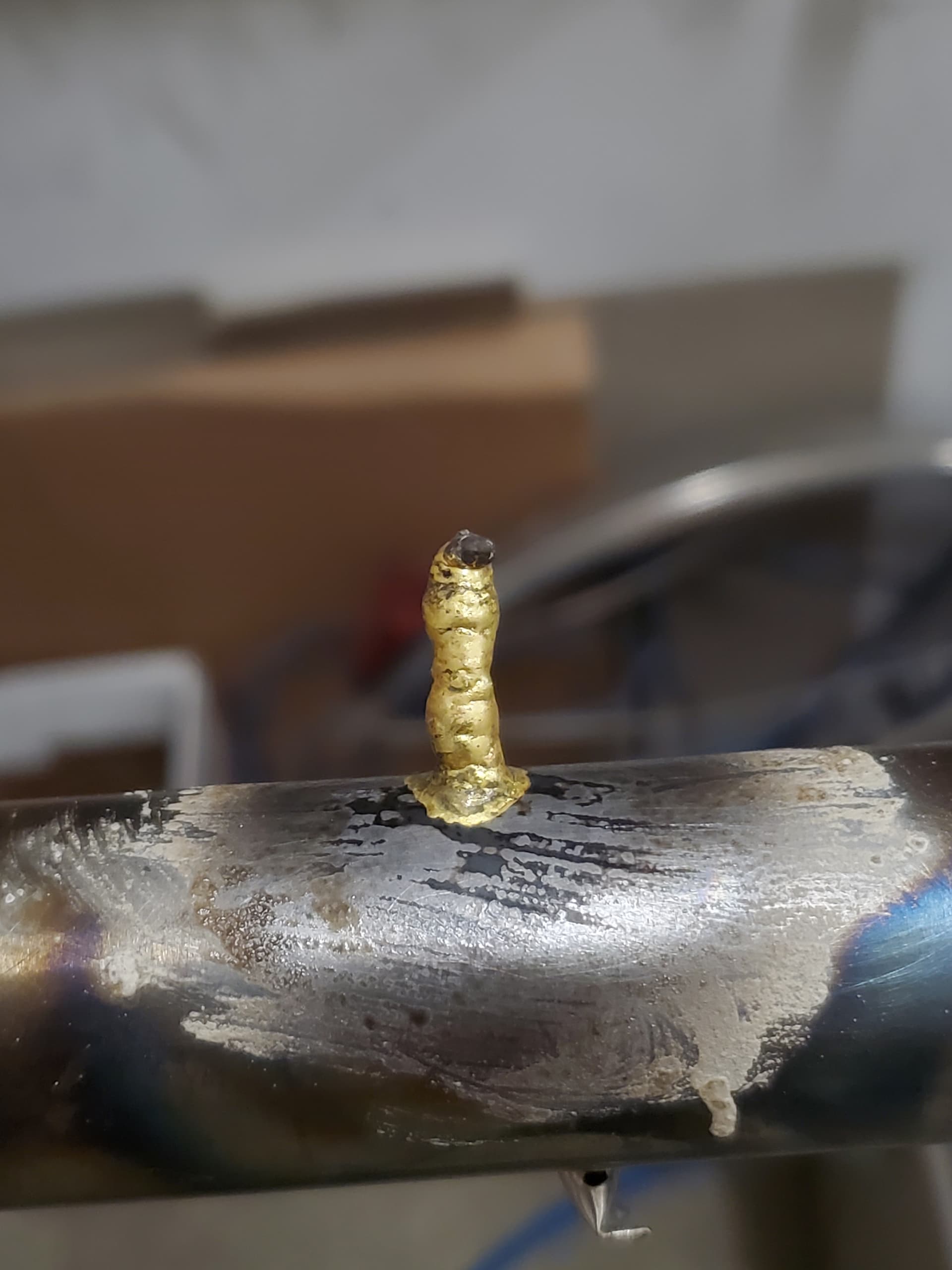

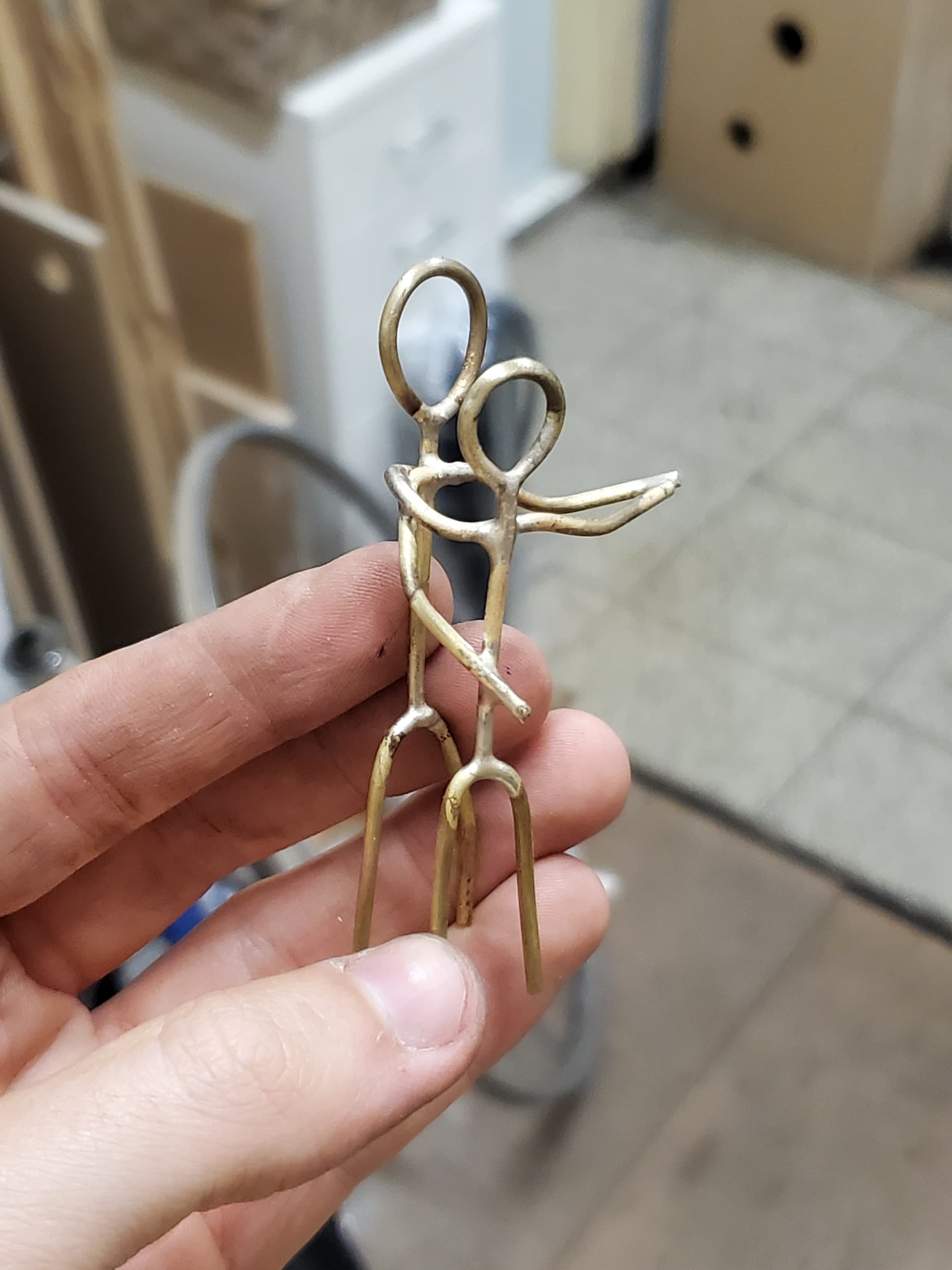

Now a slightly more tricky heat control exercise!
A little sculpture made of brass brazing rods, first annealed and then brazed together with silver. I think this is a decent exercise to stay within a narrow temperature range, but of course it’s much smaller stuff that’s much easier to bring up to temperature.
Sell those on Etsy and retire young!
Haha not sure people would really pay much for these things :laughing:
Also Etsy would keep most of the money :slight_smile: They’re very nice though (I mean your artefacts, not Etsy).

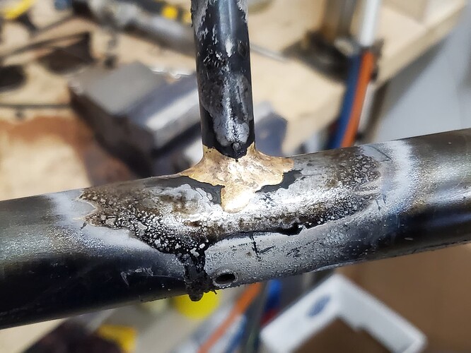

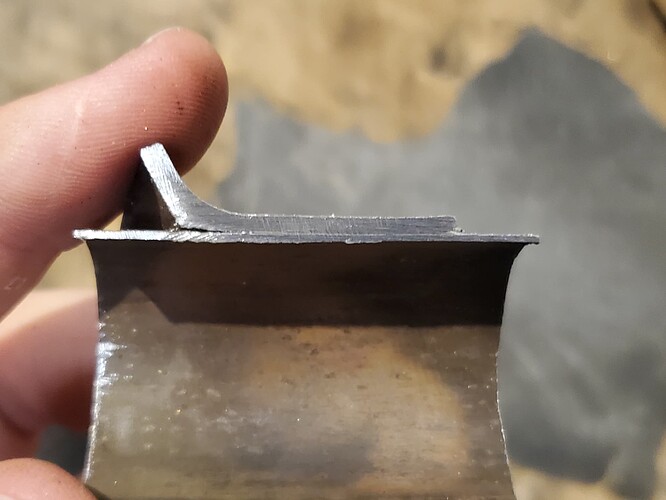

A little fillet brazing practice as well, even though I won’t be fillet brazing this bike I thought I might as well give it a go since I have the materials.
I was a bit limited by only having a basic bench vice to hold the big tube. I had to put a dab of brass on the tube, then reheat when I stuck on the small tube which meant fitup was pretty bad.
Also no ability to easily rotate the piece while I’m working my way around it.
I think I added too much heat? Not sure, this flux turns black as it activates but the area around the fillet looks more “charred" black.
Oh and this icicle I made. That went pretty well. I’ve noticed a slight touch of flux on the rod really helps.

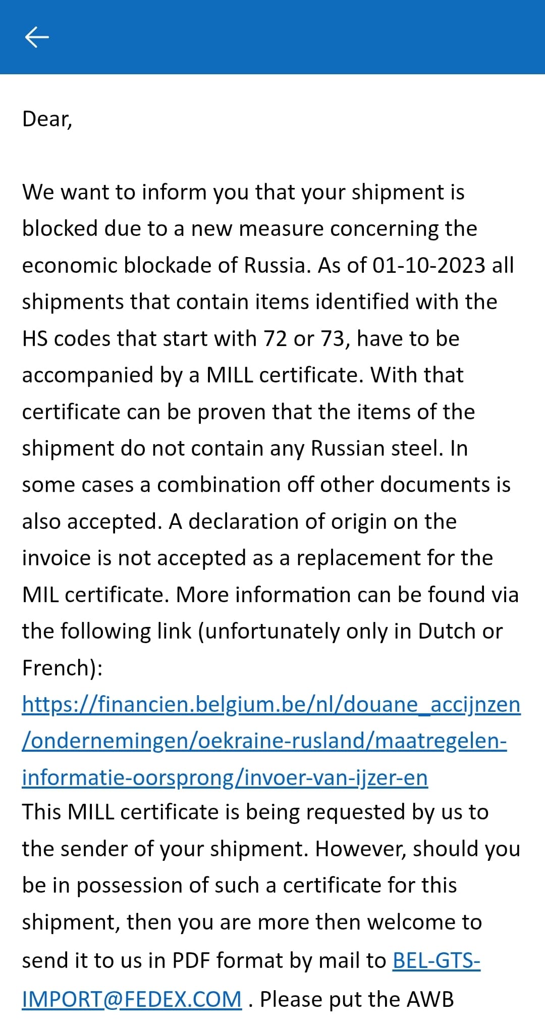

Okay so I didn’t see this one coming… My in3dtec shipment of printed lugs is blocked because they first need to declare that it doesn’t contain any Russian steel because Russian steel imports are banned.
Let’s hope they can provide that MILL document and that it doesn’t contain any Russian steel, because I’d have to find a different supplier otherwise.
