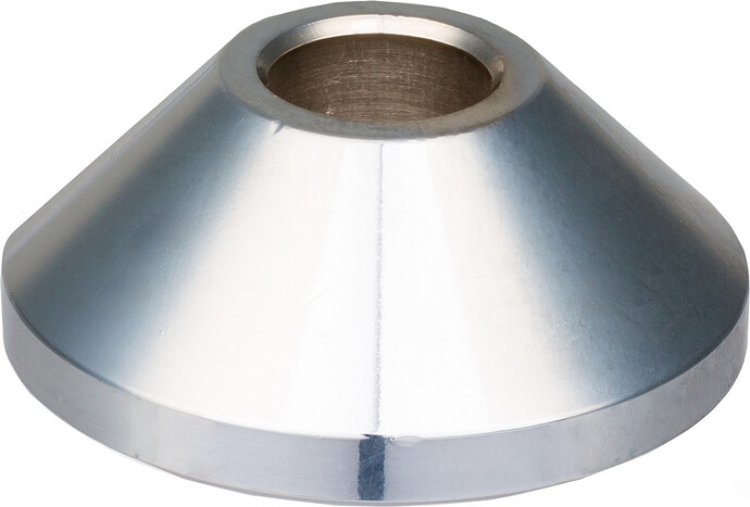

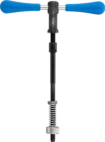

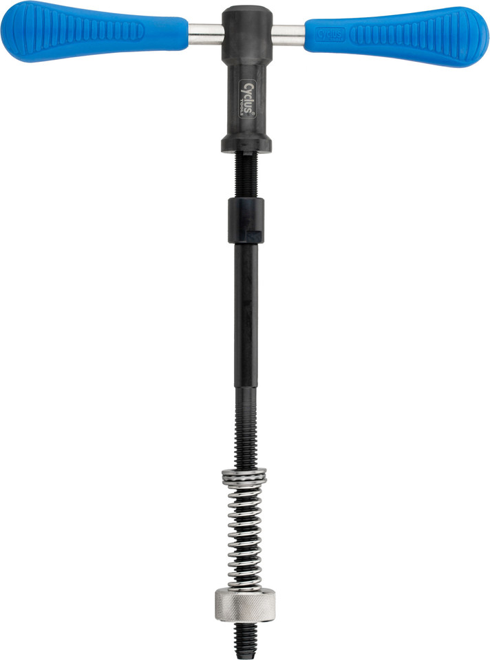

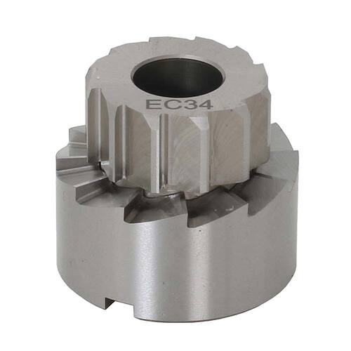

You just need one that’s 34mm, for example the below. Then you will also want the handle, and a cone, which seem to be sold separately. Links below.

My only advise is make sure you have the headset on hand so you can ream to the full insertion depth of the cup. Sounds obvious I know but I’ve seen reamers that only cut ~10mm deep and a lot of cups go in 12-14mm. It’s an annoying thing to find out while pressing a cup in!
