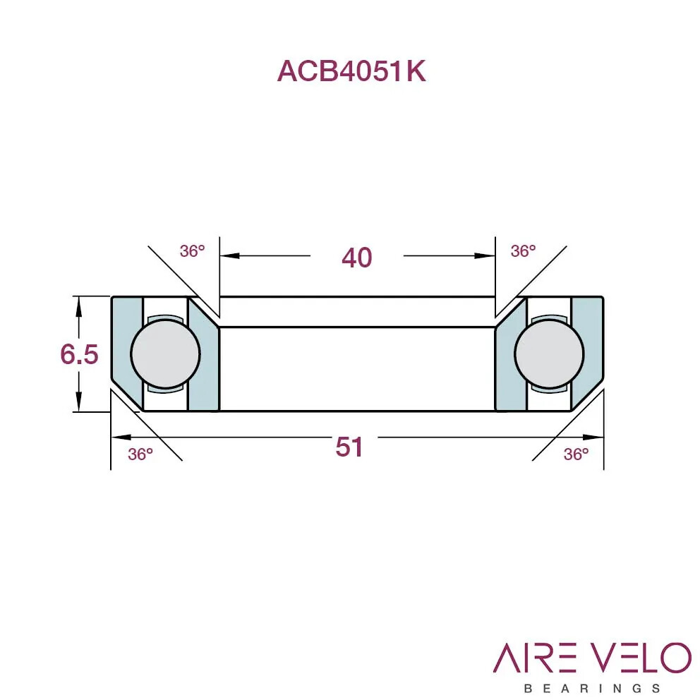

I did a bit of internet digging, and the 36deg seems to check out. The Trek Emonda uses a 51mm diameter bearing with 36deg angles:
This is a very rare bearing standard. All of the headsets and headtubes I have come across in framebuilding use 45deg ramps and crown races.
  • putting a crown race on a molded fork crown is a bad idea
  • you will need to match the angle of your headset cup as well

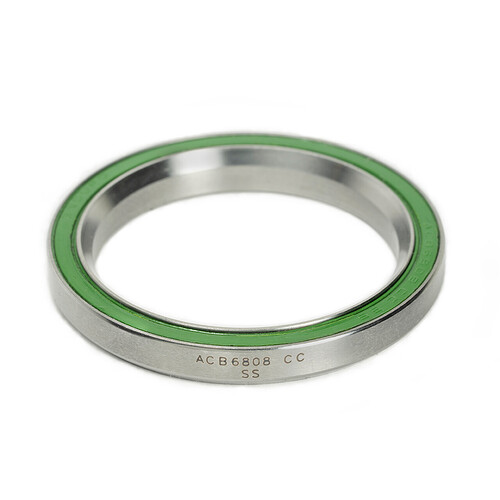

This bearing might work, it is 52mm diameter, 45deg external, 36deg internal:
I would not worry too much about the bearing height. If the headset cup bottoms out on the fork, just throw the cup in a lathe and take off 1-2mm. I just did this yesterday!
