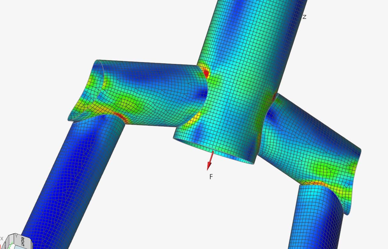

I actually did some FEA to compare the different possible configurations of how the segmentation can be done and couldn’t find a significant difference in stress for any of them, so you should be fine on that one.
