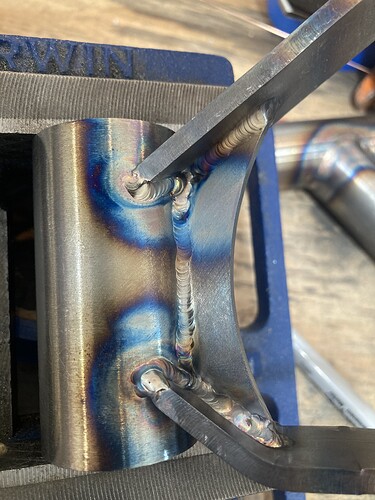

Day 13 part 2- steady improvement but I need some help
#1- I need more metal! I probably have 5 days supply left. If you have any drops, I will be happy to pay shipping

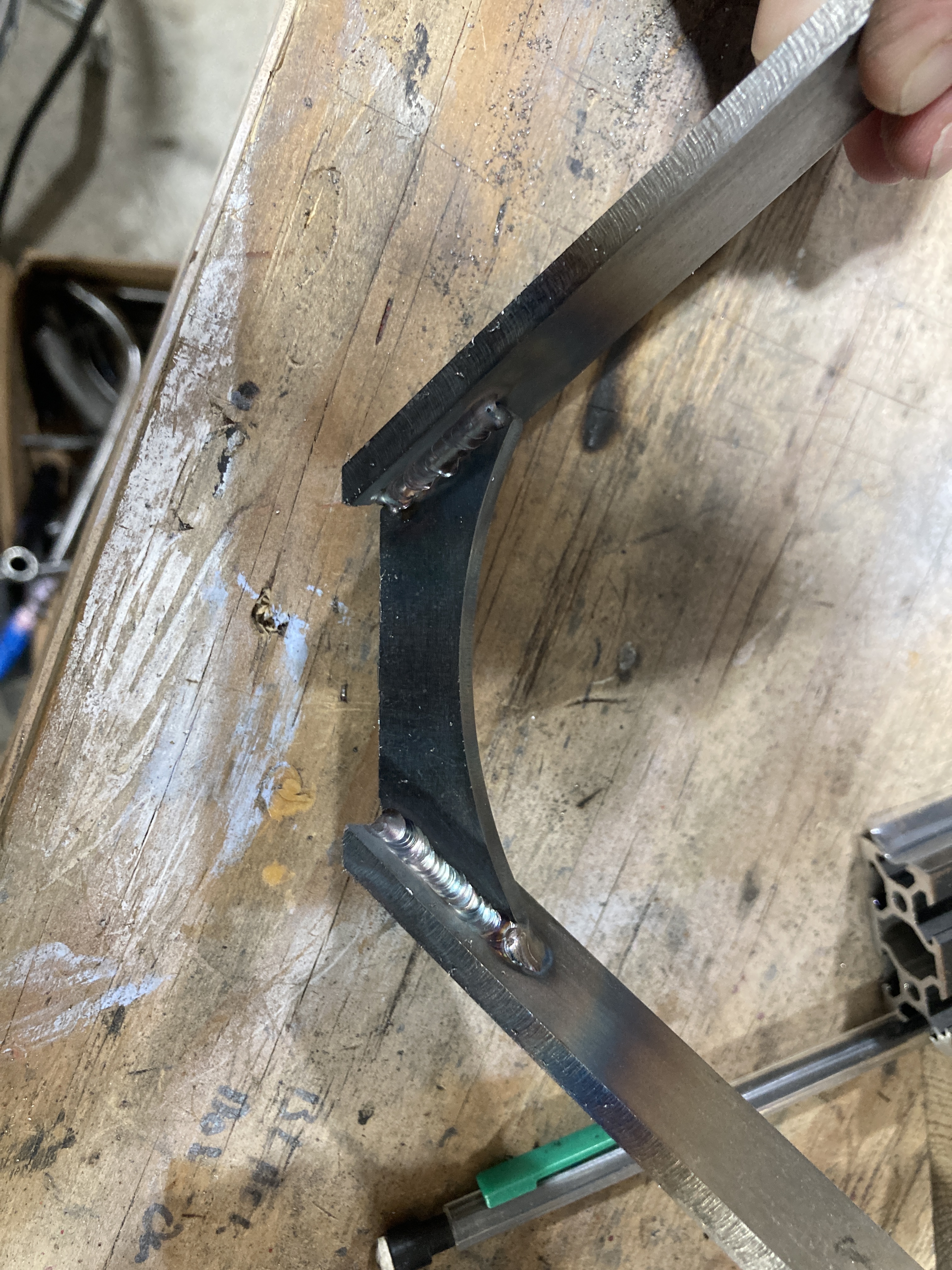

#2- The acute angle area of the joint is making craters on the inside of the solid tube. See picture 2. What do I need to do to improve this? More filler? The outer part of the joint looks good. Seems like a good way for a frame to fail…
Don’t stop in the acute part of the joint, bring the bead around to one of the ears. If you absolutely must stop then add a bunch of filler and slowly back off the pedal, I tend to pull the arc back over the last weld as I back off. Swirling is another good technique to avoid craters.

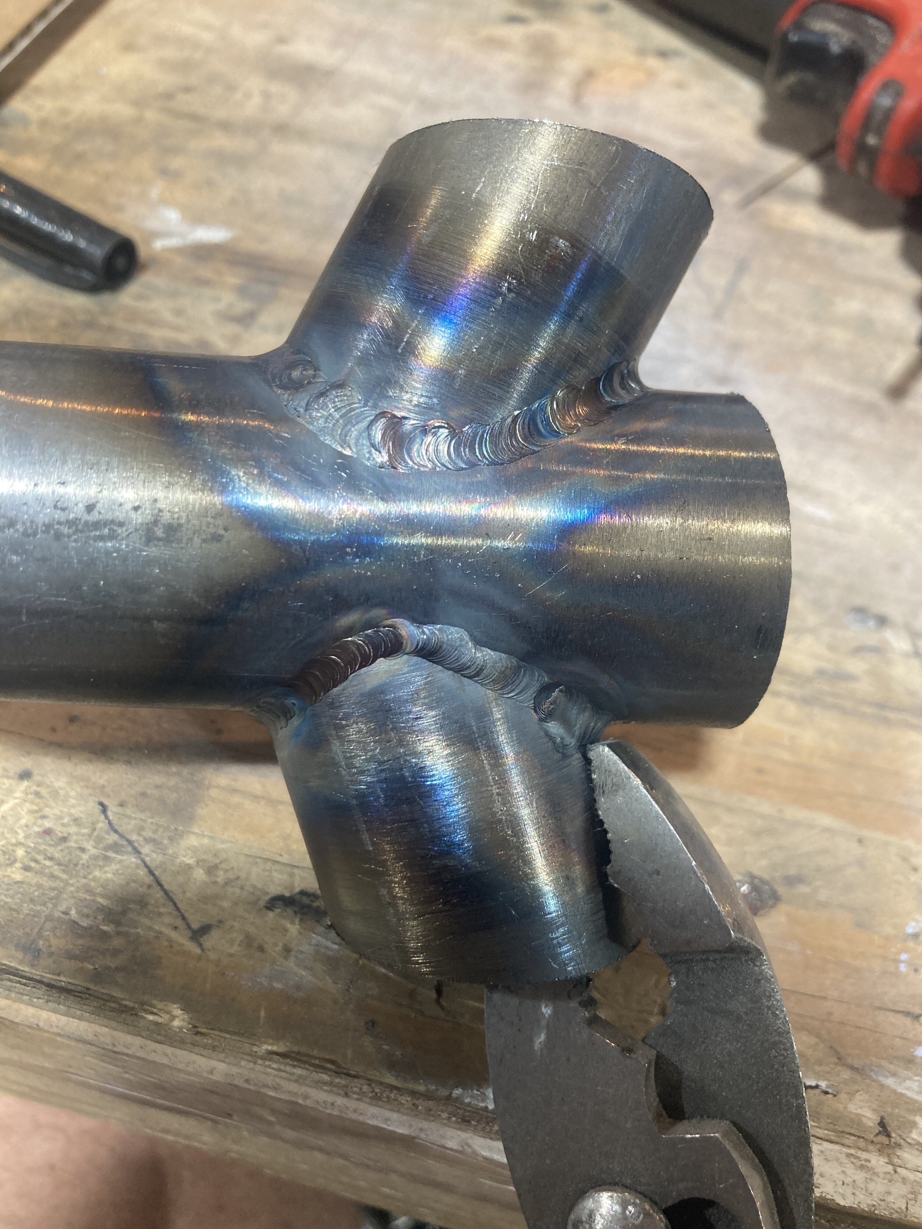

Day 15- Half way there- Presented by hard mode.
I wanted to try a hard practice joint. I left the whole tube on during welding to better simulate a down tube/top tube. I immediately remembered how frustrating these joints are. This was better than I could have done in the past but the acute angle is still tough. I also keyed out trying to tack weld ![]()

Day 19- This is the best joint yet! Changing my weld direction made a huge difference in the tight area. The heat distortion on the backside is much more even.
What causes the ripples in the freeze pattern? I’ve been looking around and don’t see it in other welds.
The ripple is caused by a more liquid puddle while traveling. I get it on the welds where I am running a higher background current.
That’s what I thought after watching some videos of tig puddles. This seems to happen when things are flowing nice and I am actively dipping the rod in the puddle.
This is not not pulsed weld. And I feeding too much filler? I am going to try to switch to a 30 degree grind on the tungsten. I’ve been doing a 45 degree.
I’m not sure what a 30-deg angle equates to but I try to keep the length of the grind to 2 - 2.5x the thickness of the tungsten. To get a better feel for this when I was first starting I just put a piece of blue tape on my grinder with a set of marks for 1/16" and one for 3/32".
You may find that slightly blunting the tip is necessary when you go to a more acute angle. On my welder I find my low amp arc starts wander if the tip is too sharp. If you do blunt the tip be careful and definitely wear eye protection if you’re not already. I have accidentally shattered an electrode or two and at least one bounced off of my glasses.
