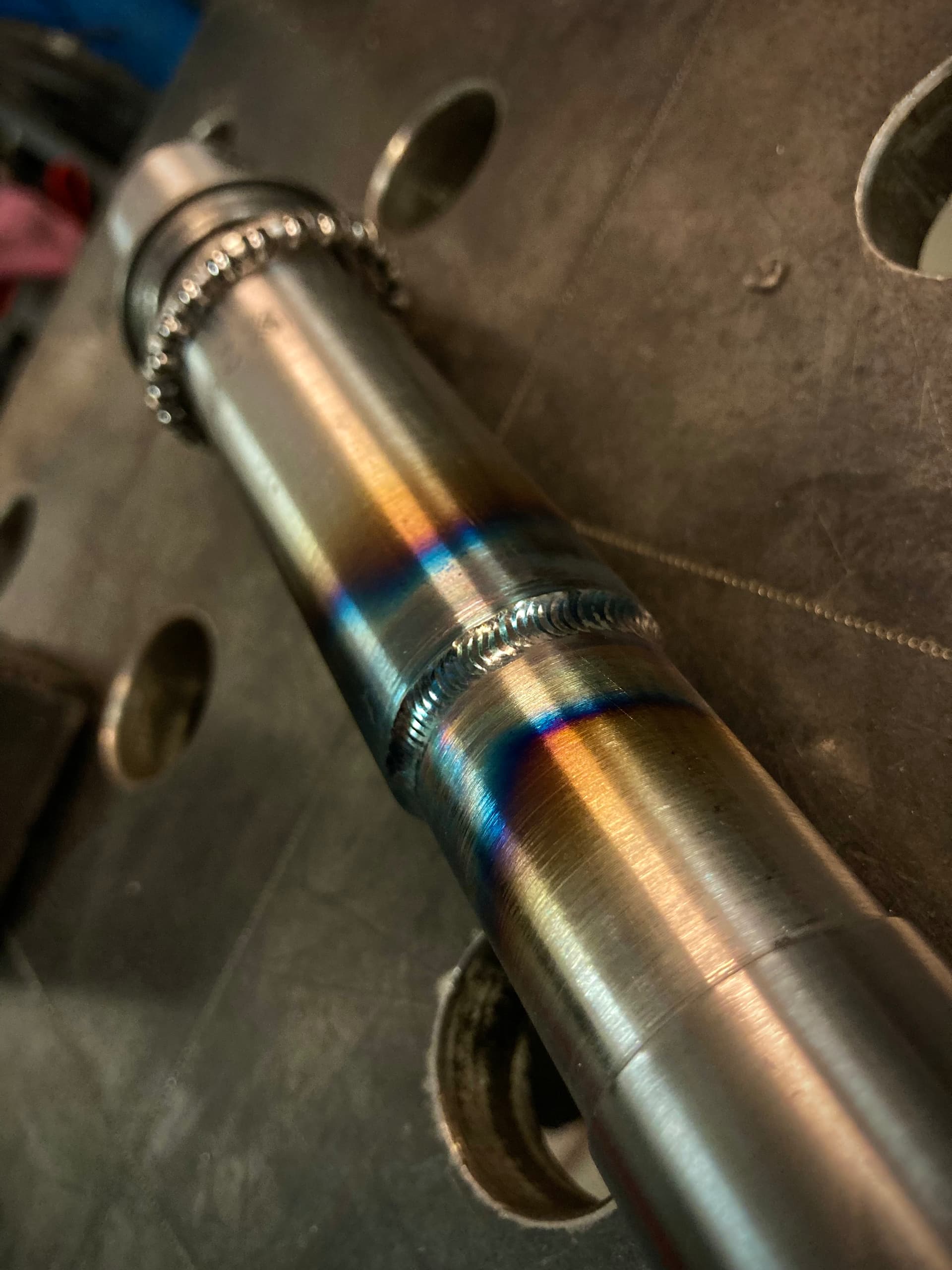

I’ve had good luck making long steerers by using 1.125x0.058 tubing and then making a tapered shim out of 1.125 x 0.095 (about 2.4mm thick) that is turned down to 1.010 on the OD and tapered at the top end. This is inserted with force (freeze the insert, heat the steerer, use a big hammer) before the crown is brazed up. I don’t know for sure that this is a good solution, but an old tandem builder who I trust a lot recommended it. I made a few 500mm long steerers (for cycle trucks) using this solution.

I much prefer to extend the steerer and use a longer headtube. I think this will put less stress on the bearings than an overextended stem would. I’ve had some success with extending steerers using industrial precision seamless tubes and tig welding them in place. You can get 22,23mm ish tube and press it into a 1" threaded steerer or get a thicker one and turn it down to size as you said. Worked nice for a couple of cargobikes.

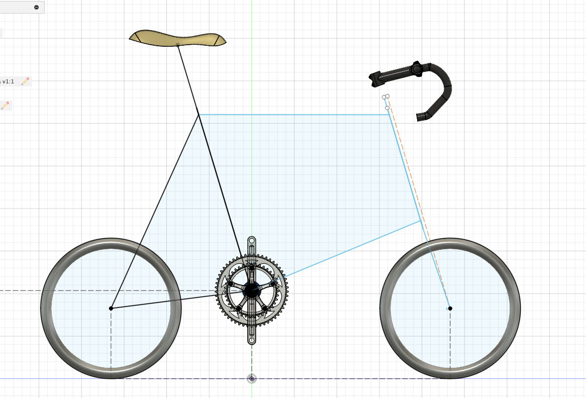

Here’s a very rough mockup, to give you an idea of what I have in mind. The parts are random at this point. There will be lots of real estate on the headtube and chainstays for front and rear racks, so I’m thinking of a radonneur like setup.
I love this idea.

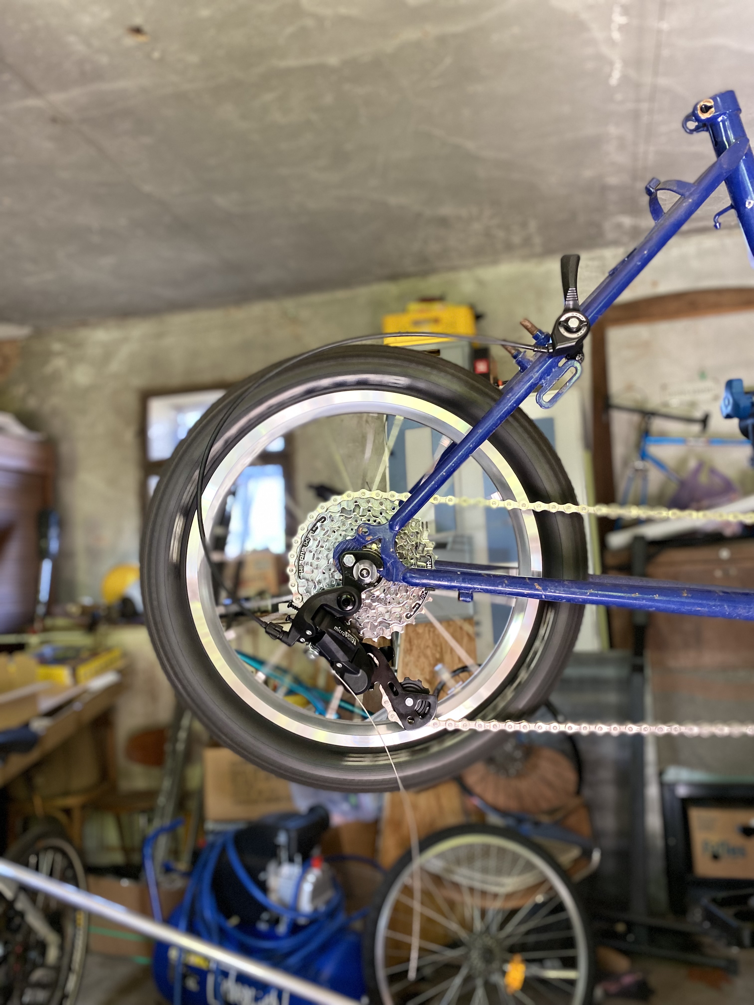

I am only commenting to say the Microshift rd actually works well, definitely works with 30t and maybe even 32t. An older road rd might look better, but I don’t mind motivating Microshift to keep making these… with immense buying power of like 7€. Pictured on a 305 wheel.
