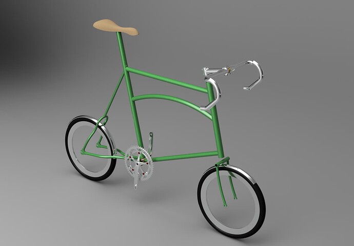

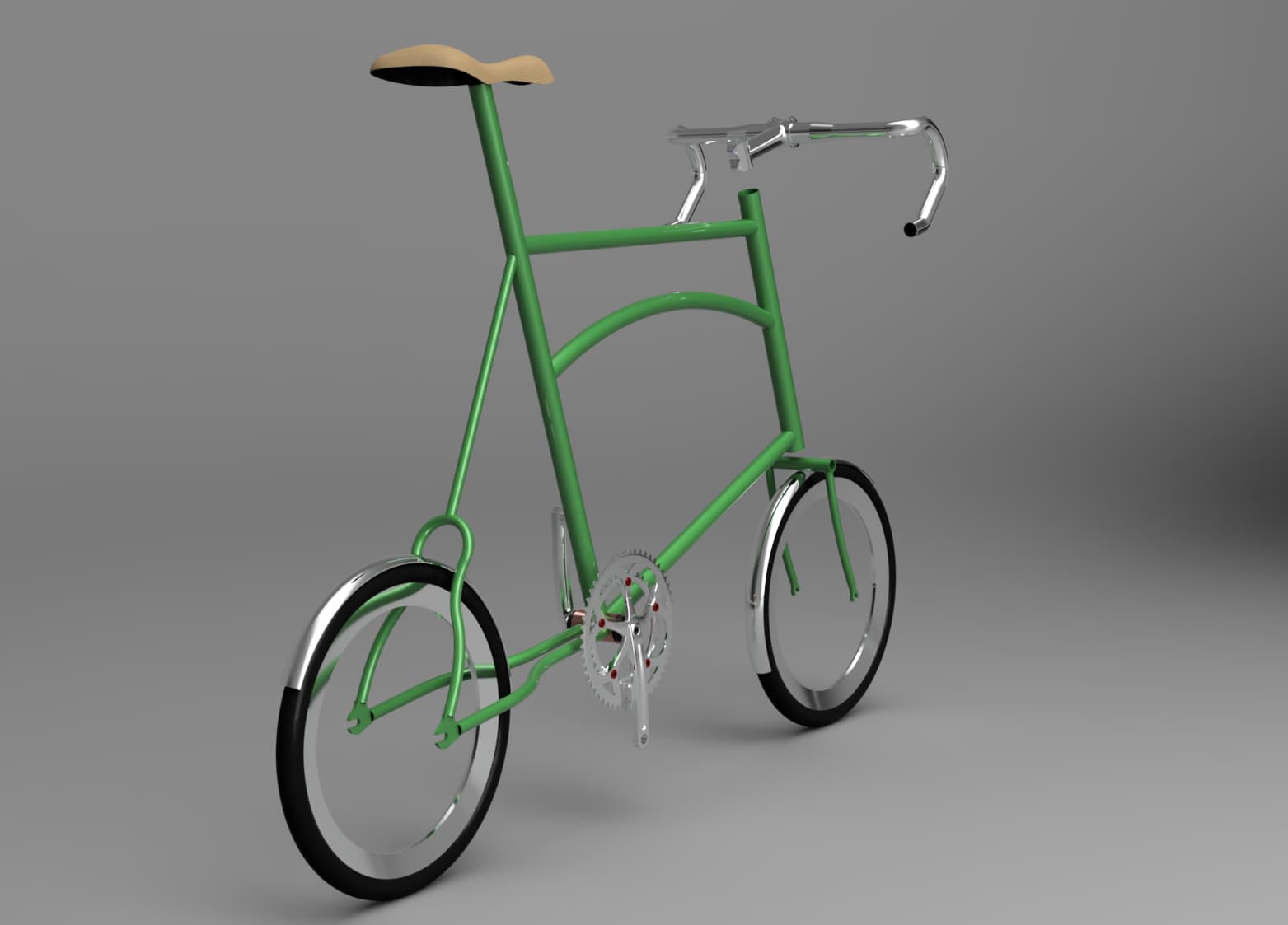

As for the general design I decided to add a second horizontal tube to the frame to add weirdness and went with a mono seatstay. Here’s a render of the general idea - by far not yet 100% accurate.

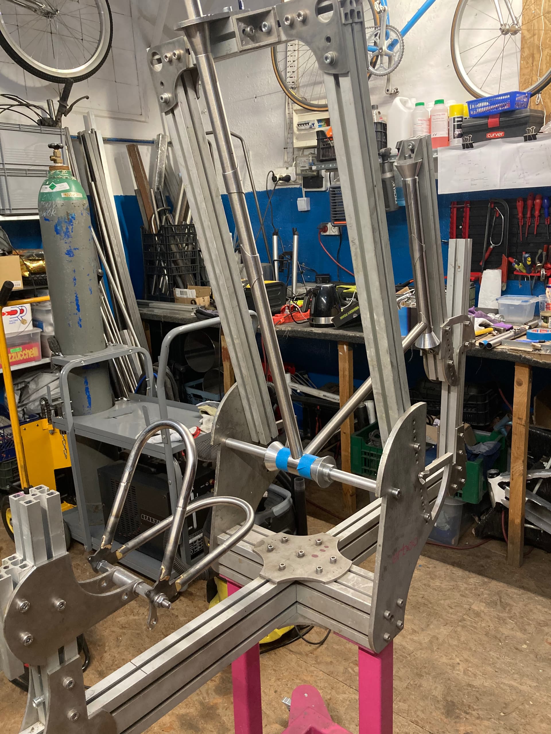

I’m finishing up my frame jig, as it needed quite a bit of upgrading.

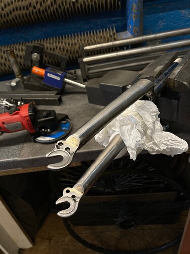

Also, gear wise, I got a set of Shimano 105 Golden Arrow brakes and levers. This should make things stylish, will need to give them a good buff though.

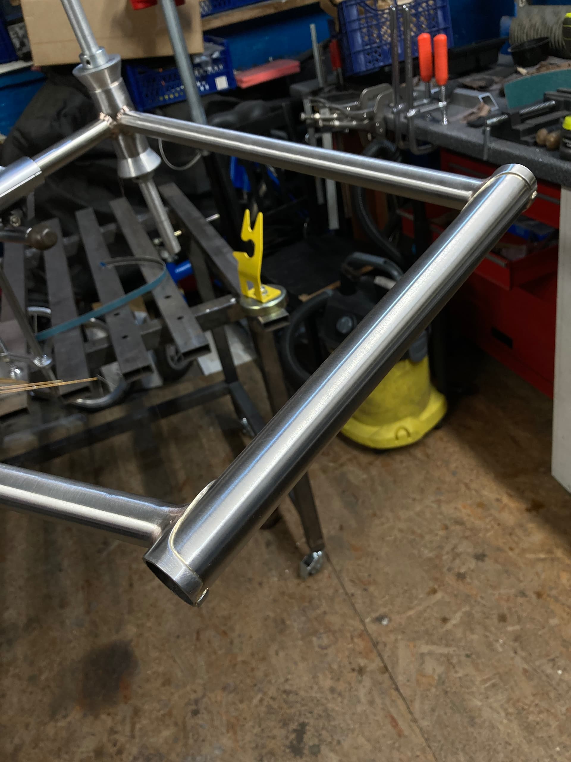

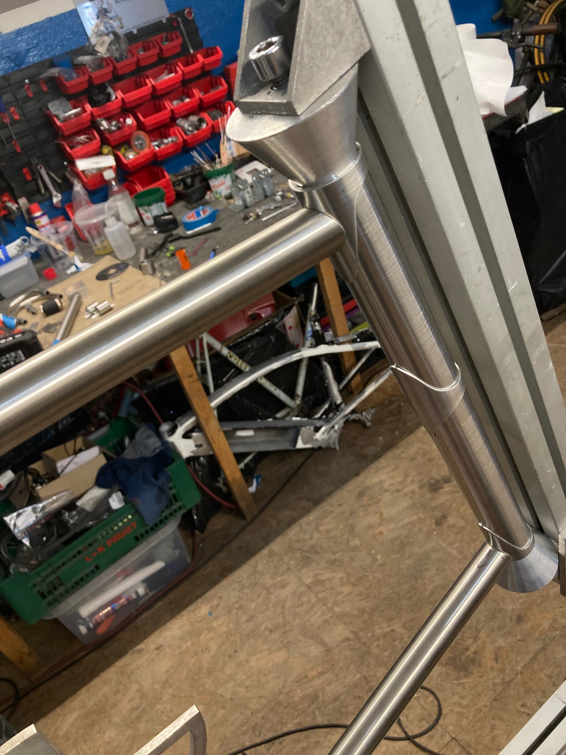

Some work done, still a bit to go. I took a leap of faith and went for a bilaminate headtube and seattube. After a long-ish filing session the faux lugs are taking shape. Also simplified the rear triangle a bit.
Here’s the the ridiculous rear triangle I came up with. It really looks mind boggling due to the overall proportions of the bike.

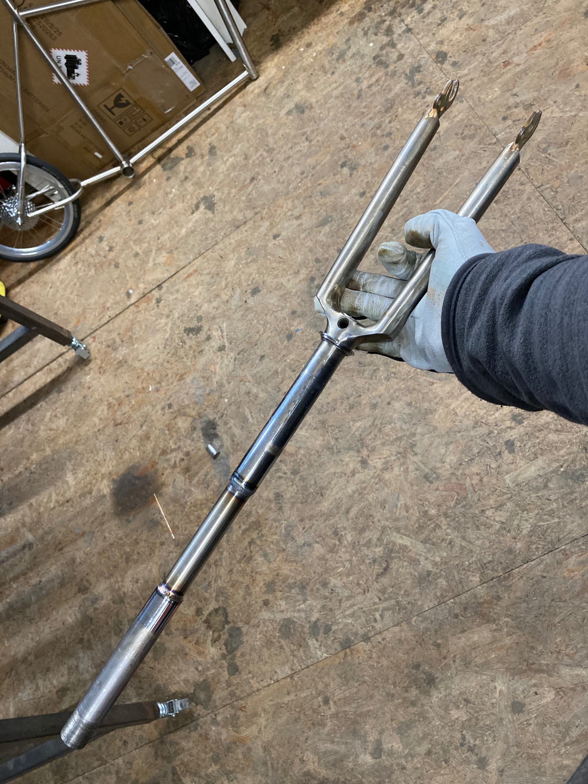

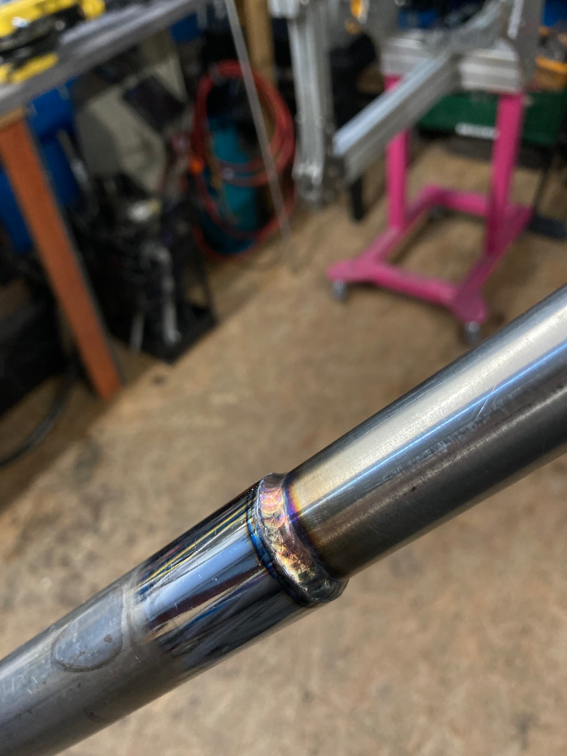

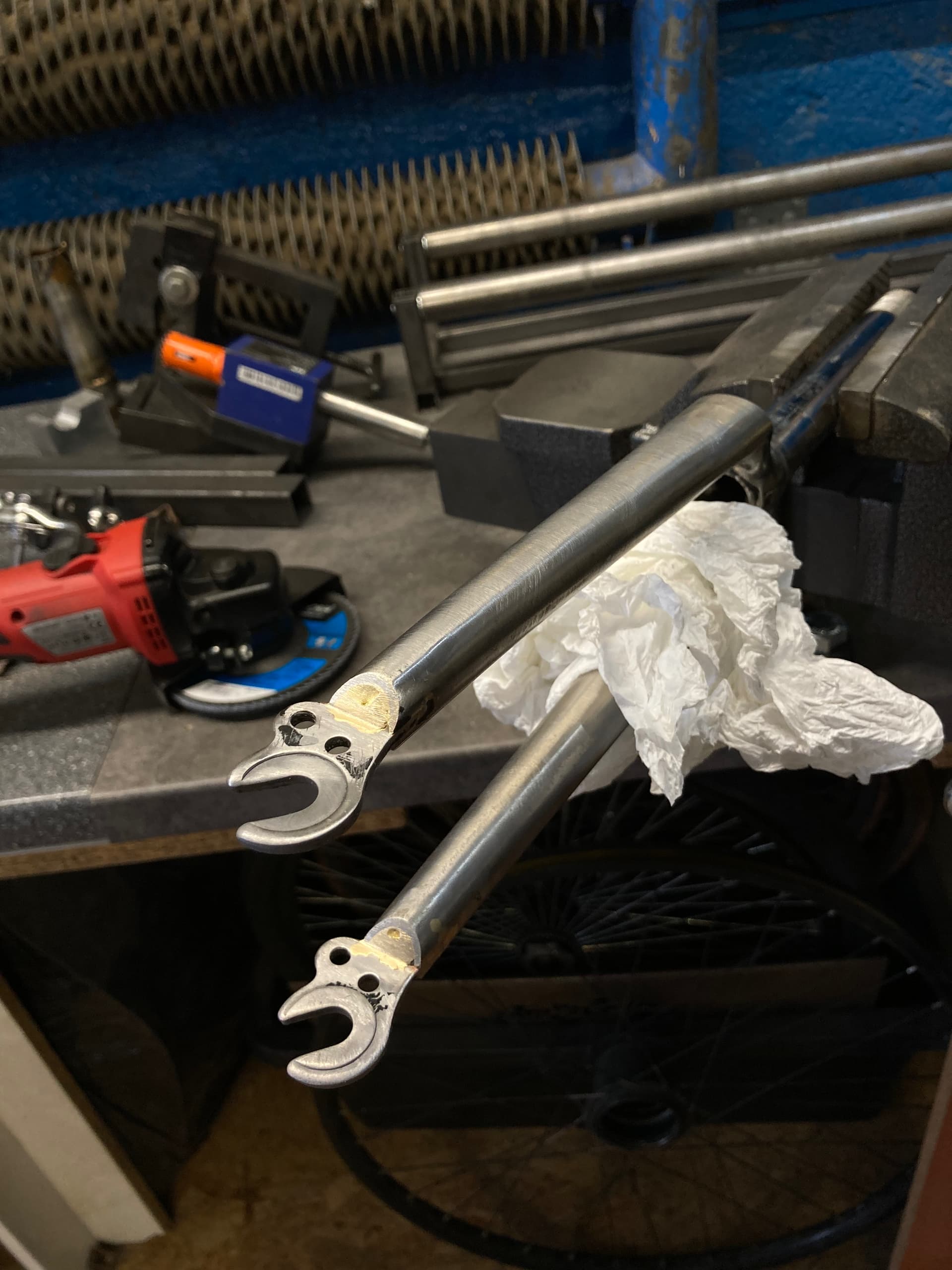

Also the fork got chopped and I performed a steerer extension procedure worthy of a south american plastic surgeon.

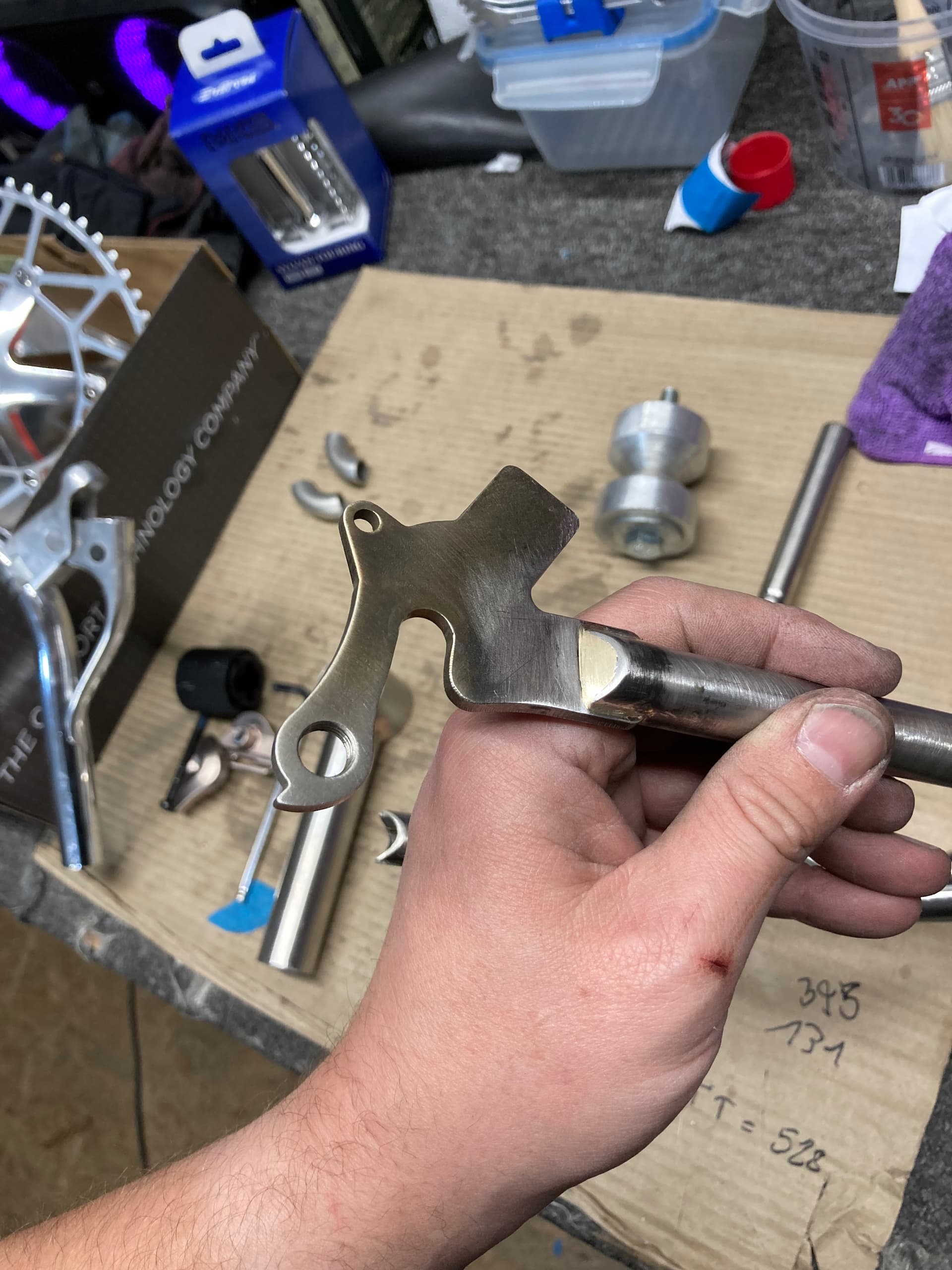

For my first attempt at making stainless half lugs I think it came out not too shabby - I made notes to improve. It was a pain to get it to look presentable, my hands were “tired”

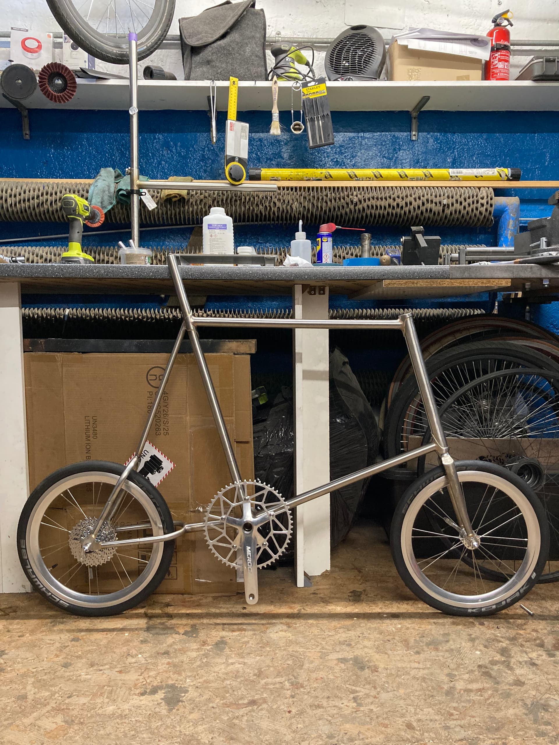

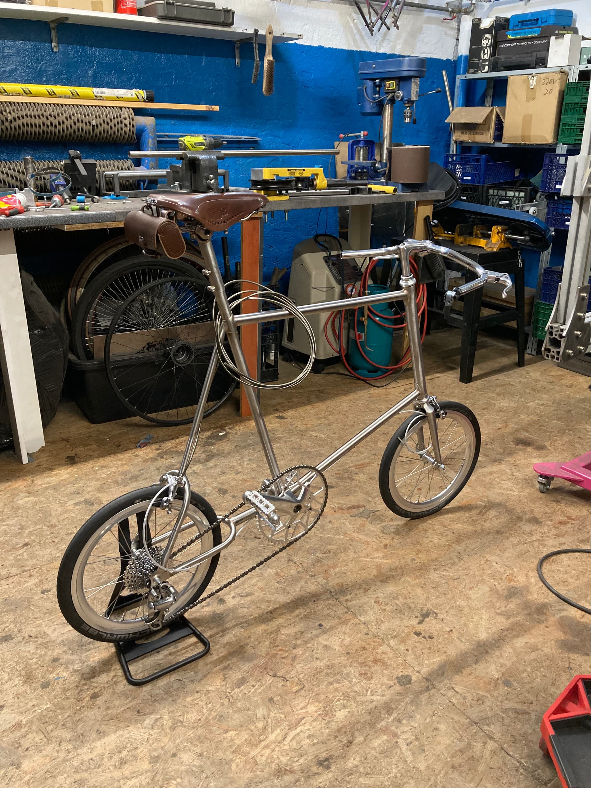

Here’s the first mockup, tons of clearance for a big chainring, which is good because the first test ride proved the 56t is not too much at all for this wheel size - will probably go with 60t
Ready for the first wonky ride. Did not have the time to do a proper fit (the mast needs to be shortened about 40mm) nor did I connect the brakes - just had to try if it even is a rideable bike, so heel to concrete brake it is. Got tempted to mount a moustache bar with some old shimano golden arrow brakes and levers. Might go with a different cockpit version later, I’ll probably make a stem/handlebar combo.
Finally had a chance to ride it properly, what a blast!
I will probably build a custom stem, right now it’s like riding in the drops. Maybe a stem/bar combo?

This looks great. What’s the front centre like? I built a 20” wheel polo bike once that repeatedly threw me off the front when I used the brake. F-c too short for the low front axle.
It’s 572,5mm. Didn’t try to pull stoppies yet, to be fair I’ve got some antique brakes on this thing with stopping power I could only describe as placid at best. It’s a short small wheeled bike, I’m aware it will have a greater tendency to buck when stopped abruptly. On my previous minivelo I went the other way a bit too much, moving the saddle almost exactly over the rear axis. This made it very hard to take off quickly without a unwanted wheelie.

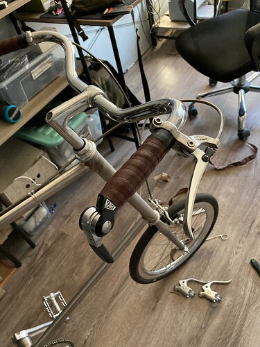

Decided to flip the moustache bar upside down. This gave me an 80mm rise and a more city appropriate riding position (your mileage may vary). Picked up these very simple skeletonized brake levers at a very good price, they have a light vintage look to them - the adjustability being a tradeoff.

Oooo Tektro FL 750 levers! My absolute favourite brake levers I’ve seen yet. I put the black version on a friend’s bike and ever since then I want a silver pair for a bike I don’t have yet. I’ll probably use them when my first frame is done.
Mine too! Just a surprisingly rigid chonk of metal through the fulcrum and zero consideration for appearance features that don’t add functionality. I for one like the look of functionality.
