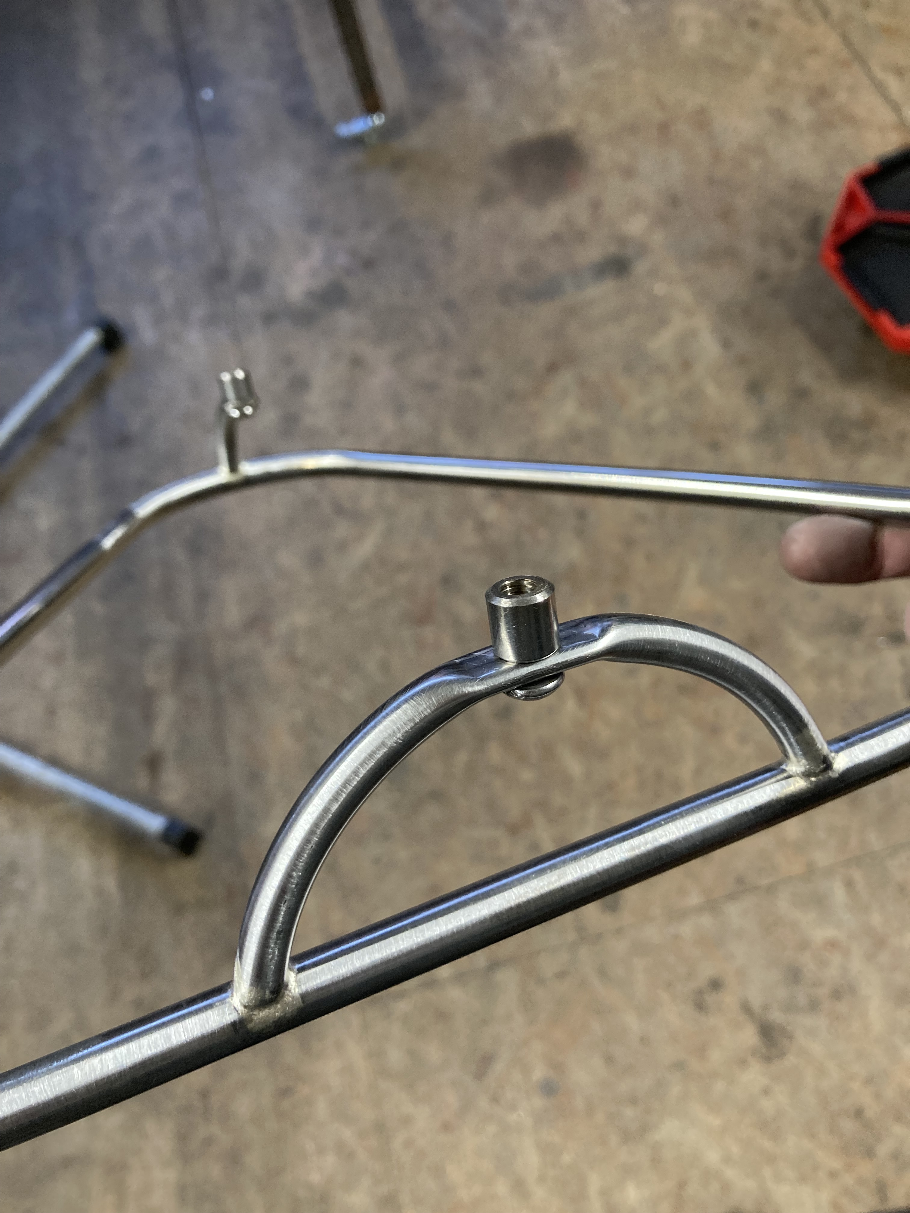

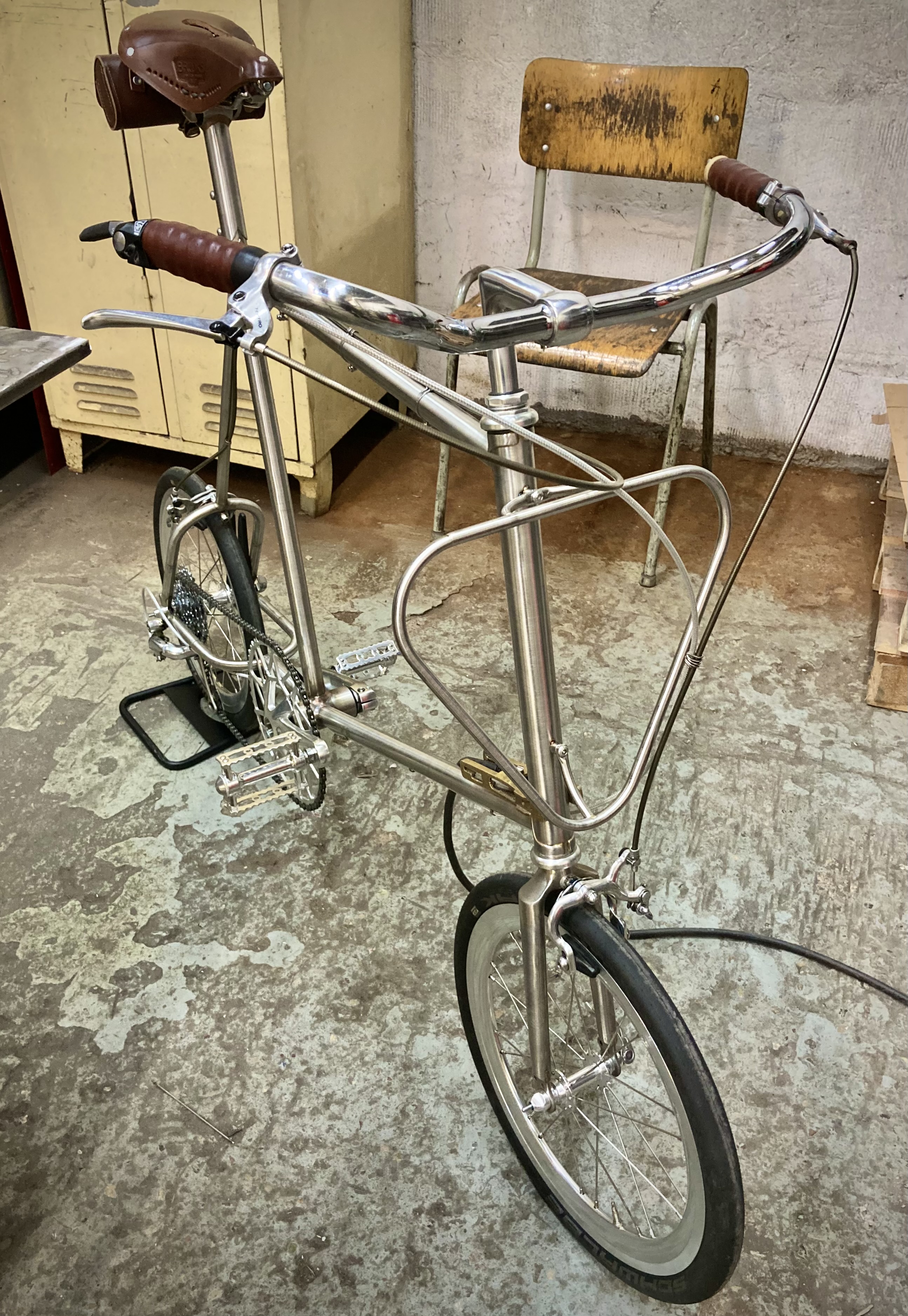

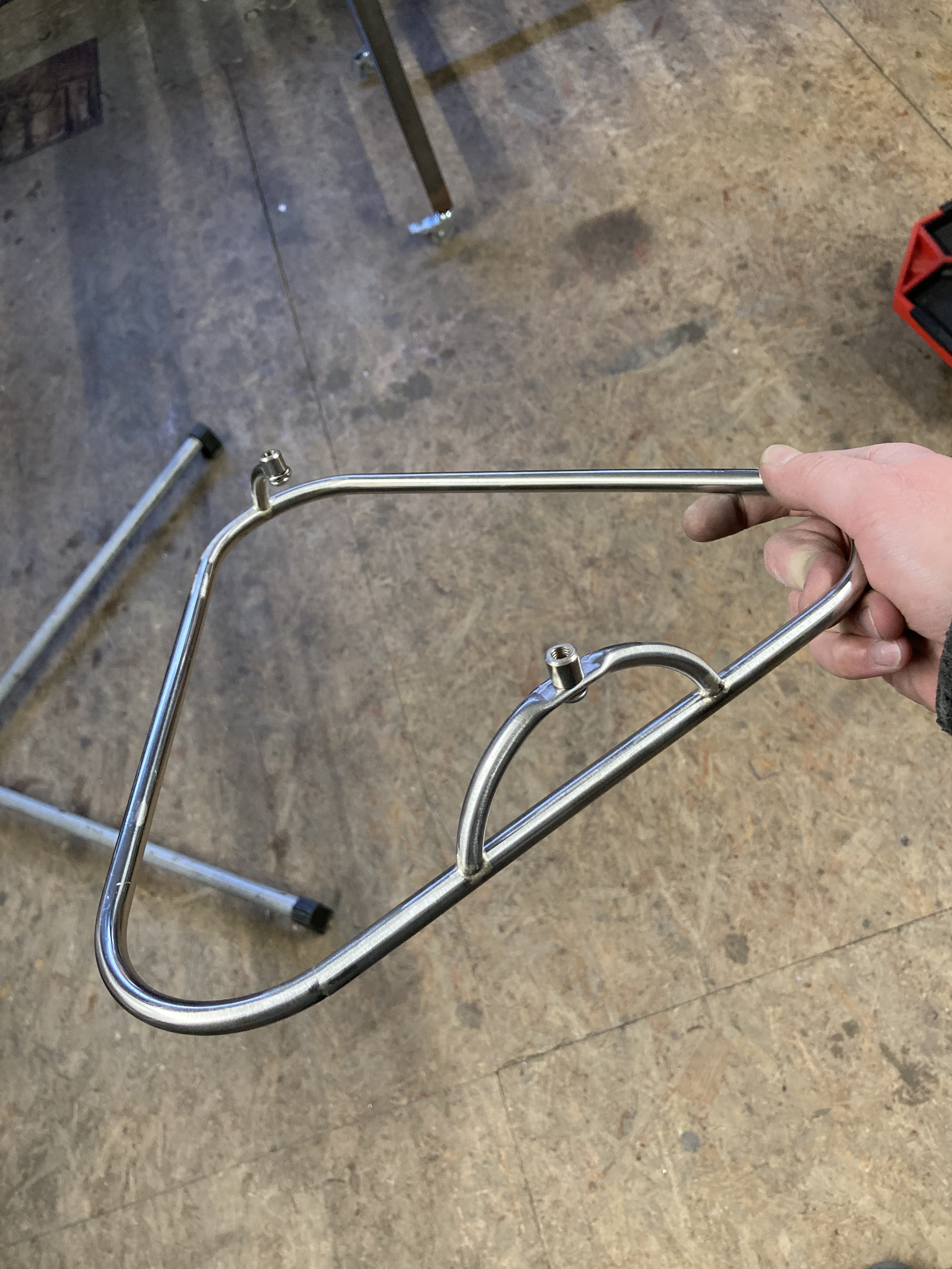

Hi Y’all, finally had the time to whip up a front mounted rack for my Brooks Scape small pannier. I was thinking od using the brompton front bag system for a while but it’s just so bulky.
The whole thing is attached to the headstock via M6 threaded weld ons

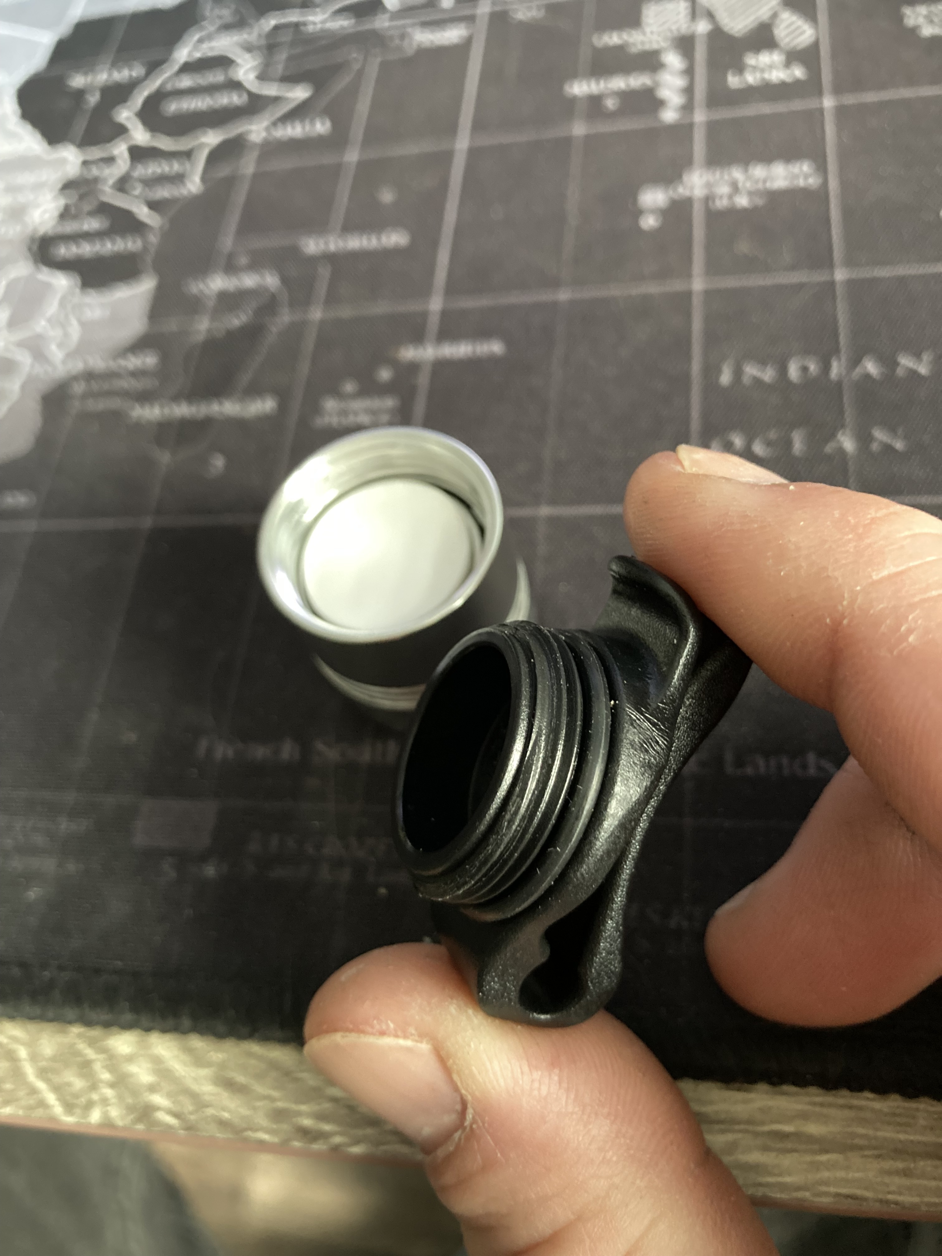

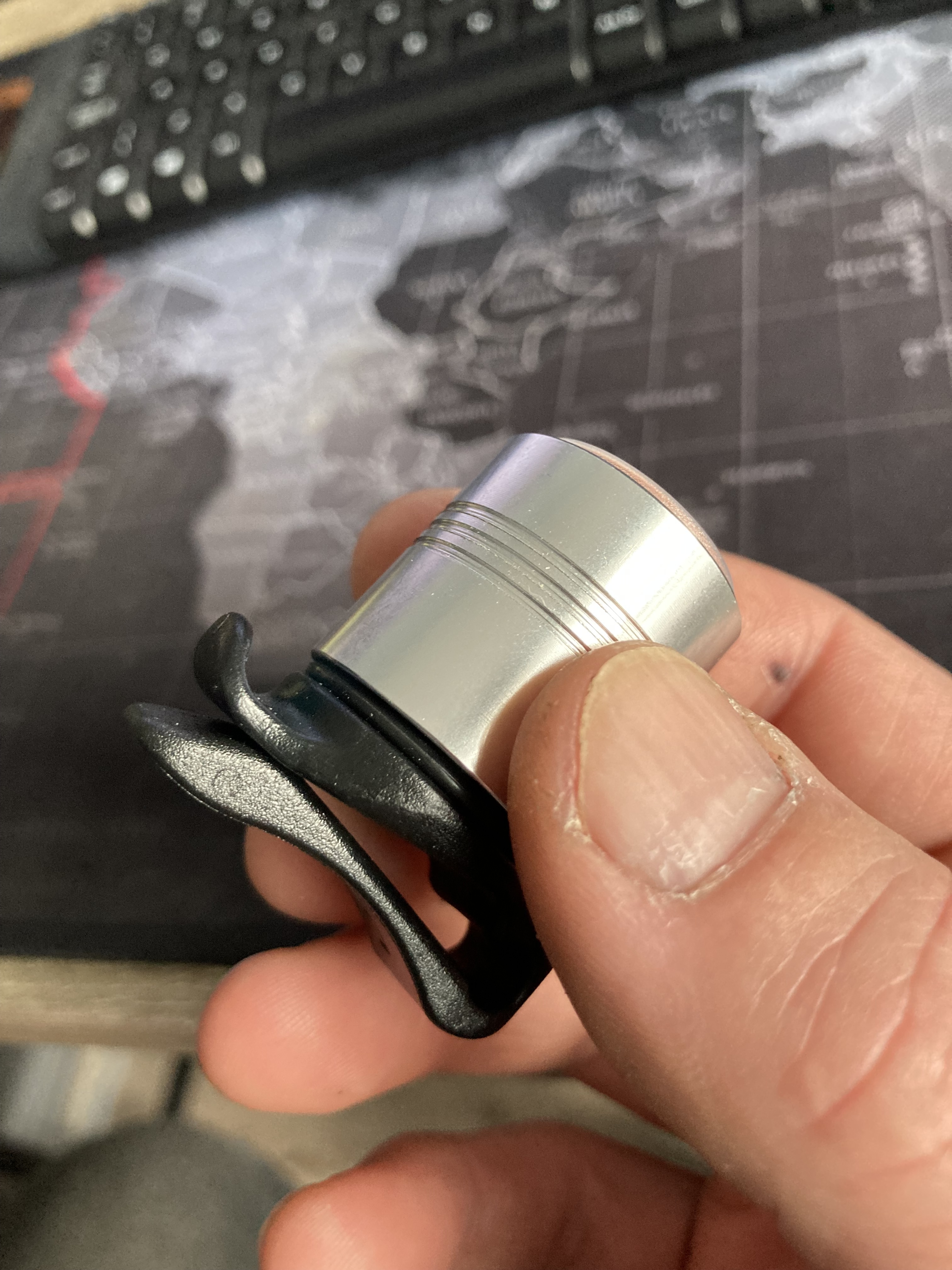

I was also looking for some nice lights which would fit the build, there was a great deal for a lezyne femto set so I pulled the the trigger. Turns out they have an M24x1,5mm internal thread on them and that should match somę of the automotive oil pan plugs on the market - that gave me the idea to make metal mounts for the lights fixed to the frame. Will post as soon as I have the opportunity to test fit my theory.

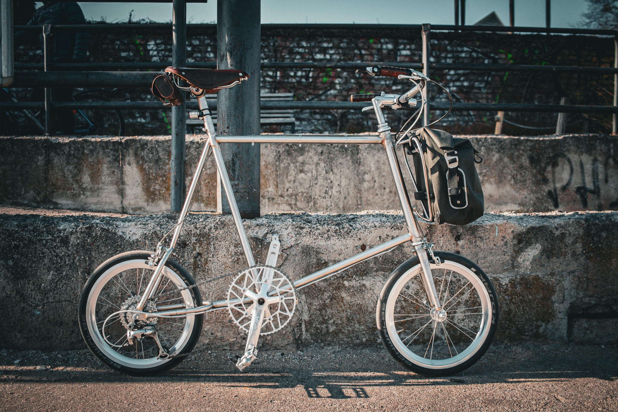

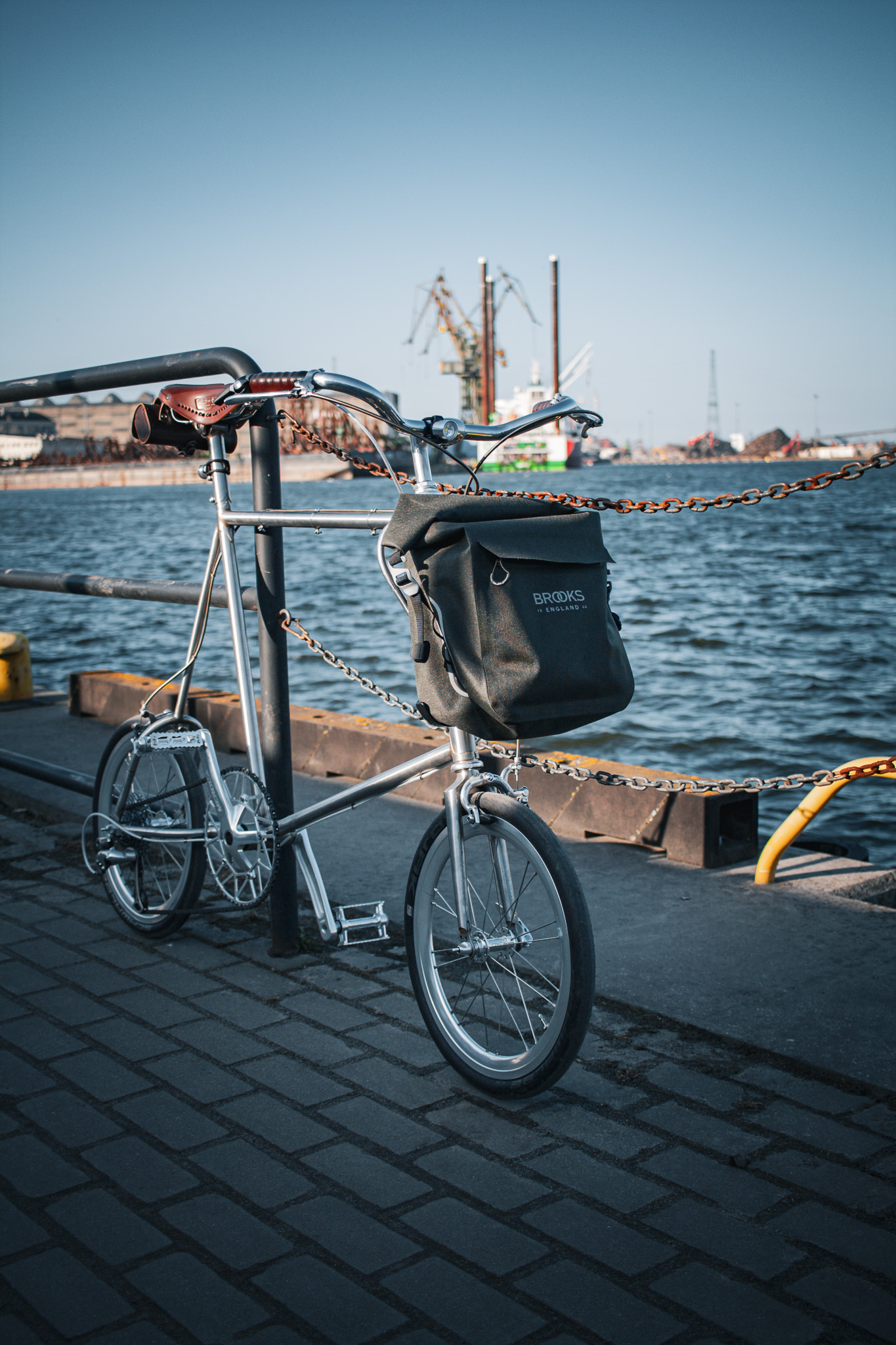

Also, I did a couple of shakedown rides with the front rack and the Brooks Scape pannier attached. This is becoming my favourite city errand run setup.
