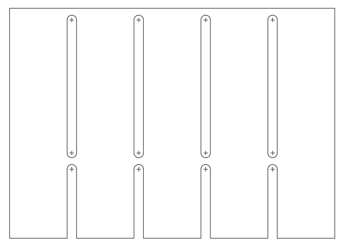

I need to make a bonding fixture to enable batch processing of the test samples and to be able to have a consistent bond gap. My plan is to go with a geometry like this, with the idea that I can align the specimen sheets form the grooves and control the overlap length. After curing I will cut the samples apart.

I am working at one of the above adhesive suppliers in testing. For the jigs we lately opt for very simple 3d printed jigs out of PLA when the adhesive is only room temperature curing. Similar to your design just with a stop at the end to define the overlap. Of course only works if you lapshears have the standard 100mm. The gap is adjusted with simple shims.
What gap thickness you’d like to go?
For temperature resistance and raising the Tg of those 2component epoxies a tempering or curing at elevated temperature is a thing. You might want to consider it.

I was thinking of milling the jig from MDF because I’m not sure if my 3d print would be flat enough. 3D printed one would be much easier for me to manufacture though.
I’m aiming for 0,2mm bond gap.
