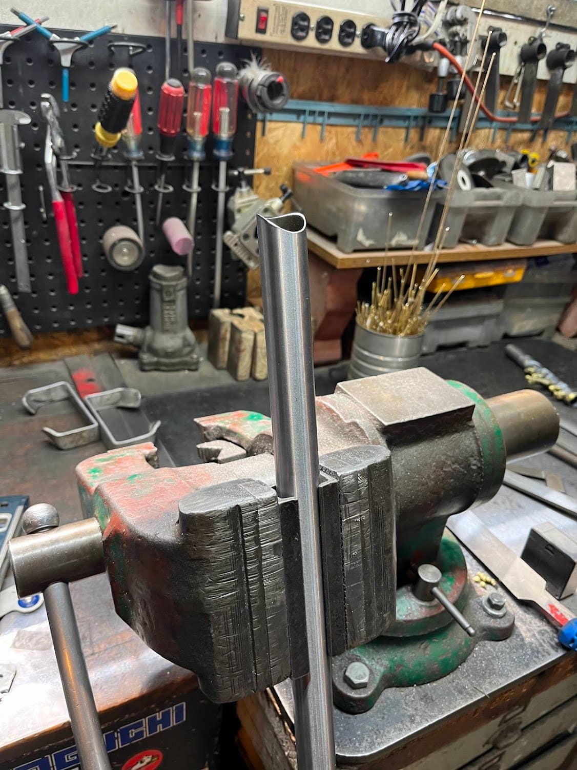

All tube cutting and mitering was done by hand

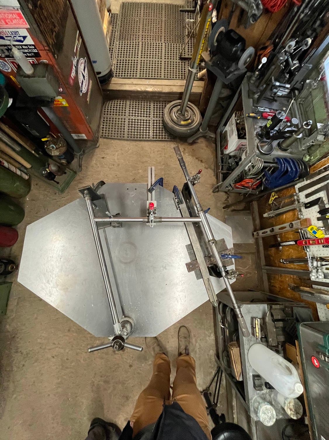

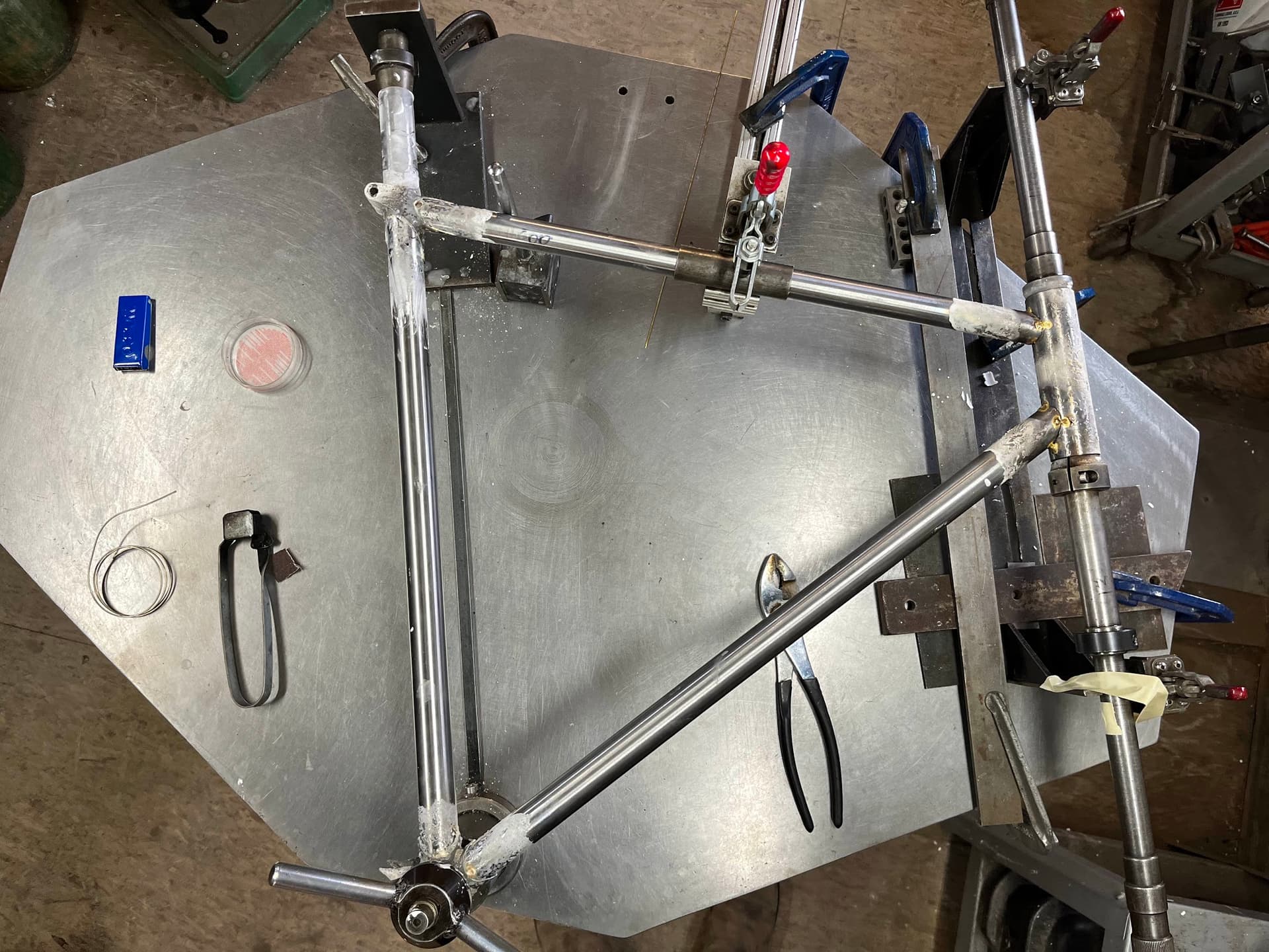

Starting to see a frame come together on the table
Tacking the front triangle
Brazing

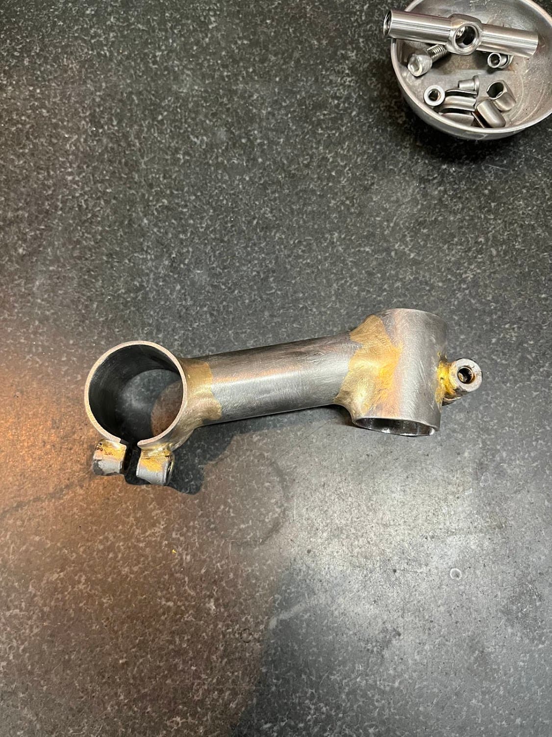

Stem!

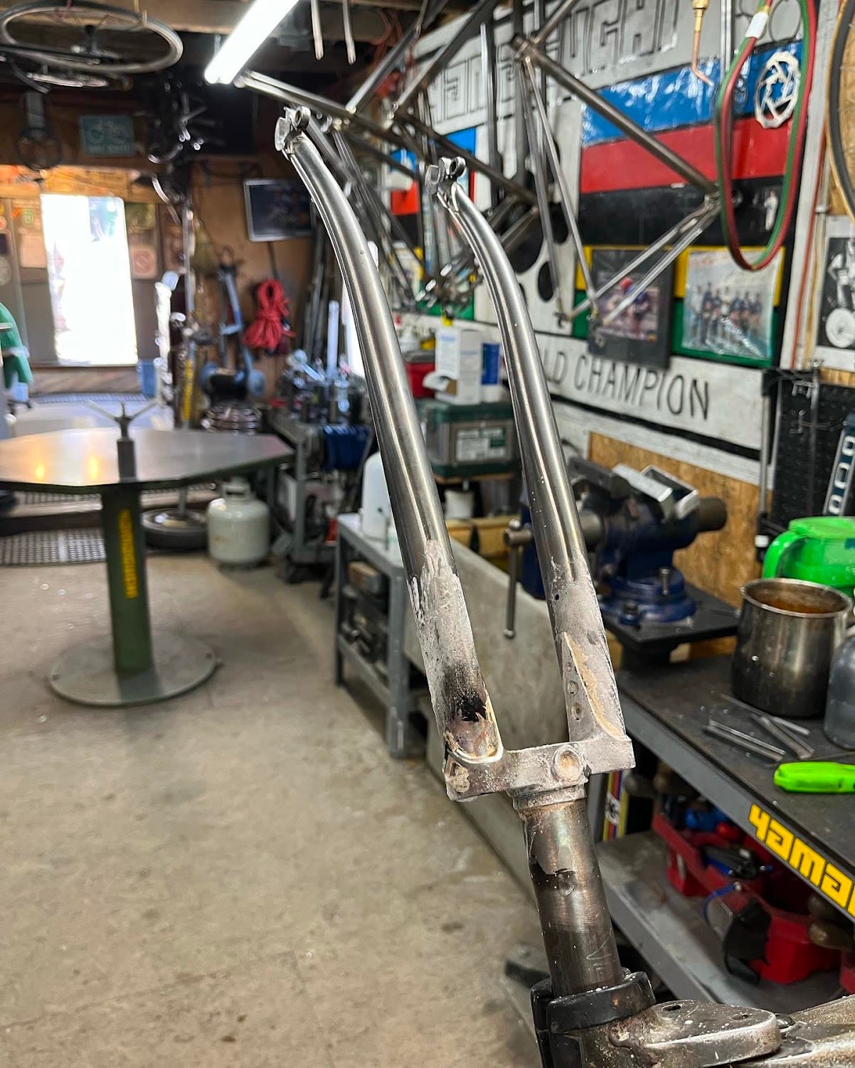

Fork!

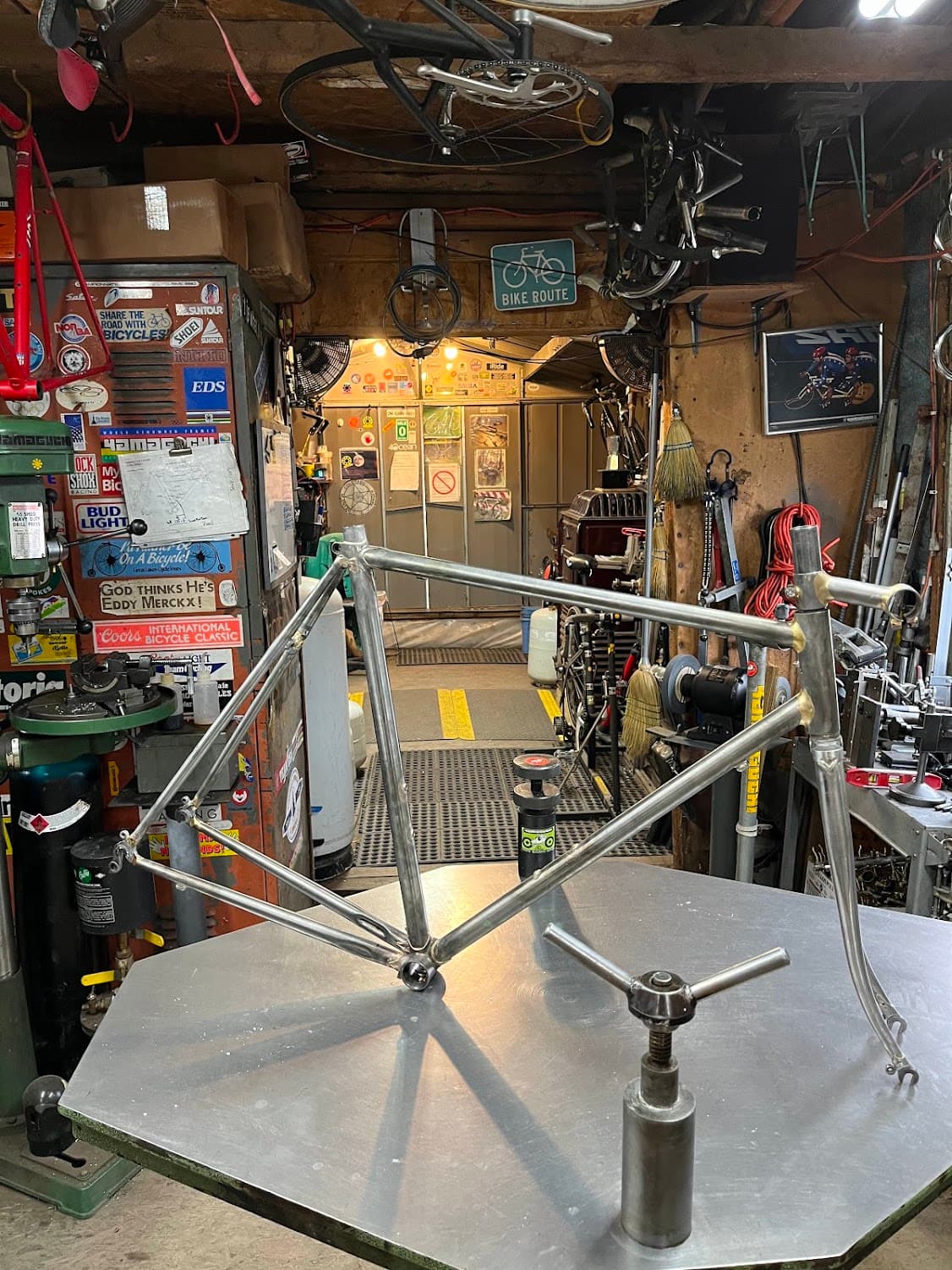

Frame mocked up with fork and stem

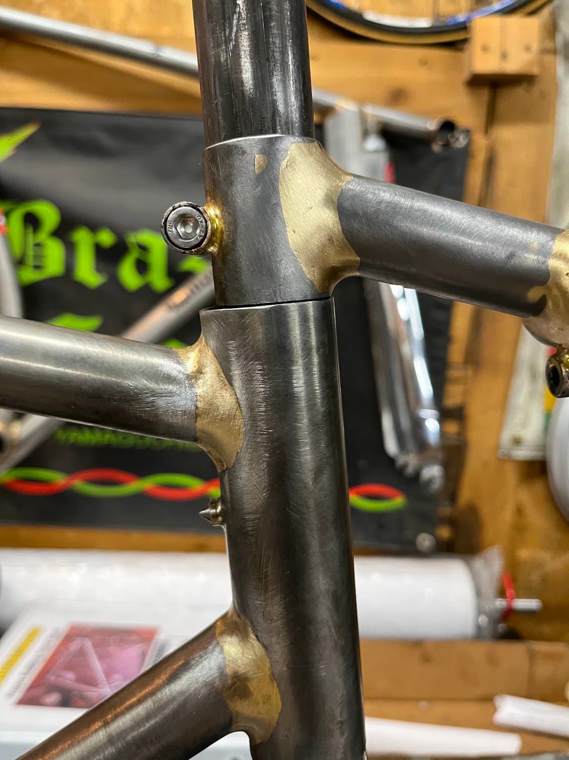

Cleaning fillets

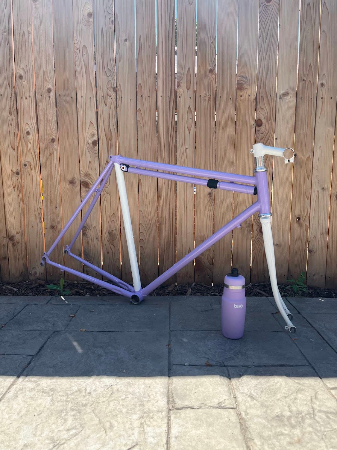

Paint!
…fast forward again…

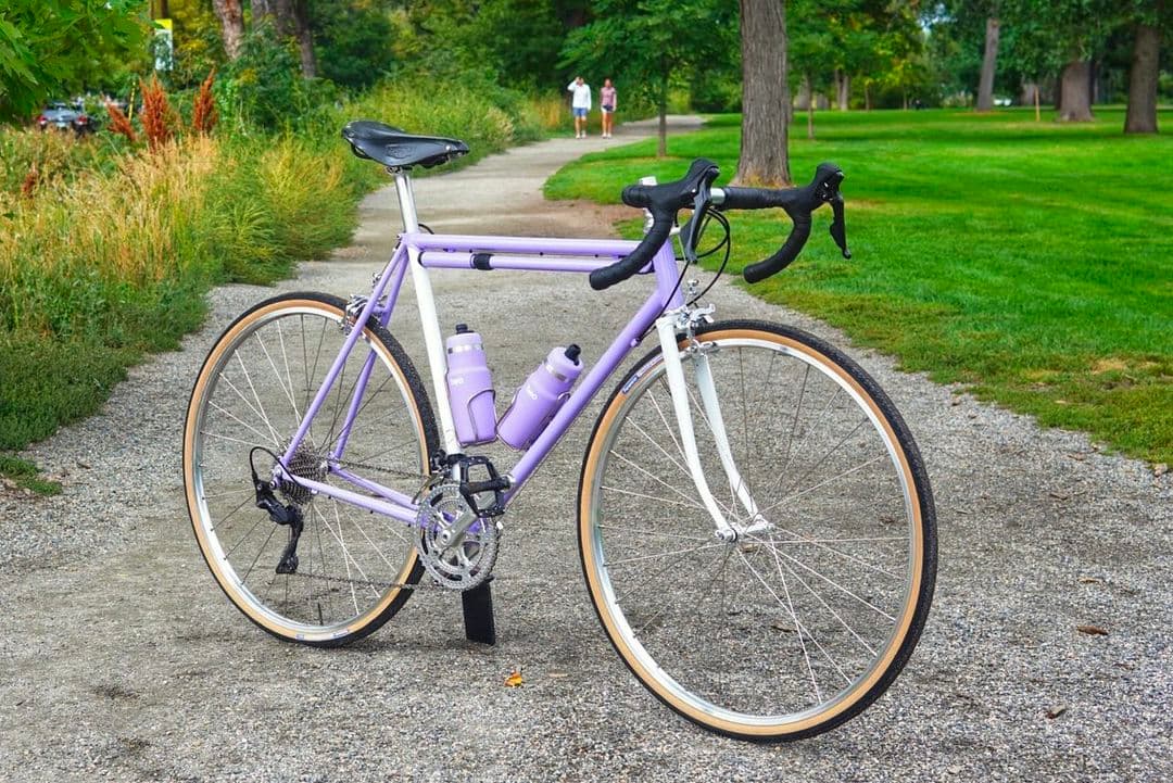

Final build!

Very cool. Great work documenting the process as well. It’s funny to see that the jig and alignment table are the same thing. How efficient.
