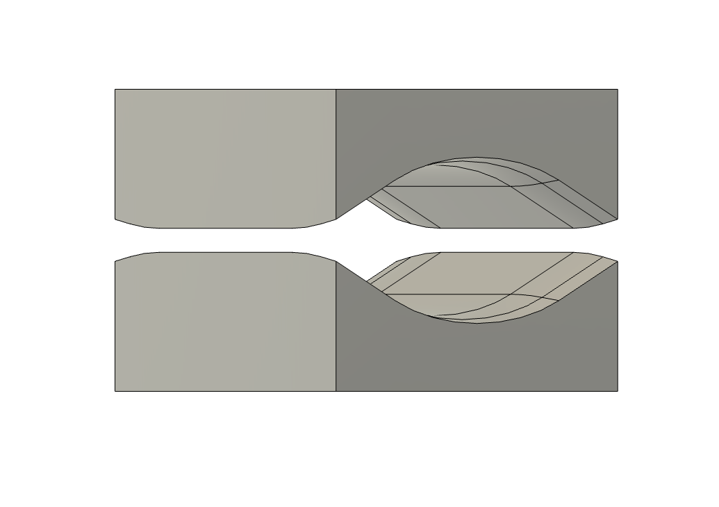

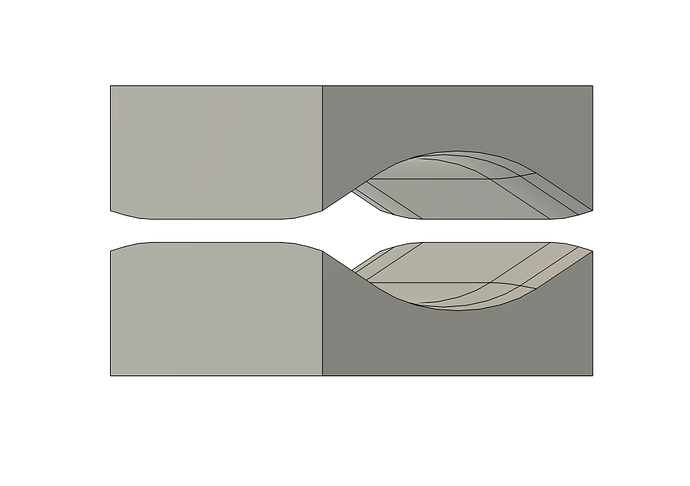

I’m trying to do things the cheap way and I’ve got spare top tubes to experiment with. I’d like to have an oval top tube but I don’t really have access to a massive press, or machined dies. I do have a 3D printer and a vice though. I was wondering if it’s possible, or even a good idea, to squish the tube small sections at a time? Just about as long as I can print and can fit in my vice. Maybe even squishing the tube gradually in a few passes? I would 3D print these dies that have a little chamfered relief at the ends so that the tube doesn’t get any weird stress from the harsh end of the printed die. Thoughts?

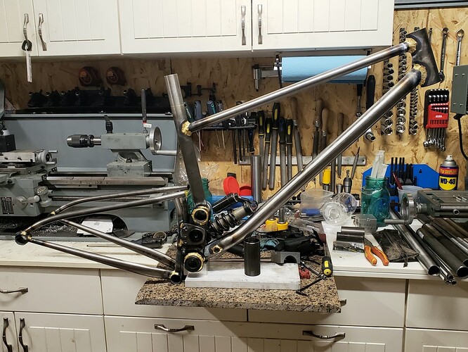

I ovalized the toptube on this frame I built in 2019 by just squishing it in the vise between two length of wood.
