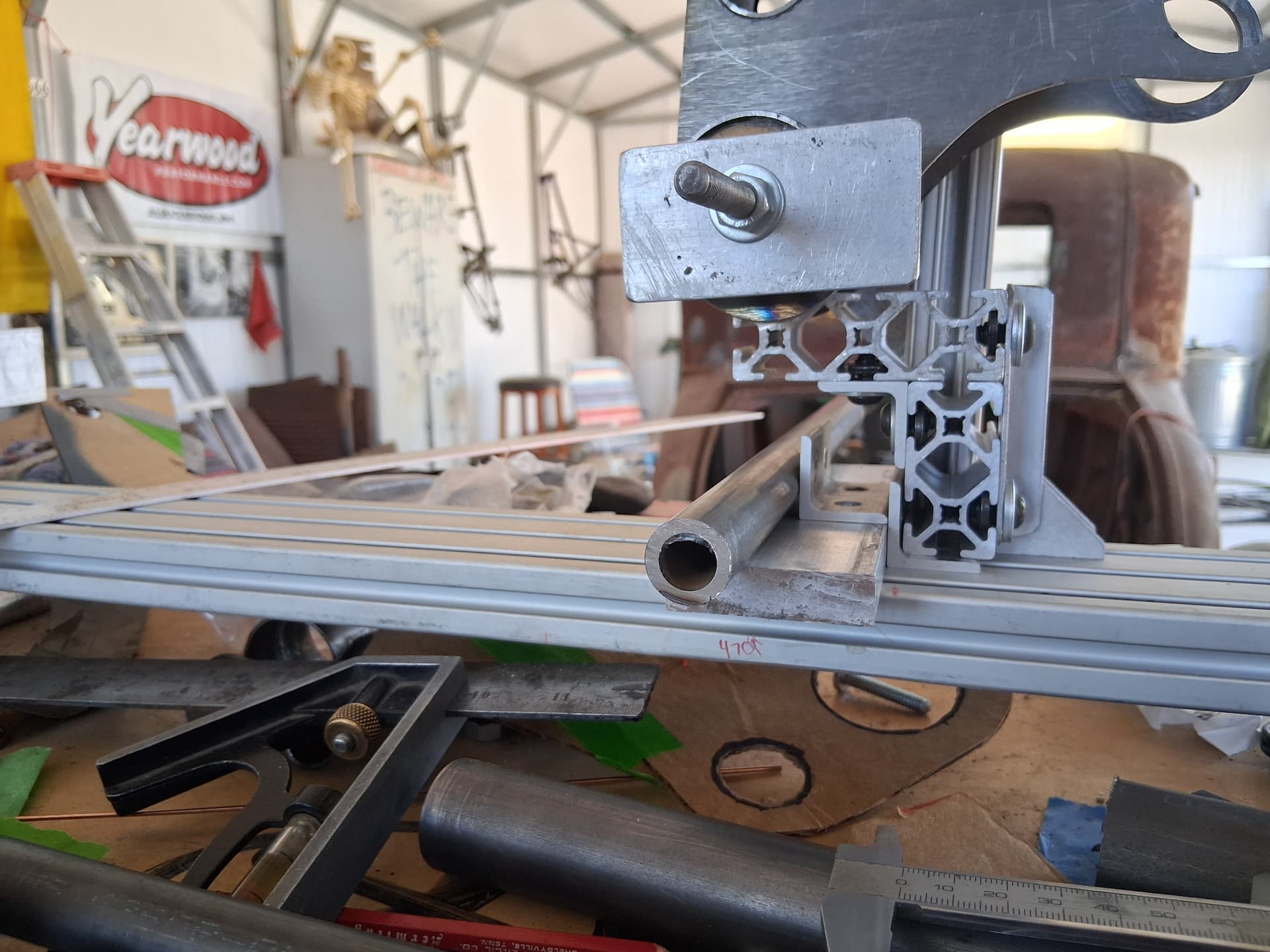

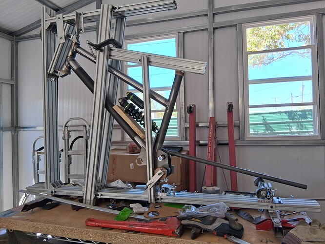

Back in the jig, I raised it another inch so I can get all the way under the bottom bracket to build the rear end.
You ever get the feeling that the thing just wants to be built? When the dumb little shit you try with stuff you have laying around just…works. You dont need to make 10 trips to the store or whatever, that was today. That doesn’t happen all that often, so I’m gonna take a victory lap.

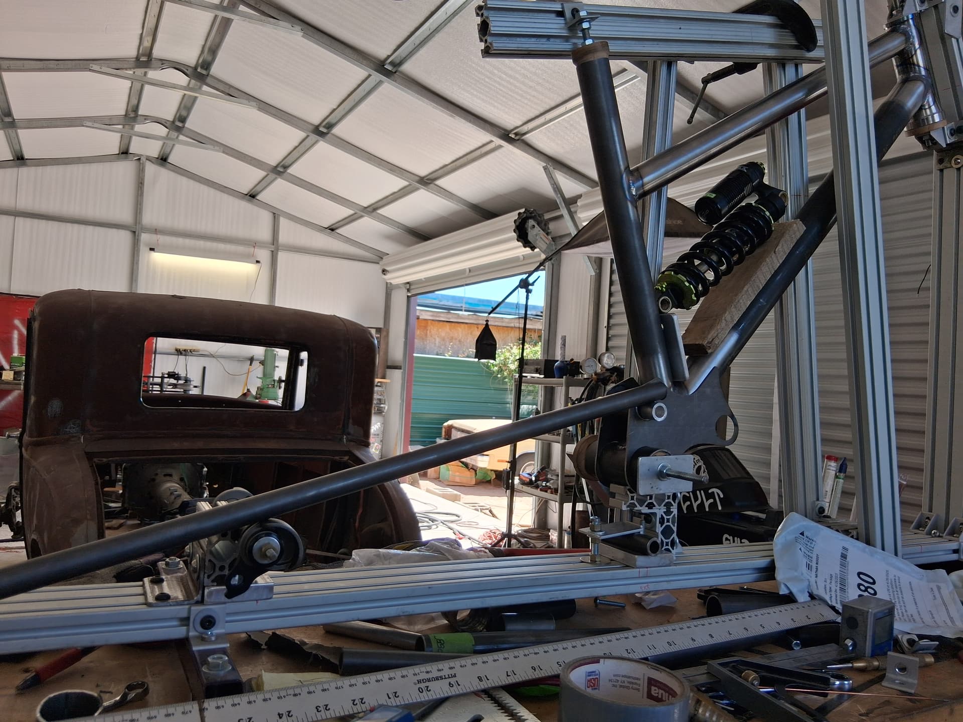

It’s a long, dumb story, but the ending is that the place where the pull link needs to mount is .004" away from being dead nuts on. On my “pRiNt” that center pivot point is 79.5mm below the center of the bb, thats 3.129". As it sits in the jig right now it’s 3.125" to the center and im gonna call that good enough. I’d rather be lucky than good.
In another huge personal victory, it doesn’t appear that I’m gonna have to cut a big chunk out of the top tube to clear the piggyback on the shock. I don’t even know who I am anymore.
I also set a “seat stay” in the area just to get an idea and i really like the profile. Kinda fun to think there will be no bike above that point, just tire.

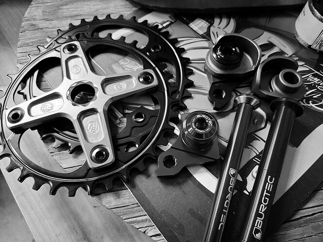

I’ve been back and forth on a bash guard. First, it would need to live in the same area as parts of the rear triangle, chain stays and link and stuff. Second, it always rubbed me wrong that a non-ebay bash guard is, like $75, when chainrings are $40-50. Im just annoyed that the sacrificial thing I gotta buy to protect my expensive chainring, costs more than the thing it’s intended to protect.
Enter the 36t, ebike chainring. They’re cheap as a red brick and just as reliable. They’re steel, so they’re their own bash guard. I got a pair for $38 so if I do manage to, somehow, demolish one, I have a spare in my toolbox.

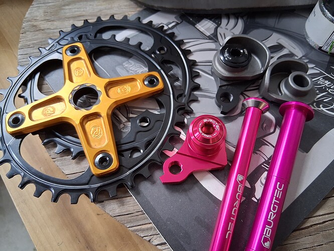

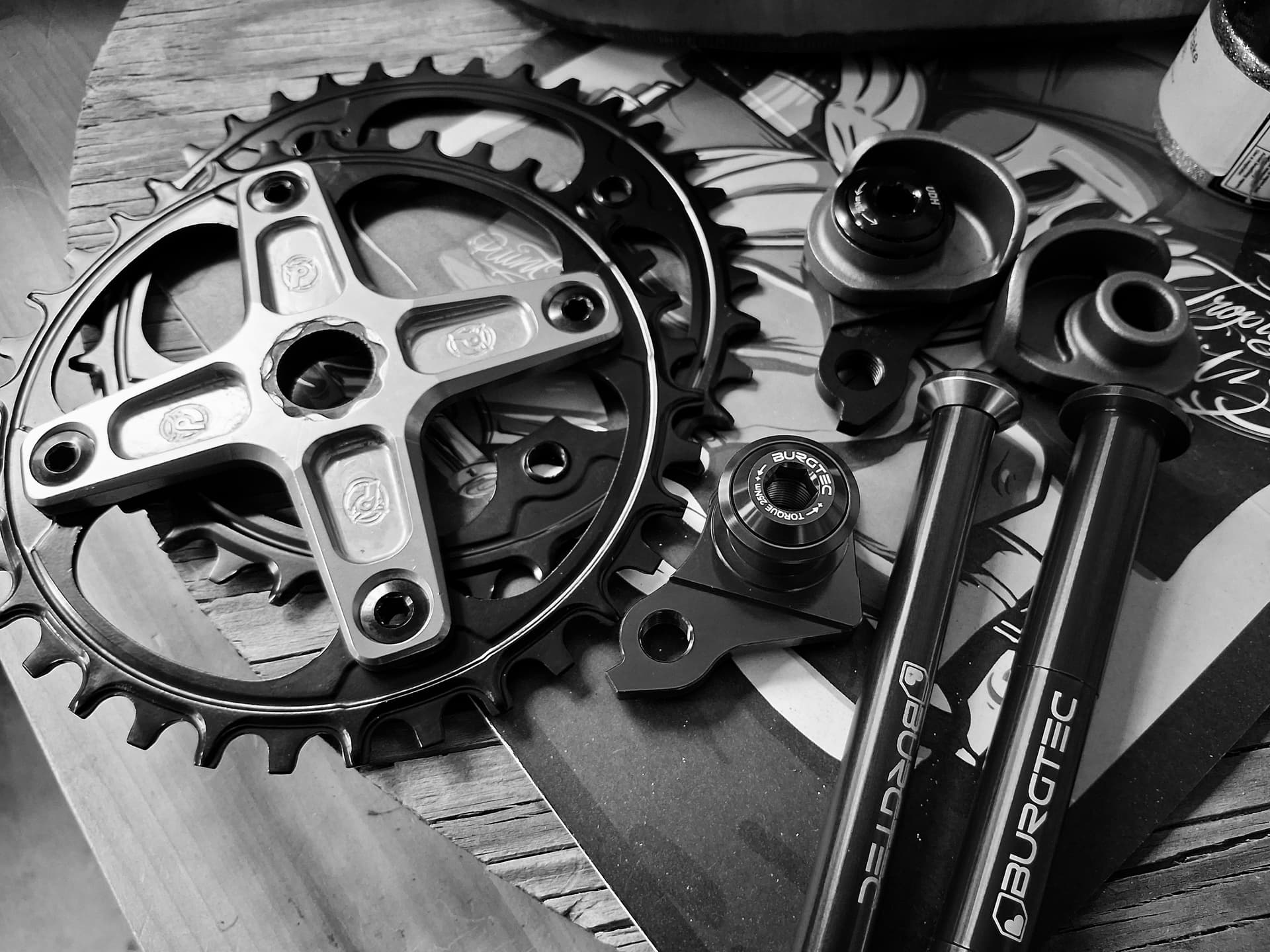

Speaking of spares. I needed a udh axle, figured I’d grab a spare hanger. Since I didn’t need to buy a bunch of stuff for this build, i thought a small color change was in order. The other one was black and green and gold. This one will be primarily black, keeping the green in the cockpit (stem, bars) but I’m replacing the gold with…
Guesses? First one to get it will earn themselves a hearty congratulations. You’re trying to guess the color of the burgtec axles and hanger, if I wasn’t quite clear enough about that…
Rootbeer? :rofl:
Nope! Points for first, though.
I’m gonna say Red. though I should have said orange based on the crank spider you have.
You seem like a pink guy to me
Sorry dude. And, to be a pedantic ass, the spider’s gold :grin: but im gonna paint it anyway…
And we have a winner! Nothing but pure, alpha male, tough guy shit here :joy: Hearty Congratulations!
It goes so well with black and acid green and I’m like a poison dart frog, the bright colors warn of my unpleasantness.
Also, want all the bros to leave you alone at the bike park? Put some pink on your shit, they have no idea what to do with me and leave me to my business. I love it.
What do I win?
Pretty sure it was a hearty congratulations, which you have received. However! As a special treat for guessing it so quickly, I’ll not only double your prize but I’ll also throw in a complimentary Home Version of our game. Thanks again for playing and a very, very hearty congratulations!

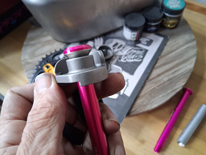

I failed to notice that there’s a beveled washer under the head of the Specialized axle, so it sits like this in the dropout.
Luckily, I have an app for that.
I have a countersink that appears to be the same angle as this washer so i can cut my bevel and fine tune how much thread engagement I get. Hopefully, I don’t have to modify the axle. I love it when a plan comes together.

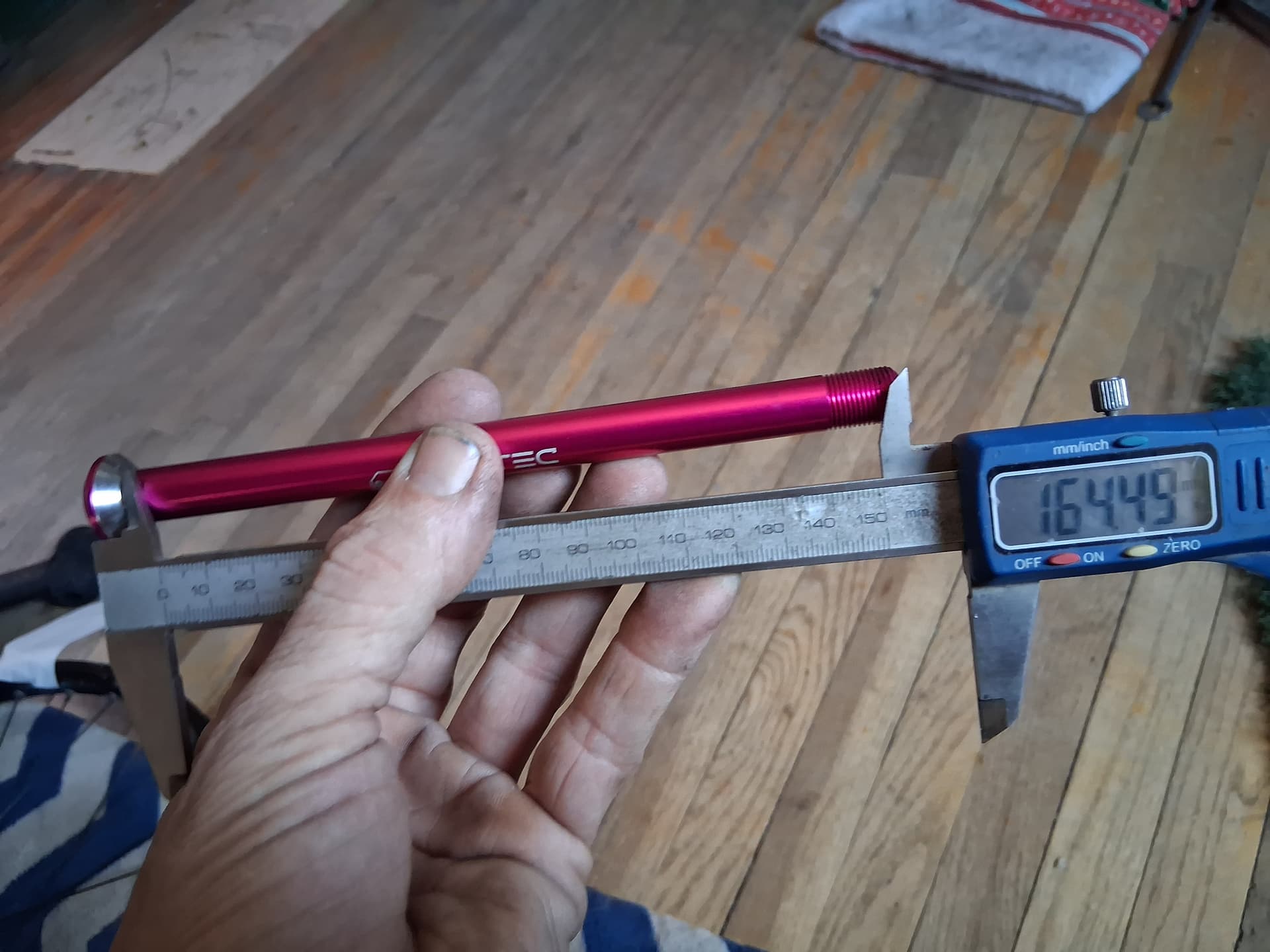

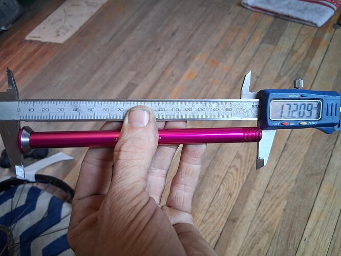

Interesting. I hope I’m not the only one who didn’t know this…apparently udh axle measurements are for the overall length, including the actual head of the “bolt” I didn’t know this, because usually hardware is measured from under the head to the tip (:rofl::joy:)
So this 173mm axle only has about 165mm of usable axle. That’s annoying.
There was enough meat on the nds dropout that i made it work. But, heads up, i guess?
Is this just how these are measured? Seems like it would introduce a lot of inconsistency across manufacturers? I’m, very obviously, not an engineer, but this seems…weird? Anyone else? Just me?
I think it’s just the countersunk type axles that measure things wrong. All the axles I have at work and all the aftermarket ones (old man mountain, Robert axle project) measure from under the head.
Thats super interesting. So they’re not even all measured one way? Thats hilarious, not a huge surprise because mountain bike stuff, but still hilarious. I’m actually little shocked they were able to agree on thread pitch and it doesn’t change based on length or color or something. How silly.

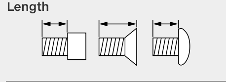

I don’t know if it’s that weird. Countersunk screws on McMaster Carr are measured the same way.
Also interesting. Looks like I’m uninformed, also not a huge surprise :grin:
