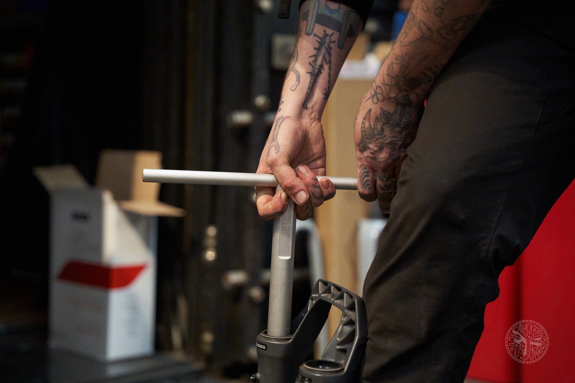

Fork burnishing. I learned something new today!
For those lurking:
This makes a lot of sense… For a $400 OEM fork, There is no way the bushings will be sized accurately and consistently.
Question about the “Ohlins style” threaded tool people are referring to: Do you turn the threaded rod and pull the burnishing tools through the bushing? Then somehow reverse the process to pull it back out?
I can’t claim to be the biggest tinkerer, so I haven’t tried many alternatives, but ever since I read this review on Vital I’ve been mixing some Maxima Assembly Lube into 30wt suspension suspension fluid until the viscosity seems about right (it’s pretty thick) and using that as bath oil. It works well in fork lowers and it has virtually eliminated stiction in every air shock I’ve used it in when I add it to the air can to lubricate the main seal. Not sure if it’s easy to get ahold of in Europe but in the US it is relatively inexpensive and widely available.
Yes. You use a drill to feed the insert down into the lowers and then reverse the drill to back it out. It is fixed at the base of the lowers. That Ohlins tool also has parts to install and remove bushings.

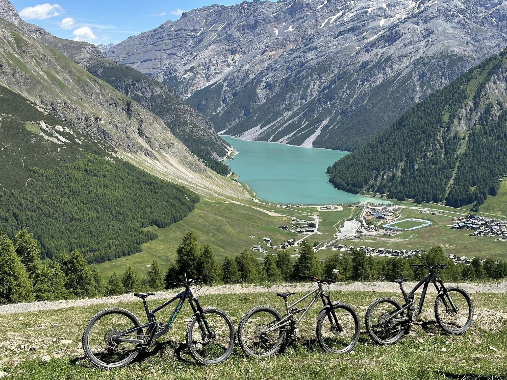

Back from trip to Livigno.
Bike was good, If I could change anything, then I would like a slightly longer reach.
Last year I was on Size L Megatower. Fork was better, But otherwise I can only praise my creation.

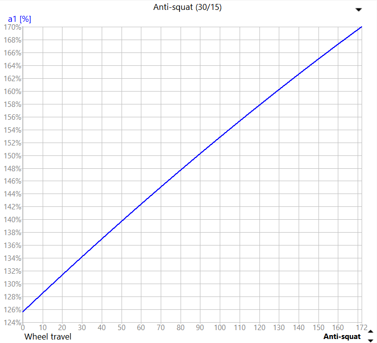

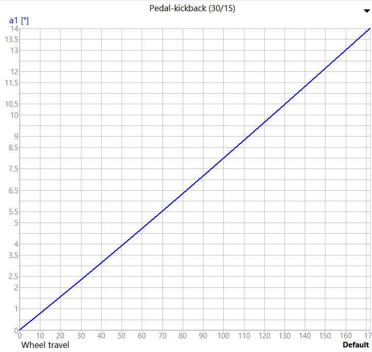

I built my bike with quite high anti squat and pedal kickback. I was afraid I can feel my pedals moving, kicking and rear end harshening. Especially because my anti squat is raising with travel(most bikes are opposite).
But I can’t feel anything thru my pedals.
It does pedal well and I can even sprint. All the other fs bikes have squatted like crazy.
Only place I feel stiffening of the rear end is pedaling over big roots, but I don’t really do it, when going down. And it is not really a huge difference.
I got 54 points of engagement and I ride with clips.
Gearing I’m using mostly going down.
What do you guys think? Am I just not feeling it or is this pedal kicking, suspension stiffening mostly overblown feeling? I just cant get over thinking how does my most simple single pivot rear feel better or as good as Megatower.

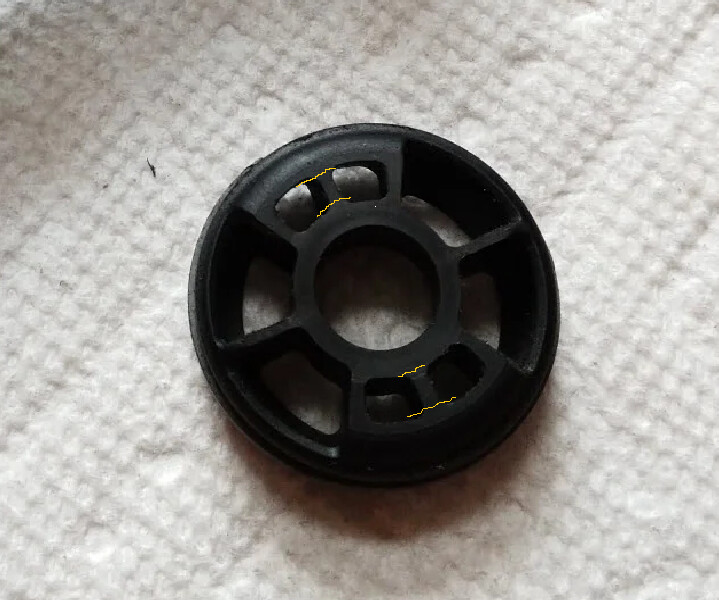

At that point my tuned shock was working better than my fork and I decided to make rebound holes bigger - just cut the walls marked with yellow.

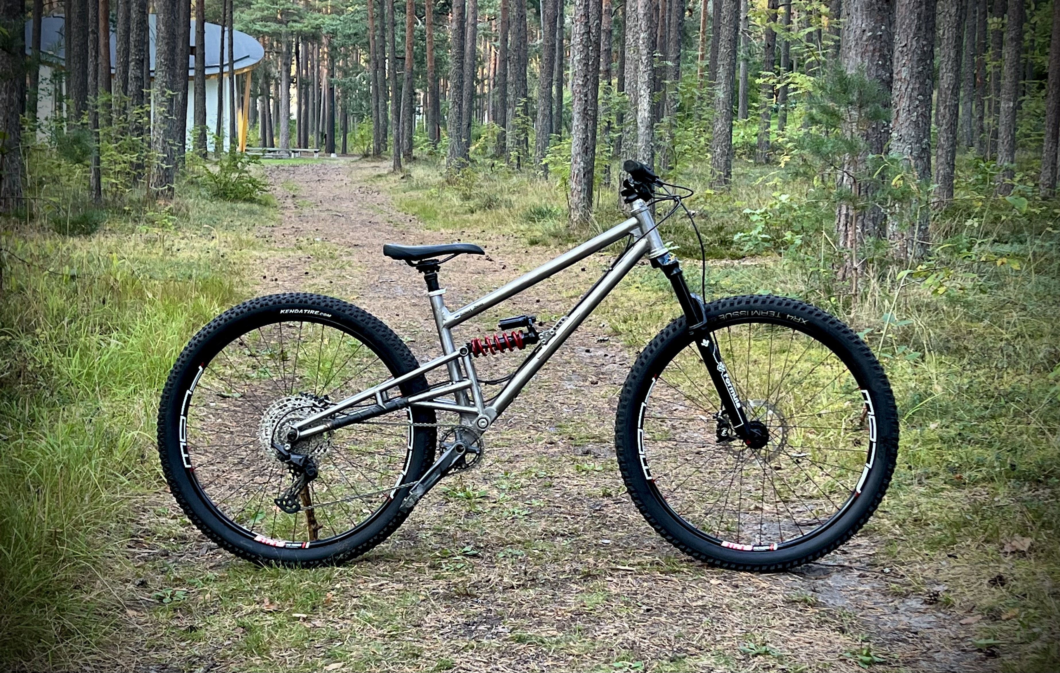

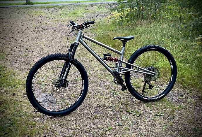

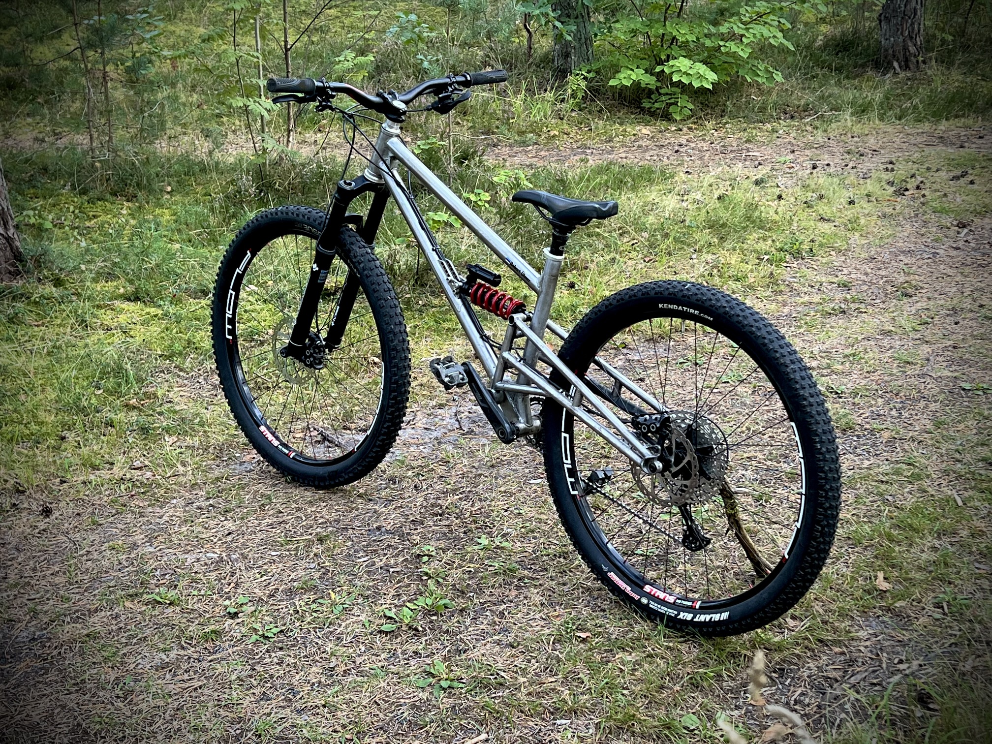

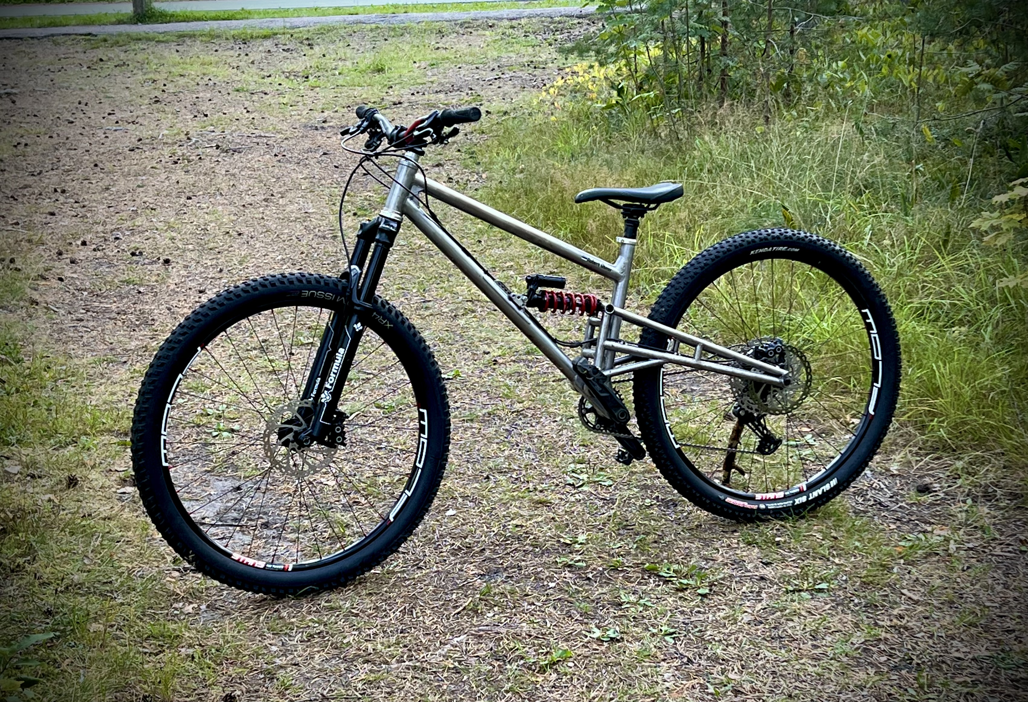

Mellower trails need shorter travel. So I bought Formula 35 and SDU coil. No idea how it rides yet, but it does look cool.
29 wheels
140/140 travel
HA - 66
BB - 340
SA - 79
Reach - 473

Did my test ride. Rides nicely. Climbs better, sprints better.
A little too much weight on hands for my liking, but maybe I’ll get used to it. I like high stack.
79 sta when pedalling on tarmac, makes the body move a little up and down. Strange feeling, but did not bother me too much.
340 mm BB felt good. I was afraid it is too high.
Coil works nicely, I did feel a little bottom out on one jump to flat, I’ll try to find a little longer bumper, and I think together with a re-valve it is going to be great. Ohlins or Fox have nice bumpers, but I can’t find any for sale.
Formula 35 feels good.
Great success.
