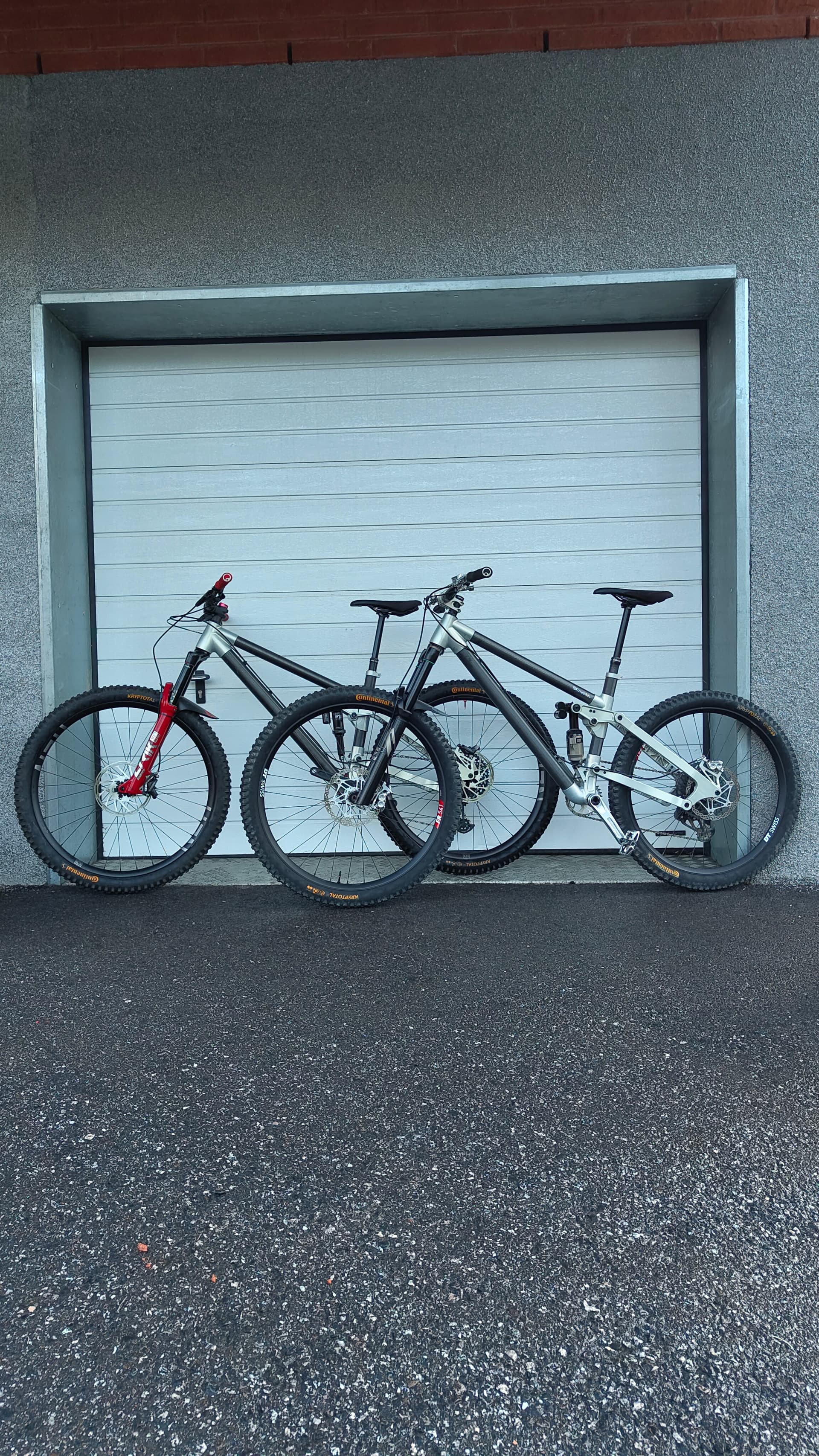

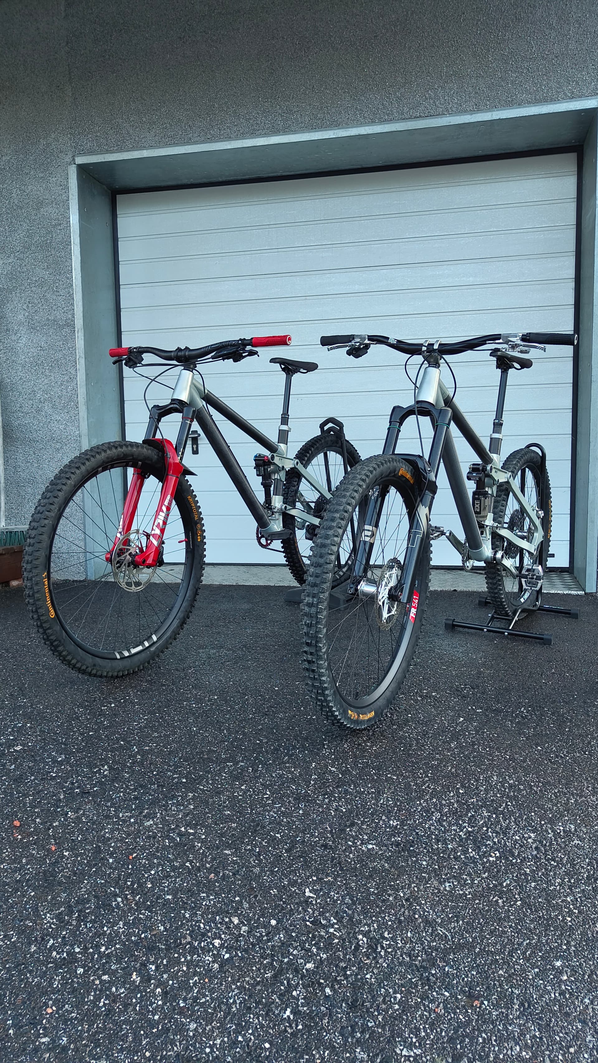

Finally built the 5th frame so the spare parts doesn’t just lay around the garage. This is kind of a special build as I made it for my father to use :slightly_smiling_face:
So far all of the frames have been running smoothly without any problems! Looking forward to starting the second bike park season for my frame.
This build is running a 160/140mm travel and full 29er. Here’s a few comparison photos compared to my own build.
