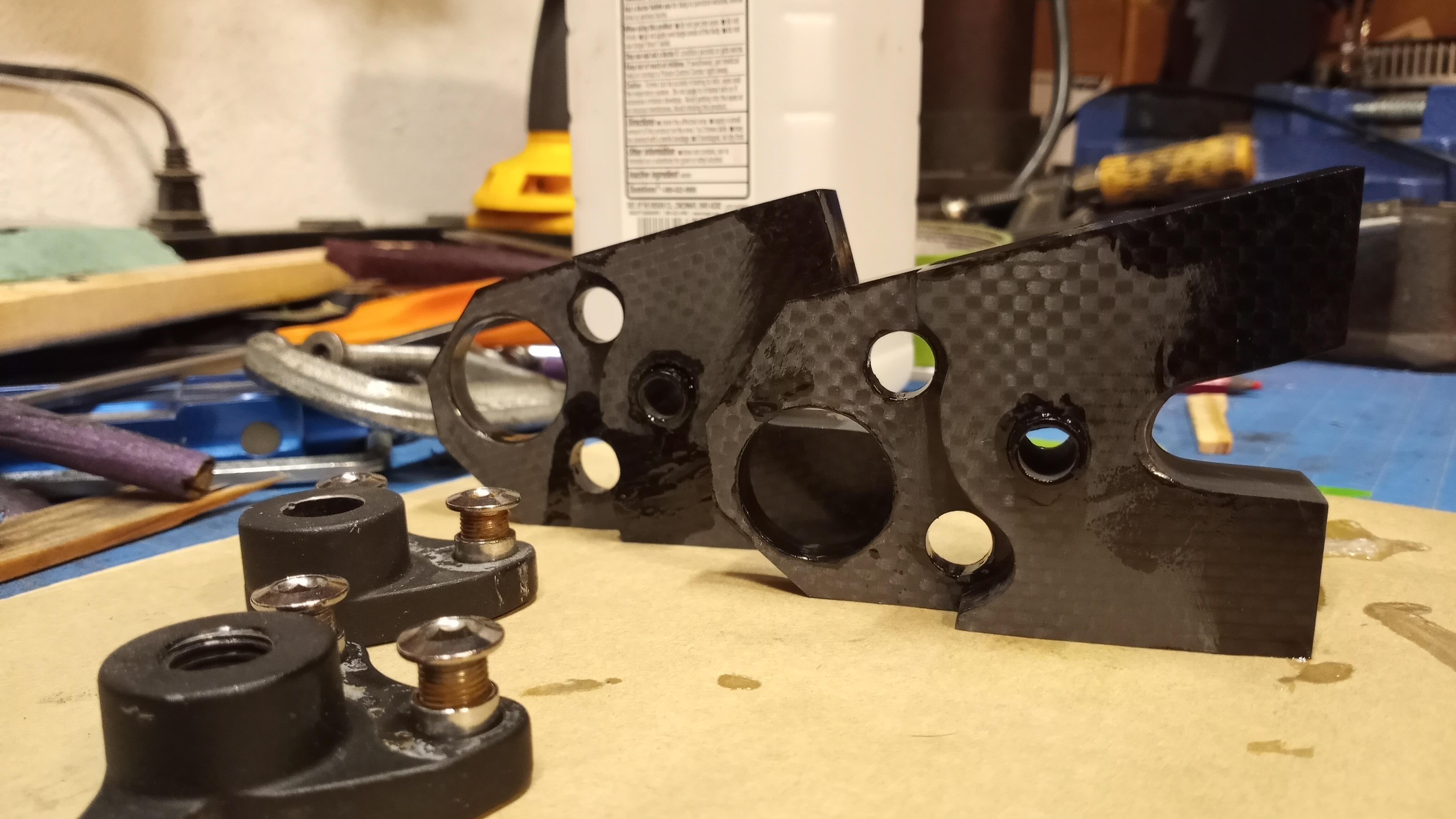

Still got a little sanding to do but these are starting to look like something.

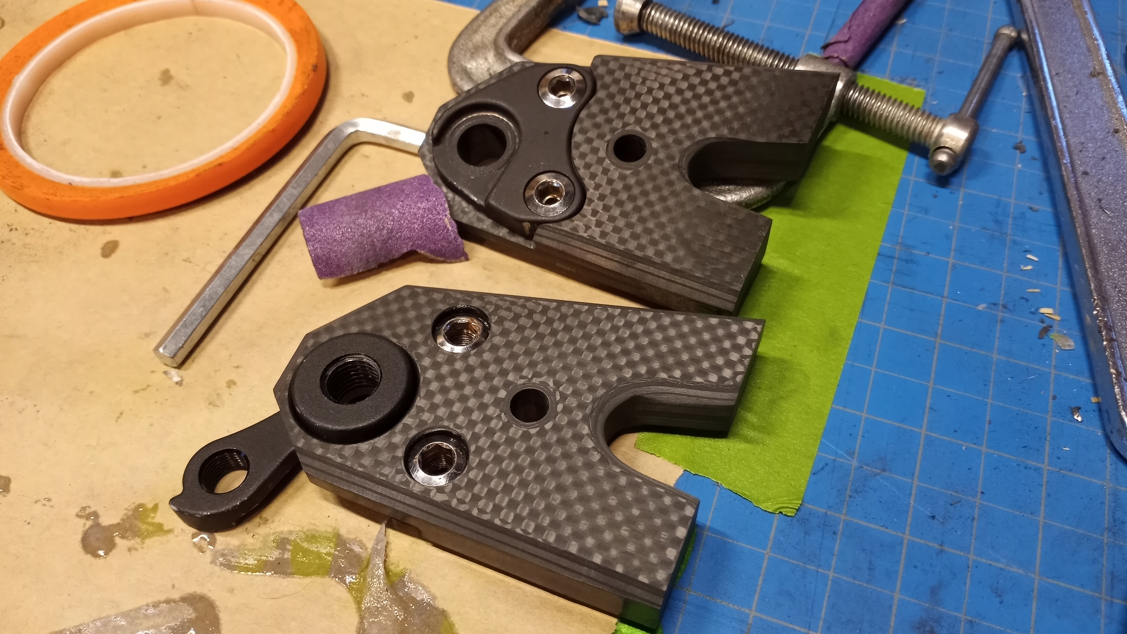

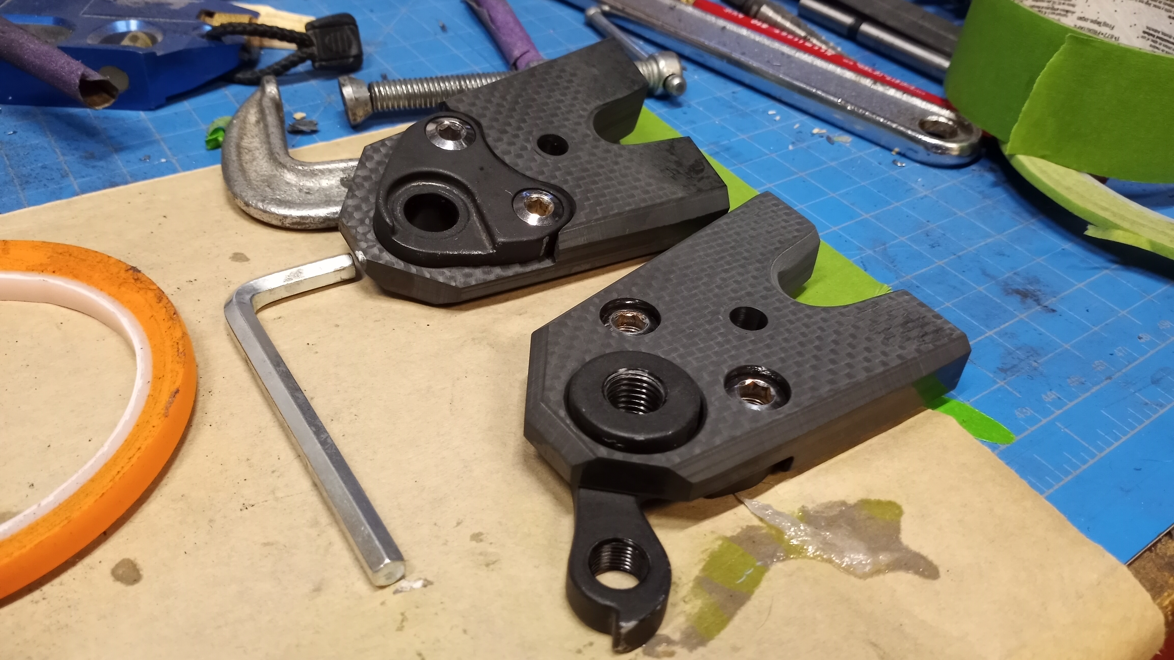

Those carbon plates were jumbo jet rejects (allegedly) each is 28 layers thick for a grand total of 56 layers of carbon fiber goodness in each side. I wanted to use a replaceable insert and had these and the axle for them already, winner. The thick plates were epoxied together and then cross “pinned” with some 10mm carbon fiber tube. I’m gonna use that same tube with some m6 1.0 coupler nuts to make the brake mount. All the drilling was done with woodworking forsner bits and too much spindle speed, worked pretty good actually.

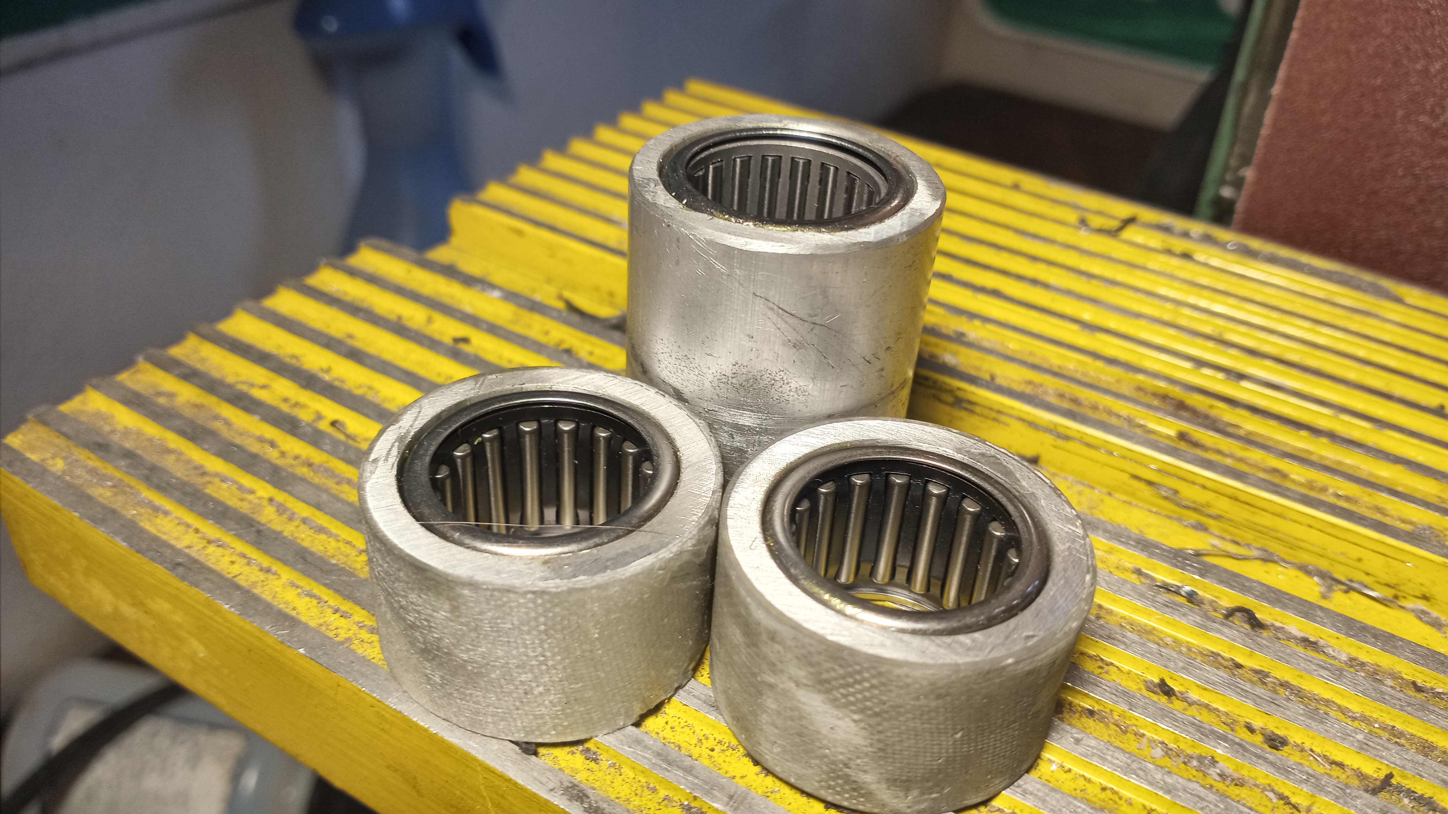

I finally talked myself into reaming these aluminum sleeves. Reaming 6061 by hand with an adjustable reamer was…emotional, but I got it done. Needle bearings all press in and still spin, so that’s an improvement from last time.

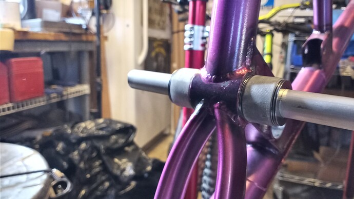

The double stacked one is an adapter, sorta. The main pivot was all set to use wheelbarrow bearings (haha) with an 1 3/8" od, all the needle bearings are 1" od. So I welded a piece of seat tube (35mm .065") into the original pivot (38mm .065") sleeve, bringing that id down to 31.6mm (1.25") The aluminum tubing has a 1.25" od and a .125" wall, some light reaming action and bingo was his name-o.
It’s got thrust washers everywhere anything touches so I can snug it up and it’ll all still spin. :metal:

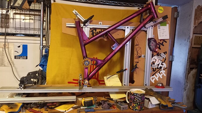

I had an idea about getting the frame repainted real quick, I was gonna get it done with fancy aircraft paint and get a picture of it in a huge paint booth next to the private jet that it was sharing pigment with. That didn’t work out, so you’ll just have to settle for the plane by itself.

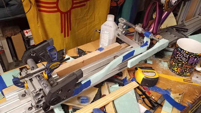

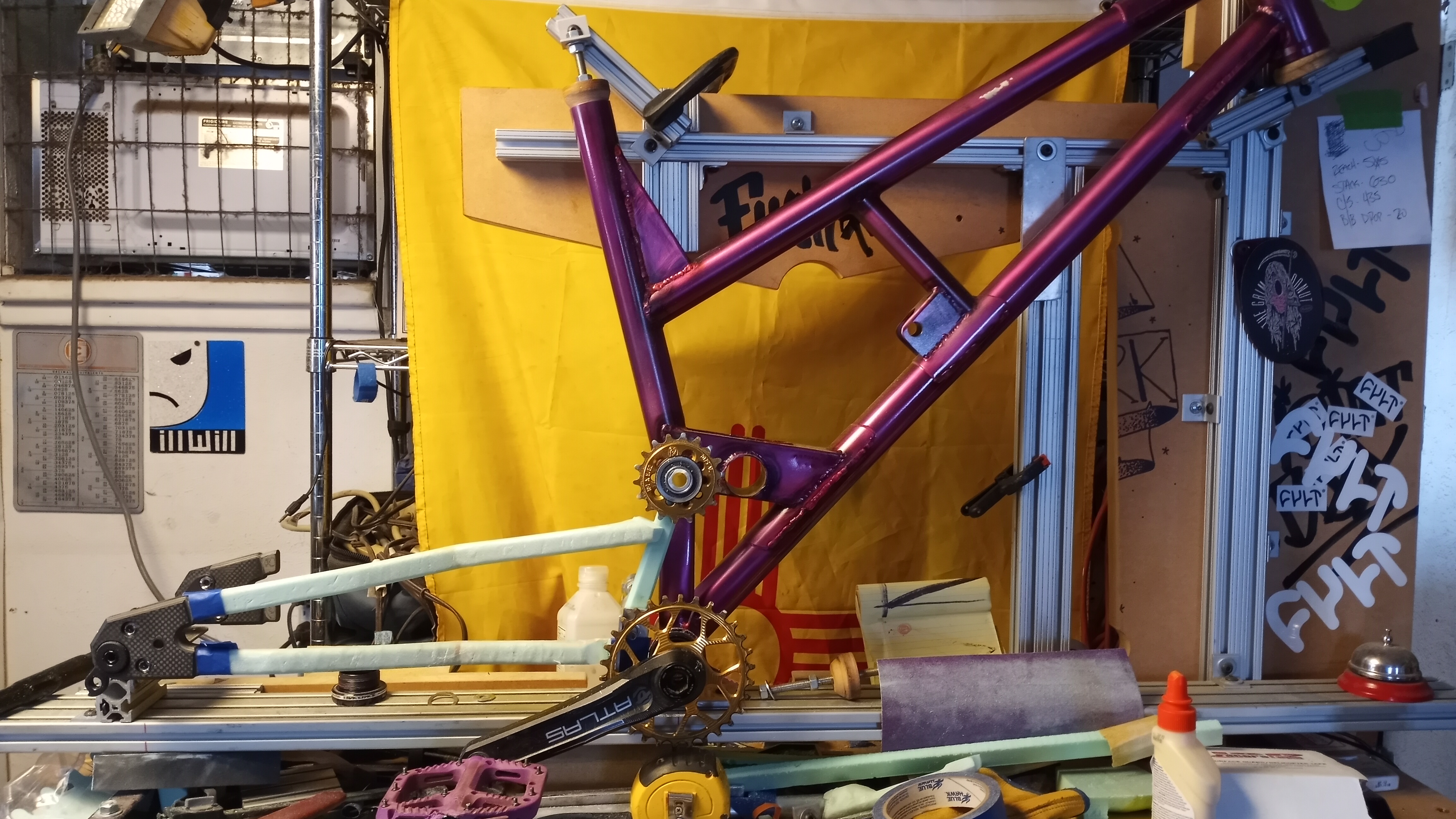

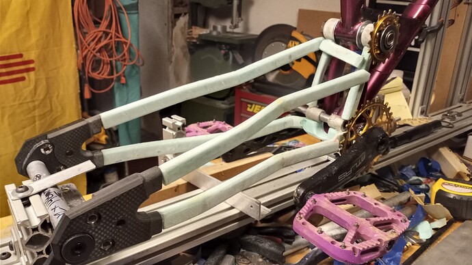

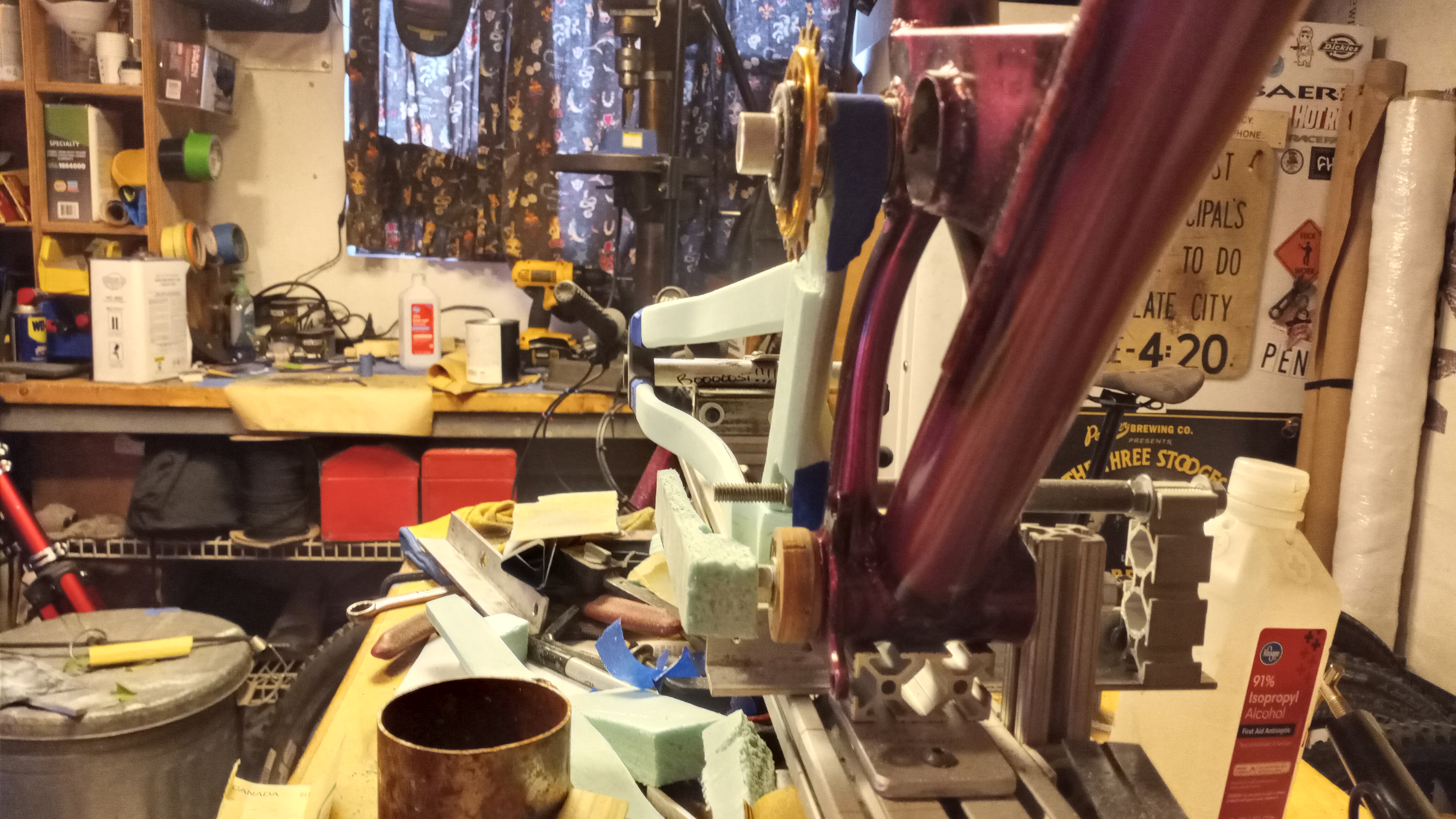

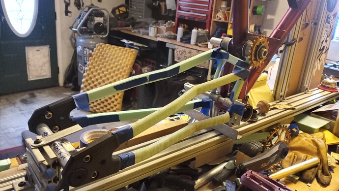

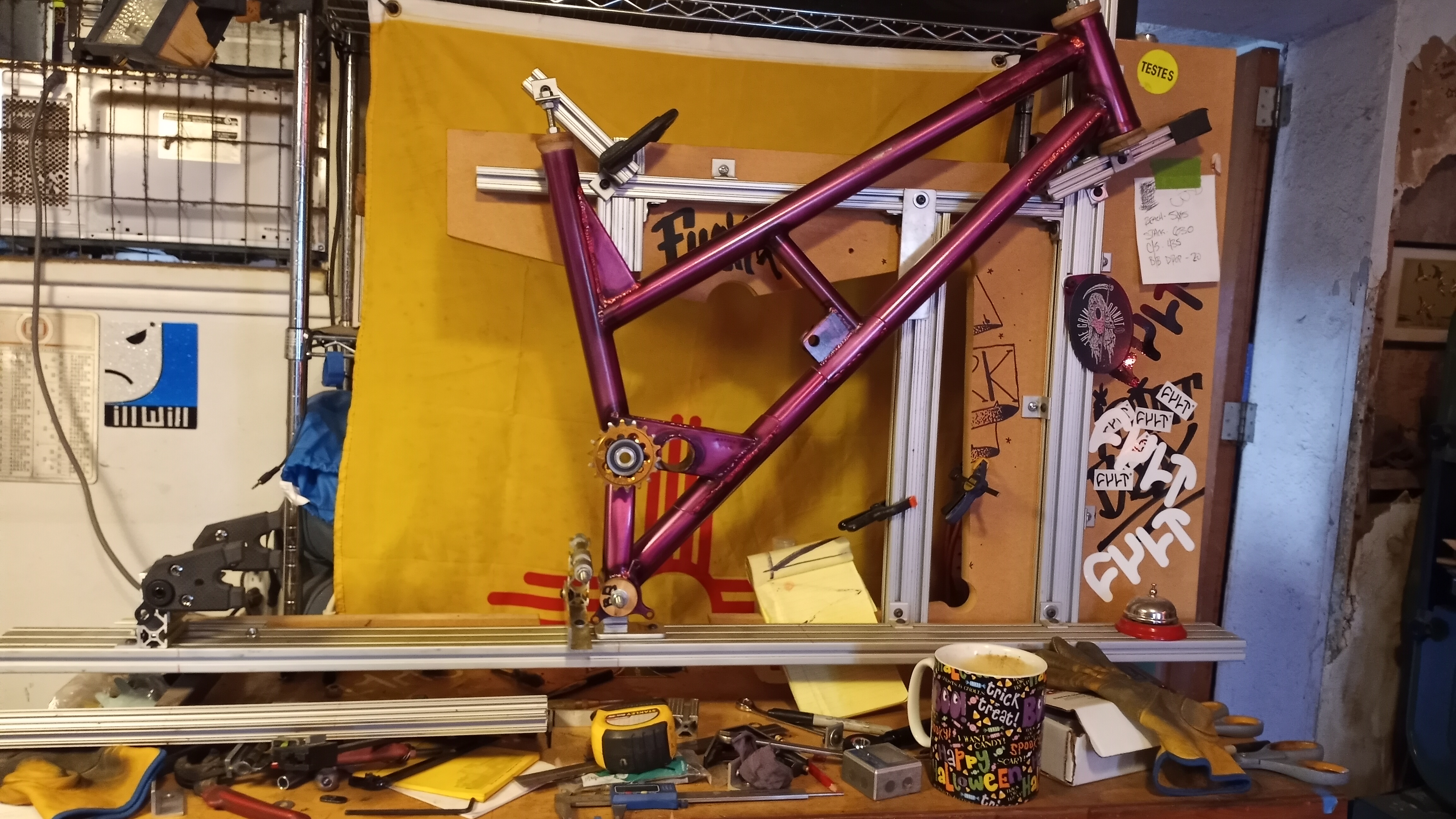

Took longer than it probably should have to get that all set back up in there, but I think I’m ready to start carving some foam.

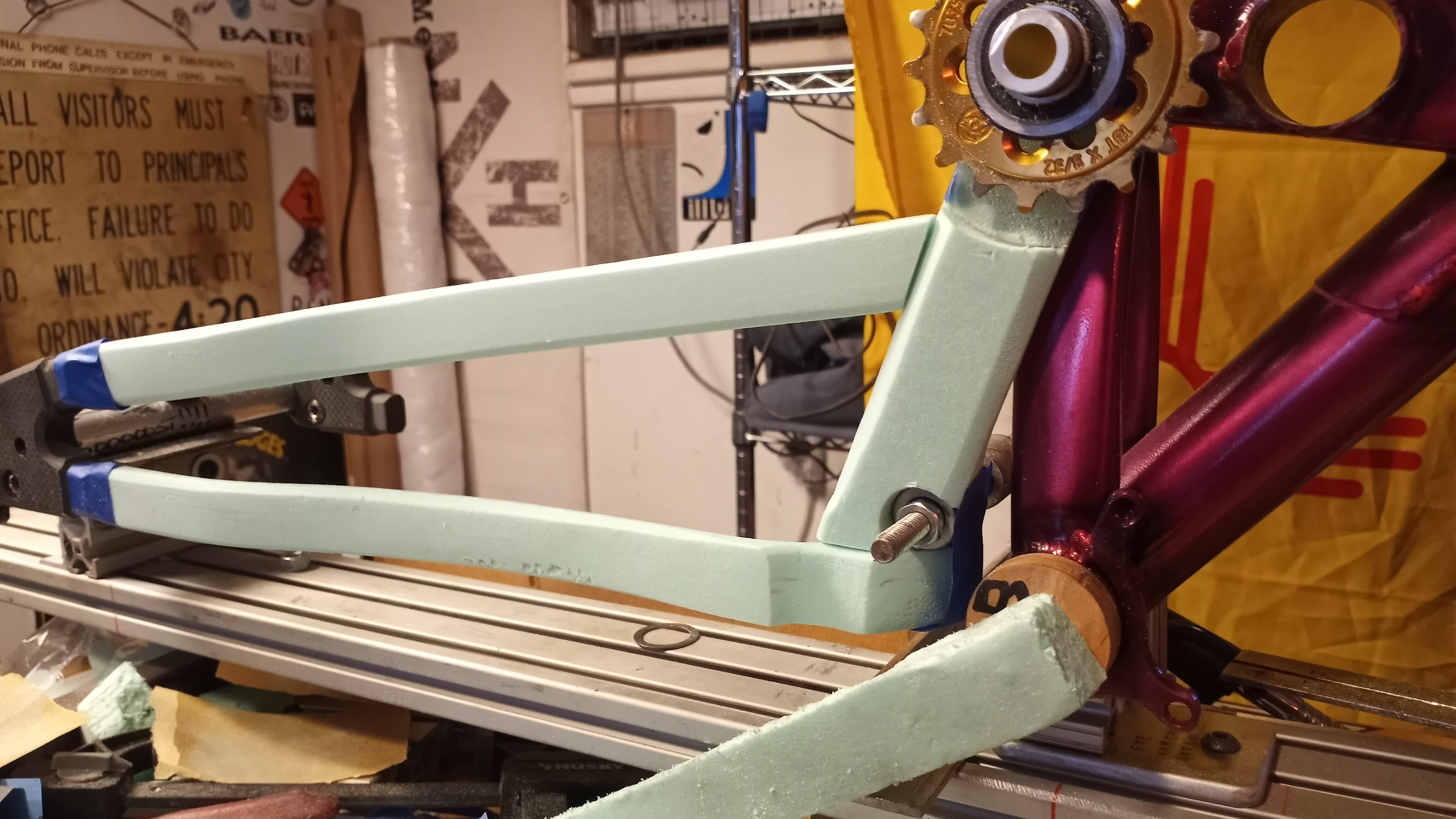

I’m already liking how low slung the rear looks. I think I’m gonna drop the seat stays for chain clearance so it’ll actually look even lower. Groovy.

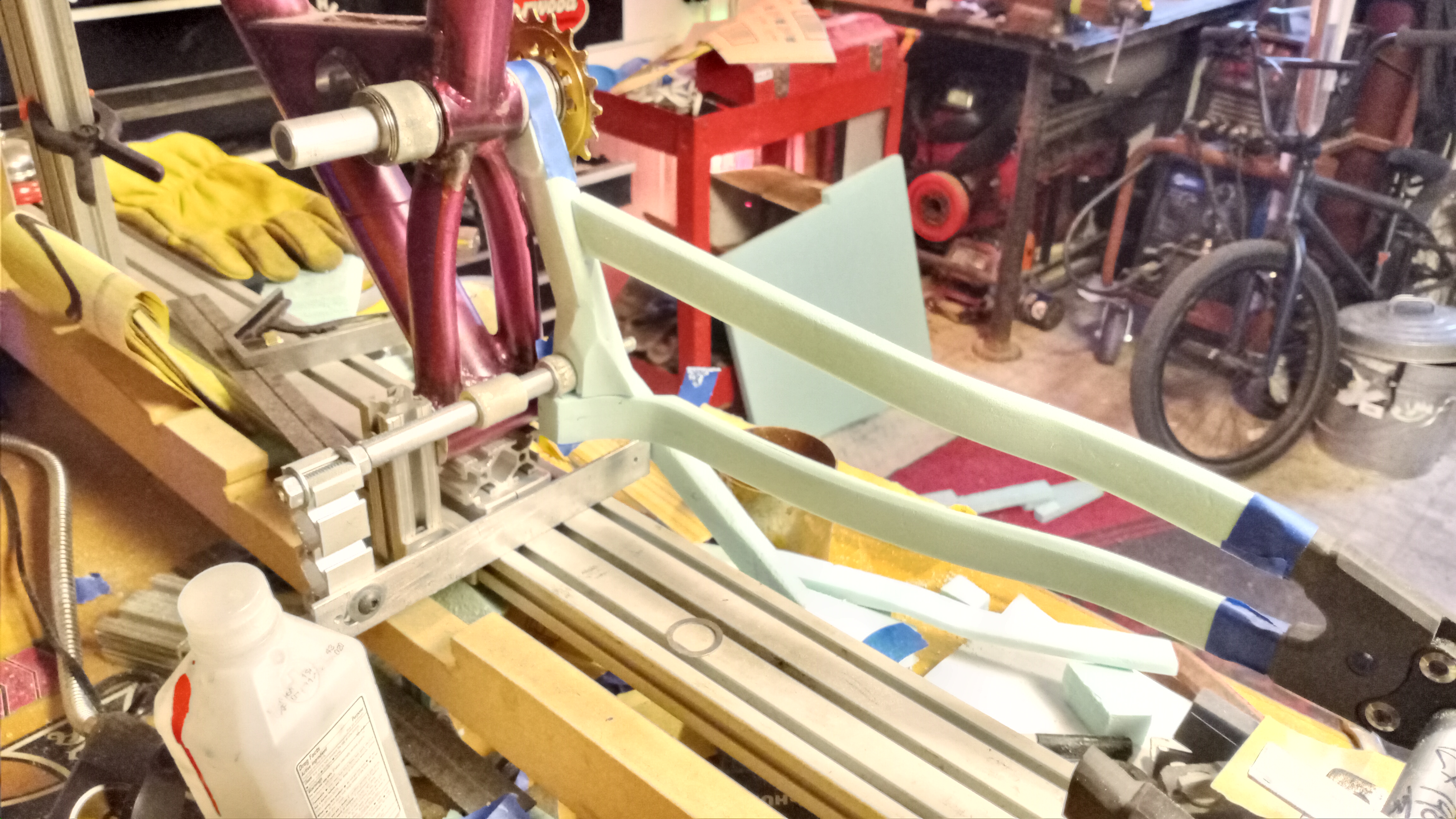

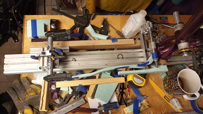

I seem to gravitate back toward a kinda swoopy, s-bendy guy, less organic looking that the 1st try but still kinda swoopy. It looks pretty thin in that one plane (about 10mm) but I plan to go heavy with the glass and the UD tape there and get my strength back. That’s the cool shit about composites, right? I might retrace them as one piece and make the whole thing a little fatter. Who can say what the future holds?
Progress. Kinda.
Stays for days
I’m probably going to trim some height off them, I’d like the finished height to be about where the foam is now. Width should be good with 3 or more mm of carbon on it.

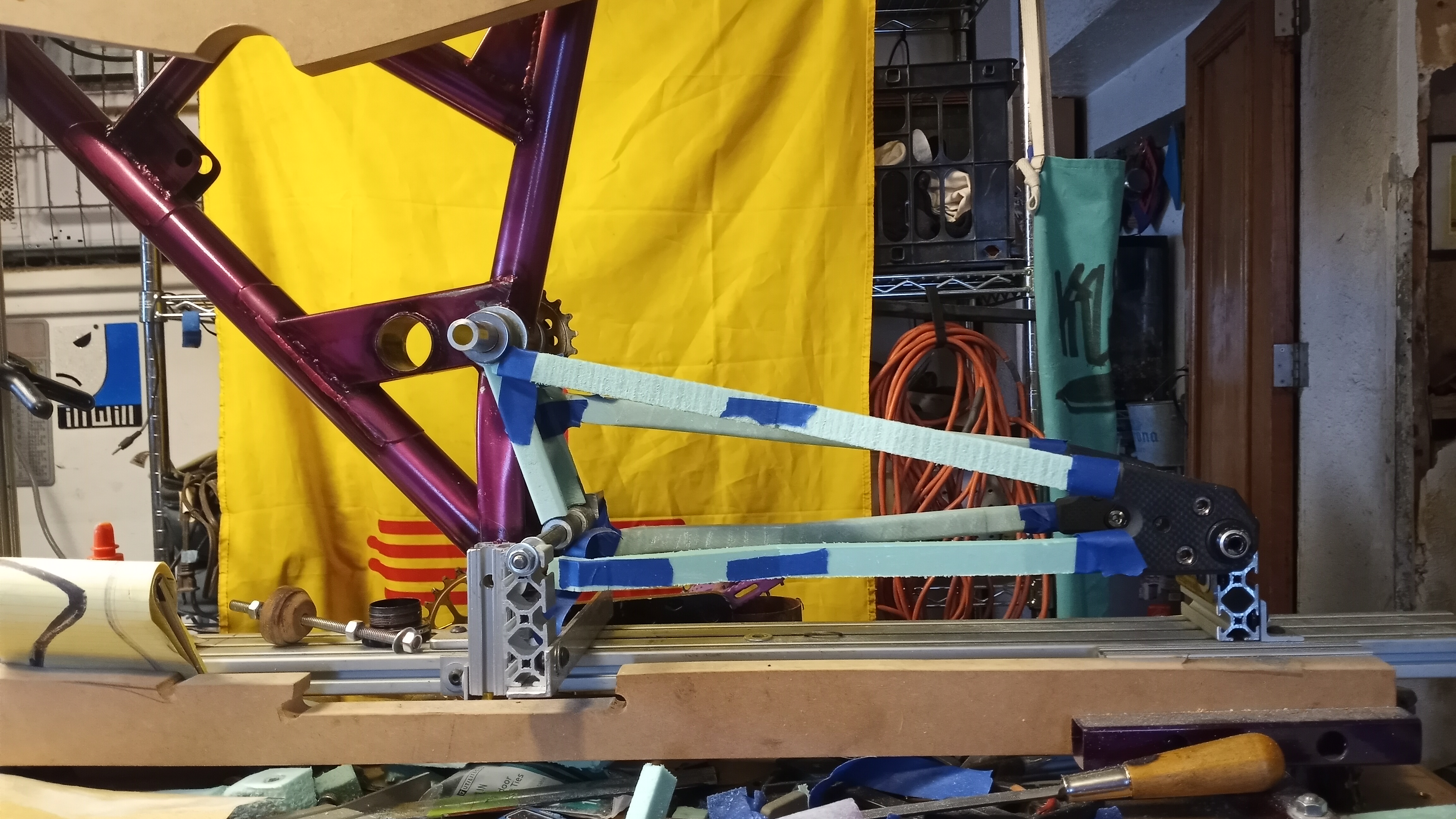

Serious question, should I make the non-drive seat stay dropped to match the drive side or make the whole deal asymmetrical and put the nds stay right into the center of the pivot bearing?
Gimme your thoughts :point_down:
I would make the CS’s asymmetric. That way no one tell if your rear end is straight or not!

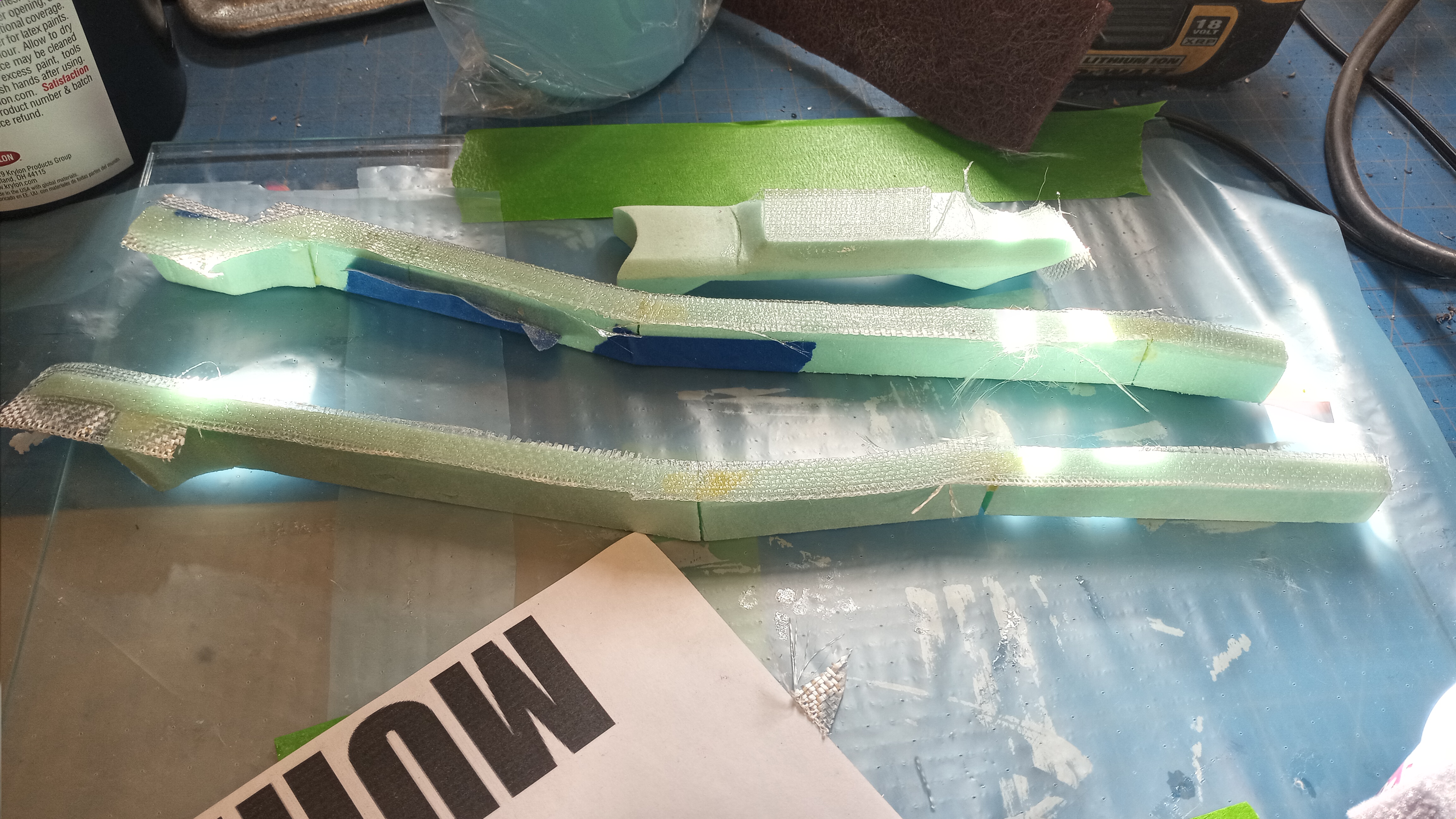

I’m going to do my first layer or 2 in fiberglass, enough that I can sand it smooth before I do any carbon laminating . I think that will be enough to hold the shape in a vacuum bag. We’ll find out.
That is, of course, after I make these again (time number 4) because I’m dumb and they won’t work this way. 4th time’s the charm? Doubtful, for me, 6 times will probably be the charm. Good thing styrofoam is cheap and my time is pretty much worthless :stuck_out_tongue_winking_eye:
I’ve done things like that in the past where i laminated a thin layer at first just to get it stiff enough, then overwrapped it and got the bulk of the laminate done in vacuum infusion. I don’t see a problem with this. I’d probably already add a tube or a carbon wrapped silicone cord for the cable routing now tho.

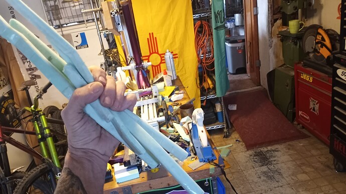

And we’re making parts! I finally settled on a design enough to start building. The swoopy guys just weren’t doing it so I cut some 1/2 x 3/4 strips on the bandsaw and built these blockier bois. I think they’re gonna look better against the straight steel tubes and they match the dropout plates a lot better. They’re just sitting on a piece of plate glass to keep them straight-ish while the 8oz glass tape hardens up.
Cross all your fingers and stuff.
My entry for ADHD inspired workbench contest, and a little progress. I replaced the big and chunky connector piece from the last post with a piece of the same .5x.75 that I made the stays out of, I think that’s gonna work better. Should have good tire clearance, looks like it’ll clear the chainring

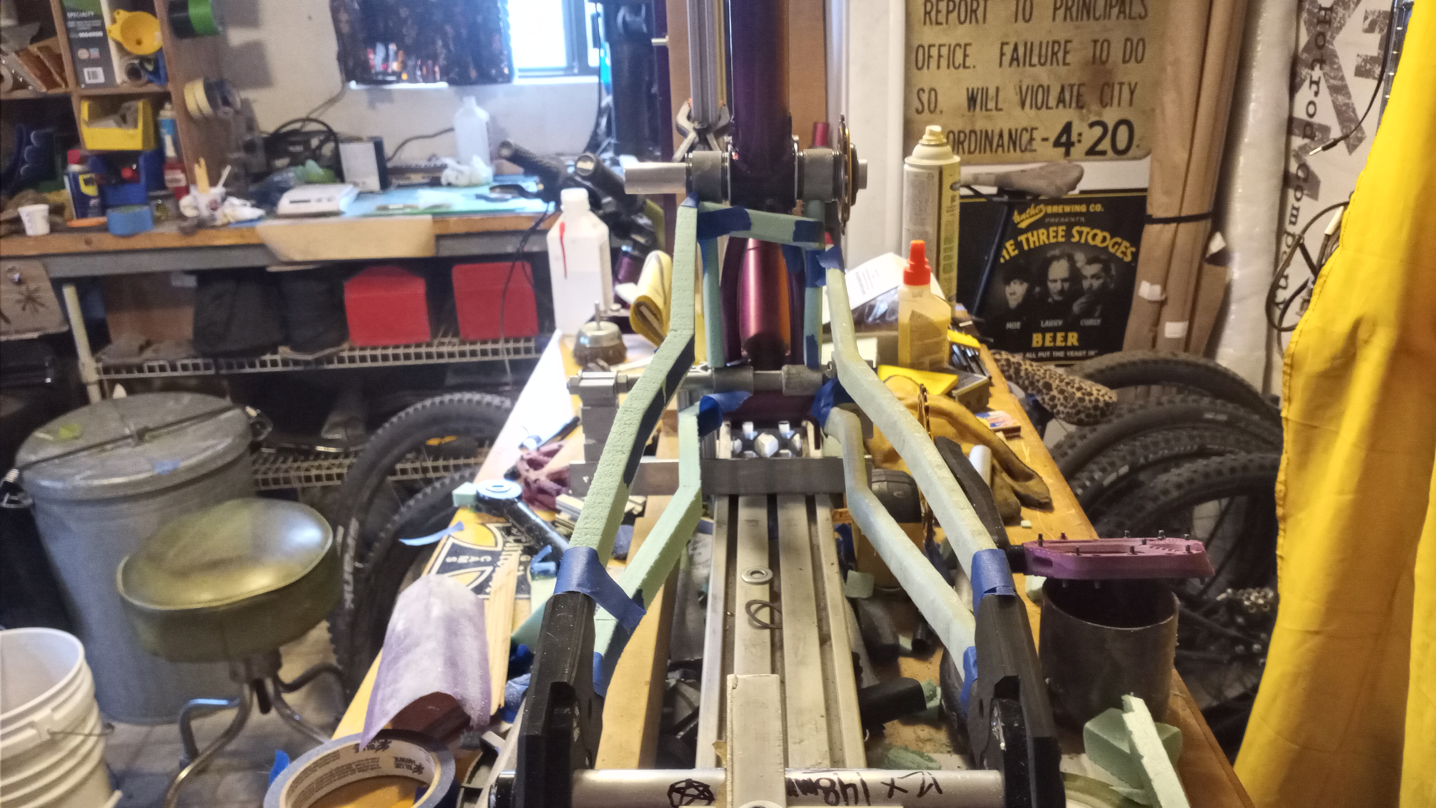

Asymmetrical stays won out. I will admit, it’s been kinda fun to be able to make a few different versions, try stuff out, move it around, OpTiMiZe ThE sPaCe.
Smarter people would use a computer for that. Not me!

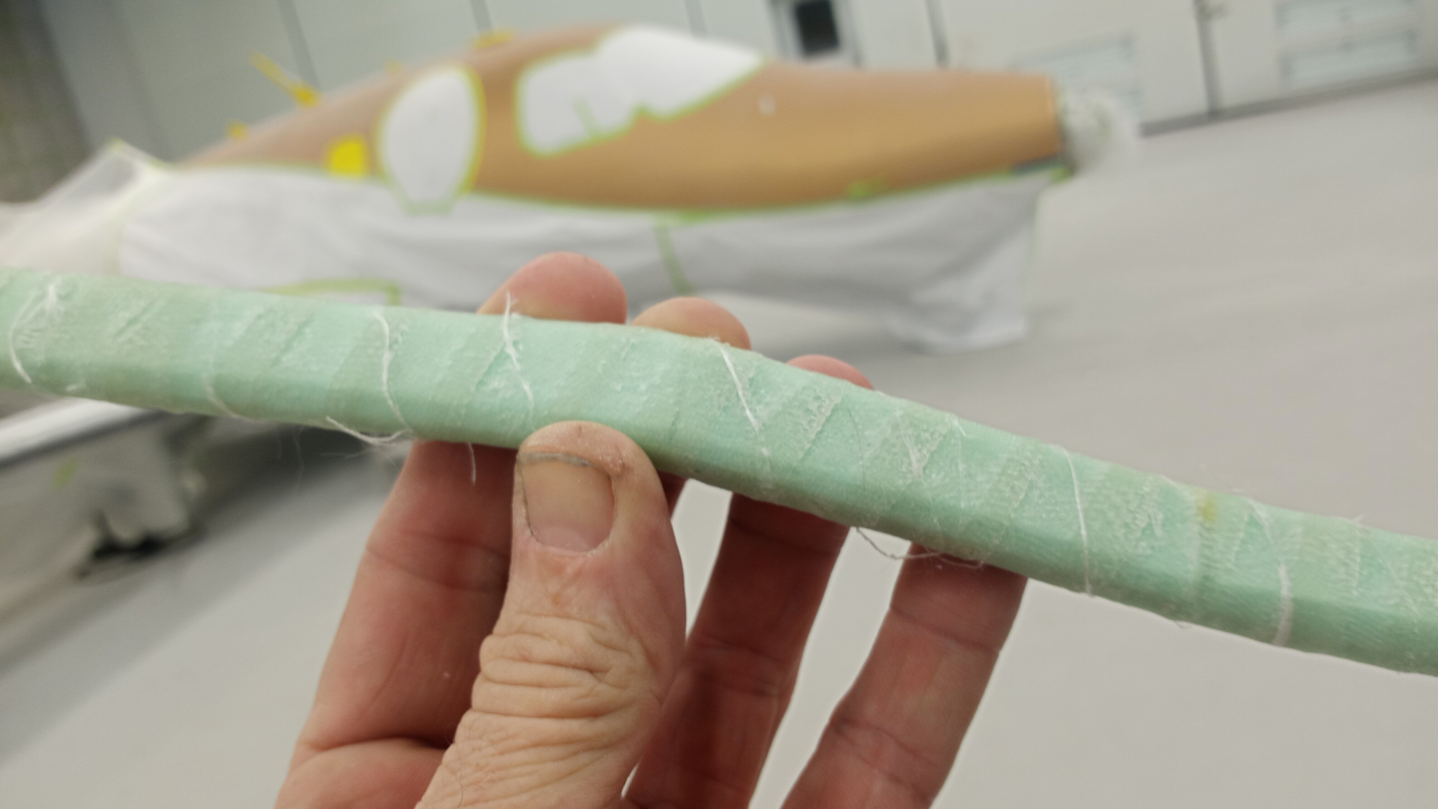

Most of these parts have their first layer of glass on 'em. I’m hoping to have the initial glass layer on the rest of them by the end of the weekend.
I’m still feeling positive despite what your eyes are telling you. I think.

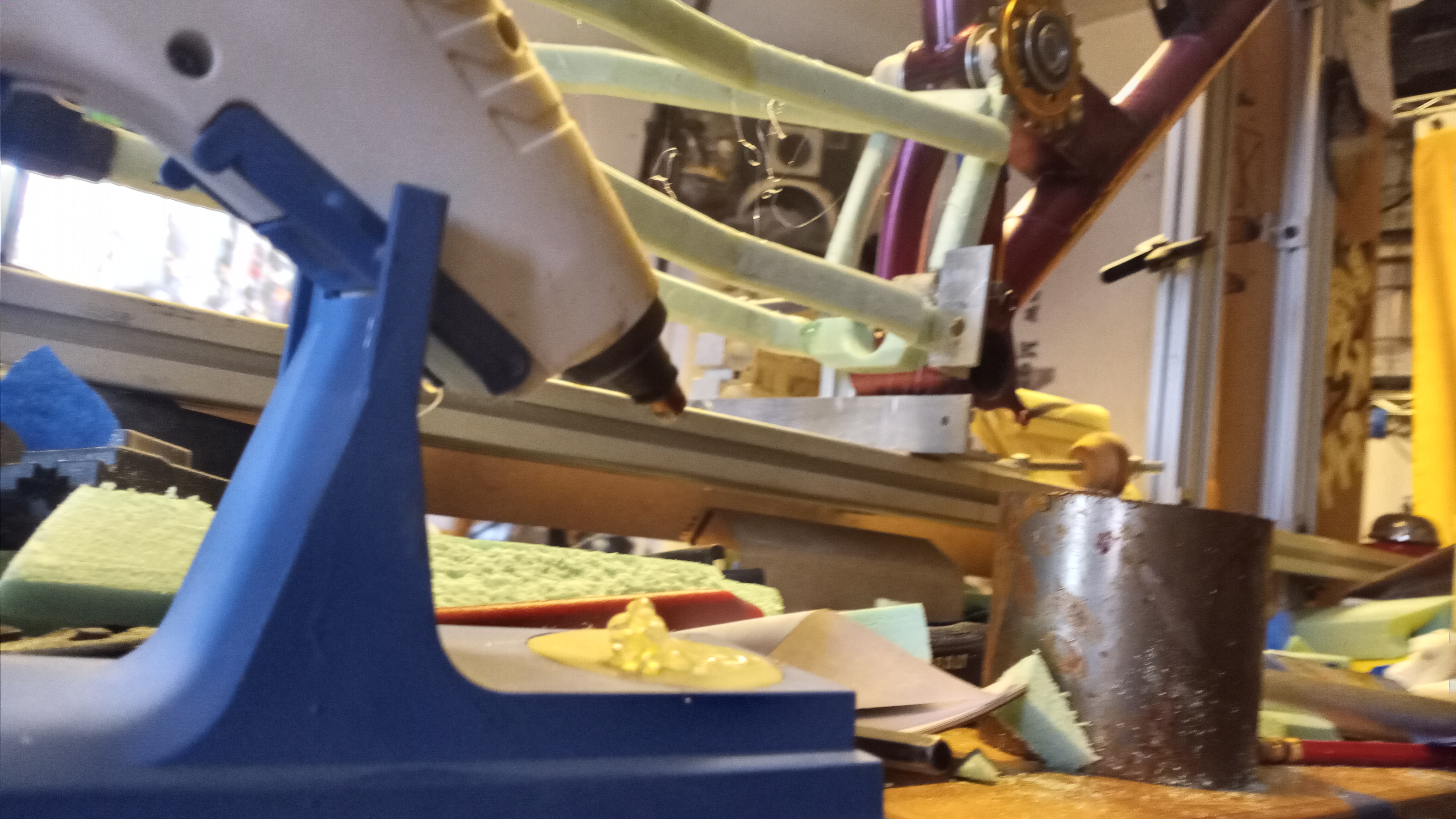

Man, if I’d had any smidge of integrity as a “framebuilder”, it went out the window when the glue gun came out. Good thing I didn’t have even a smidge. Can’t lose integrity if you never have any to begin with.
Got all the bits covered in itchy shit and sanded
I really did just hot glue everything in place. I thought I had more pictures, turns out I was wrong.
You can kinda get a look here, the important thing is the hot glue gun, it’s cordless.

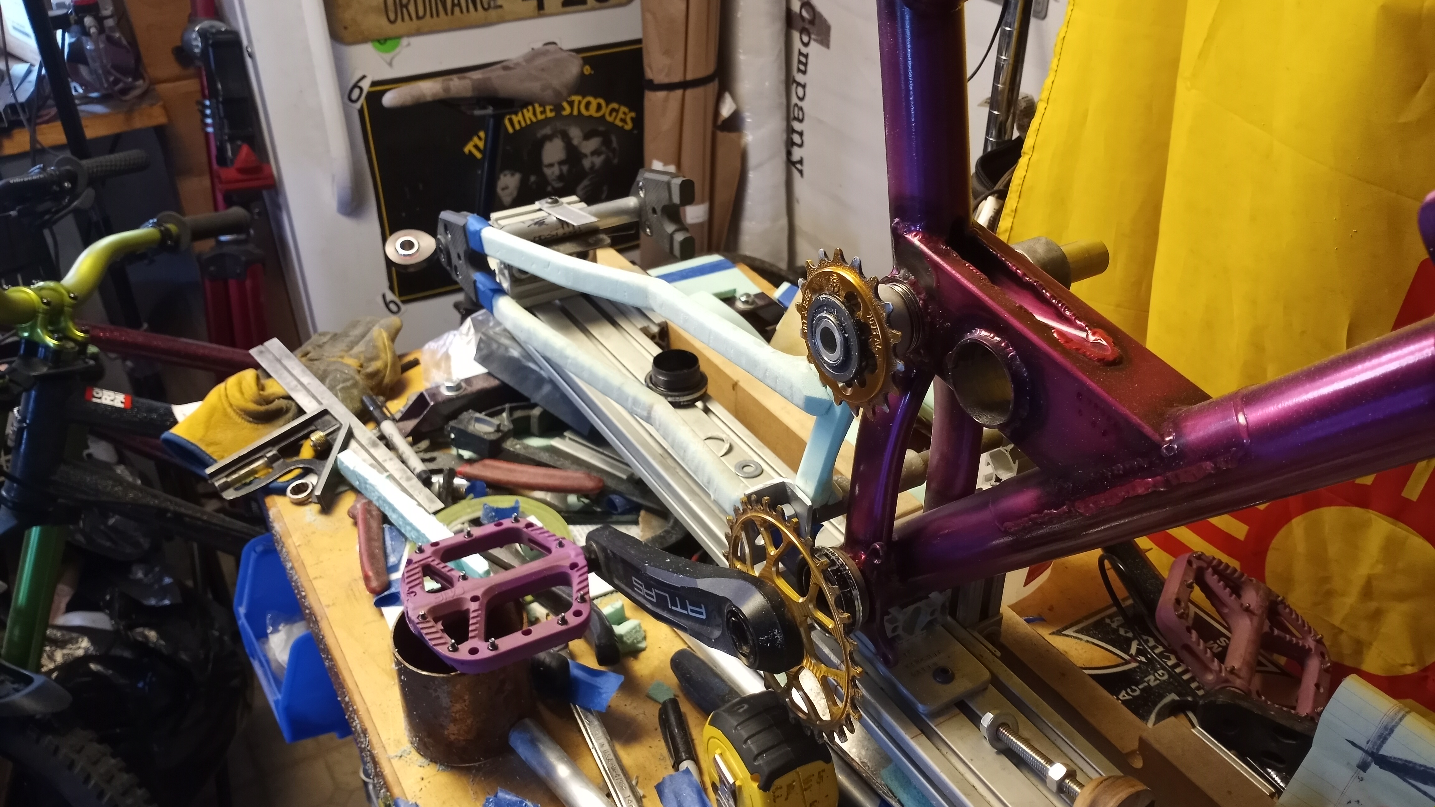

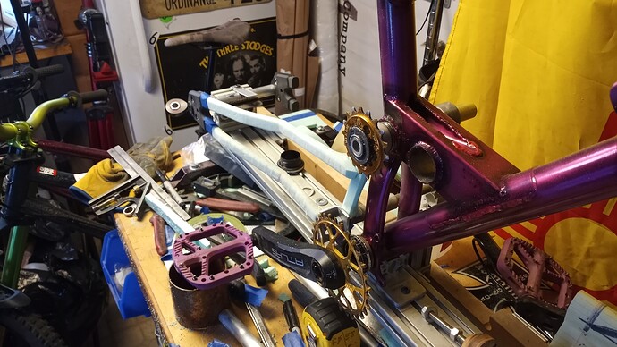

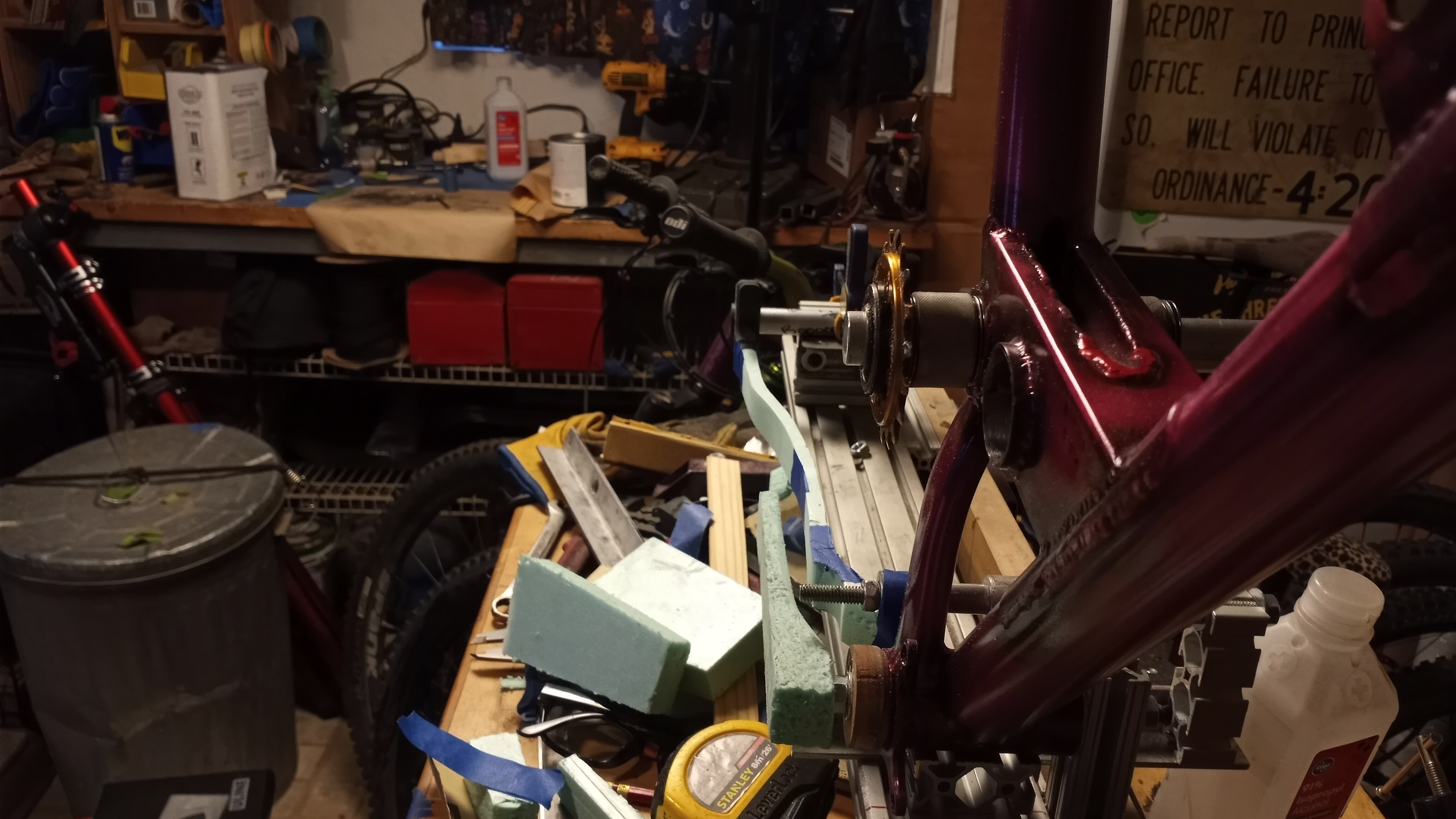

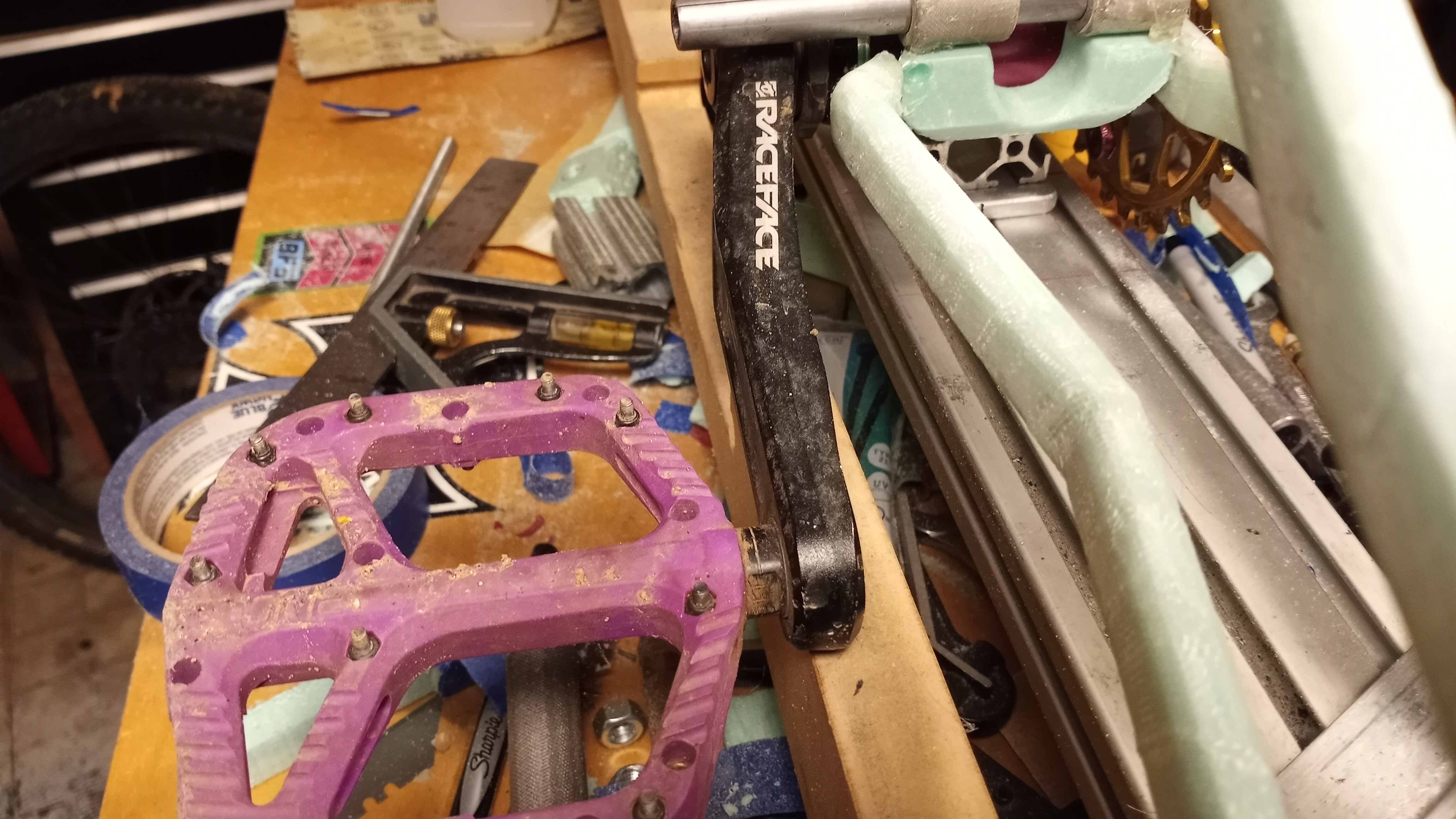

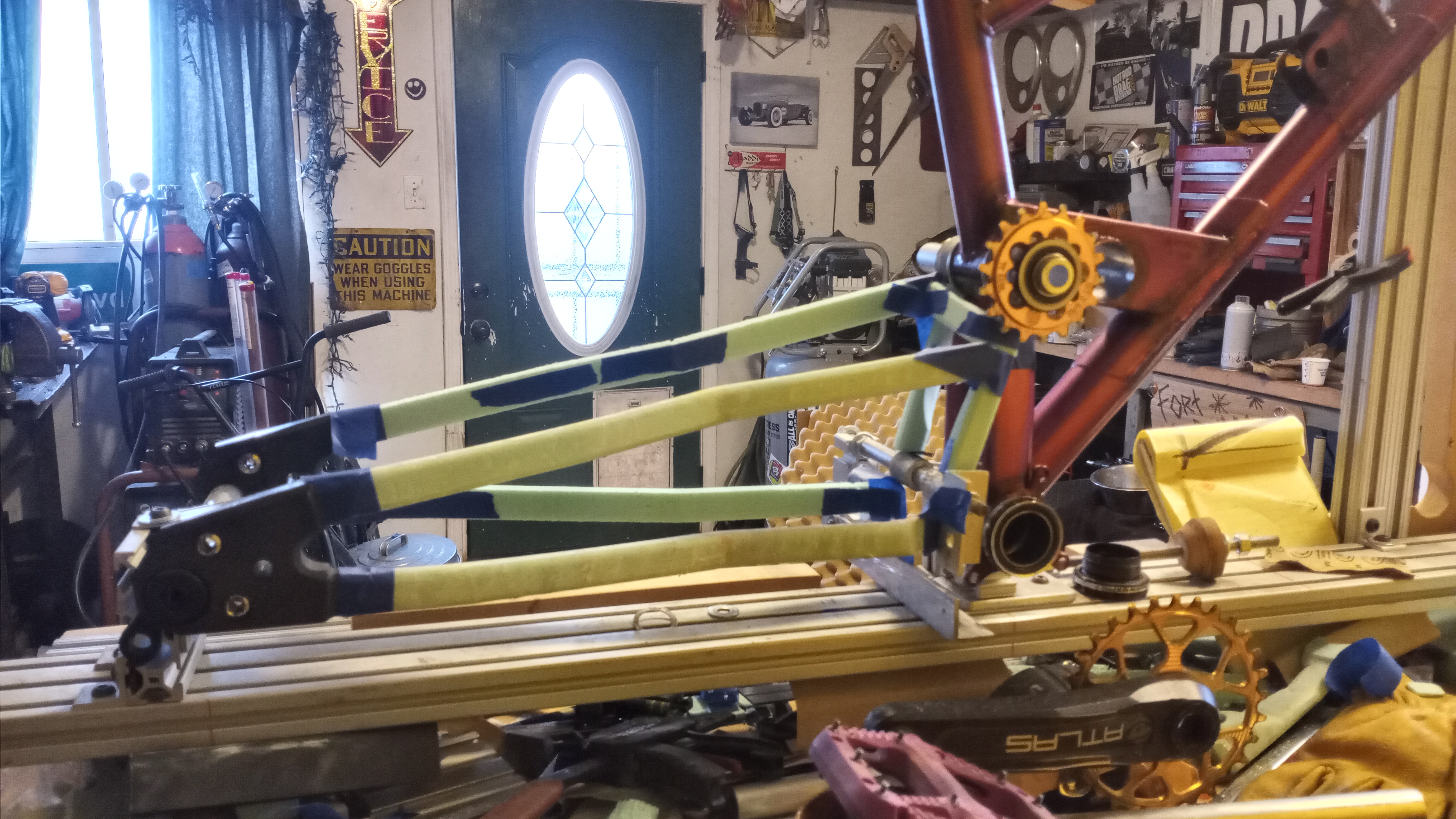

I decided I should probably test fit the actual cranks in the foolish thing and see if they fit (Crankset Assisted Design)
That last one isn’t the best bit of photography I’ve ever done but it gives you an idea, kinda.
You can see holes melted in the foam from the hot glue and the gaps you could push a shopping cart through.
Good thing the gaps don’t matter! In more positive news, there’s clearance everywhere, clearance for days, it would seem.
