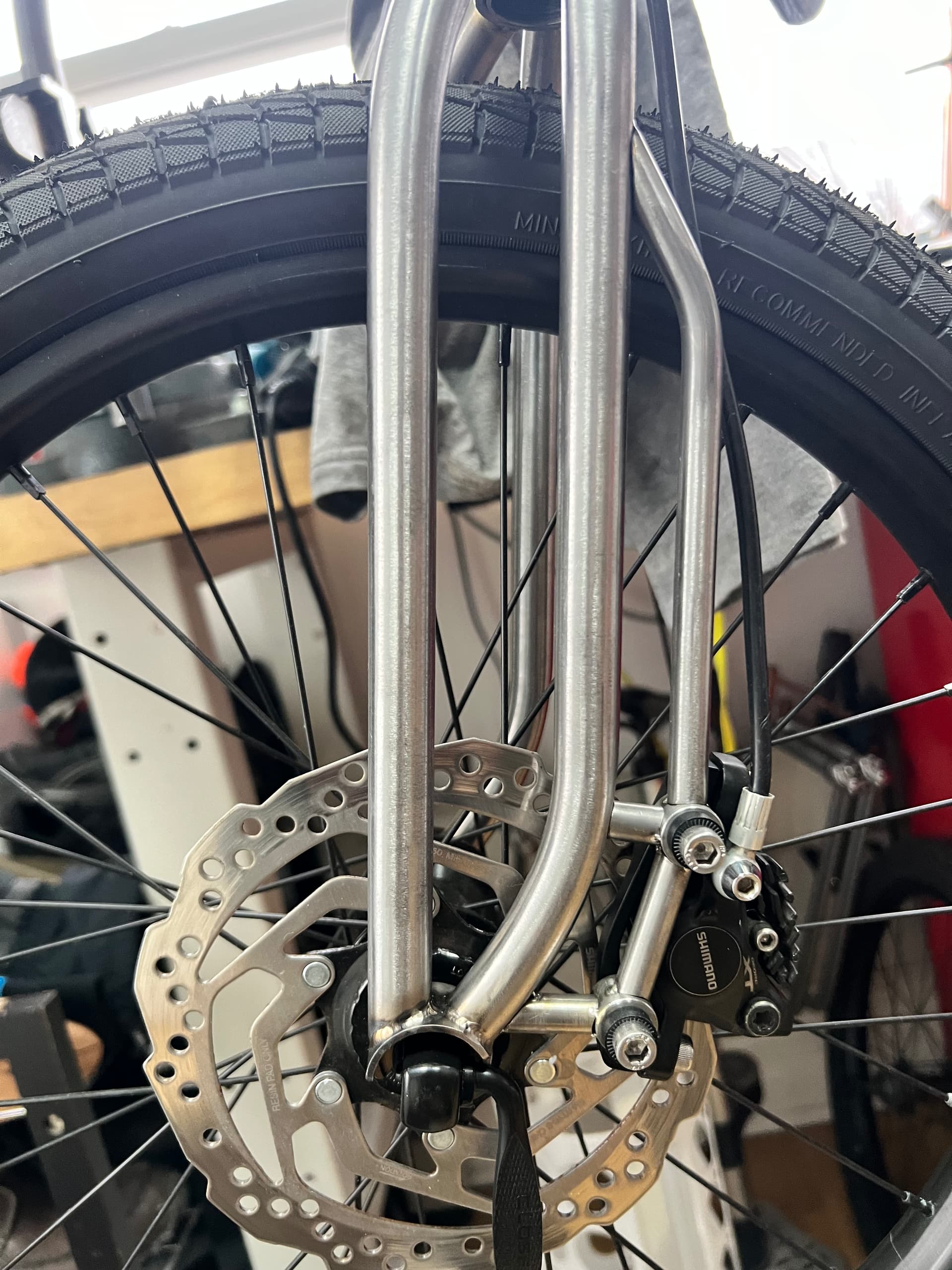

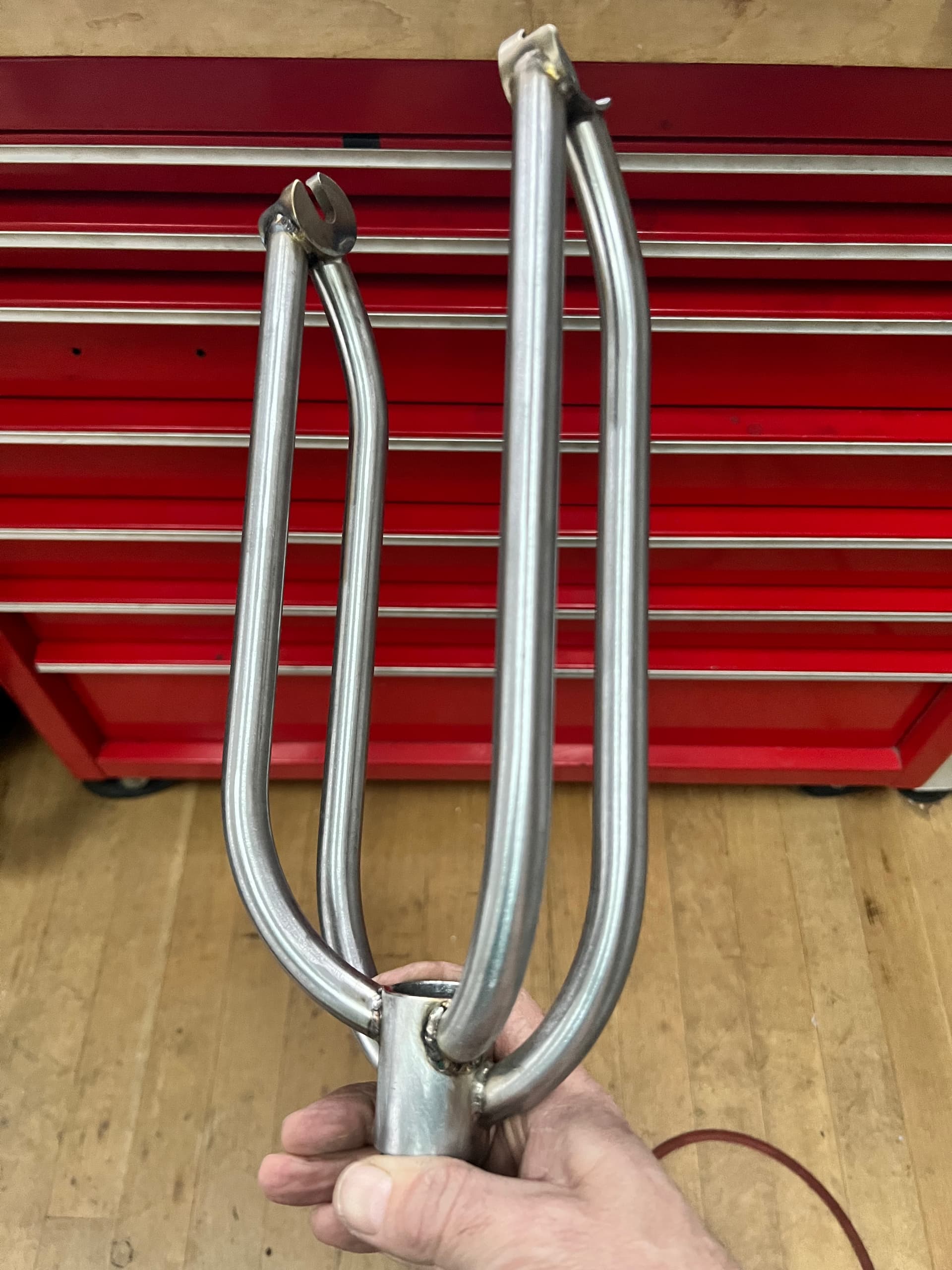

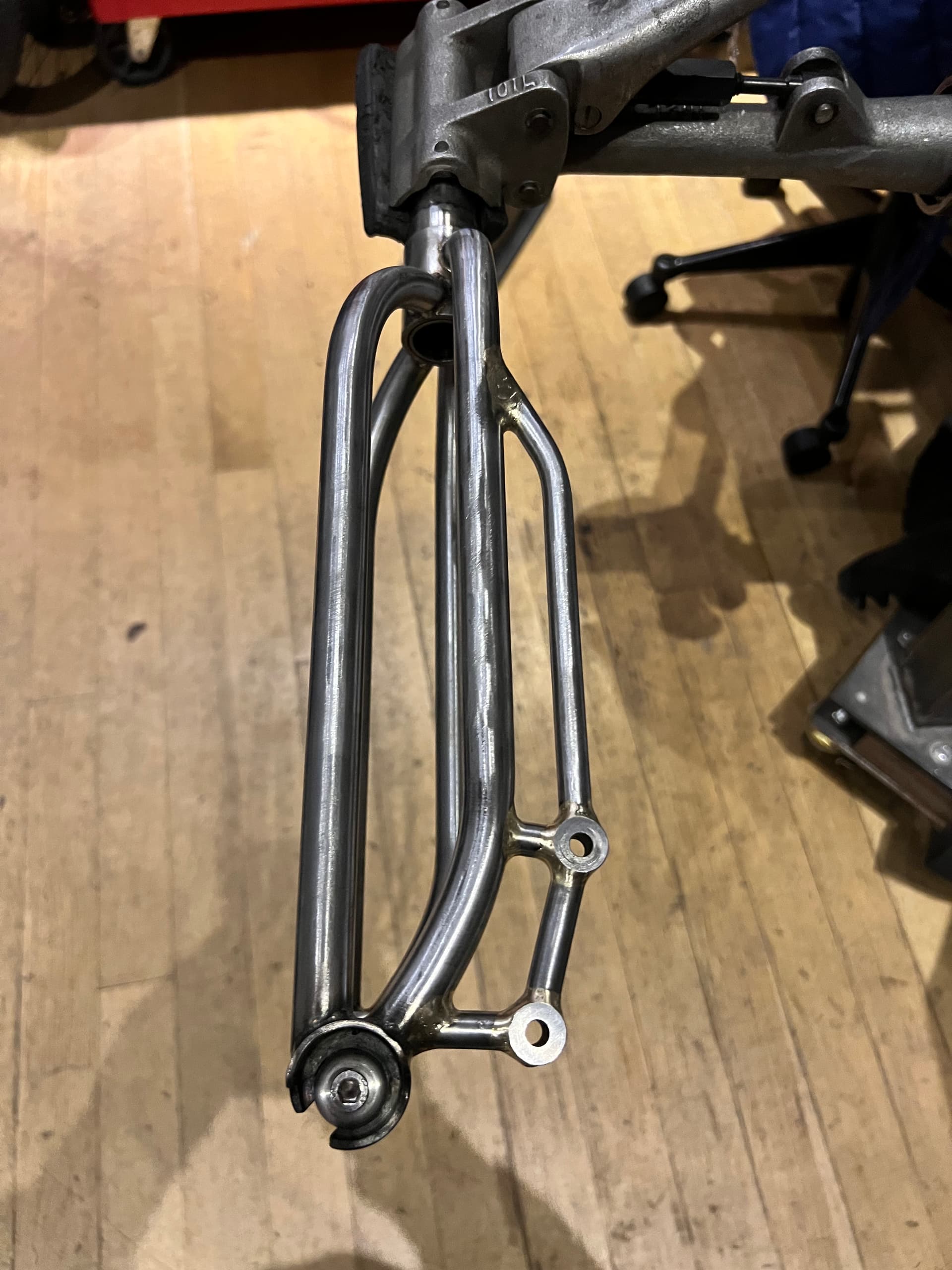

Did you ever end up making that Truss fork? curious what tubing you ended up using?
Yes, used 5/8” .035 chromoly. I have only rode it a few times, but it feels stout. I will have a better feeling for it once the weather gets better. Some pics of the process.
That’s a rad looking fork! I’ve been toying with the idea of a truss fork for a few years. Just never get around to buying the supplies. It’d be more of a touring setup with a clamp above the head tube as well. I hope you update when you get some riding time.
Is that stainless steel? What advantage does a truss fork bring?
It’s straight gauge 4130 tubing. It looks cool, can’t comment on how it compares strength wise.
